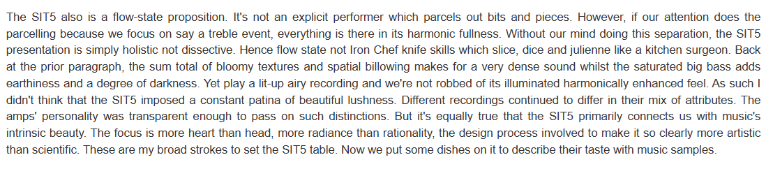

This is what Srajan writes ( I couldn't cut and paste his text.. I had to take a "picture". You tell me what it means.... (*)
Is the SIT5 then operating some kind of a high bit rate or is it sort of like the FET is filling it's holes one at a time and thus creating a voltage quantum gradient energy flow copacetic with the FE so that the Tokin steps in to fill in like the City Hall workers used to fix potholes in the Windy City in the Days Of Daly?
Has Nelson Pass perhaps managed to undo Leibniz's "natura non facit saltus" claim? Has Nelson invented a new "electronic calculus" that combines macro-quantum ion flow with a negative continuous rate of energy dispersion? Maybe Nelson has a bunch of French knives in his closet and he went "chop chop" happy one saturday evening and.. lo and behold... the sound of F5... Does the Iron Chef own a pair of F5s?
Honestly, I got no clue what Srajan writes about anymore.
God forbid he starts using a Japanese knife.... like a Santoku.. Will that make it so because Tokin is a Japanese device? Or maybe he's saying that the F5 mushes the potatoes instead of making hash browns... ?
Must be the fine Irish whiskey, I reckon.
Anyhow, I just wish the F5 weren't so expensive.... hmmm..... Maybe if I create my own Audio Review Site.... Zon Of Zenaudio... I might get some F5s from FW for an extended review. I'm sure I can come up with all kinds of uptown purty words too.. I got a theasurus somewhere... maybe use some Audio Reviewer AI machine...
(*) Mind you, trained as a physicist, I usually can successfully straddle the worlds of philosophy and engineering... but as Srajan gets older, he's become a bit more obtuse. He's gone into the realm of science fiction prose like Bradbury.

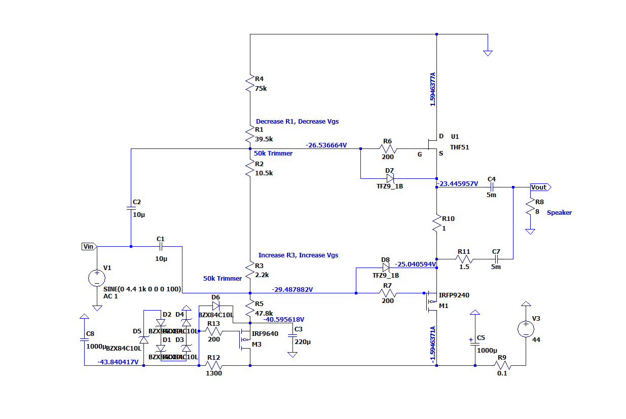

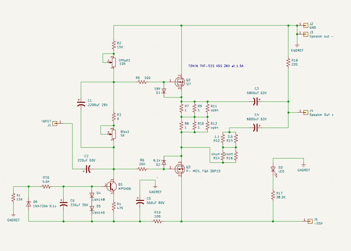

Here is my current schematic. It's still changing as I listen and experiment.

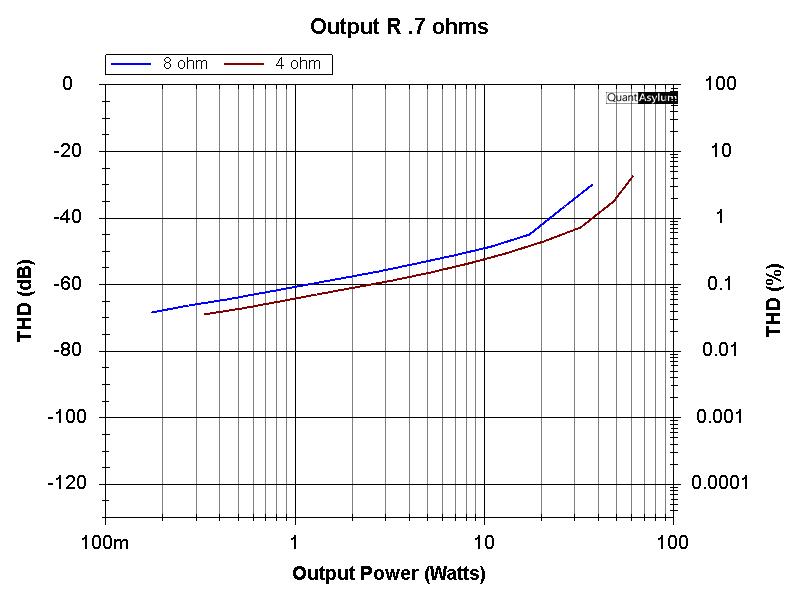

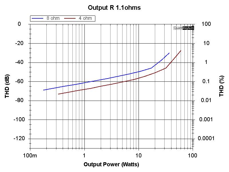

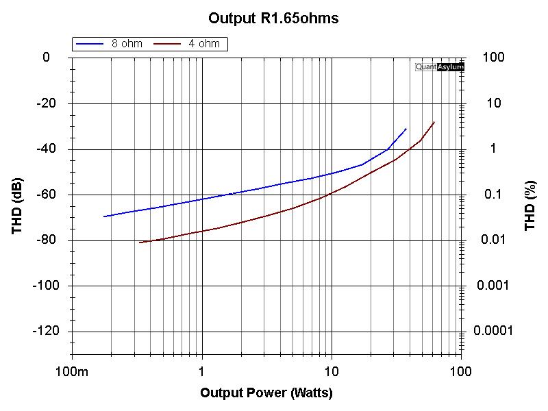

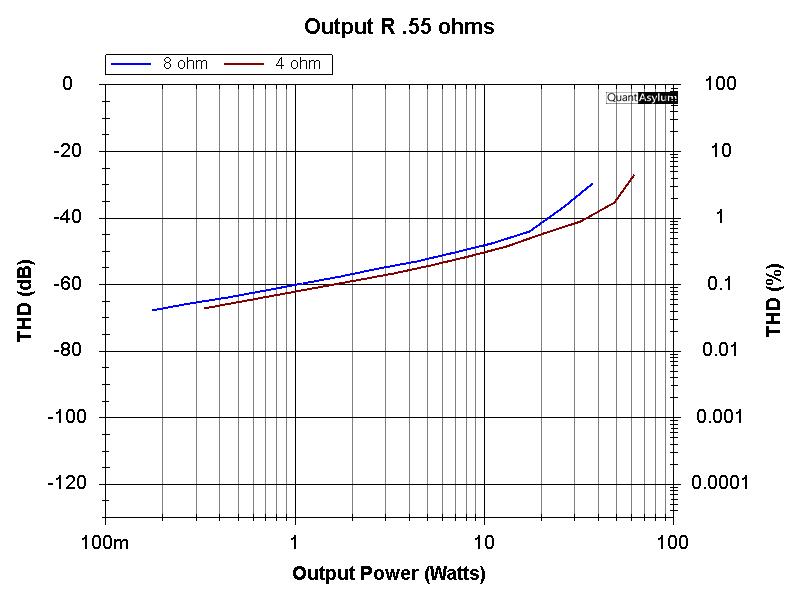

Here are my thoughts on adjusting the source to source resistor and series output. I played with 2 ohms source to source which reduced the gain. I didn't need more than 1.5v there so I just went with 1 Ohm and I like the sound.
I'm trying to keep the harmonics the same for 4 and 8 ohms with even spacing. Here are some examples .55 ohms, .7 ohms, 1.1 ohms and 1.65 ohms. I'm currently at .84 ohms.
The 1.65 ohms is close to the 20% but i don't care for the sound. Maybe I'm not measuring it correctly. Also as I'm running the 1.65 ohm tests I can see the H2 drop below the H3. crossing to the other side of the load line.
The sound is quite nice, different from my Tokin choke loaded or MU followers.
I made an affirmation in the past when Generg asked how to measure, the affirmation was wrong.
To calculate the contribution of mosfet you need to look at the current at its source pin.
This current is the sum of the current that runs through the resistors that are between the sources and also the resistors that are in series with the cap.
Also to mention that those groups of resistors is in parallel one with the other and for the resistor values that you have in your schematic total R is ~0.46r. It could be that you go class ab with such a low value and only 1.5a bias. You can monitor the voltage drop on the power resistor in the rc filter of the ps and see if it changes and how much.
It is good to adjust the vds of sit at the highest power that you target into both 4r and 8r and try to keep the higher harmonics as low as possible. Then see if you like what you get at 1w 🙂)

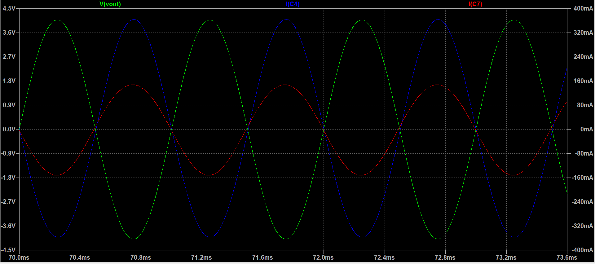

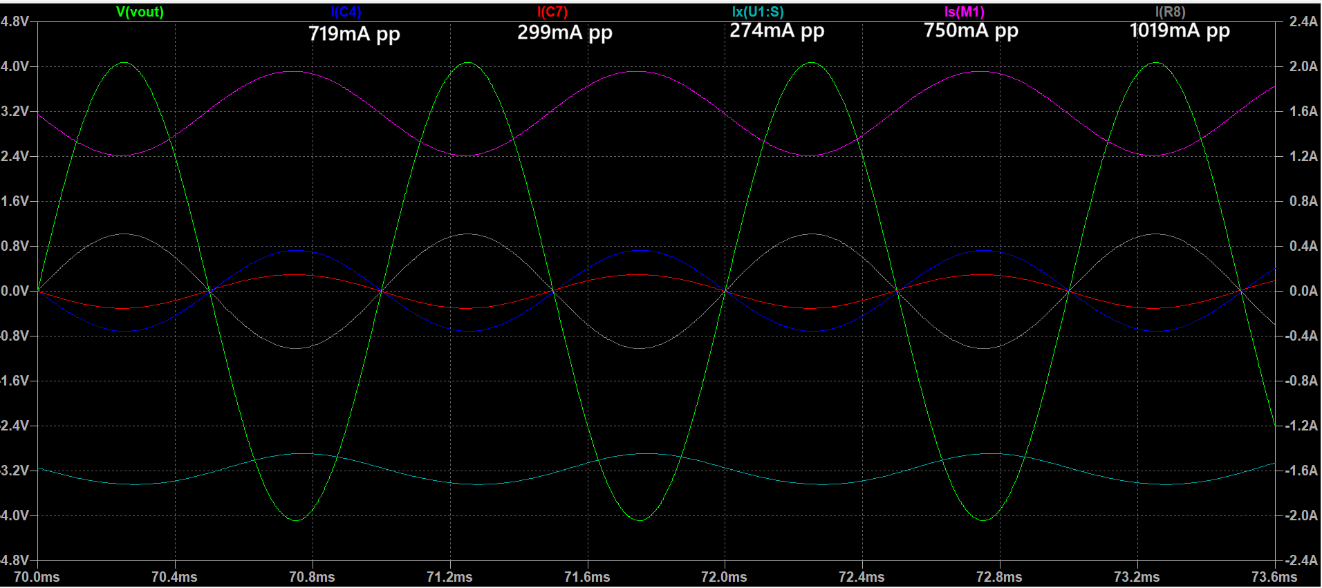

I have been playing with an output stage in LTSpice and I have been looking at the current through the two output capacitors as a way of checking the contribution of the SIT and mosfet to the output.
According to the output plot, the current through C4 (SIT) was 363mA peak, through C7 (mosfet contribution) was 147mA peak. Total current was 510mA so the mosfet contributed 29% in this example. I hope that this is the correct interpretation.
Did you mean C7?
According to the output plot, the current through C4 (SIT) was 363mA peak, through C4 (mosfet contribution) was 147mA peak. Total current was 510mA so the mosfet contributed 29% in this example. I hope that this is the correct interpretation.
