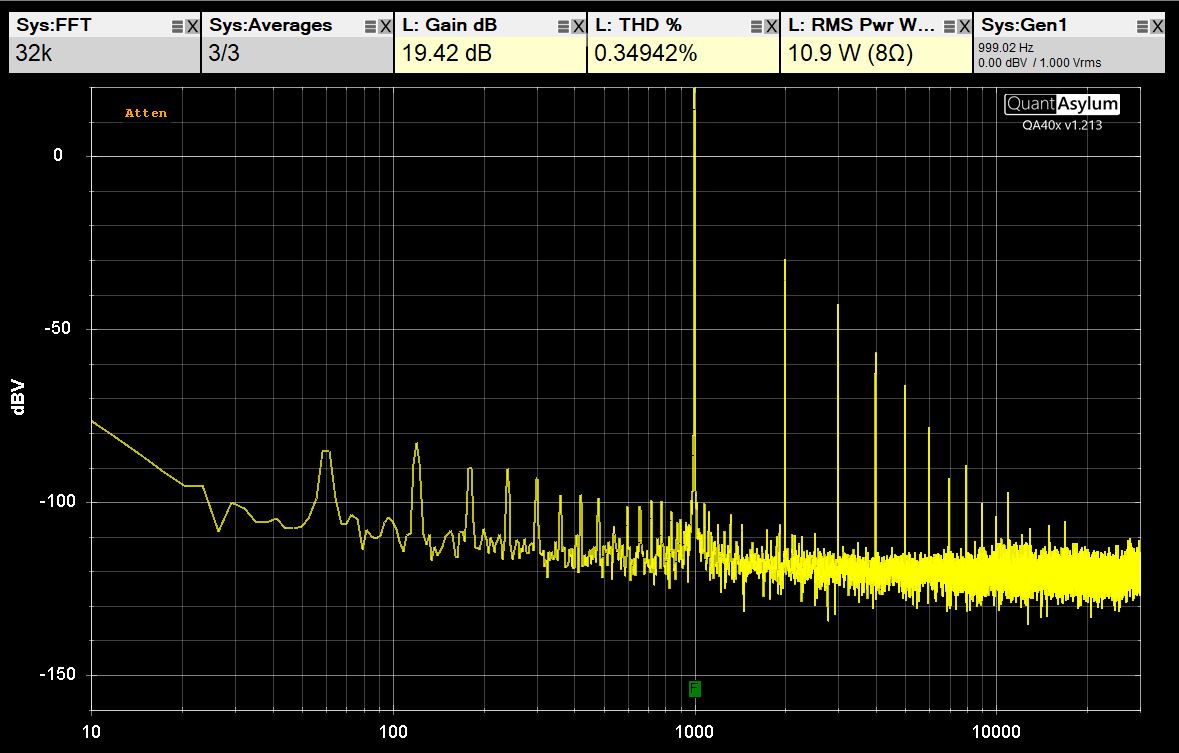

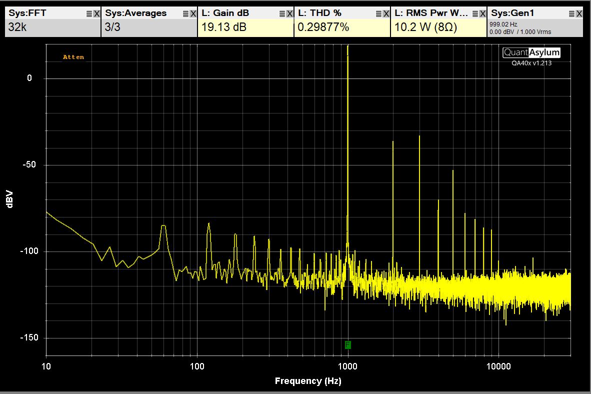

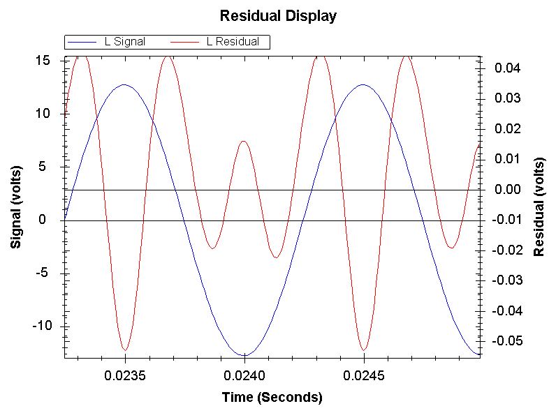

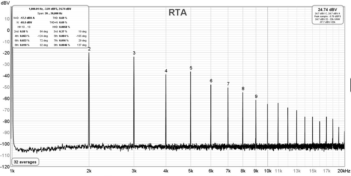

The series resistor in the output from the mosfet changes the SITs tracking of the load line. So the question is what do you like? It’s easy to see the changes in the spectrum it’s much harder to decide what it should sound like.
Here is 10w at 8 ohms

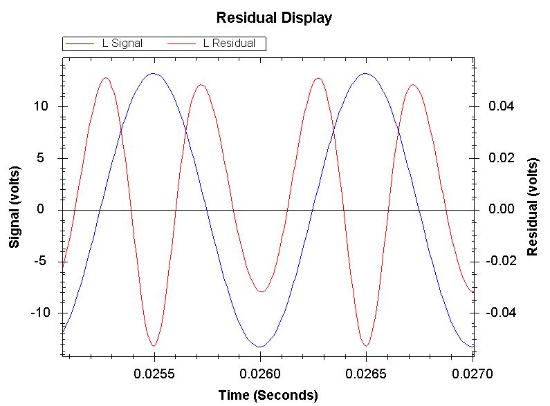

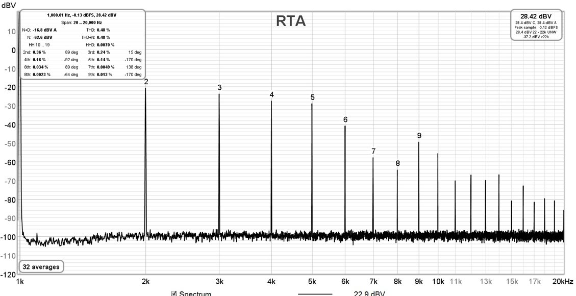

Here is with a 4 ohm load. About 20w. With the output resistance at .7 ohms
At a resistance of .55 the load line holds and you don’t get the H2 dropping below the H3.
What sounds best? That’s the secret sauce!

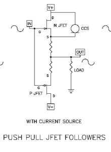

This article from Nelson might be interesting https://www.firstwatt.com/wp-content/uploads/2023/12/art_sweet_spot.pdf

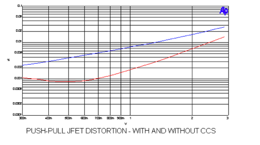

Here is one of the possibilities to "search for the sweet spot" that might be used in SIT-5 too in a passive way like XA30.5.
"Here's a technique we use at Pass Labs – the use of some single-ended bias in a push-pull output stage to reduce distortion. The distortion curve below shows what you can get if you simply put a small value current source in parallel with one of the JFETs as shown on the middle circuit. The current source displaces the bias current values on the JFETs until they achieve a more perfect distortion cancellation:"
So I have something new to search if I can see it in Spice.
Nelson is a genius as the "Audiophiliac" said.....

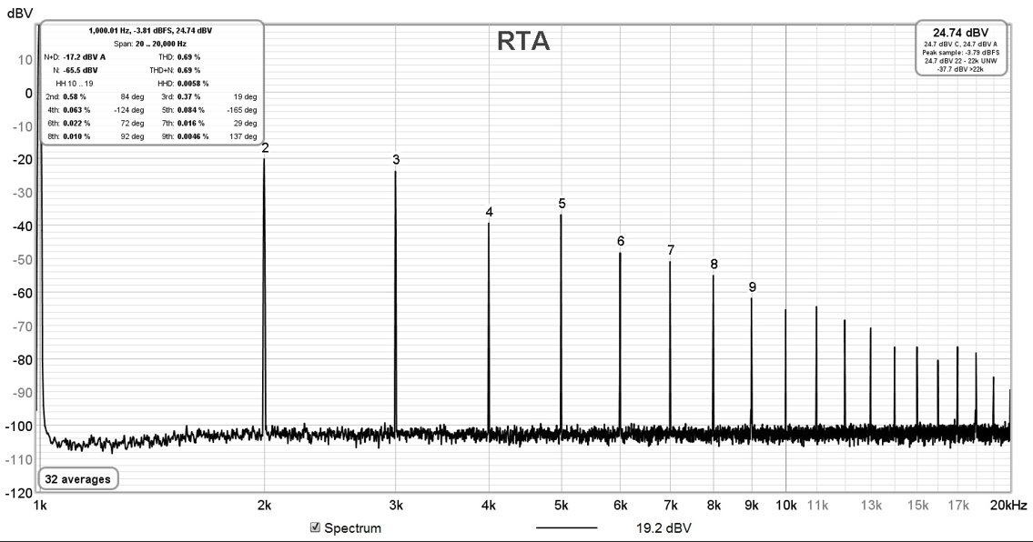

Ben for the 8r test it was around 80vdc with 1.6a bias so class AB, same stuff for the 4r test, 60v with 1.8a bias.
I am attaching another measurement at 75w/4r but this time at 0.4a bias 🙂) which is practically identical to the one at 1.8a bias.
I don't know if it is still true.
It`s no problem .. we all learn by reading these graphs. +h2 in my graphs is actually -h2

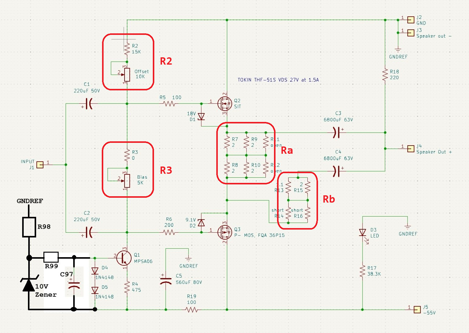

I created some simulations using LTSpice to determine the THD values.
I used Botte's circuit as a basis.
For all outputs, the VDS on the SIT was set to 27V.
The IRFP9240 was used for the MOSFET.
The values with a slash between the values refer to a load of 4 and 8 ohms.
The following values were used as input voltage: 3V, 5V, 10V, 15V and 20V.
The supply voltages were -55V, -60V, and -65V, with a current of 1.5A and 2.0A, respectively.

The resistance Ra is between the two source pins and Rb is the resistance at the MOSFET source to the speaker.
Code:
