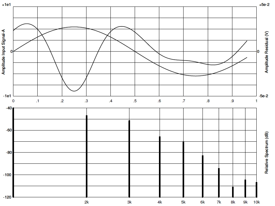

These days I went ahead with the tuning of the amp. After a long battle I can say I got where I wanted with the enclosure I had at hand (there will be more with the future monoblocks) so I settled on 56Vdc for the ps and a bias of 2A.
I had some Lpads that made my life easier when doing the adjustments but even like this it took some time.

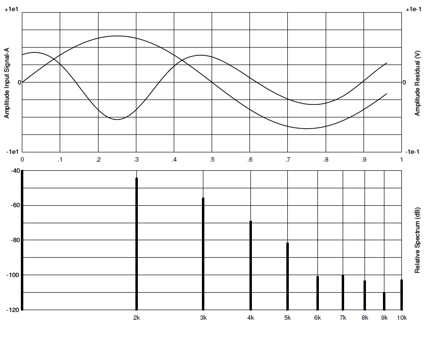

After I listened with the amp set in different ways I adjusted it till I got the best performance at 4r and then did same procedure for 8r. I had the pleasant surprise to see that same settings work great for both 4r and 8r.
Without a fft analyzer its a bit of a lottery getting to the best settings because probably you have different gain devices and it doesn`t help using same values for certain components, here you have to do your homework if you want the best implementation.
So here is how 27w/4r look
Then with the same settings here is how it looks at 20w/8r
Then I measured the mosfet modulation into 8r which was ~24%. When I seen that also the modulation is where it should I think you can imagine how happy I was that this time I nailed it 🙂)

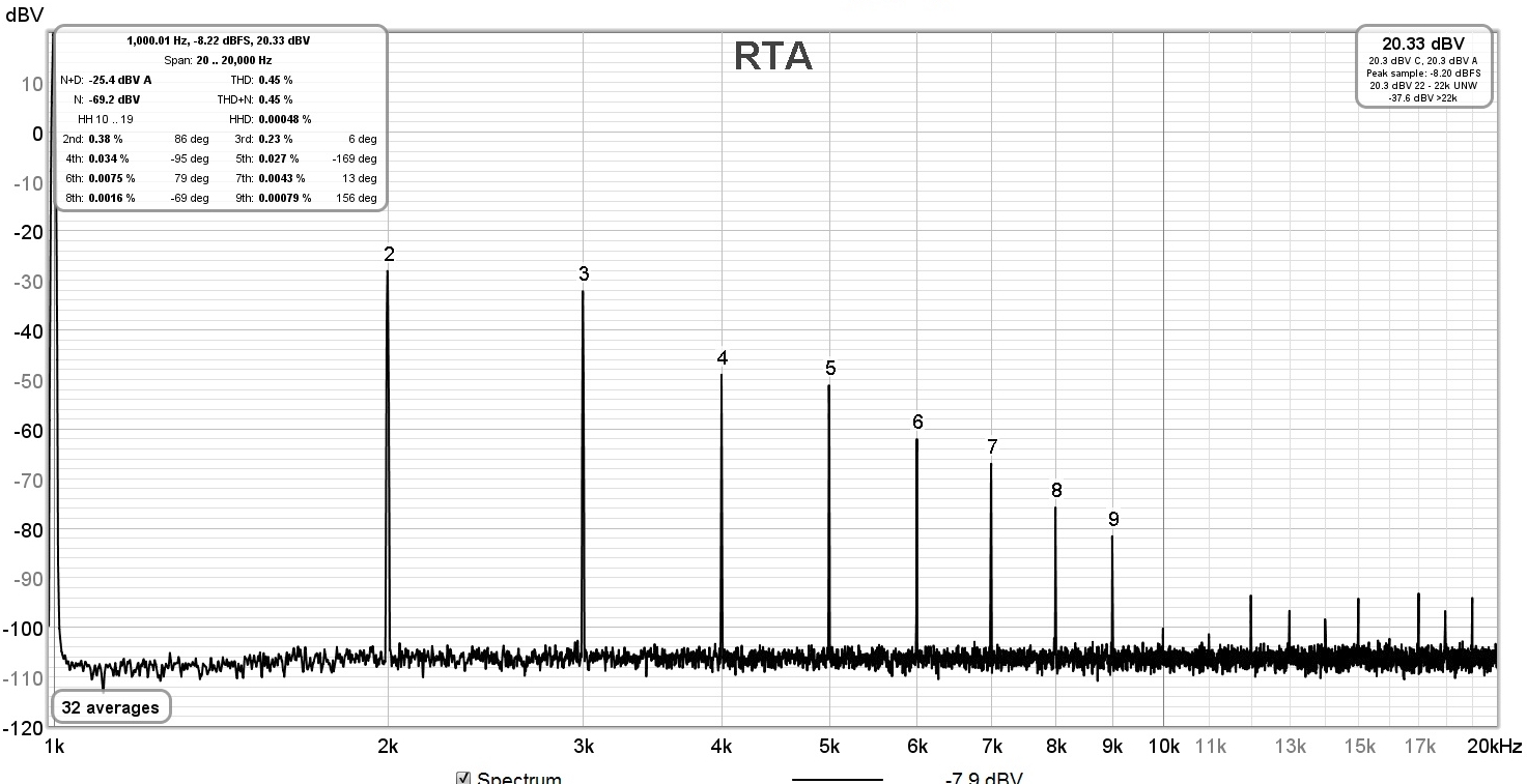

Edit: forgotten again but now was in time for an edit
Here is how h2 looks at 27w/4r
