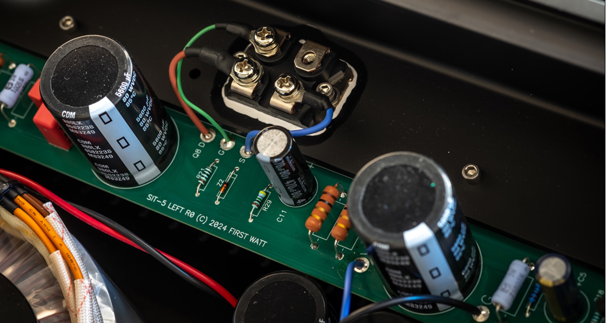

First Watt SIT5

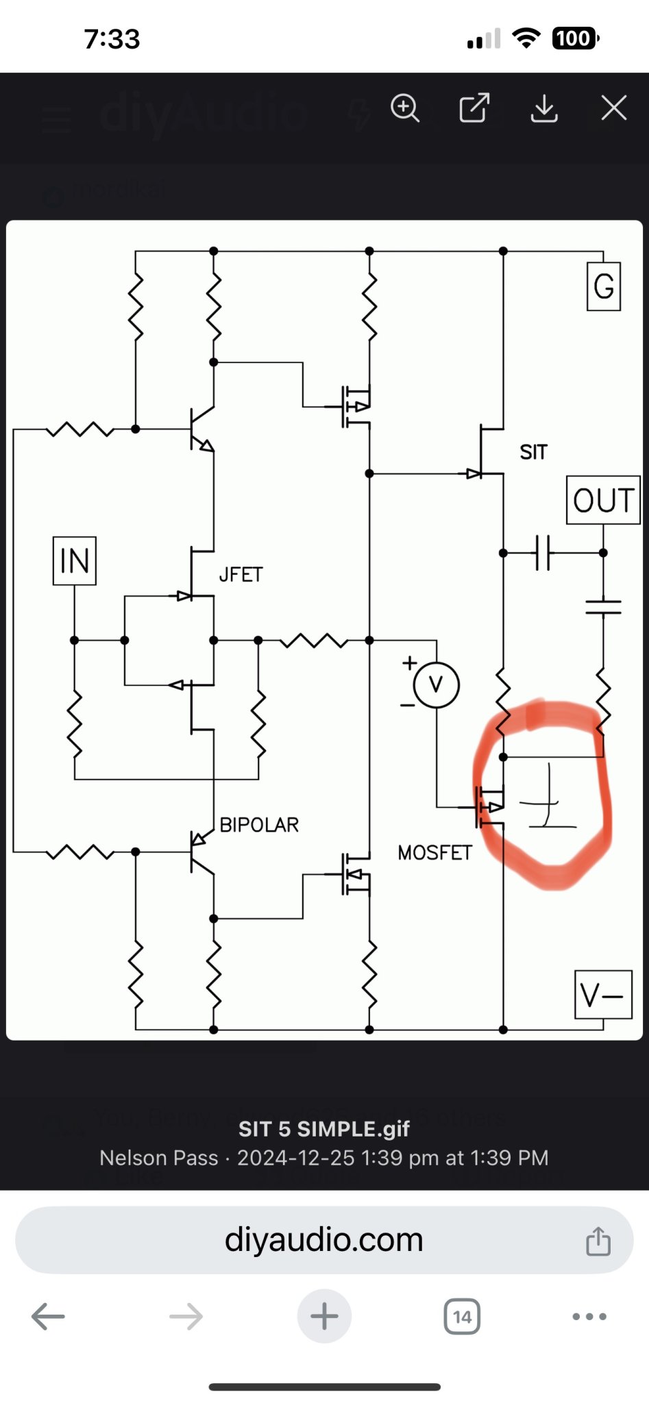

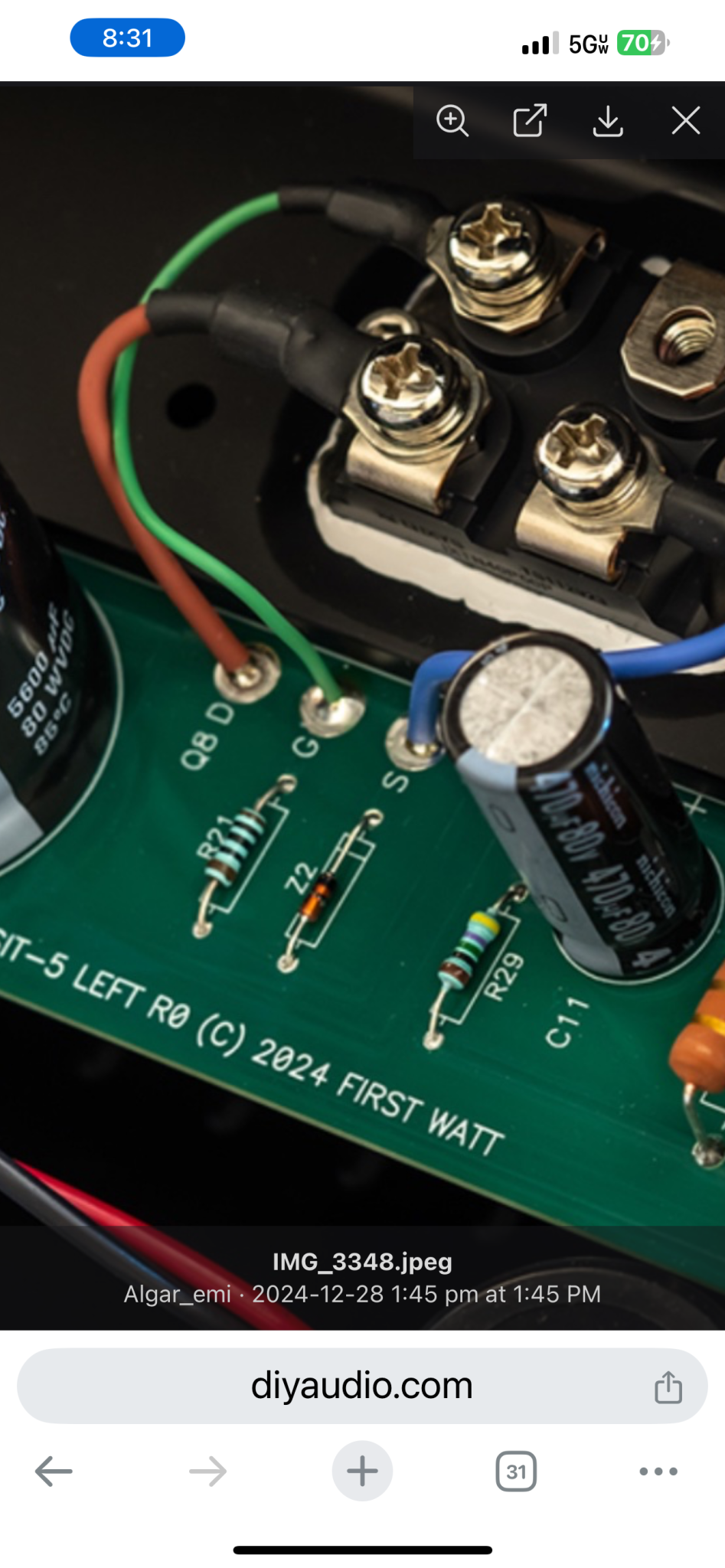

Gerd maybe you’re on something, two high power resistors of 1R can be seen on the right of the picture 😉
Naturally you want to share the dissipation equally in a project like this. With a (beastly) monaural amplifier, one side of the chassis would be handling the "top half" of the output stage, other side handling the "bottom half". The SIT-1 being another monaural example, with the Static Induction Transistor (and a couple of power resistors) on one heatsink, and a row of six power resistors (100W rated Vishays) on the other to even out the thermal load.

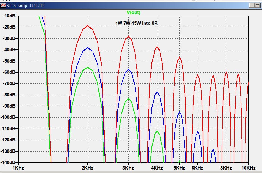

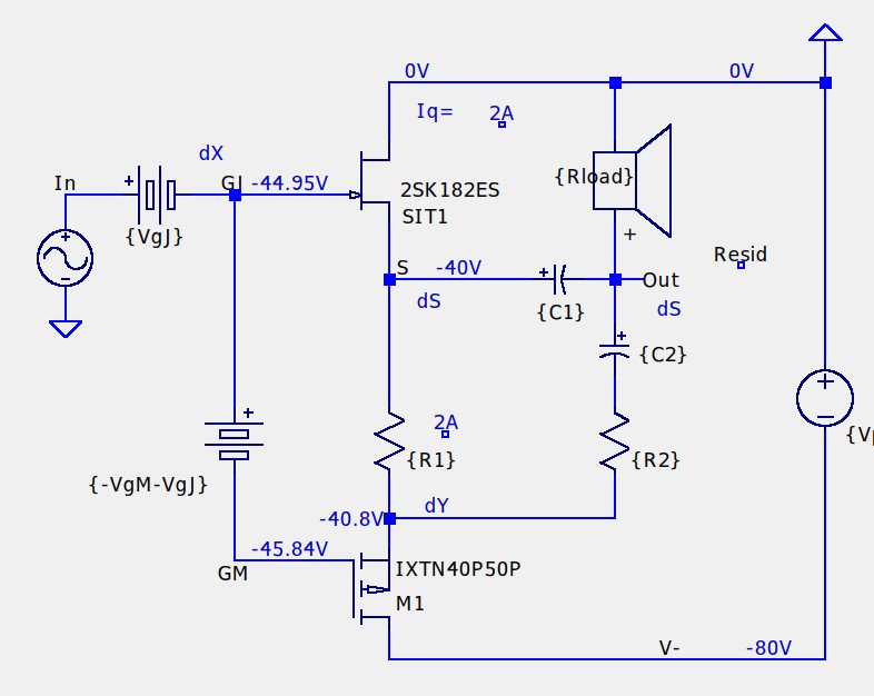

Simulations show that the SIT-5 output stage is amazing. So far I have discovered several major improvements over any of the mu-follower follower MUFF stages:
  • Less sensitive to the choice of quiescent Vds of the SIT. Thus it is more tolerant to variations between SITs.
  • Distortion falloff pattern remains the same at all power levels. The rate on falloff decreases with power.
  • The class-B behavior is excellent at power levels where one of the FETs stops conducting.
Here is my simplified simulation schematic. The SIT model parameters were derived from my measurements and agree well with bench tests. I have not fully tuned the circuit parameters (I0, Vds0, R1, R2).
Also below are spectra for 1W, 7W, and 45W into an 8R load. Very nice.

You are correct that the AC current of PFET is considerably greater than that of the SIT.
But the contribution through C2 is much less than through C1.
The simplified circuit appears to function nicely without R2 and C2. Perhaps the reason for those components is to allow R1 to be big enough for an optocoupler bias circuit but still have strong output from the PFET. No other magic involved.

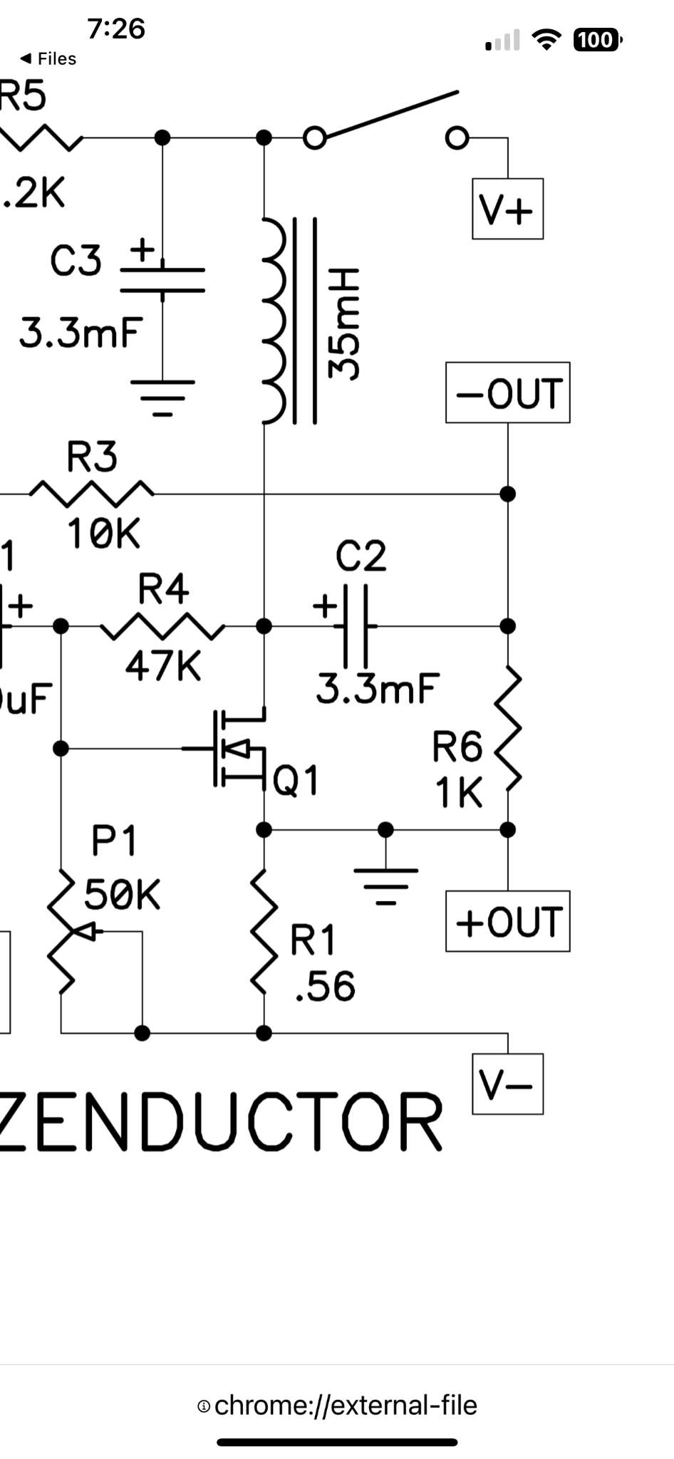

The way the output resistors are connected, one set is used to set the bias and the other can be independently adjusted to ensure that the output character (H2, H3 balance) remains the same over the entire power range. A different way to say this would be that the two resistors in the output are in parallel only for AC.
Another cool thing is that the circuit has BJTs, JFETs, MOSFETs, and SITs, all working together :hphones:
