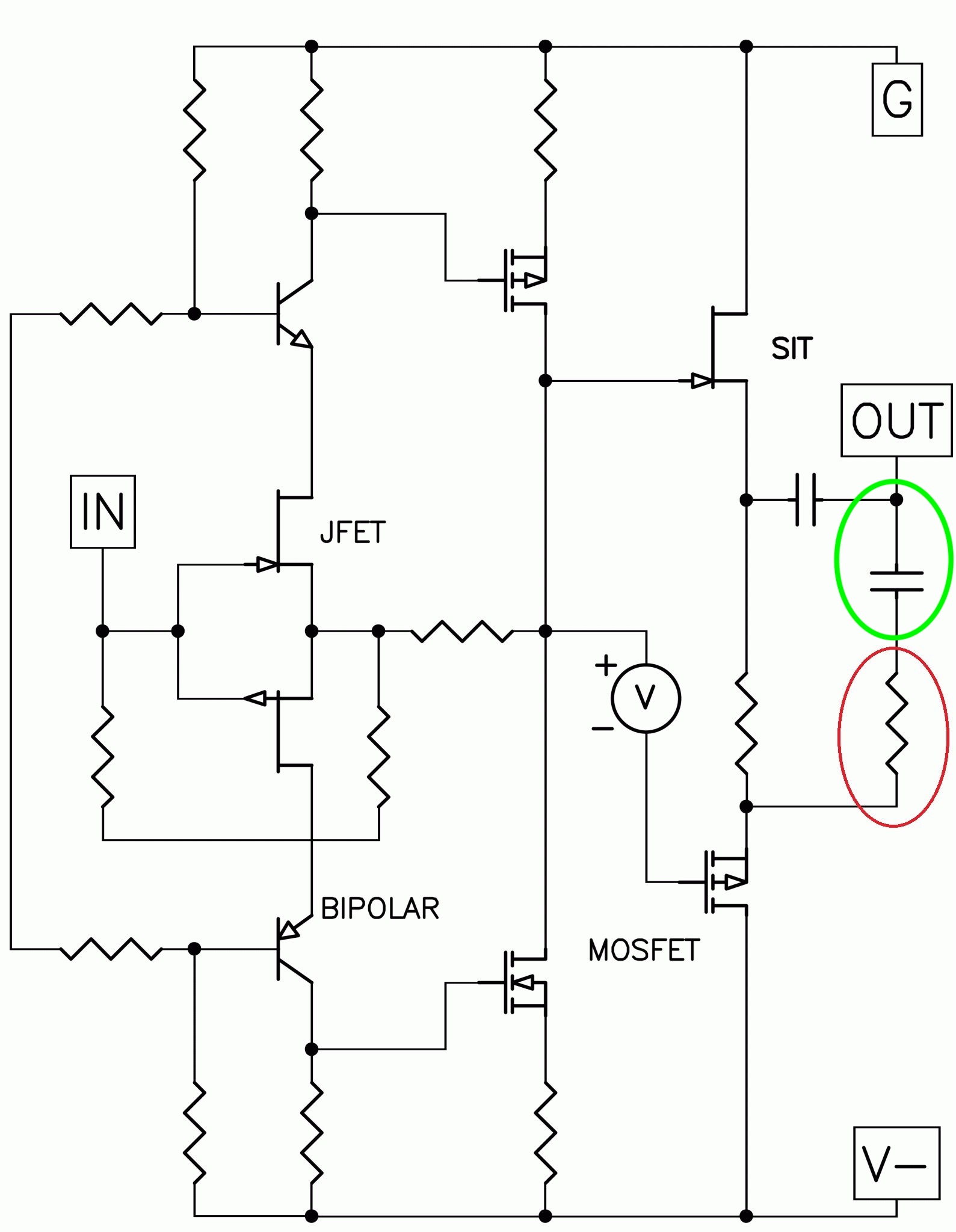

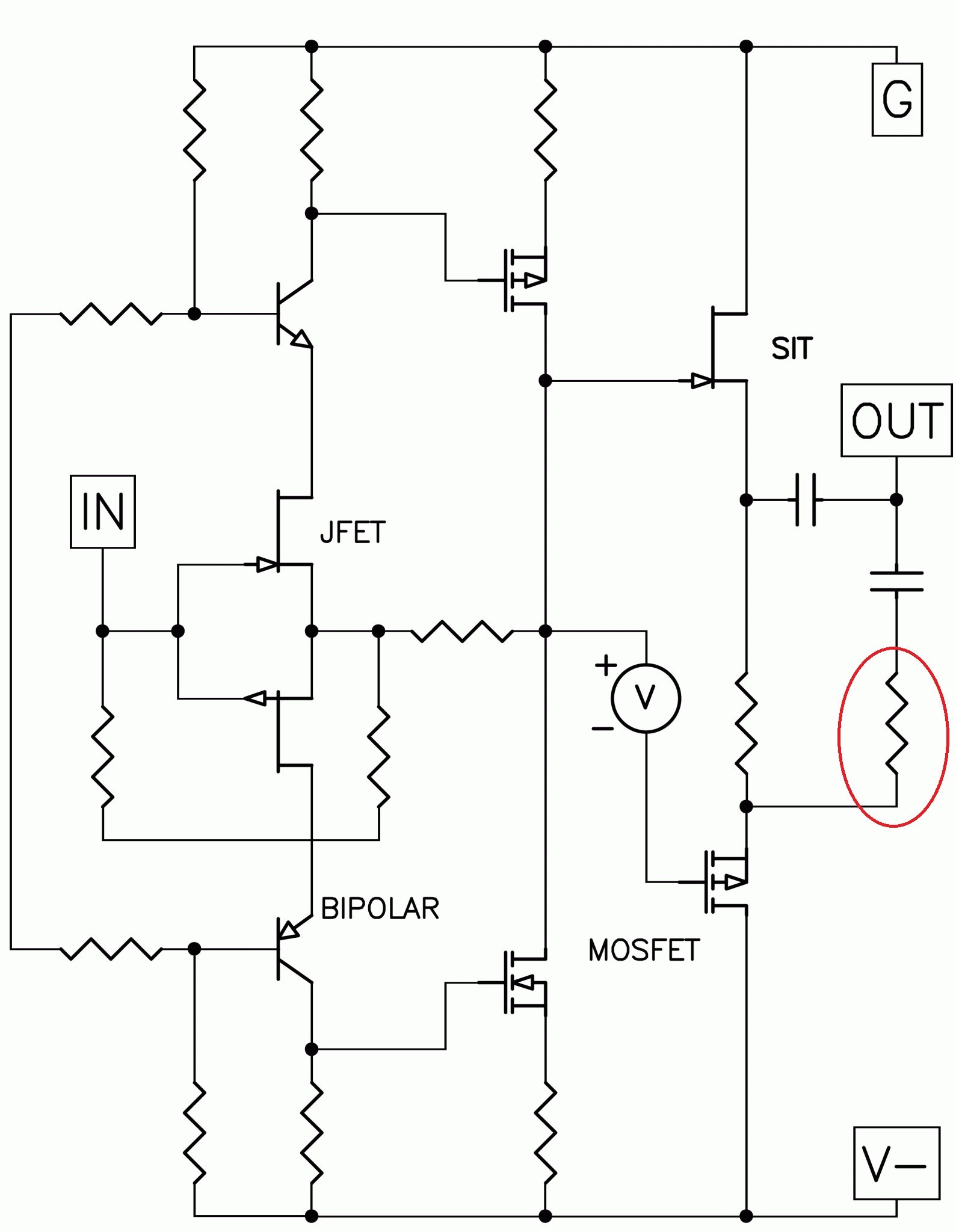

Yes, but if you look at the arrangement in the zenductor, in between the bias resistor is interposed with a capacitor and ground… according to Nelson in his article, the bias resistor does not degenerate the mosfet…. I guess that is what I was trying to see if that is what Nelson was talking about.
What I see is that the speaker out from the SIT drain allows Class A single ended output.
The speaker out from the mosfet drain can be controlled by the resistor between the mosfet drain and the capacitor connected to the speaker output. This resistor can be set so the amplifier is more single ended or more push-pull.
When set for more push-pull output, the amplifier output into lower speaker impedance (such as 4 Ohm) will allow for much higher power output than into speaker with higher speaker impedance (such as 8 Ohm).
When set for more single ended output, the amplifier output into lower speaker impedance (such as 4 Ohm) will be lower power output than into speaker with higher speaker impedance (such as 8 Ohm).
This is all set by one resistor which controls the amount of amplification that the mosfet provides.
Schematic with resistor noted:
Reactions: generg and andynor

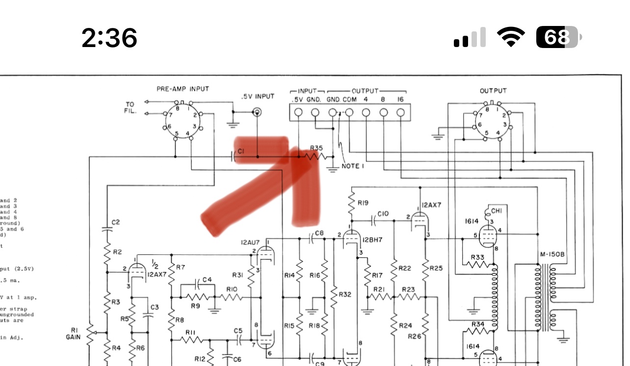

I think I have embarrassed myself enough for one night…. I follow what you are saying, if that is the case, then as a designer, one cannot assume what the customer will plug into the amps. So the question is, how does one design for both speakers in mind, 4 ohm speakers push pull, 8 ohm speakers single ended… maybe that is what pa was getting at. I know old school tube amps used to have different outputs connections for the types of ohm’s speakers connected. I doubt that is what is going on here.
No speaker is exactly 4 Ohm or 8 Ohm over the whole frequency range, or even 4 Ohm or 8 Ohm at any frequency.
There are all sorts of assumptions and compromises in design, and the designer makes choices to suit his goals and preferences.
The simplified circuit appears to function nicely without R2 and C2. Perhaps the reason for those components is to allow R1 to be big enough for an optocoupler bias circuit but still have strong output from the PFET. No other magic involved.

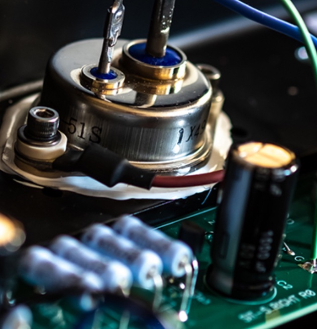

This time possibly no optocoupler, a TO-92 can be seen near the SIT and the 3Watt combo. Maybe done like in A3 or ZM like......Algar emi had hawks eyes.
If we take the extra green output capacitor as a supercapa = 1F: that has been used before as a Double Nelson output on a source resistor . . .
This way, the Rs becomes just a voltage shifter.
(Sorry Pa, this design unintentionally gets bigger and bigger)
Where did you see a TO-92 device? I didn't see it an any of the 6Moons pictures.

Comparing both 6moons pictures, we can see a blue wire on the mosfet side, near the two 1R resistors, then the same blue wire on the SIT side, between one resistor (maybe paralleled with a smaller cap), then 4 power resistors, and an other smaller cap., so maybe the output network is split as well between side, and between section with separate cap/resistors…
This blue wire may well be the output wire to the rear speaker connector.
To resume it seems there are smaller cap, maybe 470uf as we can see in parallel with each resistors at the output, in addition to the larger 5600u coupling caps…
