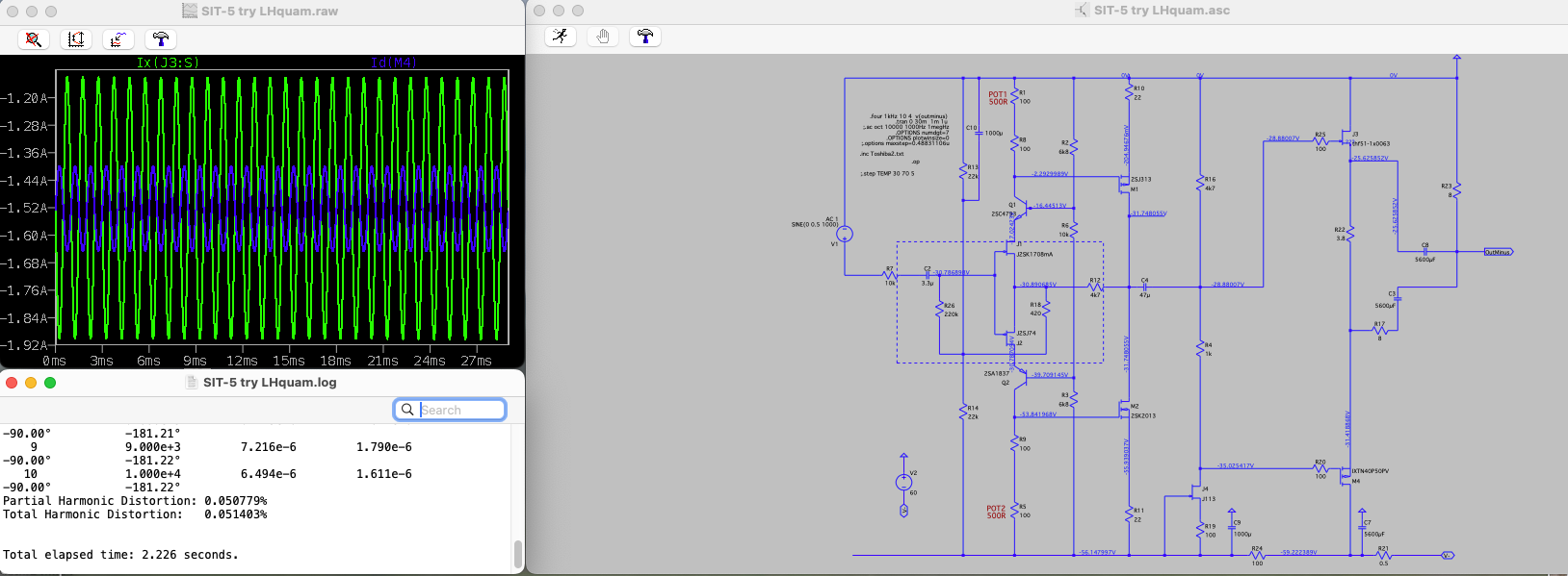

First Watt SIT5
Inspired by lhquam success.....
I tried his way to make the biasing of the output stage, hope I got his decisive idea right.
Because I have no real understanding, it was all done by try and error or copy and paste....
Helas, I am no lhquam, no ZM and no Nelson of course, so there might be severe faults. You all know LTspice is patient, reality often not.
Please comment. How much current do I need to get the 35Watt with 60V rails?

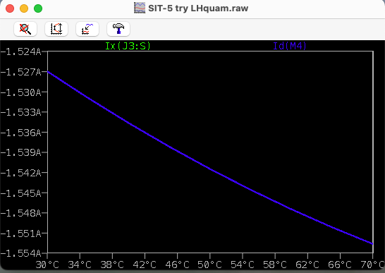

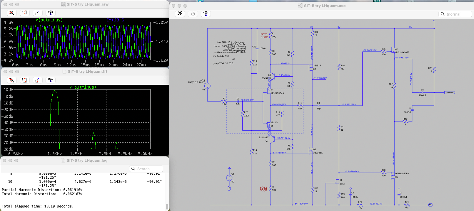

A bit higher current and I adjusted the source resistors at the output to get more contribution of the SIT (green), blue MosFet.
Of course do not take my draft too seriously it is more "entertainment than analysis" to vary a well-known saying....

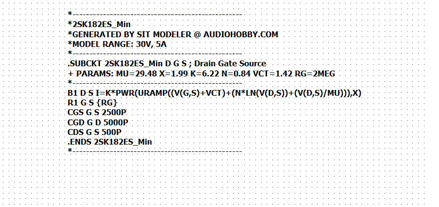

Thank you Ben!
I show them both here: And Lynn is there the tempco visible?
First one:
*2SK182ES2
*GENERATED BY SIT MODELER @ AUDIOHOBBY.COM
*MODEL RANGE: 80V, 2A
.SUBCKT 2SK182ES D G S ; Drain Gate Source
+ PARAMS: MU=16.98 X=2.56 K=0.443 N=1.6 VCT=0 RG=2MEG
B1 D S I=K*PWR(URAMP((V(G,S)+VCT)+(N*LN(V(D,S))+(V(D,S)/MU))),X)
FOR MULTISIM COMMENT OUT ABOVE LINE () AND UNCOMMENT NEXT LINE
*B1 D S I=K*PWR(MAX((V(G,S)+VCT)+(N*LN(V(D,S))+(V(D,S)/MU)),0),X)
R1 G S {RG}
CGS G S 2600P
CGD G D 0P
CDS G S 0P
.ENDS 2SK182ES
Second one:
*2SK182ES2
*GENERATED BY LHQUAM
.SUBCKT 2SK182ES2 D G S ; Drain Gate Source
R1 G S {RG}
CGS G S 17.7nF ; Ciss-Crss
CGD G D 0P ; Crss need a value here
CDS G S 0P ; Coss-Crss
.ENDS 2SK182ES2
