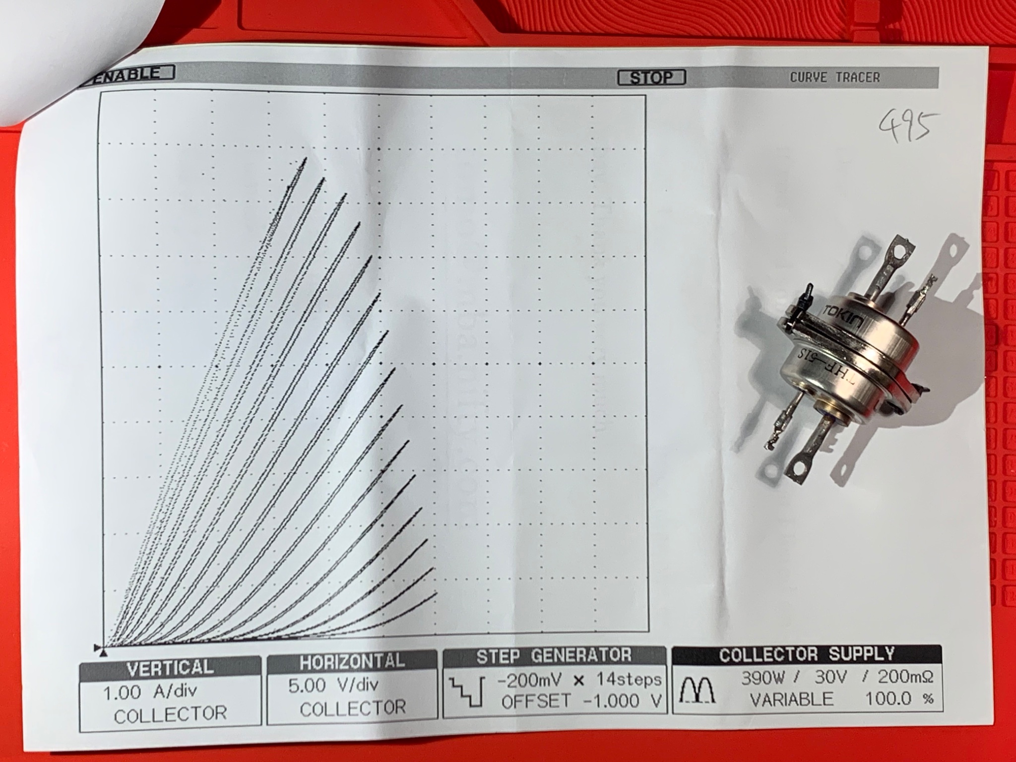

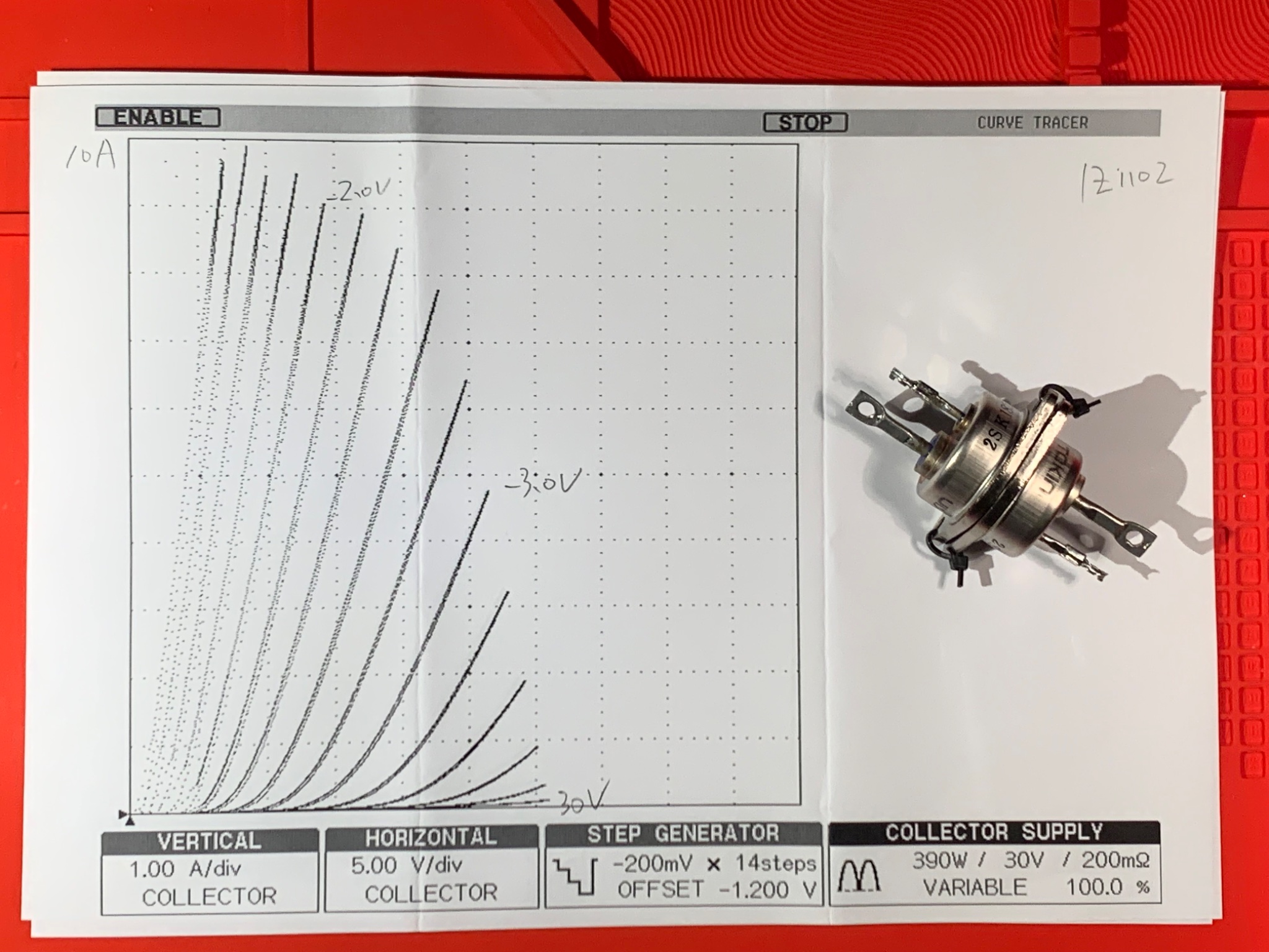

Well, thats interesting points of views and aspects of them both.
But that does not tell the MOST important thing: how they actually will sound in a specific topology.
I dont know yet, but the different beautiful pairs have slightly different curves. 🙂
How much will this affect the sound? As i said, dont know, still building, remains to be measured and possibly heard. 🎺🙂🎸

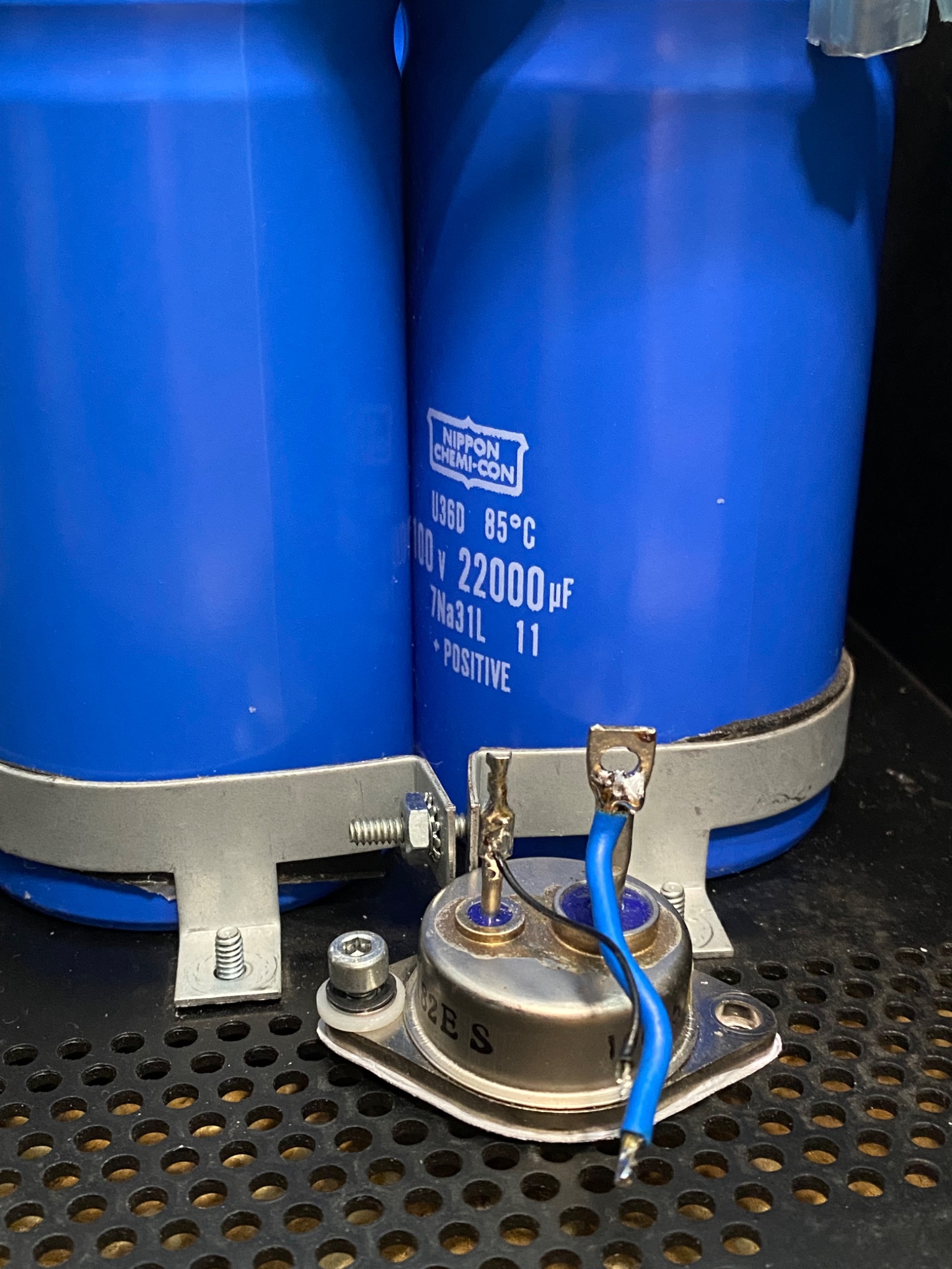

My choke loaded 2SK180 is at 1/3 of maximum dissipation. I can keep my hand on the naturally cooled heat sink indefinitely so I think I can probably push it a bit more.What is the maximum dissipation that the bravest heart around went with these sits?
My THF-51S mu follower follower is currently running at 3A and 75V (37.5V to the THF-51S) so I am going easy on the THF-51S. This amp has forced air cooling so it also runs cool.
With high dissipation requirements I think forced air cooling is the practical solution.

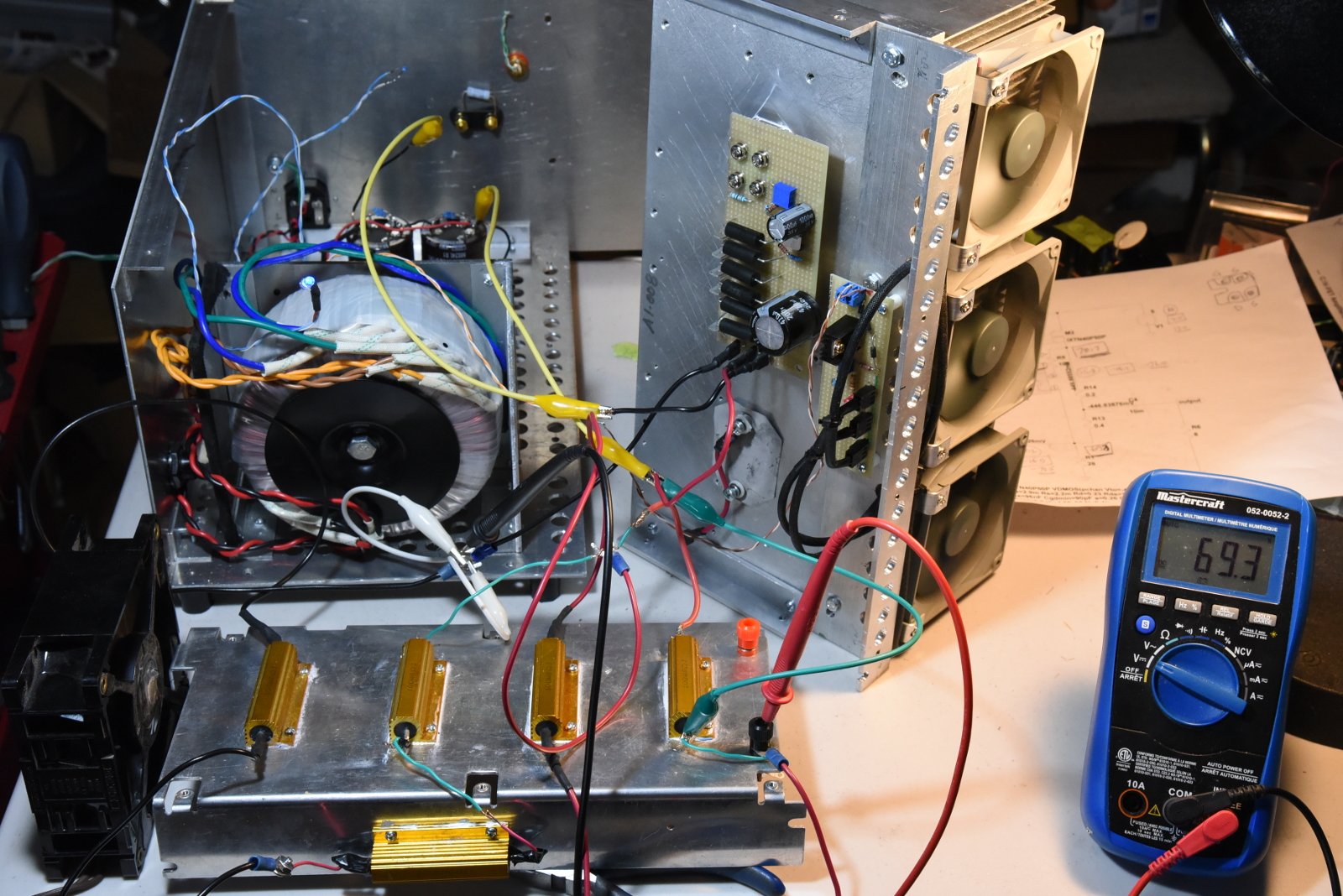

I will be using forced air cooling with my new amplifier which I'm currently building. During my CCS testing, I used a 120V power supply and set the current to 2.5A, and used a 28 ohm resistor array to simulate the load of the SIT. The dissipation of the MOSFET on the heatsink was about 125 watts and with three 90mm Noctua fans in operation, the heatsink got warm but not hot. I expect adding another 175 watts with the 2SK182ES would not tax the cooling abilities of the system.
The test load resistors got quite hot, though.

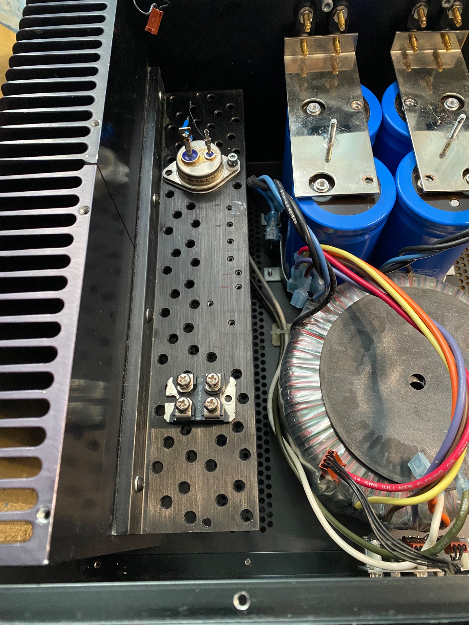

This is what is left of a 300w/8r class ab amp that idled at 540va. It was to be repaired but the owner changed his mind so I took it off his hands.
The power supply and the chassis seem good for a stereo sit5 so that’s what I’ll put inside.
