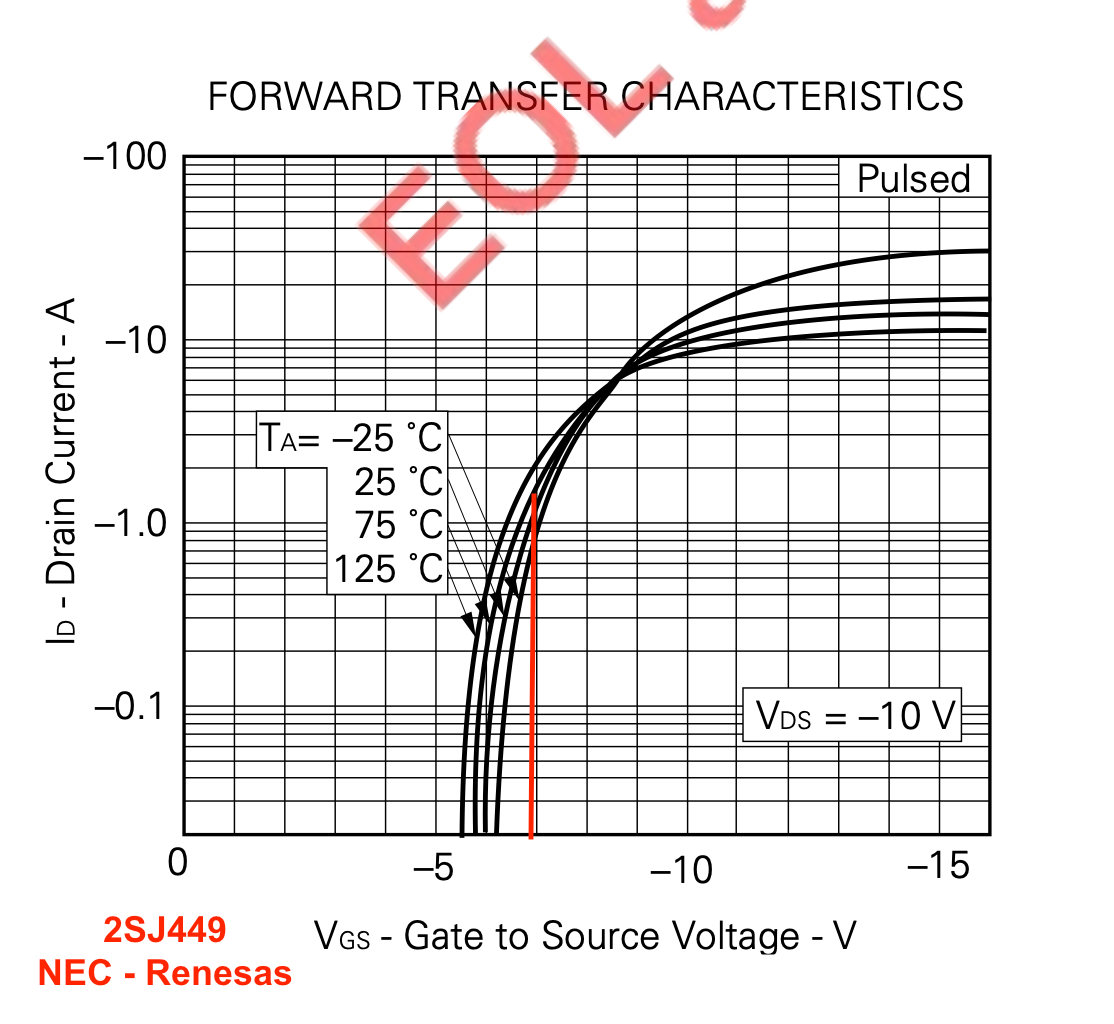

For the P-mosfet, the 'standard' thought is to the very macho IXTN40P50P and similar. Then you need the source resistor to create the benign Vgs bias.
But what about another legacy P-mosfet?
The 2SJ447 (NEC, lastly Renesas, EOL) has Vgs of nearly 7 volt at 1.5Amp. [I use it in a HV shunt]. The idea is that it allows a mucho smaller Rs, maybe zero. OK, the Vds max isn't that high, but that is not important here. The source resistance is not as low as the IXYS stuff though (3,5S/<0.8Ω-on vs 38S/>0.23Ω-pulsed). But the latter can be solved.
Ah. The Cero SIT-OM amplifier is born.
Paralleling for more than the little <6Amp should be possible. Because the transistor has a positive tempco, a small Rs of say 0.1Ω on each would be beneficient.
Of course, first look at the curse: the harmonics. . . .
Then you will get mucho mos sound.The idea is that it allows a mucho smaller Rs
I'ld guess so too. But the internal resistance being high in comparison might reduce that effect.

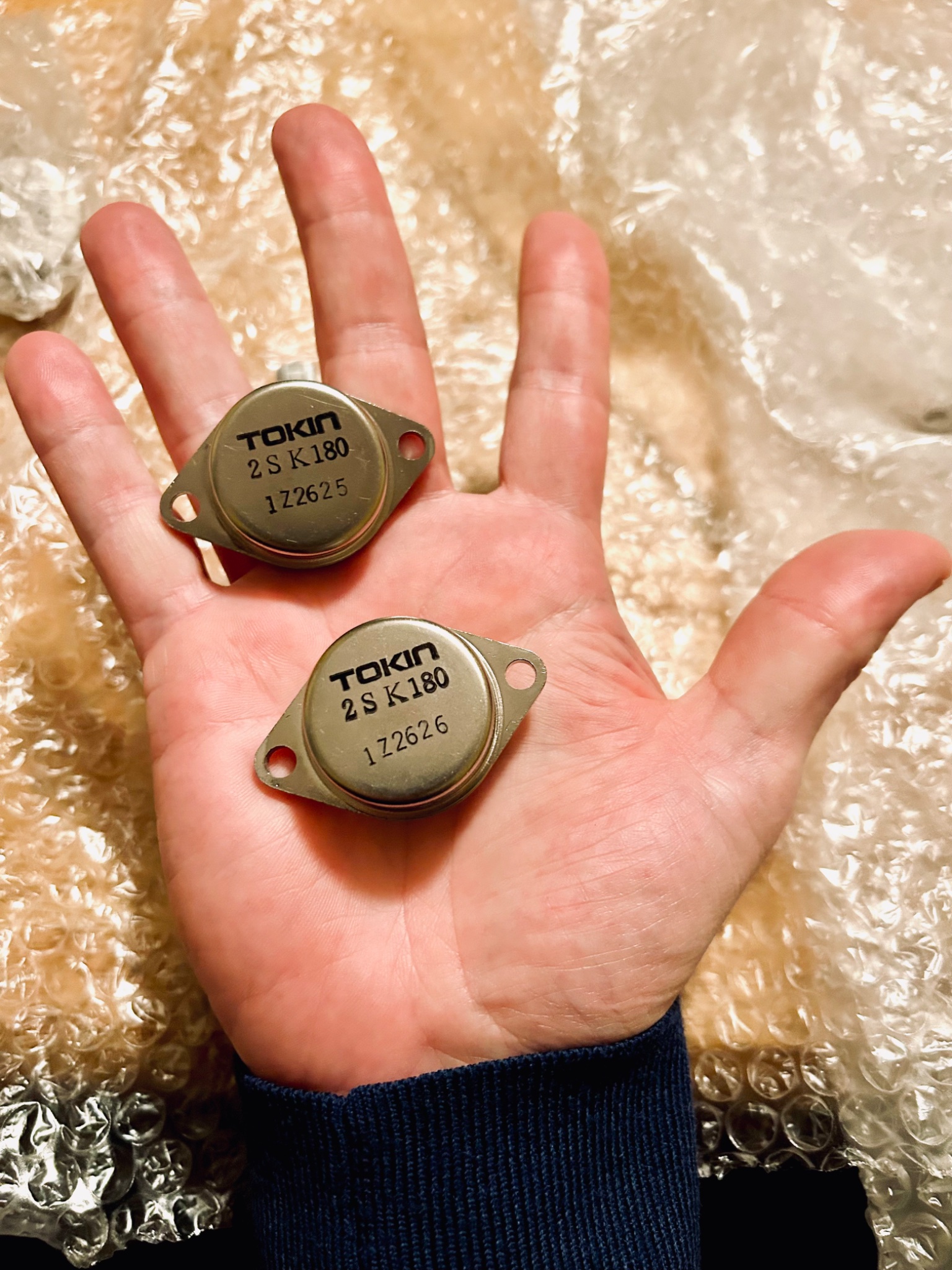

Does anyone have recent experiences purchasing 2SK182ES SITs. I previously (several years ago) purchased some from Wattenabe on EBay.
I just sent a message, we will see!I just bought two 2SK182ES from pras1170. I believe there are still some available. I ordered January 10 and they came in the mail today. Lunar New Year is coming up, so things will probably be slower.

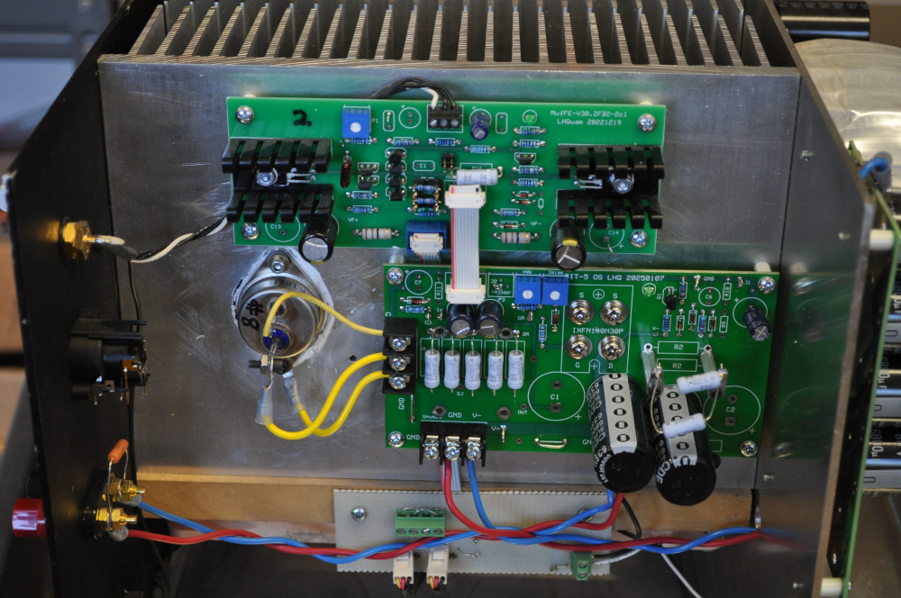

Up and running. Still might need some "tuning".
- First Watt SIT5
