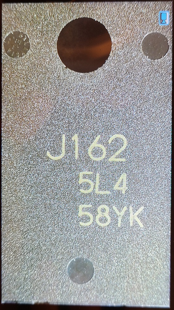

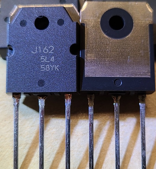

Renesas stopped manufacturing these a decade ago. The originals had batch and lot numbers marked on all three of the seals. As you can see only one seal is marked. The devices are freely available again, which means either factory reject pieces are being recycled into active distribution, or someone has purchased the assets and is continuing manufacture.
I have 20 pairs of these newer lots (with only one marked seal) with me, am plannign to put it on the rig soon. I have 3pair boards on standby for a "T" version of my derivative, and we'll see if these are any good. In single pair configuration they should present few issues.
I don't dispute that they do seem to be available from several sources but I found this image on Ebay that shows (at least an image) of a pair with all 3 seals marked
Ebay Renesas Laterals

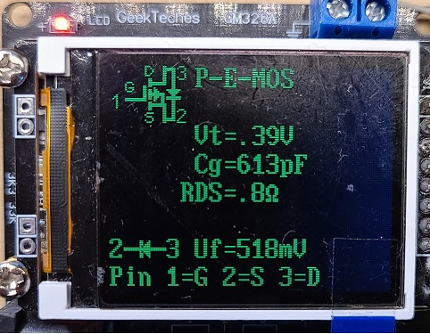

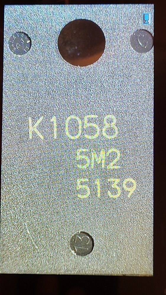

I took some pictures of my own devices and ran them through a component tester and have them in a running amp (sounds great too!). The J162 only has 1 seal marked - the one with the appropriate 'MALAYSIA' marking while the K1058 has all 3 marked. I rubbed the lettering with alcohol and a cotton swab and there is no colour bleeding or residue at all.
I haven't done any VGS testing but do not feel any need to pursue further as I am happy with the way they are performing, at least for now.

Yeah they looks like original. But ordered from China and there is no confidance that's original devices (and the marked seals are rubbed off with a finger, only the engraving remains). Maybe those are old batches, maybe new ones by original assets, maybe fakes. Who knows? 😉

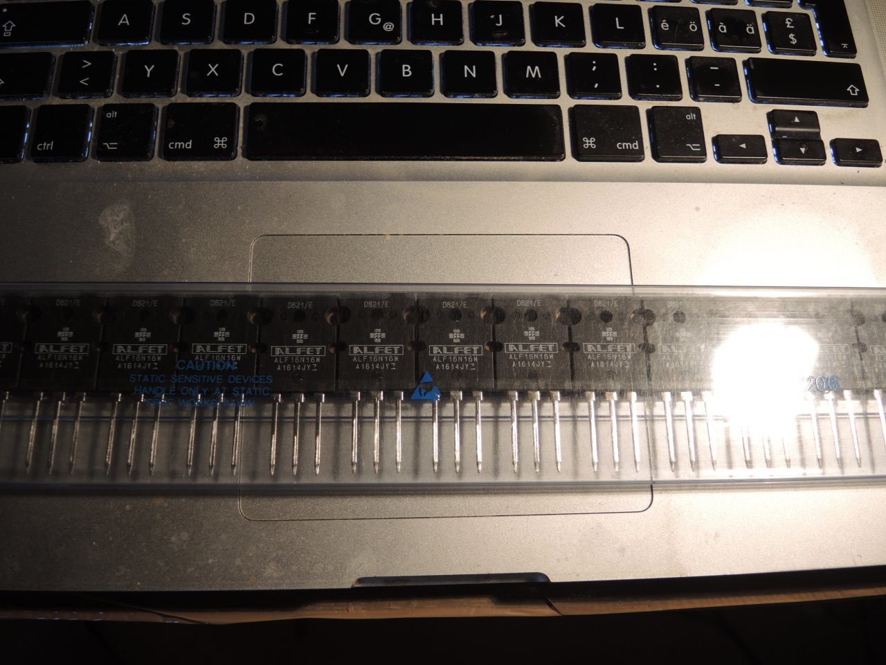

ALF16N16W ALF16P16W is still available of some Online trading sites, at least they say that these were in Stock.. Original Semelab if ALFET is Original Semelab.
I remember 2 years ago I ordered each something like 60 Pairs or more of both, and then tested to make a Single end Class A.. the sound was fantastic, a big CRACK and then All fireworks of Swiss-national Day, New Years Night Fireworks and smoke signals appeared on top of my workbench, after applying power..I think I burned at least 20 - 30 P channels and also as much N channels..this then told me, stick to what is sure, and that's why I never used Mosfet again. The leftovers are in a Box. Just took a look at the box how much are left, but actually have no intention to sell them. Just have to recognize that the ALF08P16V are missing..
Here some pics.. just checked,, missing more than half.. and If I remember right, I used each time 4 pieces while testing.. and not only one time.. LOL
Mosfet, is definately not my transistor..The P channels might are in an other box.
Please do not PM / No Sale.. the most I would do is to give them free to Mr. NP.. as back up but I think he has more than I do..May someday I will get smarter that I'm I now, and know how to create a non burning CLASS A Single END with Mosfets..
