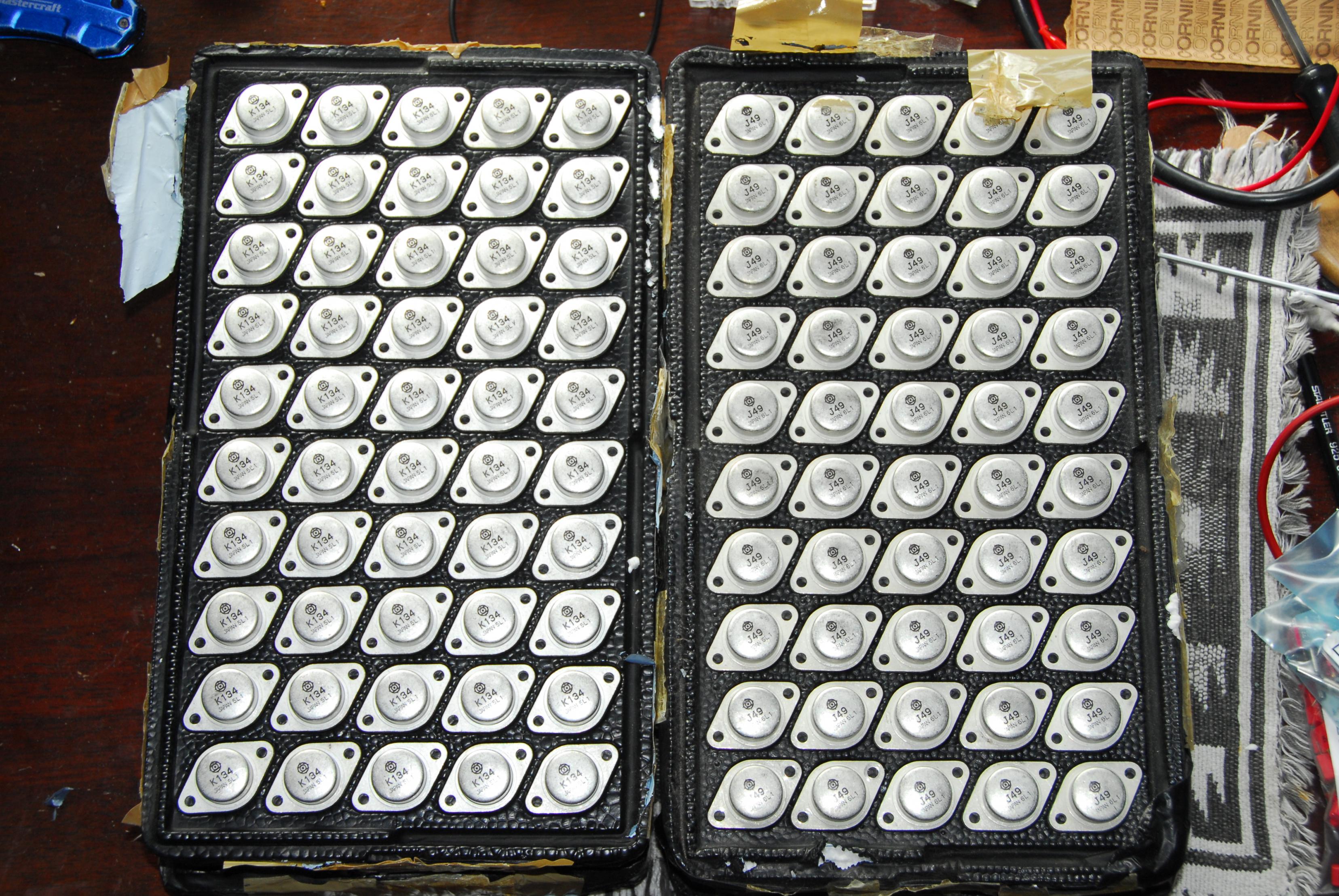

so , basically , any iteration of oldest and bloody popular Hitachi 2SJ50/2SK135 goodies
Getting to the party late, as usual, I am only up to page 30 of this thread...but based on your comment ZM, am I a lottery winner? I have had these since the late 80's when I was experimenting with MOSFET amps with 6DJ8 cascoded input tubes, cool amps, sounded pretty nice.
That's a really nice stash of old Hitachi lateral Mosfets. I have a smaller set that I've saved from re-building old Hafler DH-200 and DH-220 amplifiers. They are marked with the Hafler numeric codes for Vgs matching.
I still have 2 old DH-200s that need rebuilding and a good cleaning...maybe when I retire in 40 years. 😱
Sure glad I saved these Hitachi FETs, knew they would probably be useful one day. Now to compare the data sheets to the Alfets.

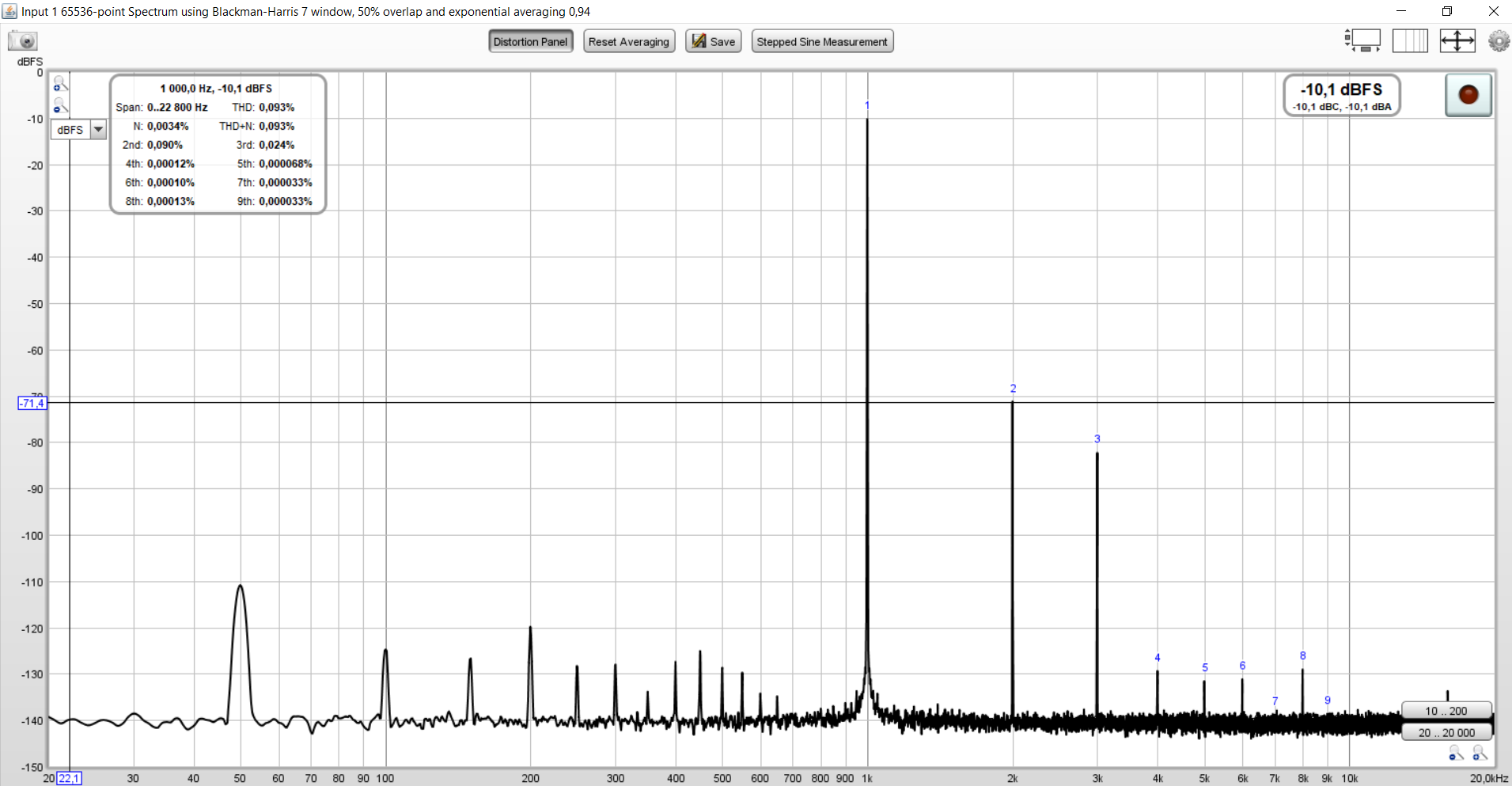

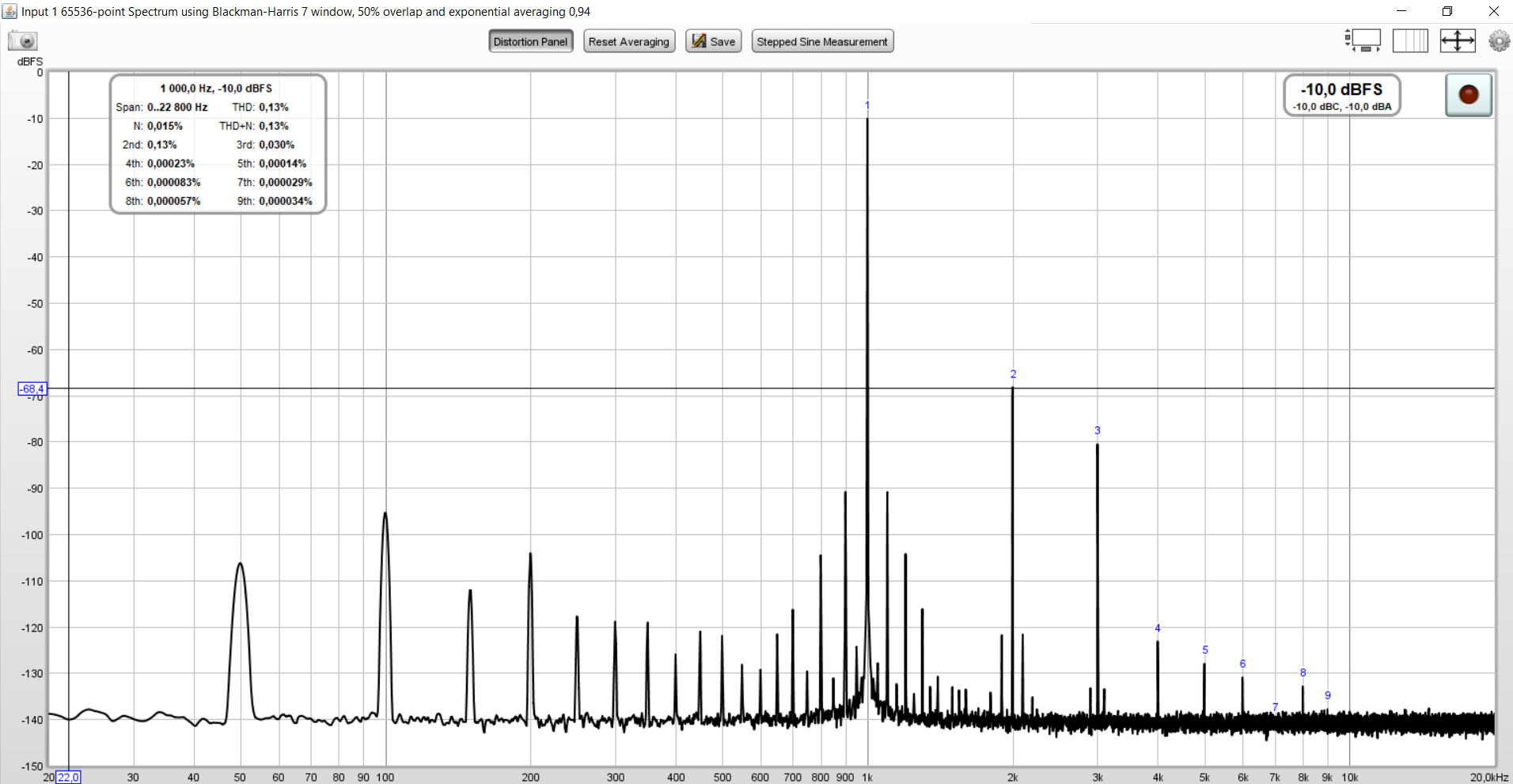

I report some of the findings from the F7 clone alpha test phase here...
All kinds of measurements and tweaks were performed on basis of what Patrick (EUVL) instructed me to do. The starting point was the F7 clone circuit fed with a regular FW type of CRC power supply with +-22Vdc rails and 1,3 A bias. See the first attachment, with H2=0,13% and H3=0,03% into 8 ohm. The H2 value was 2x higher than what was expected from the LTspice simulation but the ratio between H2/H3 was quite close.
Next we tried what happens if bias current is raised to 1,5A. Well, no effect on H2, only H3 dropped by tiny bit.

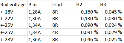

The third iteration round was to see what happens with higher rail voltages. So I fed the amp with my lab supply through the CRC supply with different rail voltages. The results can be seen in the second pic I attached. It was noted that with +-25Vdc rails the distortion lowered quite significantly for both H2 and H3, but with +-28Vdc H2 was further halved while H3 stayed the same. So if you have the sinks and your PSU is up for the task, higher rail voltages can be recommended.
The fourth and the last tweak was to implement a 10 ohm trimmer pot for adjusting the source resistance of the JFETs as described in post #1537 by avdesignguru. So I measured the trimmer beforehand for a few turns to both directions (clock wise and counter clock wise) and the soldered it in and did distortion measurement for each turn of the pot. Results can be seen in the third attachment. The results indicate that the pot had effect only for the second harmonic. This was a cool measurement to carry out as you could see the harmonics change while turning the pot. 🙂 The DC offsets were adjusted after each turn of the pot before measuring.
In the end the listening test was done with distortion adjusted to H2=0,065% / H3=0,030% with the trimmer and the amp fed with +-22Vdc rails from the CRC supply.

You have a fairly significant amount of mains harmonics in there. Did you try to narrow down if this is coming from your supplies or your test setup?
