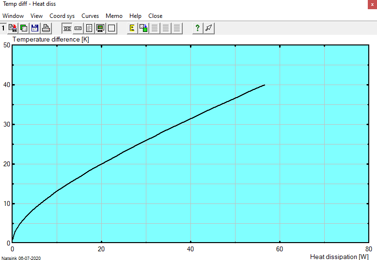

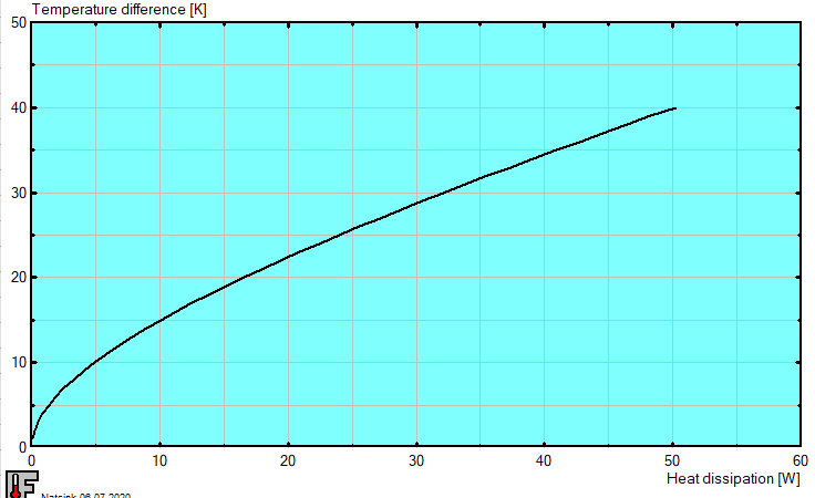

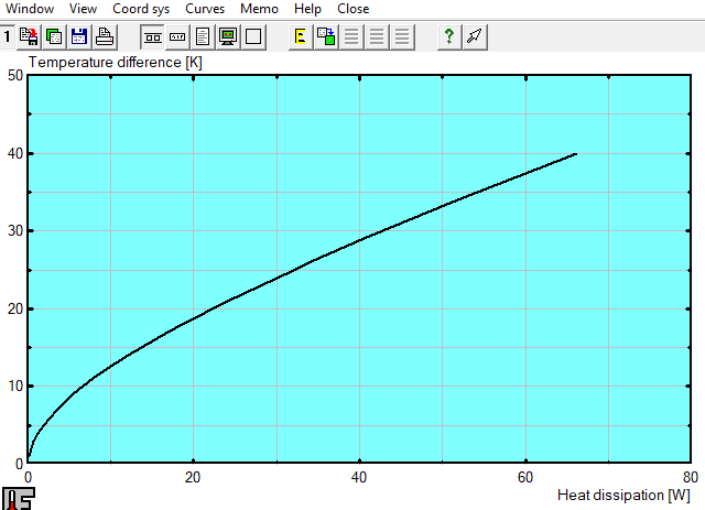

Thanks for your hands on experience here. The chassis I originally bought from EBay (China). I’ll probably be trying what I already have first. ZM thinks it’s sufficient, so will be a good place to start. After it’s built, and there are heat issues (and if I like the F7), I can move to a larger box to make it a Keeper.
Patrick
Thanks for the graphics Patrick. If the first graph (unlabeled) is for 300 x 50 x 90, it indeed looks better than the 3U 300 x 40 x 120 graph.

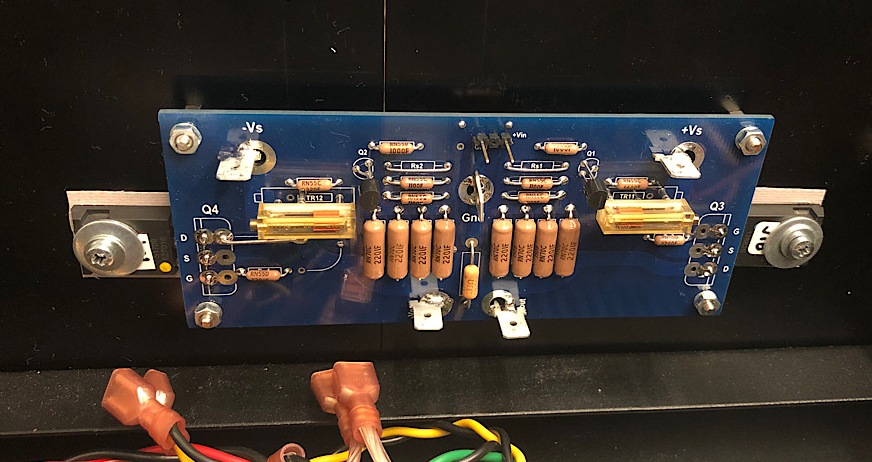

Some brave guy who built the UDNeSS wants to compare it to the F7.
So we modified the F5X PCB design for him for an alpha build.
Works first time. Very easy to adjust. Very stable thermally, as expected.
Note that :
1. Only thin-film metal-film resistors were used (Dale RN55, RN70, CPF2). No metal oxide.
2. All trim pot are to be replaced by fixed resistors once set up in final case.
PCB size 128x55mm. MOSFET mounting distance 160mm.
No need for long & thin.
Patrick
