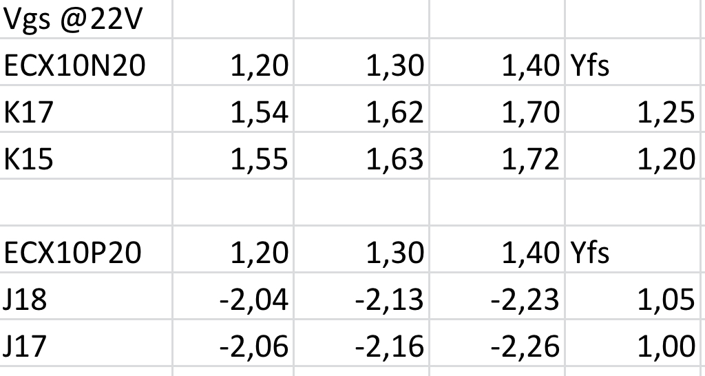

For reference... Did Morde's jfets have a difference close to 2ma Idss between the J74 and K170?
Idss values were 9,4/9,4mA for 2SK170 and 9,1/9,1mA for 2SJ74 with 22V feed. These were purchased from Punkydawgs.
For the Exicon lateral FETs See attached Vgs measurements at 1,2...1,4A and 22V rail voltage. This was done similarly to UDNeSS mosfet measurement in room temp with large fan cooled sink.

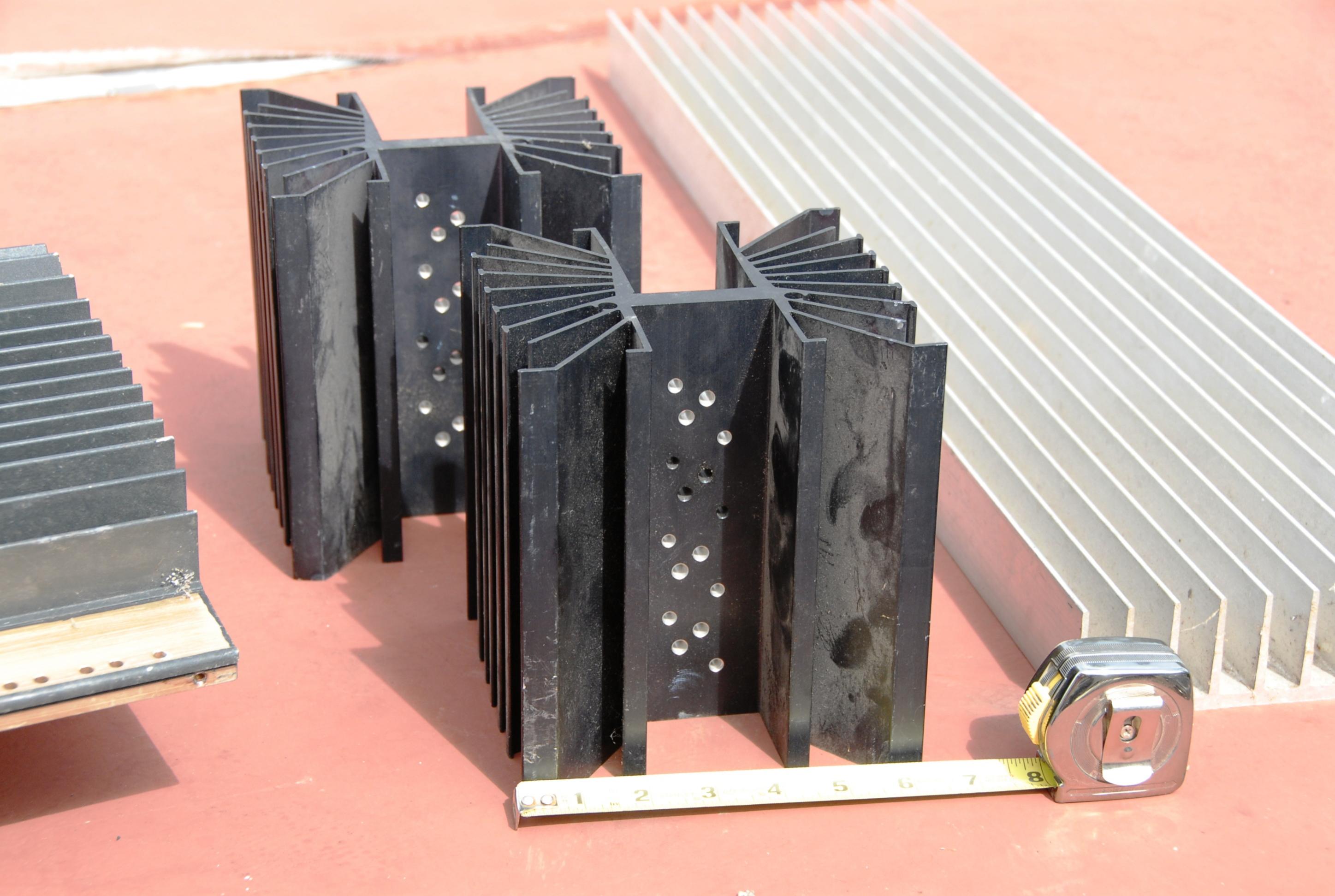

I finally have finished reading all 166 pages of this thread and am now gathering parts to build it. I have several options for chassis and heatsinks and am just wondering what the general consensus is on optimum rail voltage and bias current? I think I understand the various F7 iterations seem to like about 1A bias using the J162/K1058, but I am going to be using J49/K134. Anyone built one with the old Hiatchi FETs like mine?
If it really is only biased at 1A then I can use much smaller heatsinks than I originally planned and can save the big sinks for another project like SissySit, Turbo F5 etc. I have 2 very nice Star Wars type heatsinks, already drilled for TO-3s and would like to use them. They are 6.25"x6.25" and 7" tall, gives a rise of .254*C/W which would give a 20* rise above ambient with 80W dissipation per channel, and based on the F7 manual, it dissipates 160W for 2 channel. Given that 160W spec, and standard 24VDC rails, would lead me to think the bias in the real F7 is a bit higher than 1A, anyone concur or confirm?

I cannot confirm where Papa biases the real F7 outputs, but I have done all my testing at 24 volts/1.2 amps and things seem fine using the heatsinks in the DIY Store Dissipante 3U chassis. NB - I am using Exicon laterals in TO247 packages with Keratherm insulators, so your mileage will vary with your devices. I would suggest doing some thermal measurements, maybe with power resistors bolted to your heatsinks, or just go for it and vary the bias while monitoring the heat rise.
Thanks Boyz,
Sounds like the black Wakefield sinks will be just fine, they are extrusion 1541 or 486 for the precut version. Mine are 7" so must have been custom cut from the full length. So at that bias and rail V it will only dissipate 60W/channel. I wonder if the devices will be hot enough to "sound correct"? I would imagine that the temp of the die might have an effect on the sound. I'll also look to see where it puts the devices in their tempco curve.
Yes, pretty easy to mockup a test platform to confirm temp and dissipation.

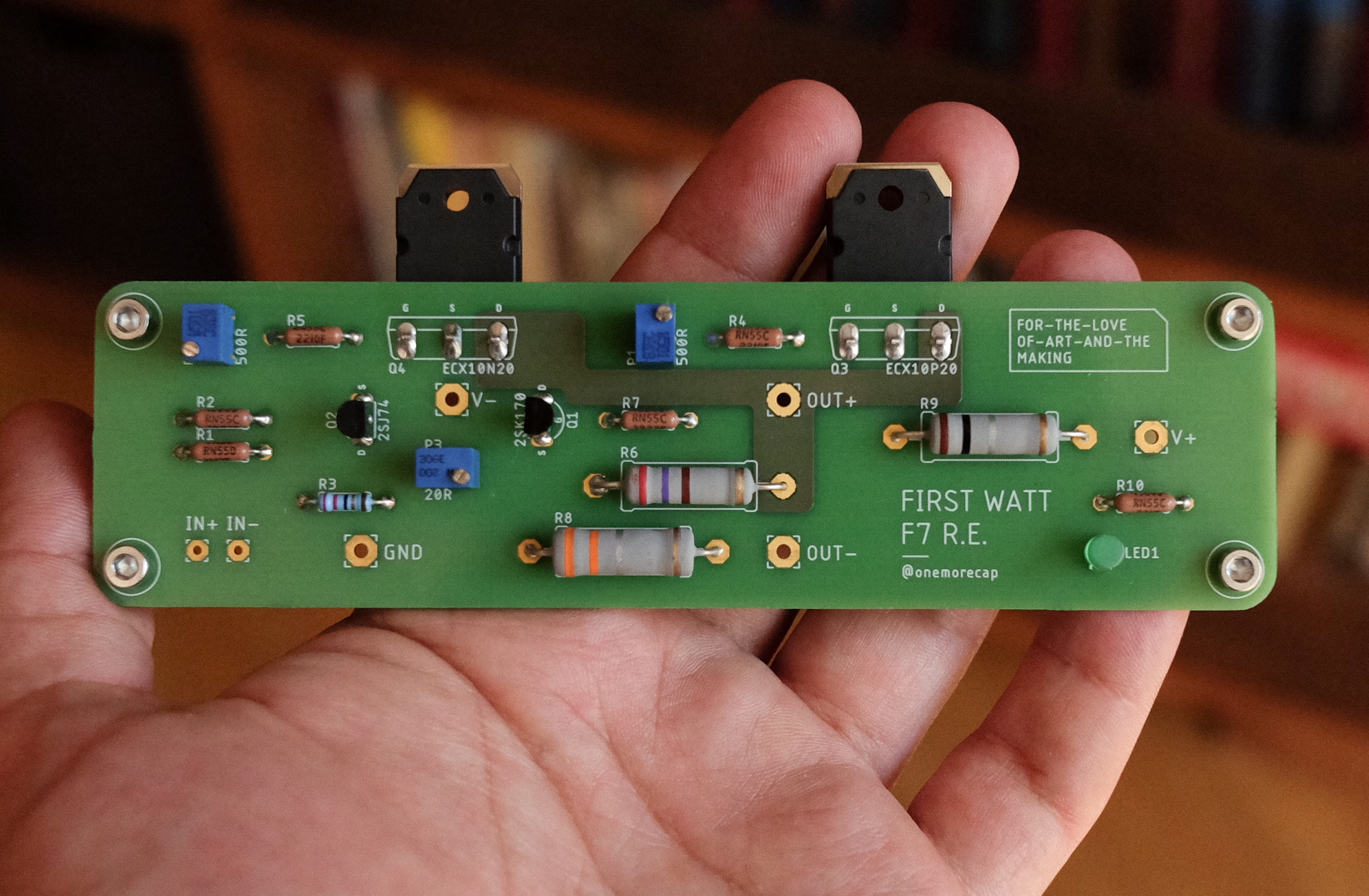

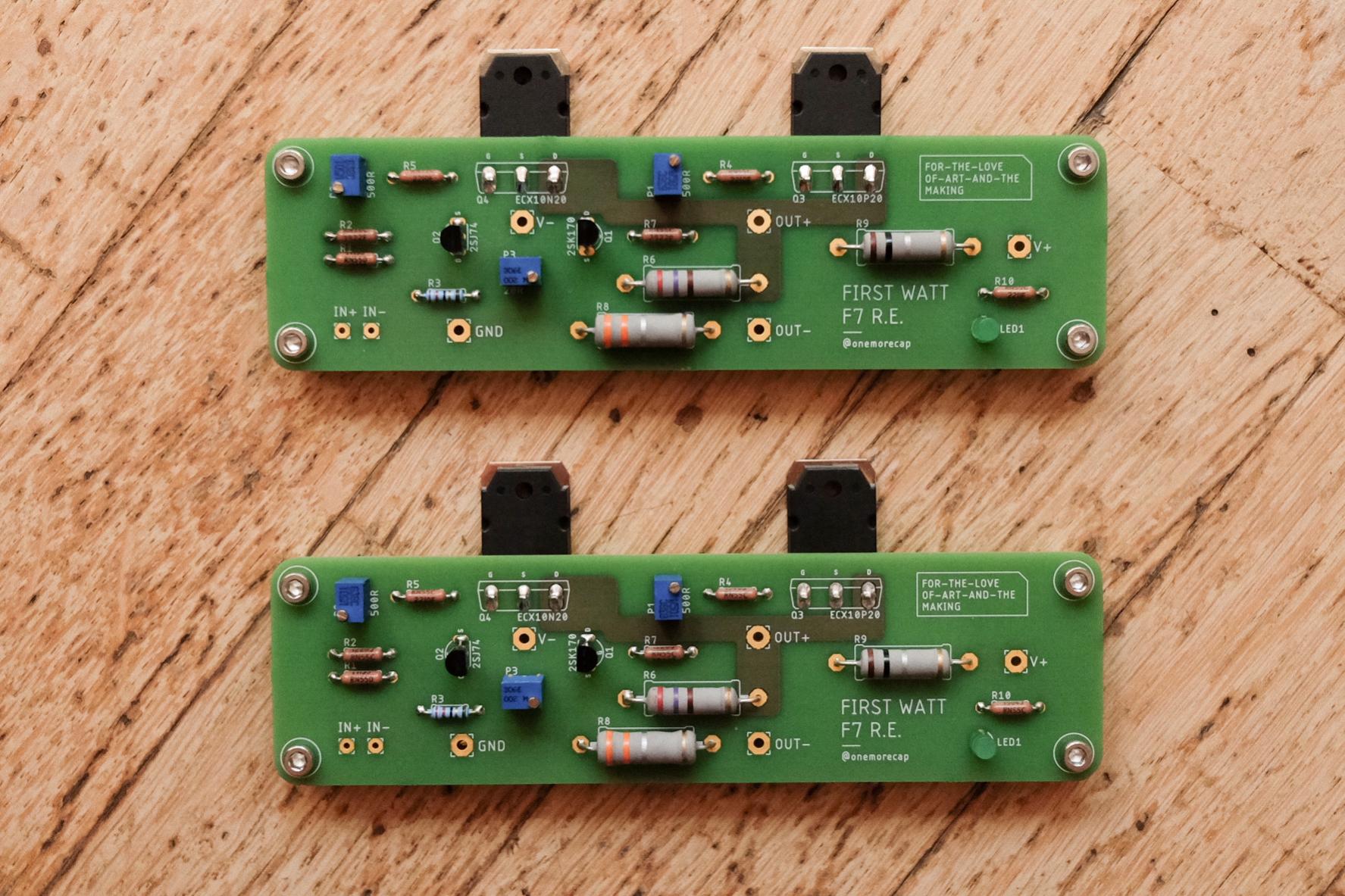

Back in the days I've completed my ACA and F5 projects and was searching for a new one. F7 instantly caught my eye by its simplicity. In my day time job "less is more" my main principle. I must give a try to this project. Even there is no schematics, even I have absolutely no knowledge, just a passion.
So I've read all the 150 pages, save every potential schematic and photo of F7, read about PCF, and start to figure out. Of course, I installed LTSpice for the first time (oh it takes time to become friends with this software), find all the models, and got lots of fun during the simulations
Here I want to thank Mr. Nelson by letting guys like me educate myself in such a joyful way. It was pure pleasure and It was a way more helpful than having a schematic on hands.
I've already started up my boards, tweaked up the bias, and played a bit with harmonic pot. Seems like everything is ok. In a couple of weeks I'll have time to come back, boot two boards and set it up. More to come.
