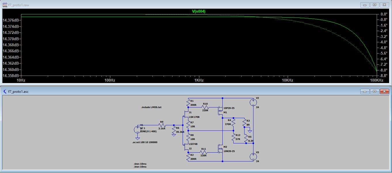

Thanks for the valuable info. So I tried 3 rd variation in post 442.
8R load 14.37dB
2R load 14.19dB
The difference is 0.18dB is that fine ?.
what would be the advantage of this ground arrangement?
