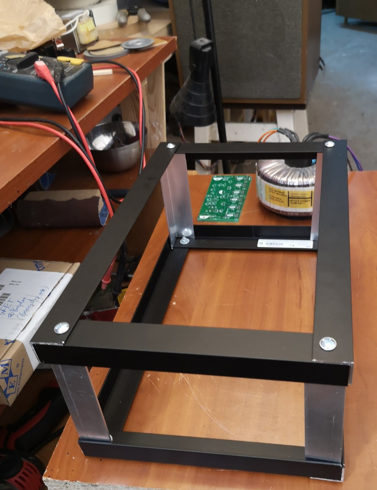

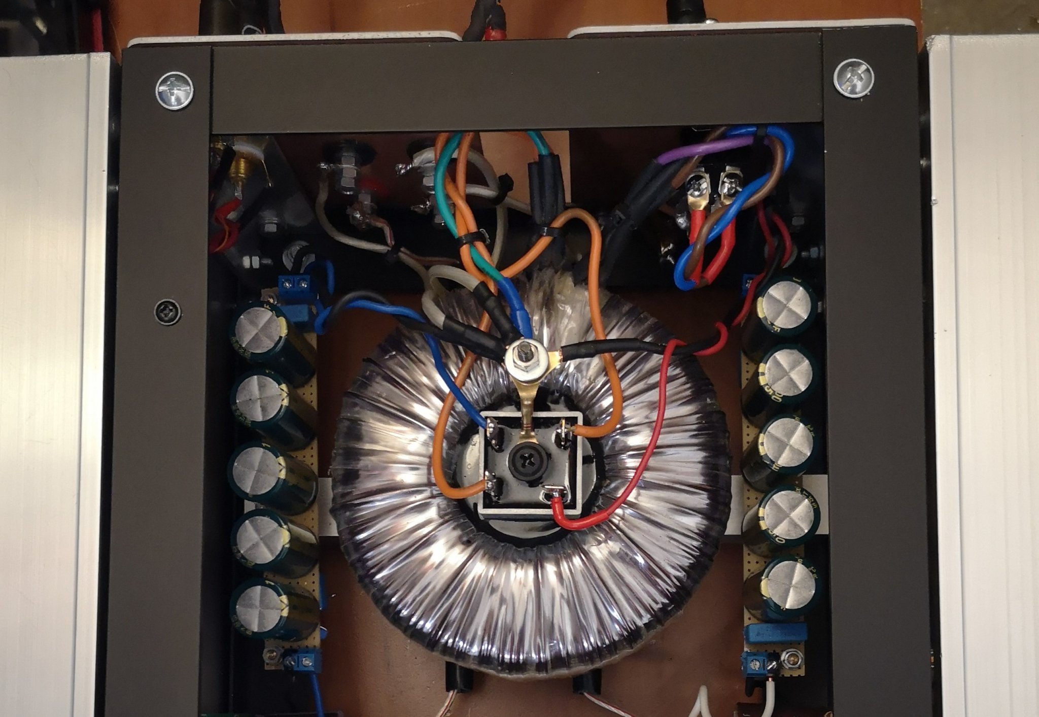

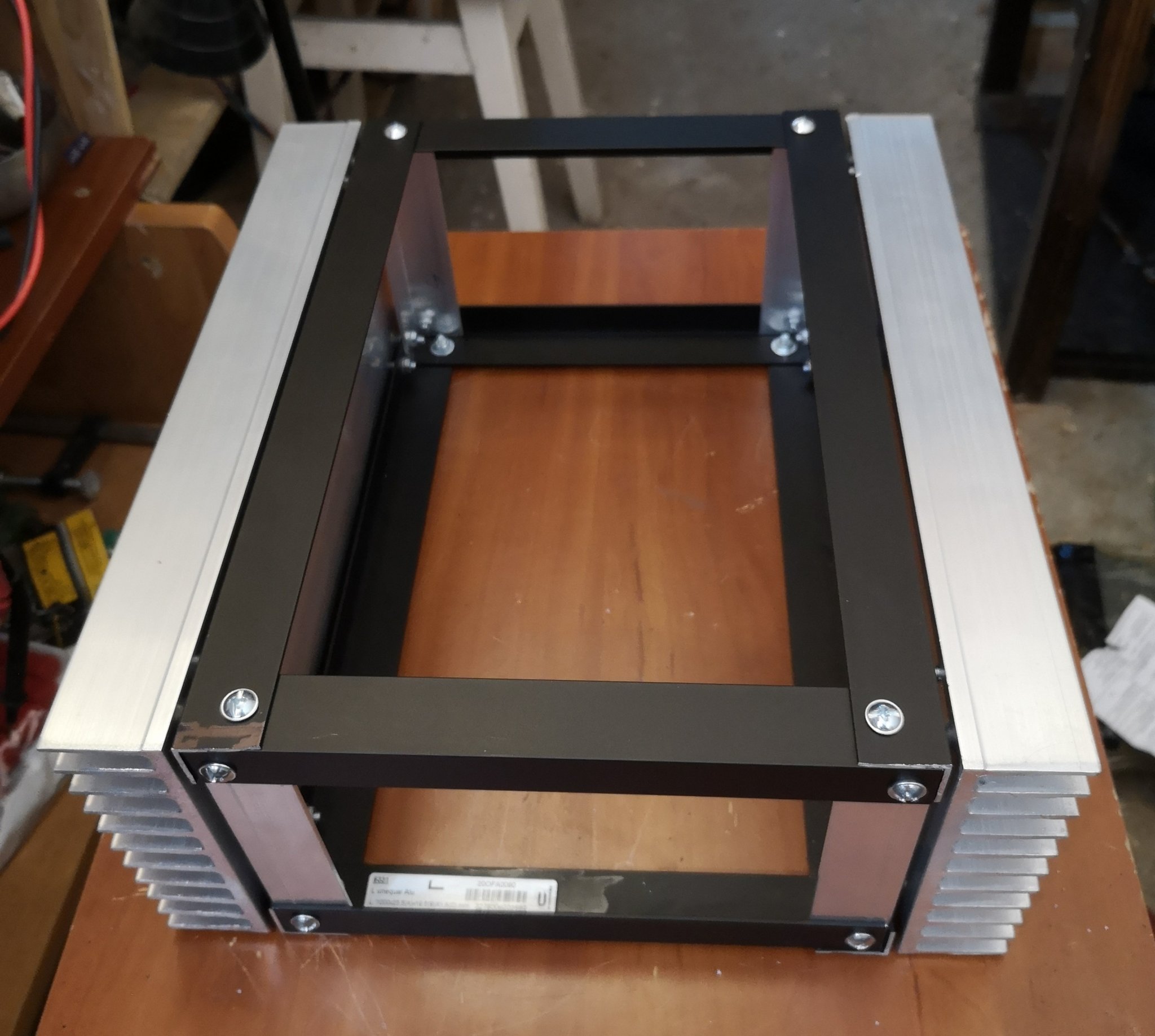

I started working on the First Watt F7 clone amplifier at the beginning of August this year. I made a supporting structure of aluminum elements measuring 31 cm x 22 cm x 12 cm.

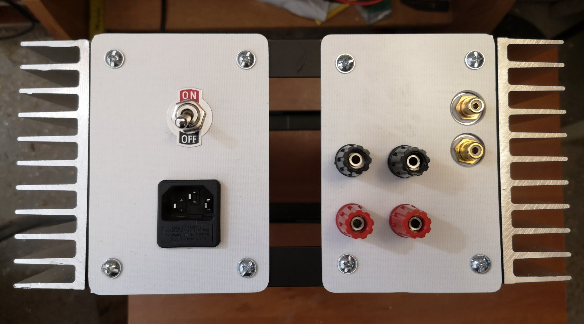

I installed heat sinks on the sides of the frame.
Hacksaw, saw blade with fork, file and electric drill - my faithful helpers.

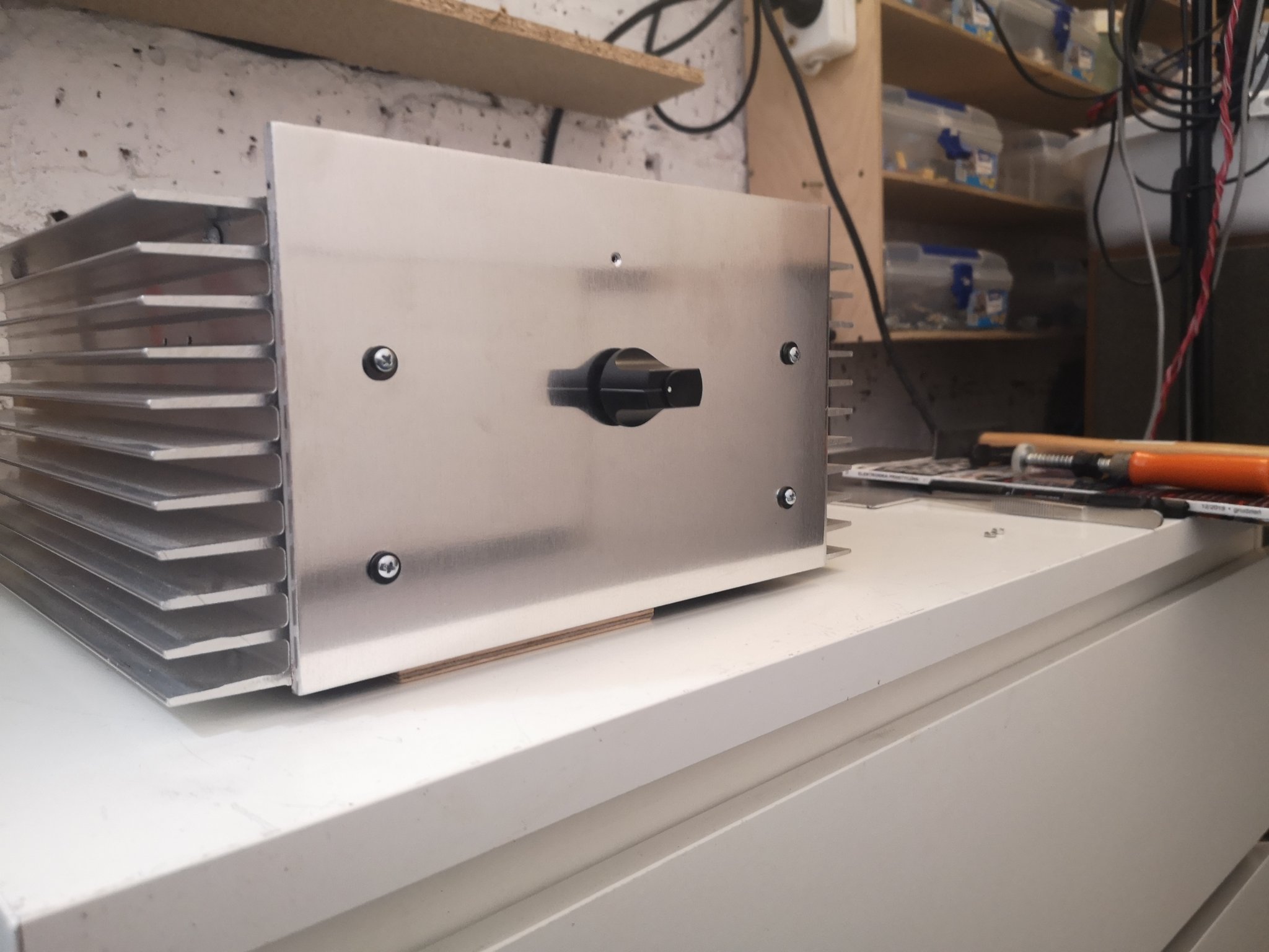

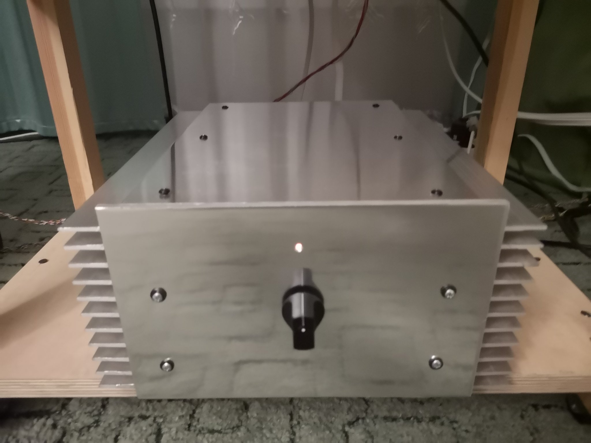

I made the F7 clone out of curiosity, wanted to check out all those good F7 reviews?
I was very impressed by the fact that after listening to the F7, many declared users of tube amplifiers started listening to music on the F7!
I will not elaborate on it, I will say briefly that I am also one of those people who, after listening to music on the F7 for the first time, cannot imagine listening to other amplifiers, even tube amplifiers!

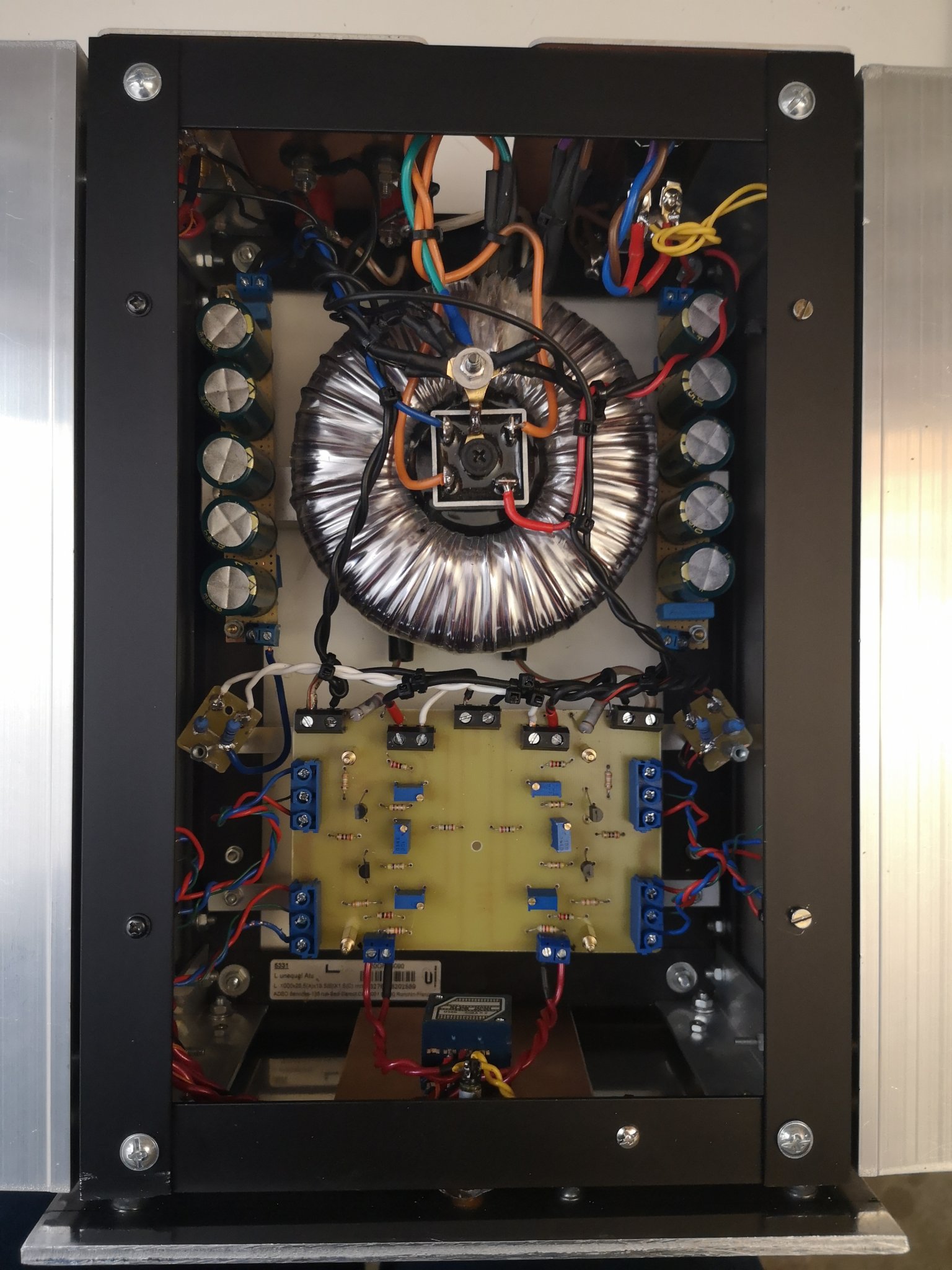

how did you set up the 3 pots to achieve the desired H2 negative spectrum?
any special distortion meter?
I only measured the currents flowing through the power transistors and the dc offset at the speaker output with an 8R resistor. My ears fell in love with the sound of the F7 amplifier right away 🙂 The wonderful lightness of the brain decoding the acoustic signals generated by the speaker diaphragm driven by the F7 amplifier!
