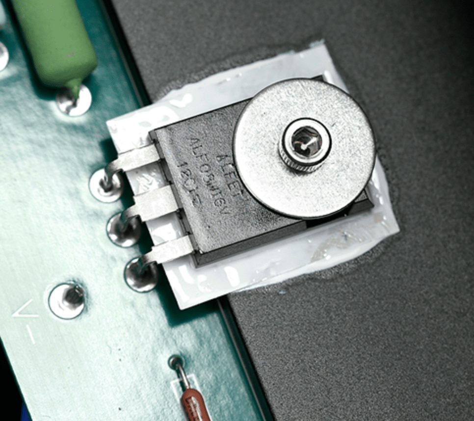

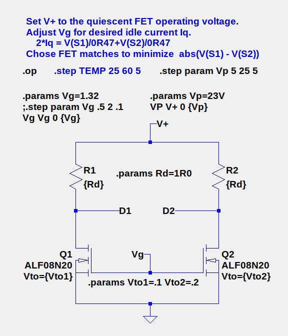

I ran bench tests matching pairs of ALF08N16 and pairs of ALF08P16 later FETs.

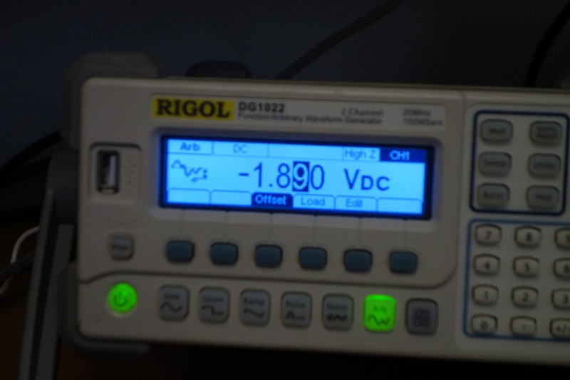

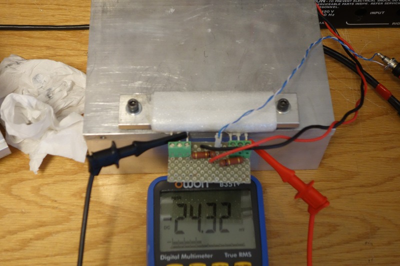

Show below are images of the lest circuit and images of the test rig where the FETs are clamped to a heatsink, power is from a bench supply, and gate voltage is from a waveform generator with adjustable DC output.
The first pair of ALF08N16 had only 25mA difference in drain current at Vds=23V and Id=600mA (for combined 1.2A current).
I tested only one pair of ALF08P16 FETs and obtained 80mA difference in drain current at Vds=-23V and Id=-600mA.
Conclusion: It appears easy to find pairs of these lateral FETs without current hogging problems.

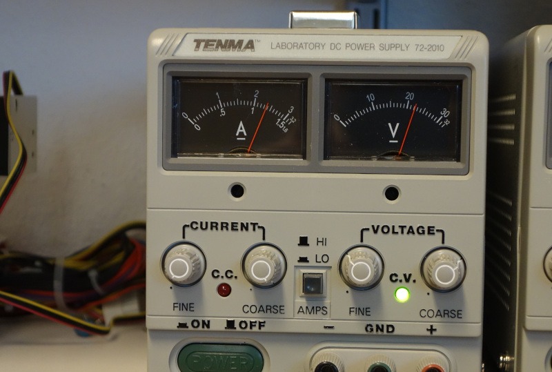

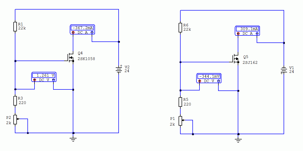

Two MOSFETs with same Vgs at the same Id and same Vds make matched pair. So, measuring them is the only way to tell ...
Put MOSFETs on the heatsink, start with the lowest resistance of the pots and set the them so that A-meter shows 1A and read the Vgs, Write it down, mark the MOSFET and measure the next one. Don't mix up the polarity of MOSFETs,

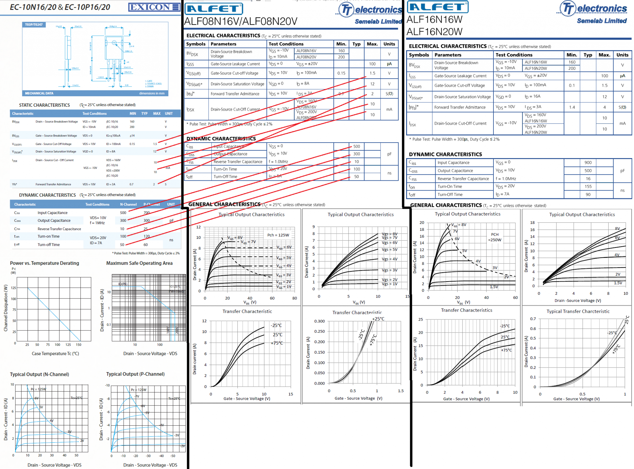

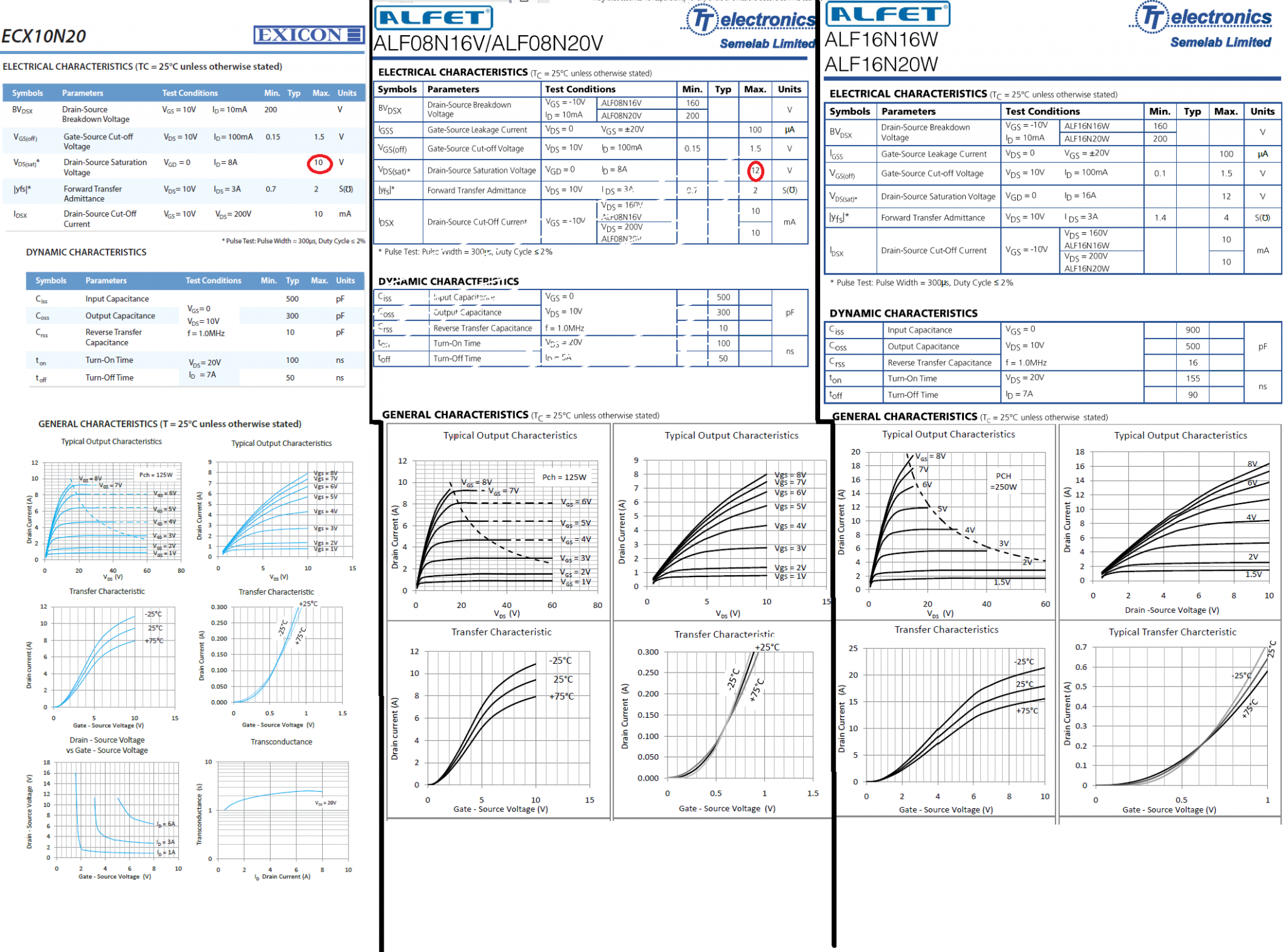

Looks the same to me, so I don't see why the rail voltage should be +32V instead of +24V for Exicon.ECX series from Exicon don't have the same dynamic range as 2SK1058 and 2SJ162. You have to use +32V rails or use the ECW series from Exicon they are better. I use ECW with 32V rails and they sound excellent.
Jfets don't have to be matched. Use J74 with Idss 3ma higher then K170
For gate resistors 47R is enough.
My F7 emulation with ECX10N20 and ECX10P20 delievers comparable results.

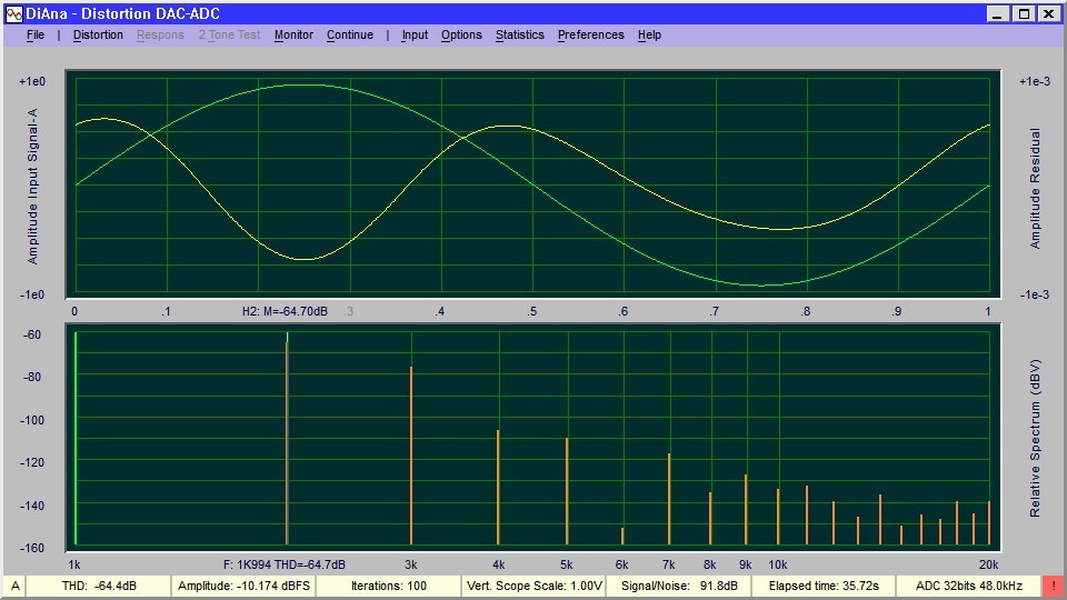

However some measurements are different from original specification, such as damping factor, which is about 20 only. I believe the cause lies in the power mosftes.
There are visible intermodulation products, so I was afraid to measure the IM factor.
The negative phase of H2 looks like in the picture book, but like I said in the beginning, this is just my emulation.

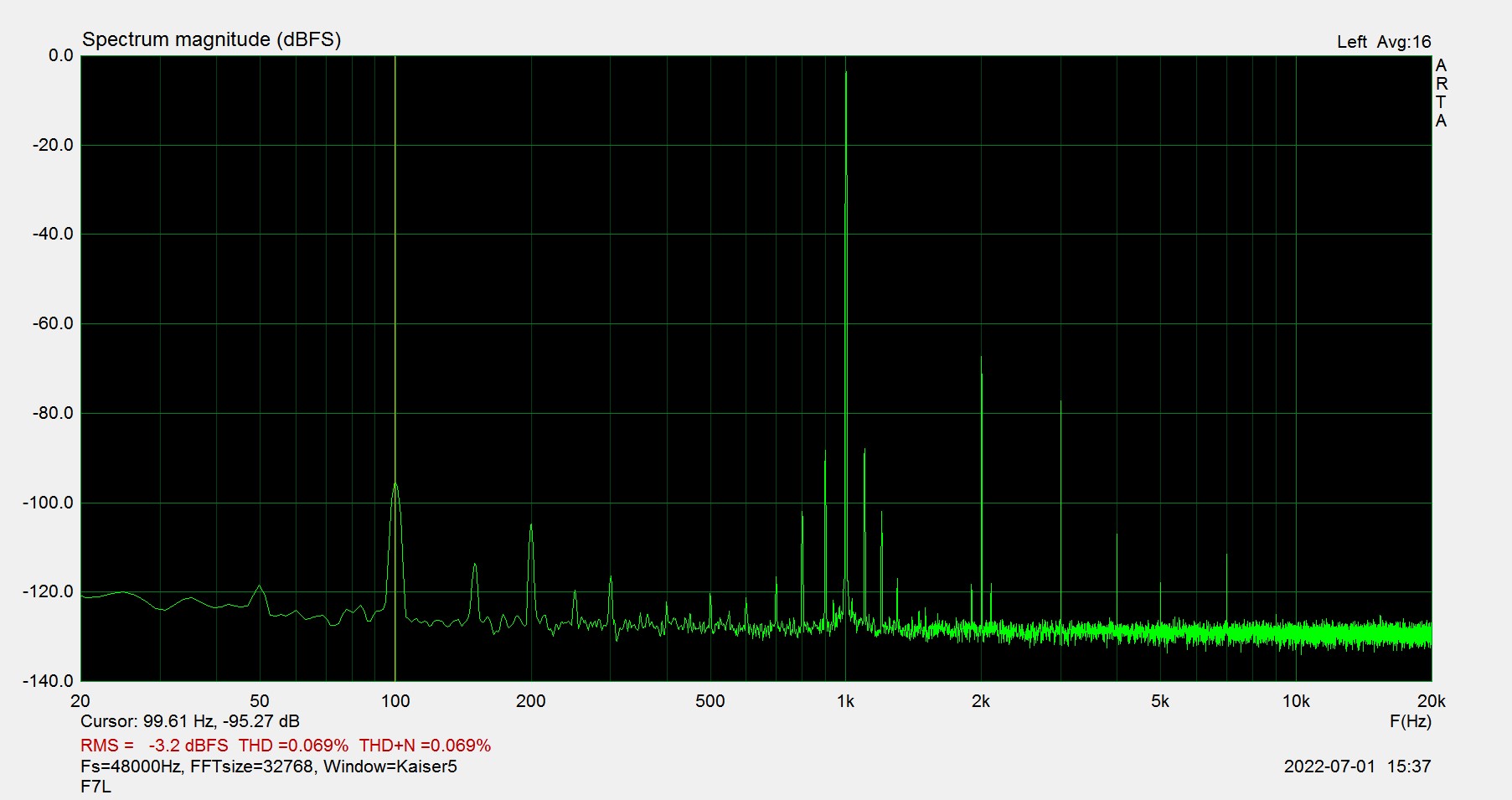

What did you emulate, if I dare to ask the question?My F7 emulation with ECX10N20 and ECX10P20 delievers comparable results.
