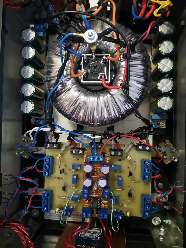

Hi @janf.The power supply includes a 200VA transformer 18Vac-0-18Vac, a rectifier bridge and two 5 x 15mF = 75mF electrolytic capacitor banks. The electric mass is run in a star topology. Guess where the focal point of the electric mass is?
6moons review photos I believe showed the PSU with 6x15mF capacitors in each bank. Can I ask why you used 5x15mF?
The size of the capacitance of electrolytic capacitors results from the current supplied by the power supply to the amplifier.
I assumed a small bias of 0.5A to 0.8A. Regards, Jan

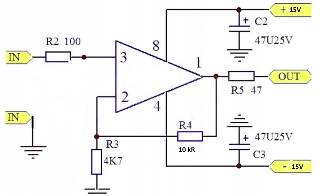

The problem of the necessary amplitude of 2.7 Vac to fully drive F7 was solved by inserting an additional gain stage on operational amplifiers (I used MUSES01, MUSES8820).
I enclose a diagram of this additional circuit k = 3.
Measuring the power of the amplifier on the full signal gave the values 23W at 8.6R and 45W at 4.4R, in both cases the amplitude of the signal at the output was 14.2Vac.

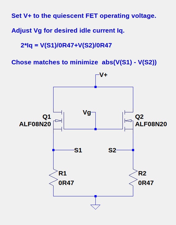

Having built several F7 clone amplifiers using the ALF08x16 lateral FETs I finally got around to modifying one of those amps to use the ALF16x16 FETs. Only one resistor was changed, but of course the pots needed adjustment. The resistor change was calculated based on the FET transconductances using the equations supplied in post #442 https://www.diyaudio.com/community/threads/first-watt-f7-review.275921/post-4585617.
I found that the increased transconductance of the ALF16x16 FETs make a noticeable improvement to the sound. With the larger TO-264 footprint they could be run at higher voltage and idle current.
I intend to see if I can match pairs of ALF08x16 FETs without current hogging problems to get the same results.
I haven't made the measurements yet. Here is the test rig I intend for matching:They have negative tempco.
So you can even parallel without source resistors.
Patrick
Unless you want to use source degen, which will reduce gm significantly,
I would move the 2 resistors to the Drains.
Patrick
Patrick
You are right. I was just making that change to the test rig schematic.Unless you want to use source degen, which will reduce gm significantly,
Patrick
Not only would the gm be decreased, but in the actual amplifier source degeneration would increase higher order harmonics relative to H2 and H3.
