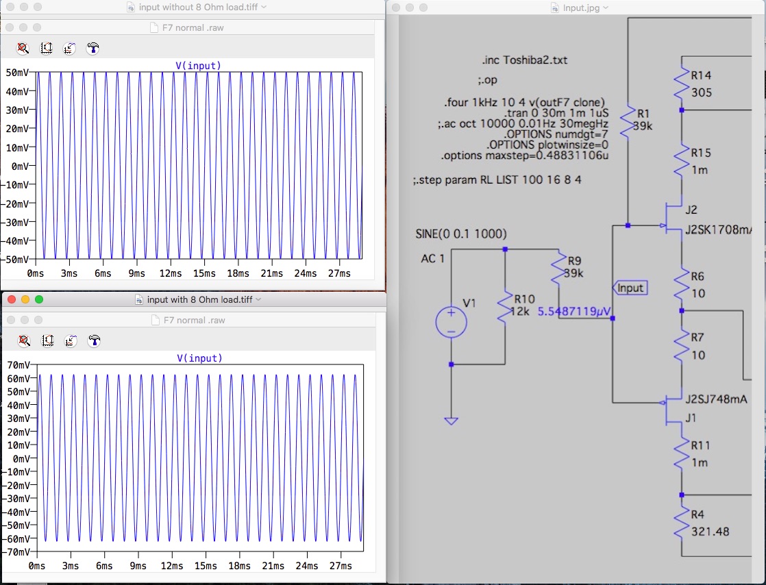

In my Spice try I had to choose for the sense resistor a value around 0R6 to get the right pos feedback.
But in my Spice work no ALFS, but SJ162 and SK1058.
The voltage value with an 8 Ohm load has to be 1.26x bigger than the value without the 8 Ohm load.
I don't quite follow the 1.26x value from no load to full load. The closer the 2 values are to each other the higher the damping factor. At 1.26x the damping factor is 3.84,output z is 2 ohms. Nelson's F7 output z is 0.08 ohms for a damping factor of 100. Your pcf resistor is too big.Try your spice models again with lower value resistors till you get close ie. load and no load voltages almost equal.I am using models for exicon equivalents that were generated by St.Andrews( Scotland) engineering dept.
Actually, that won't work. If 2 dB is all it takes to make for an inifinite
damping factor, then you will measure exactly the same output voltage with
and without the load.
Where you measure the difference is at the Gate of the input Jfet with and
without load, or you can easily calculate it from the resistive network which is
comprised of the sense resistor and the divider made by the to input resistors.
Aha!
So I misunderstood your comment in the other thread.
Thanks for correcting this, before all try it the wrong way.
I will return to Spice and try to see it in the new way.
And thanks Oreo382 too!

Here you see left upper diagram the input voltage without load, so that PFB is deactivated 50mV
and you see left lower diagram the input voltage with 8 Ohm load, PFB activated.
Ratio 62.3/50 =1.24x = 1.9dB
Thanks Mr. Pass!
