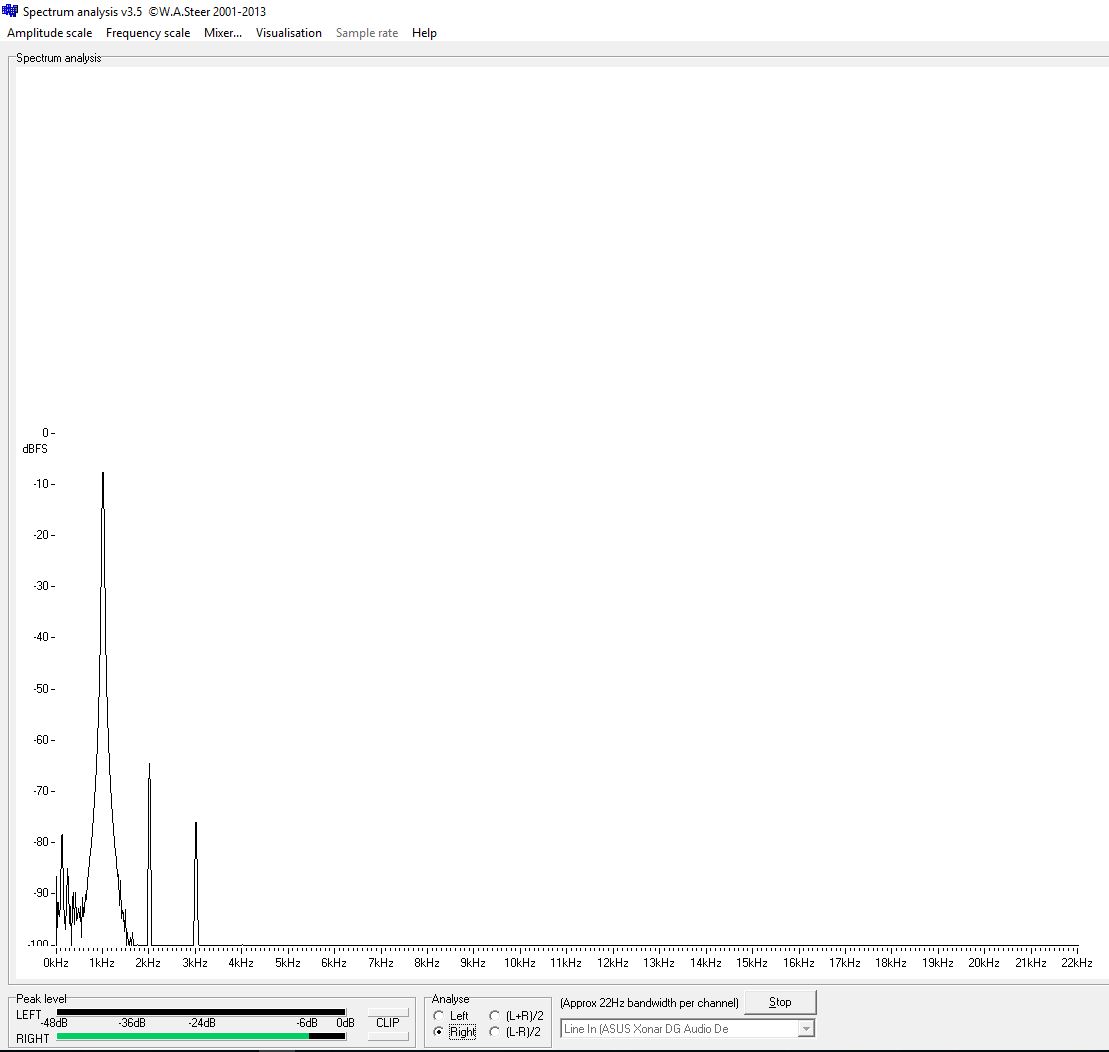

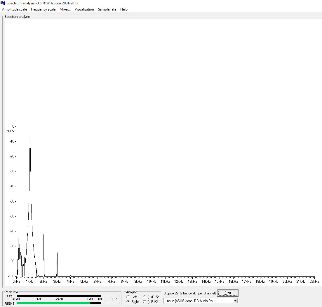

Hey Everybody, (a la Dr. Nick 😉 )
Couple of observational things.
First, you don't have to do this, but you might want to match the P3 pots that adjust H2 and H3. (You might not even use a P3.) This might be especially true if you are not using a FFT right away and plan on centering the pots on both channels. I did not match them and then ran FFT analysis and found enough variation to affect the sound. Pots are off by almost a couple of ohms. I mean it could all be in my head, but I think I hear a shift in frequencies between channels. I think it sounds OK, but there's a strange shift in frequency balance or depth and width. Like one channel if projected more forward than the other.
The thing I haven't done yet is setup the bias and offset of the amp while watching the FFT.
Also think the choice of preamp will have an affect on sound with this amp. The power amp itself is like a lie detector for the front end, much like the F5.
So maybe anything you use on the frontend will show it's goods. So far tried BA3-Pre and B1 v1. Will later try BOZ-J.
That's my two cents.
Vince

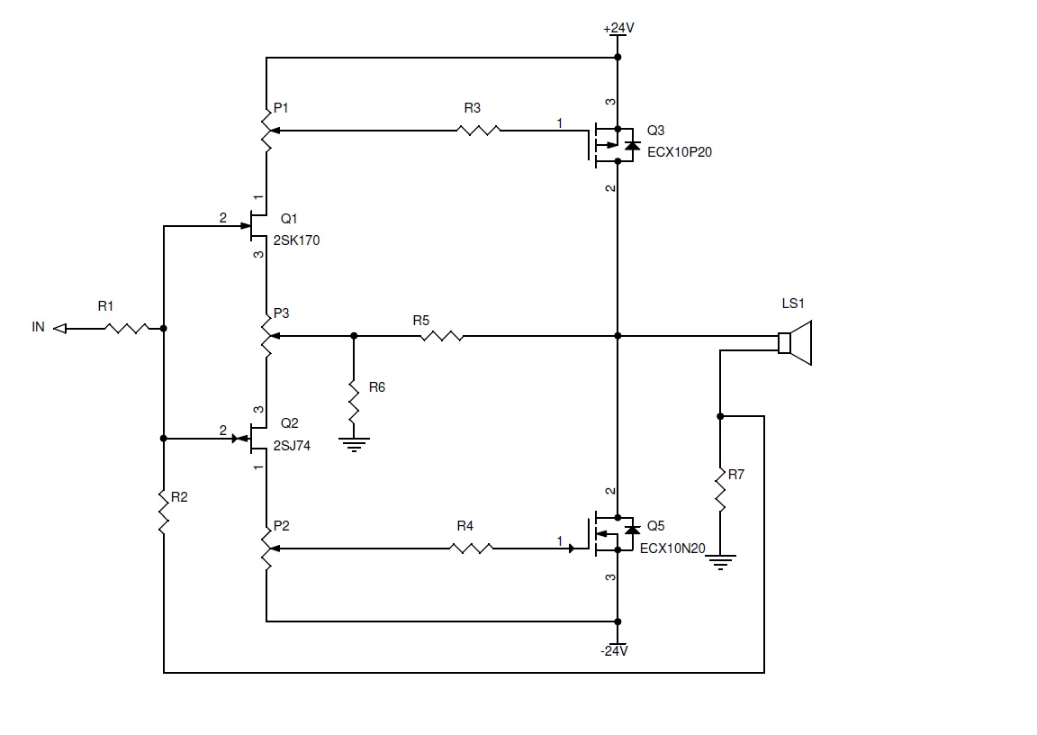

F7 Schematic
Guys is not rocket science. F7 is an F5 with negative feedback like F6 and added positive feedback. Some people did an F6 with PFC and worked nicely.
See attached. My schematic has 7 resistors but I know Nelson used 8. I can't figure it out where he put the 8th one.

On the positive rail.
Looking at the F7 picture I can see it. I wonder why he did that?

That's a way to do it.
My dream F7 has sense before the loudspeaker and a pot to fine tune the PCF . Shame I cannot find a way to make it... yet[emoji2]
Will continue to hit my head on the wall but if somebody knows for sure that it can't be done please tell me. It will save me a few hours of sleep [emoji4]
Sensing resistor before the speaker is wrong. It has to be connected to ground like in my schematic, is the only way.

I have done this but sense is after speaker load.
