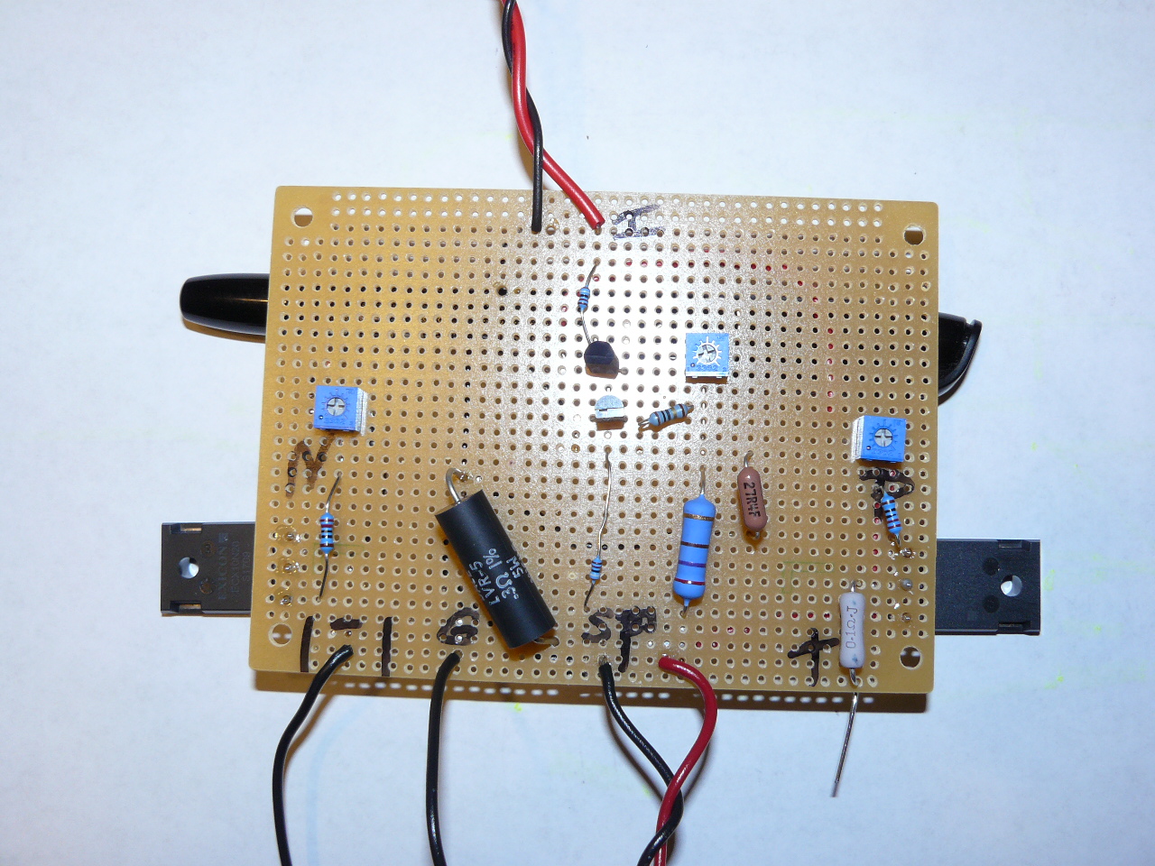

I tried my hand building a "try to duplicate" F7 clone based on Ihquam's type #2. This would not have been possible without the help of a fellow member who filled in the values being that I am only a solder slinger. The sound was fantastic after some listening yesterday.
Nice progress. Still tho a perf board assly without heatsinks and only One channel doesn't read as giving reassuring Sound quality judgements.
Not saying that it ain't exquisite.
Just wondering ...How ? can you tell.
OR? is that merely some in process piccie
It was installed on a heatsink before firing up along with the other channel. Picture was taken before being installed on heatsinks. The heatsinks have been installed in wood box with PS section that I call my test chassis. If I cannot live without a build I take the heatsinks from the box and build a proper case and PS section. This may be one of those builds. It is that good.
I have since had reservations about picture and have asked to have it removed since the F7 is a commercial product being sold but as it is not built from an official schematic I did not think Nelson would mind. And since I have not shown the underside I thought it would not hurt posting a picture.
I can say this try at duplication of a F7 sounds mighty fine in the lines of the V-fet but this statement is only from memory. I have not done an A/B comparison as yet. I can say that this build had some of the best square waves between 20 and 20K hz of any of my builds. I am very satisfied with the results. None of this could have been possible without Nelson revealing the concept of improving the F5 with fewer parts using lateral mosfets and employing PCF. I do not believe he will object with a solder slinger giving it a go. I bought ECX10 laterals being that the ALF's are no longer available.
