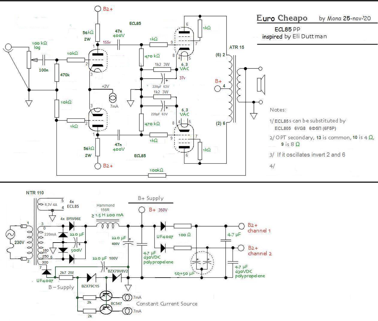

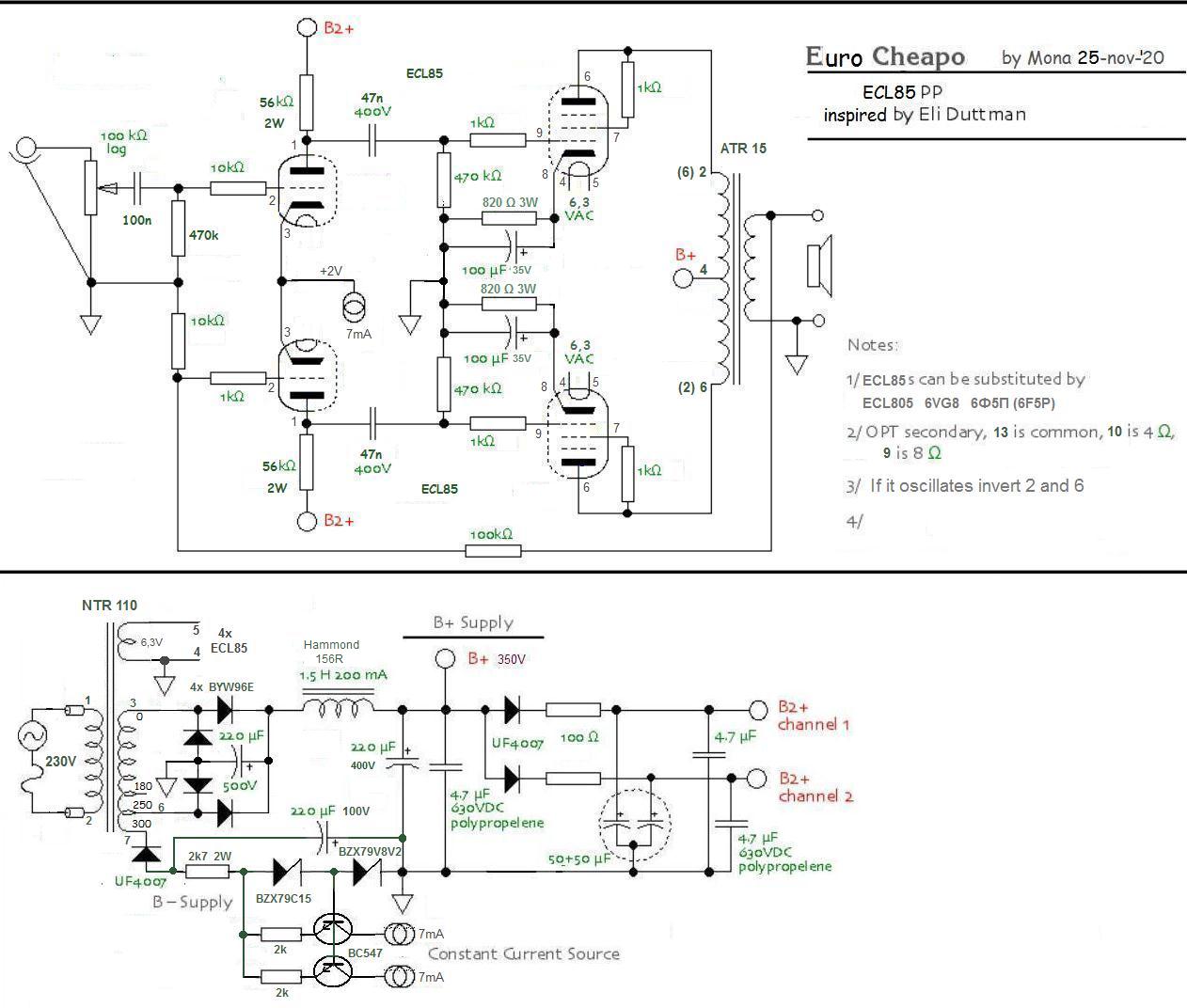

How about a European version with iron you can find more easy over here ?
The power transfo NTR110 goes for 40€ and the OPT ATR15 63€ for two.
Mona
Very El Cheapo european solution. Nice.
Can you give any comment about the quality, especially of the OT? It seems good OT's are important and I'm willing to to spend some more where it matters.
If you want cheap the quality is not the top.They are German made, one can hope they didn't make a mess of it ;) .
Could you also elaborate a bit about the circuit changes you made? Why did you do them?
With another supply transformer the circuit had to be adapted.After the rectifier nothing changed.The negative supply can come from the same transformer now and a more simple current source, constant voltage over the emitter resistor gives a constant current through the transistor.
The ECL85 resembles very much the 6AQ5 and 12AT7, no change there exept the decoupling and value of the cathode resistors of the output stage.
The value change is for a little less Pa, perhaps not needed but why push it.
And I don't like the common cathode resistor.If one tube starts pulling more current the cathode voltage goes up resulting in more negative Vgk for the other tube.With the more negative grid the current goes down making the unbalance even greater.
For the rest I changed some values more to my taste and higher input resistance.
Mona

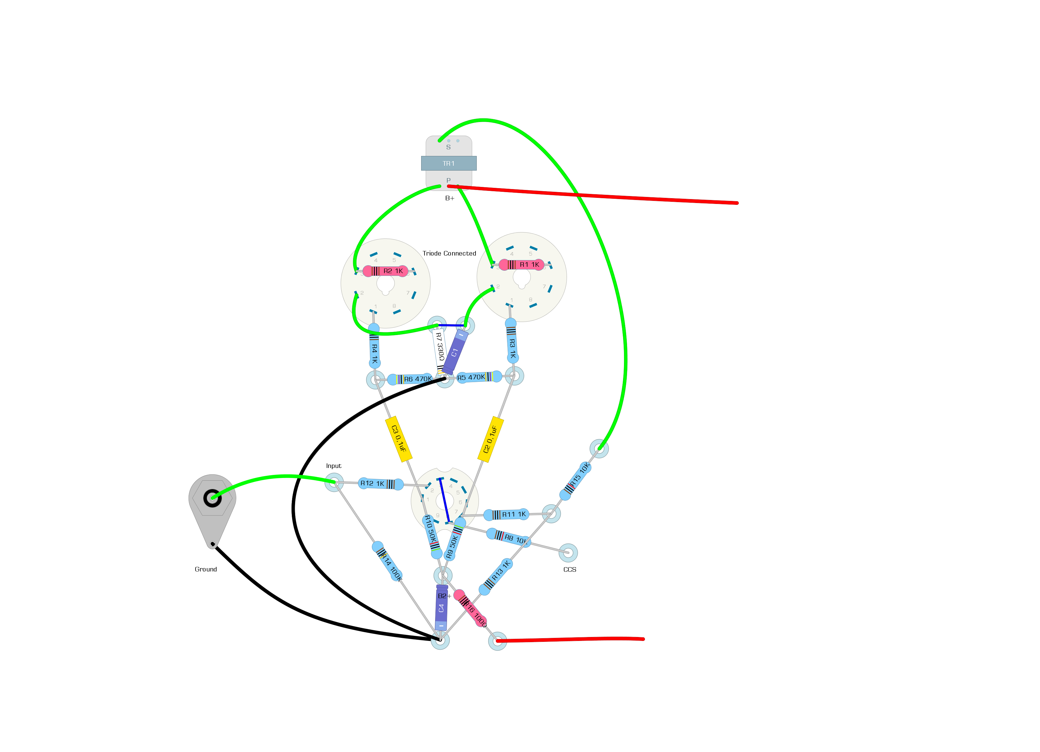

I put the (mono) audio part in DIYLC as a layout. I've done some layouts before using a turret board. I spent quite some time optimising those layouts. This time I might go with true point to point. Here's my starting point (see attachement). Not to scale yet.
Any general wiring advice wiring? Any general layout advice on point to point? Any specific advice for my (starting point) layout?
I can think of keeping the electrolytics cool, so the cathode bias resistor and capacitor should not be to close. I put the (power) filter cap close to where it's 'current is used', but it is very close to the hot tube (sockets).

BYW96E is fast and causing less HF noise than say 1N4007 (in theory). I watch your solution to obtain a few dozen of volts for the negative supply. The (horizontal) 220uF/100V is catching any zener noise. Any use for a second tor to obtain higher CS impedance?
The lower triode has a 1K stopper while the upper has 10K. Is that to cause a HF pole for GNF stability?
I think that the impedance of the CCS is high enough with the big emitter resistance.Afterall in many cases they get away with a simple resistance.
Normaly 1k stopper is used but to cut of possible high frequency at the input, one can take advantage of the miller capactance and a higher stopper.
There could be something wrong with the cathode resistors in the final stage !
The triode curves for the ECL85 I have are looking suspicious after seeing those of a ECL82 but didn't found other (better) untill now.
Mona
Balance and linearity are dependent on the ccs impedance as far as I know. Can't give a hard answer if it is enough or not.
I've been playing with the grid stopper values in ltspice. Somehow they cause the overall high frequency response to increase. Van der Veen also shows some high frequency peak in his amp transfer function, but uses a grid stopper to crush that: the behavior I expect.

In the meanwhile I found triode curves for the pentode in the ECL85 from Tom Schlangen.
Looks a good job, so I adopted the cathode resistors. Also change the value of the decoupling electrolytics, to get more stable bias at higher output power.
