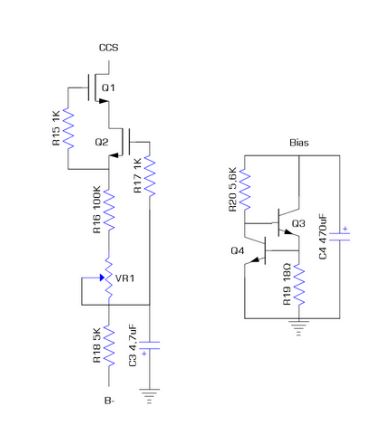

Why not keep it modular? I build these CCS on 5x8 holes Vero Board with leads soldered in place. Keeping wires short fixates it enough, no dangling around. Simply build your circuit hard wired and add these circa 2cmx1cm boards. Most efficient if you want to alter a setup. I never use fuses besides the mains fuse.

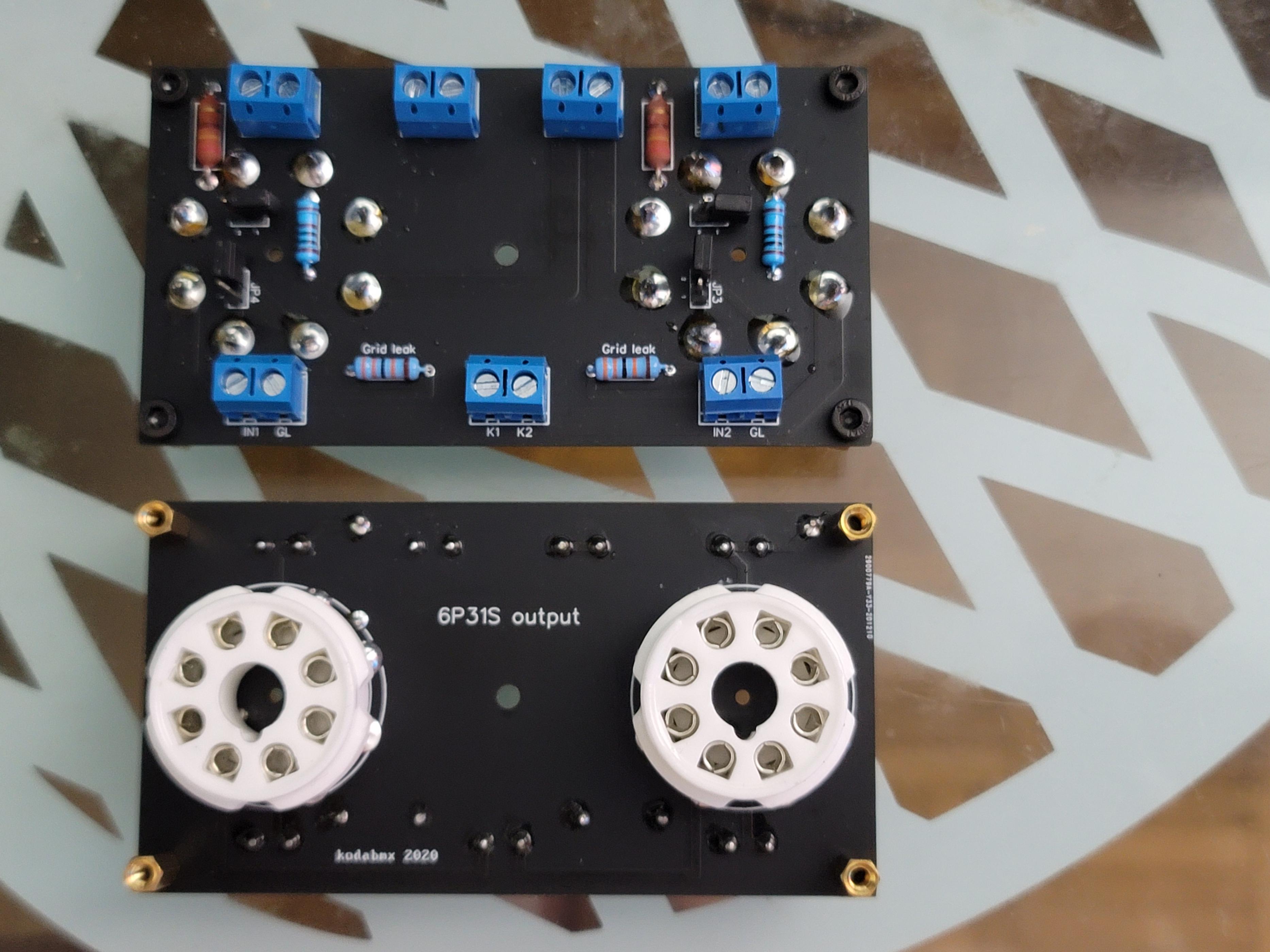

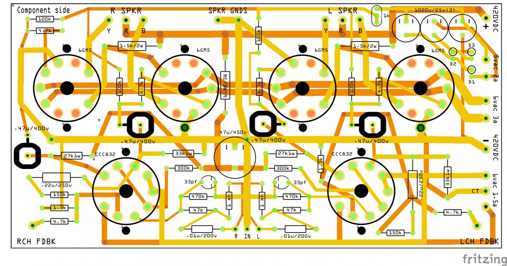

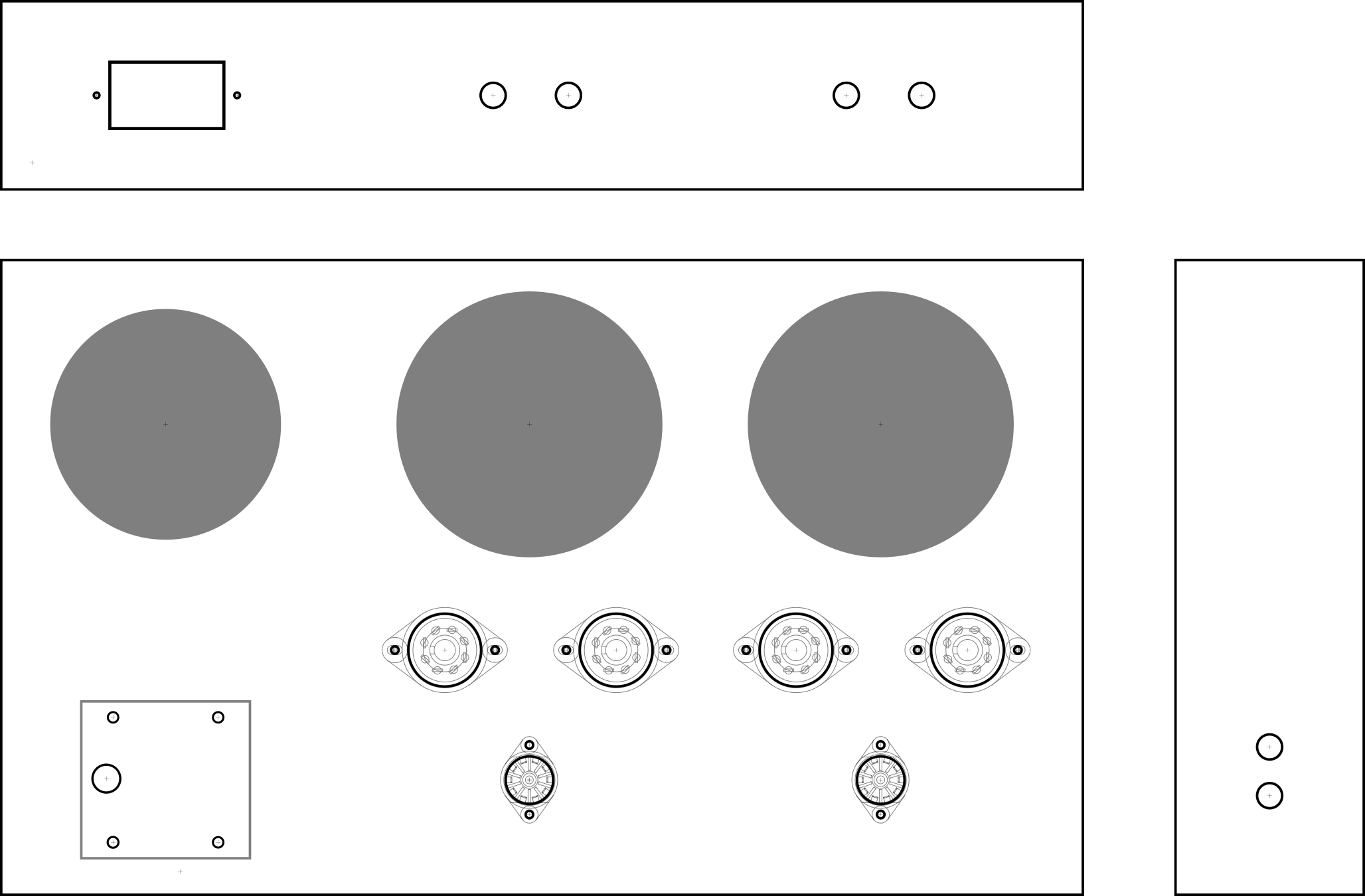

I'm making a module amp design. Pick your VA/PI, decide if you need the driver, and pick your output boards. So far, the output boards will work with about 30 different types of tubes including 6CK pinout like 6AV5, 6L6 and all the other tubes with that pinout including 6BQ6 and 6P31S with top caps, 6KG6, 6P36 etc.
Here's a picture of the 6P31/6L6/6V6/KT*/6BQ6 etc board front and back. The jumpers enable pin 3 as plate, or tying 1 to 8 for EL34.
