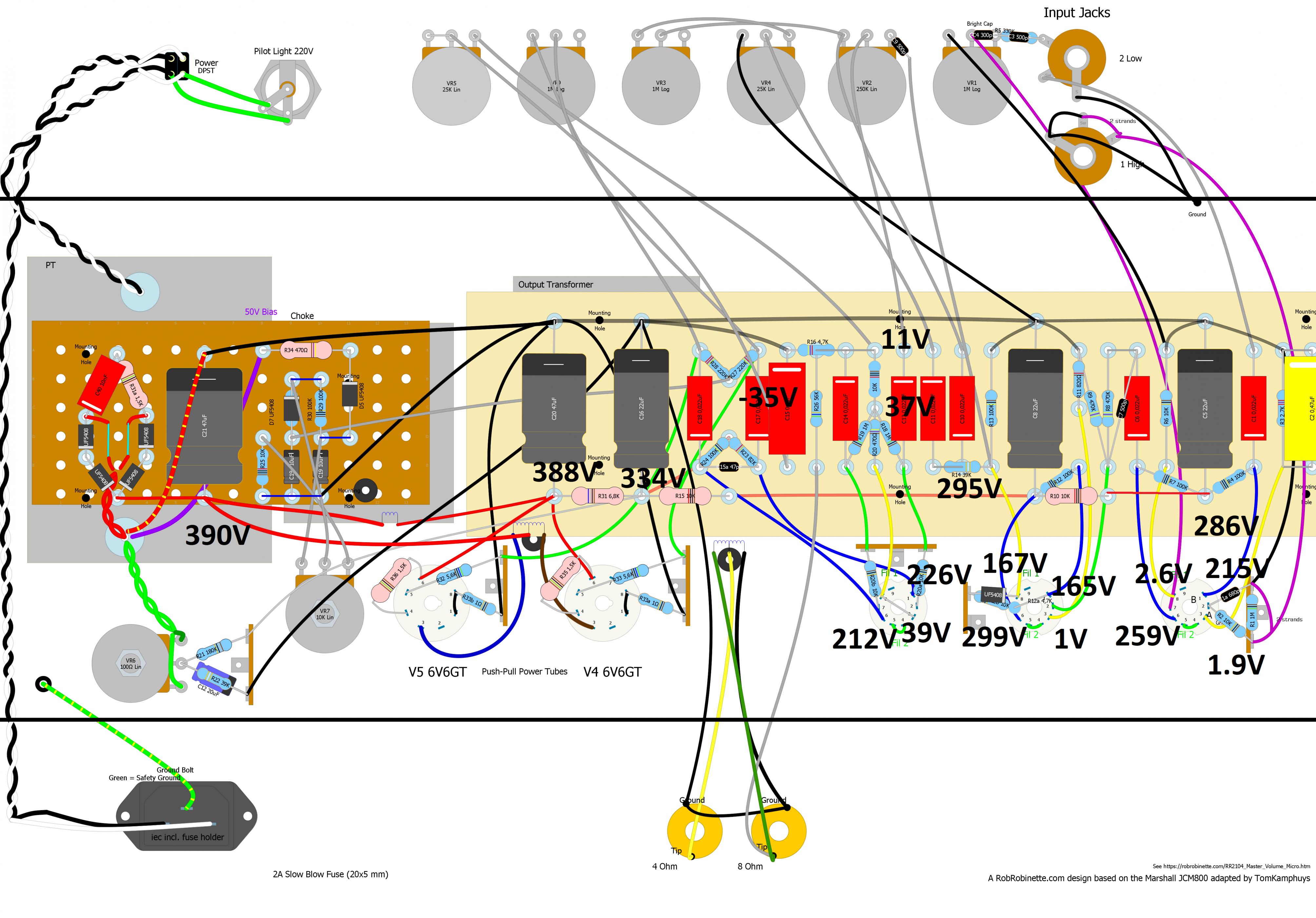

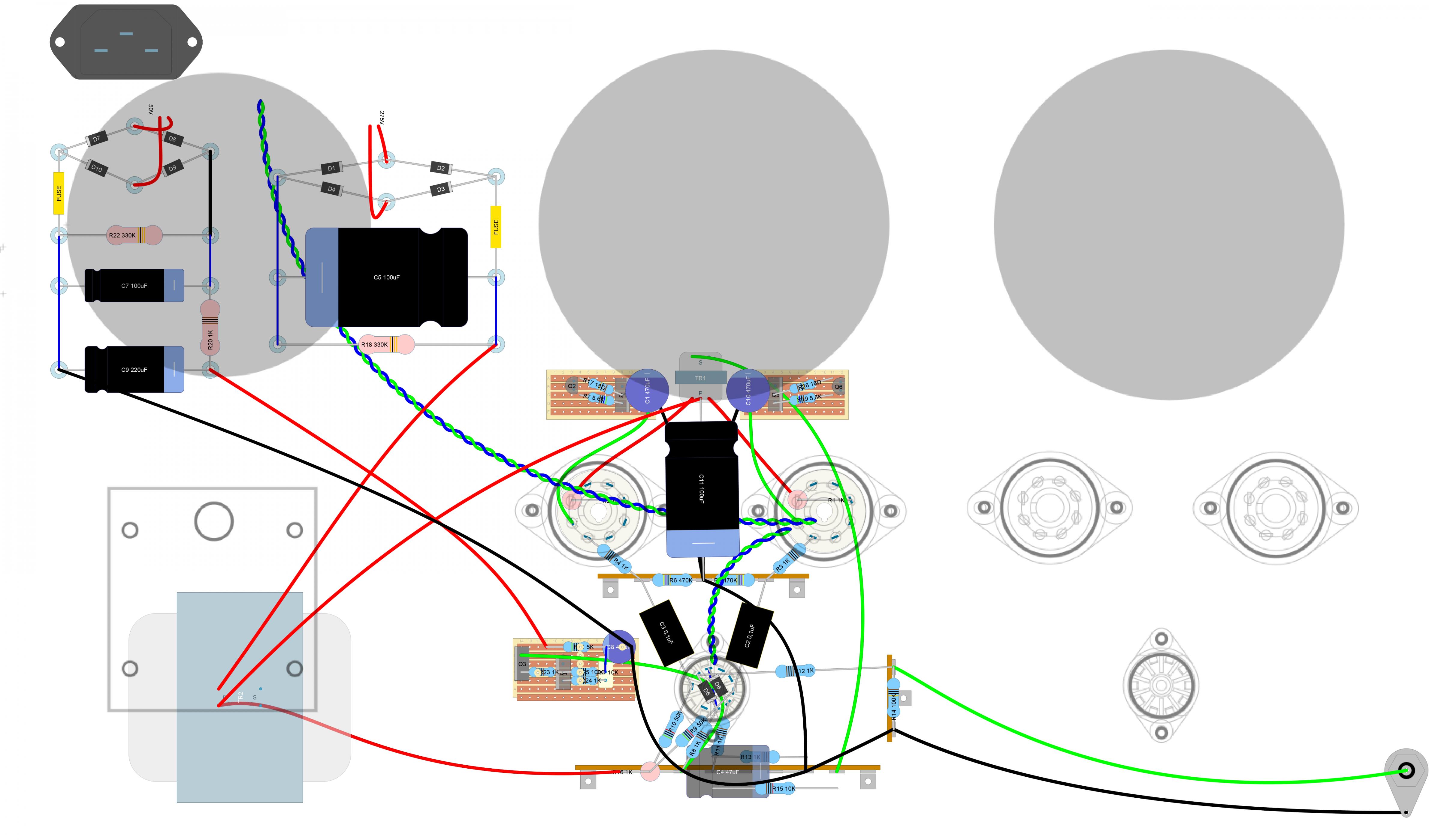

6A3sUMMER: Your line of thought seems logical. Losing the diodes also enables me to only use one bleeder resistor.

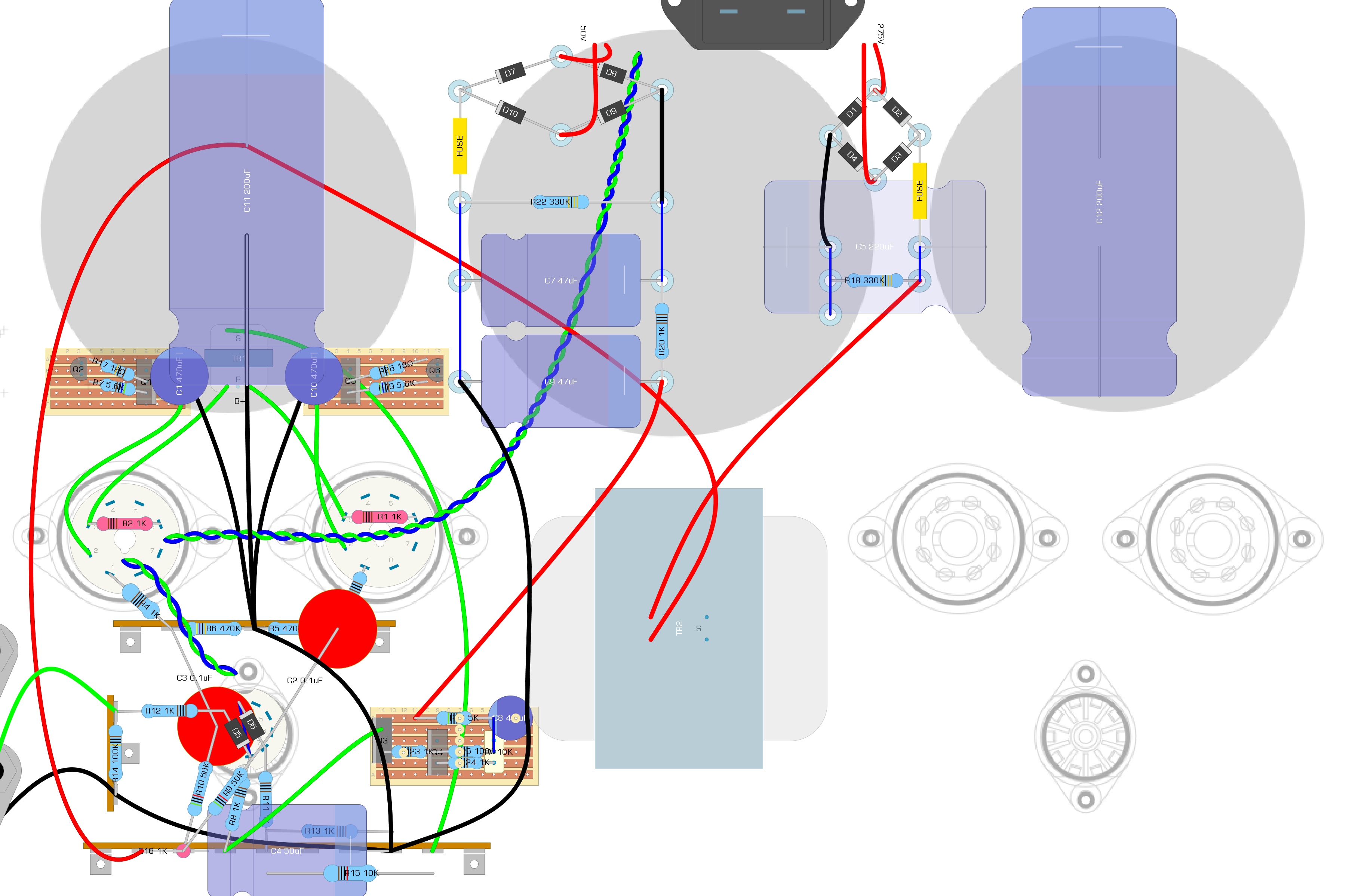

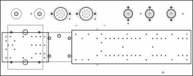

I've been busy in the mean time with a layout of which I've attached a snapshot. Just an indication to you guys that I'm still working on it; nowhere near finished.
I've also bought and received the book 'Building valve amplifiers' by Morgan Jones. I've skimmed through it and read some interesting parts thoroughly. Very thick and rather wordy, but I still learned more words from Eli 🙂

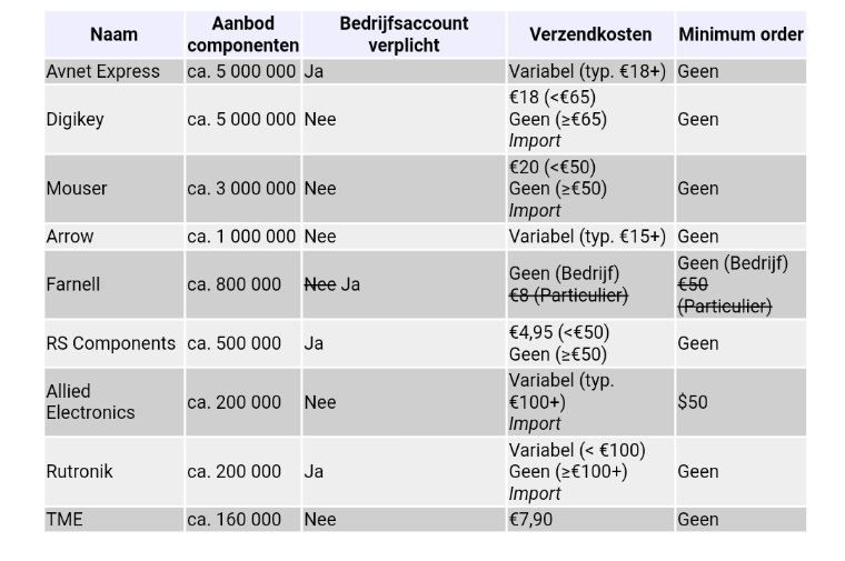

Farnell supposedly does not sell to private individuals according some source (attached, in Dutch)
And what about import/customs? I read contradictory statements.
Some Dutch:
Ja: yes
Nee: no
Geen: none
Bedrijfsaccount verplicht: only for businesses
Verzendkosten: shipping fee

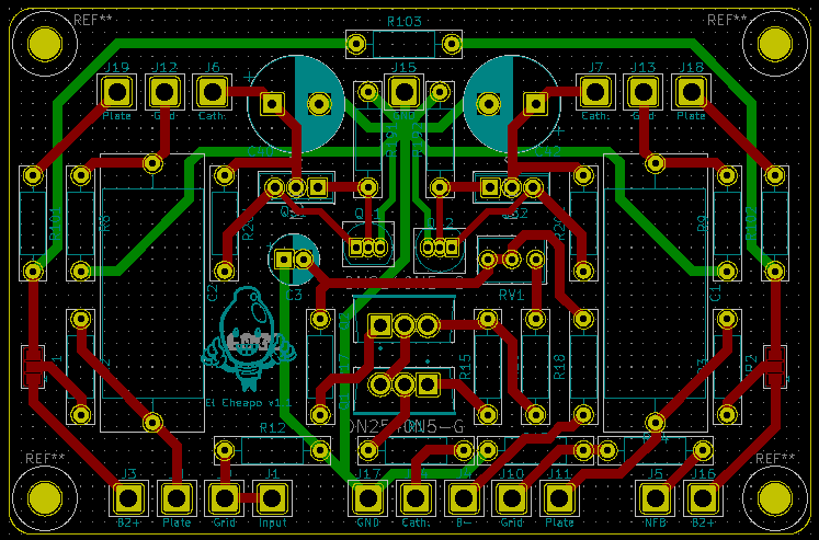

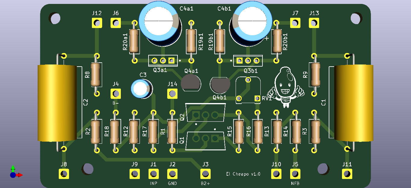

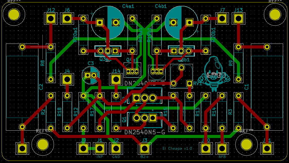

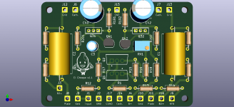

I've been playing with KiCad some more. It has a few quirks, but otherwise it is a nice program.
I've made the full audio part of the schematic on pcb, with the exception of grid and screen resistors, diodes and valves. The grid resistors should be close to the sockets. I like the sockets on the chassis. Then it is logical that the diodes are also at the socket. You guys might have noticed I can't make choices and this also enables that. I might replace this pcb for a Baby Huey. The power supply and non-pcb components and wiring should support that I. Using an adapter I might even be able to use EL84's.
However, back to reality: What about the pcb? Any good? Are there any pitfalls? Any advice is welcome.
In the spirit of the El Cheapo: pcb cost is down to 25,- euro for 3 boards (no components)
Nice work!
I've been using Fritzing, but am impressed by your KiCad layouts. Some Fritzing users call it a step up. Will KiCad export RS274 Gerbers for free?
Initially chose Fritzing cuz it would do this without extra charge for Gerber export, like some softwares that advertise RS274 export capability.
3rd pic posted shows 3rd dimensional depth- is that click view option? Or can you rotate axis views?

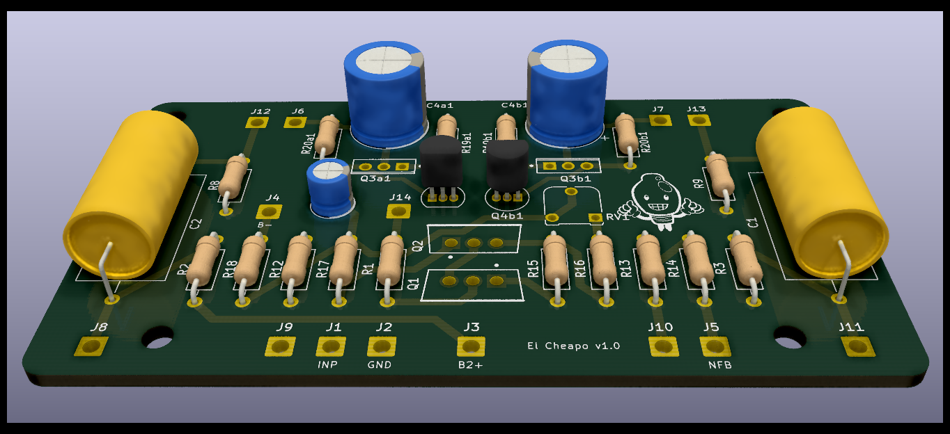

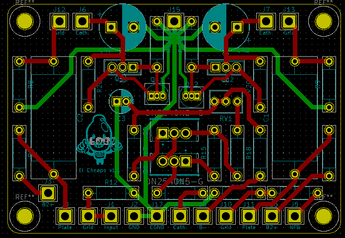

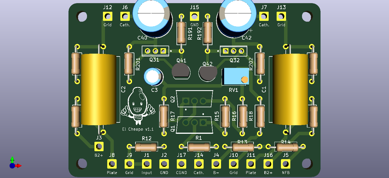

I think KiCad does that, but I'm not sure. This is the first time I use KiCad and hear about Gerber. The PCB manufacturer I found accepts KiCad files; no need for gerber files (and others?).
The second and third image can be rotated. The second one updates in real time, the third one is a raytraced image that takes some time on my old laptop.
In the mean time I've worked on the pcb some more. I forget some pads that I added and re-arranged some to group them more logically.

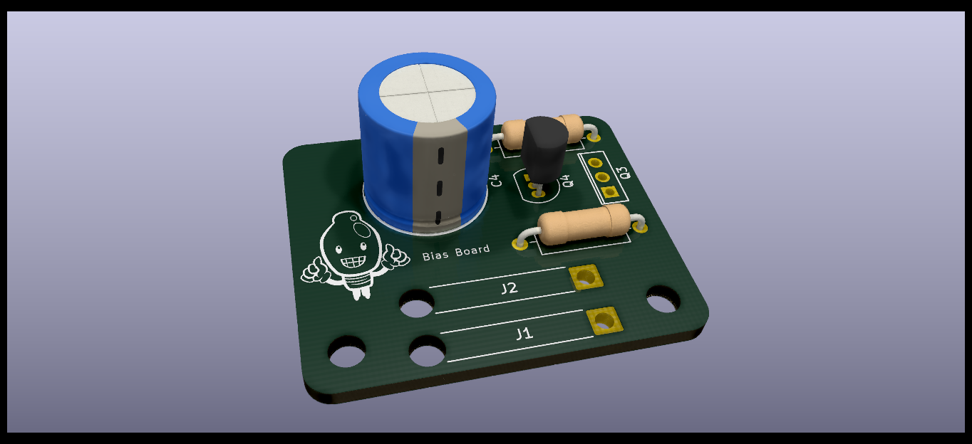

I think I've captured both the El Cheapo and the Baby Huey on a single pcb. A few resistor values and a solder jumper makes it one or the other.
One thing I'm still wondering about (and haven't included in the pcb): the balance pot in the LTP tail. I read everywhere that the CCS ensures that the LTP is balanced. Is the Baby Huey a special case? Because of its shunt feedback? Does it need the balance pot? For other reasons? ??

What schematic for BH EL84 are you looking at. BH does have a LTP balance, certainly in the latest version, dated Nov 19, 2018 (the PCB is R1.6).
Hmmmm... I have v1.1, from the wiki. Do you have a link to the latest one?
Edit: Found it: GB for Baby Huey PCB
