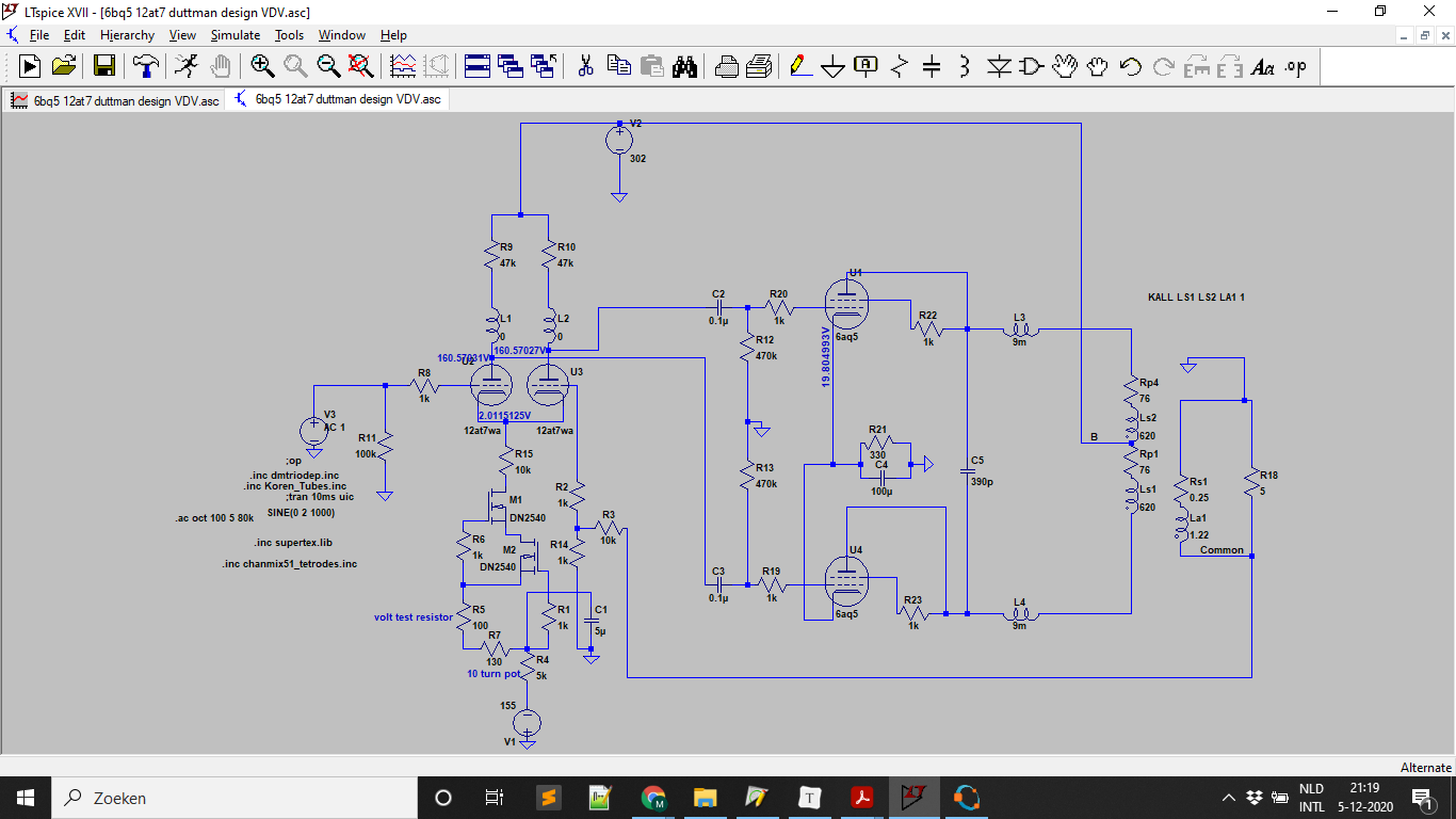

I found a ltspice model (attached) of El Cheapo I've been fooling around with. I adapted it for a transformer model as discussed in a paper (attached) by Menno van der Veen. The transformer values (attached) are from the Amplimo website.
Is the ltspice model any good? What can I learn from it and where does its usefulness end?
Did I adapt the transformer model correctly for use in ltspice?
How to model the UL case? How should I split the inductance and resistance?

Since LTspice use the same model for both tubes = two identical tubes, I suppose one or two cathode resistors make no difference.
Except for very low frequencies, the decoupling is easyer with cathodes wired together.

I am sorry, I have to leave the simulation software questions to someone else.
LTspice is very useful.
But Software and I do not get along.

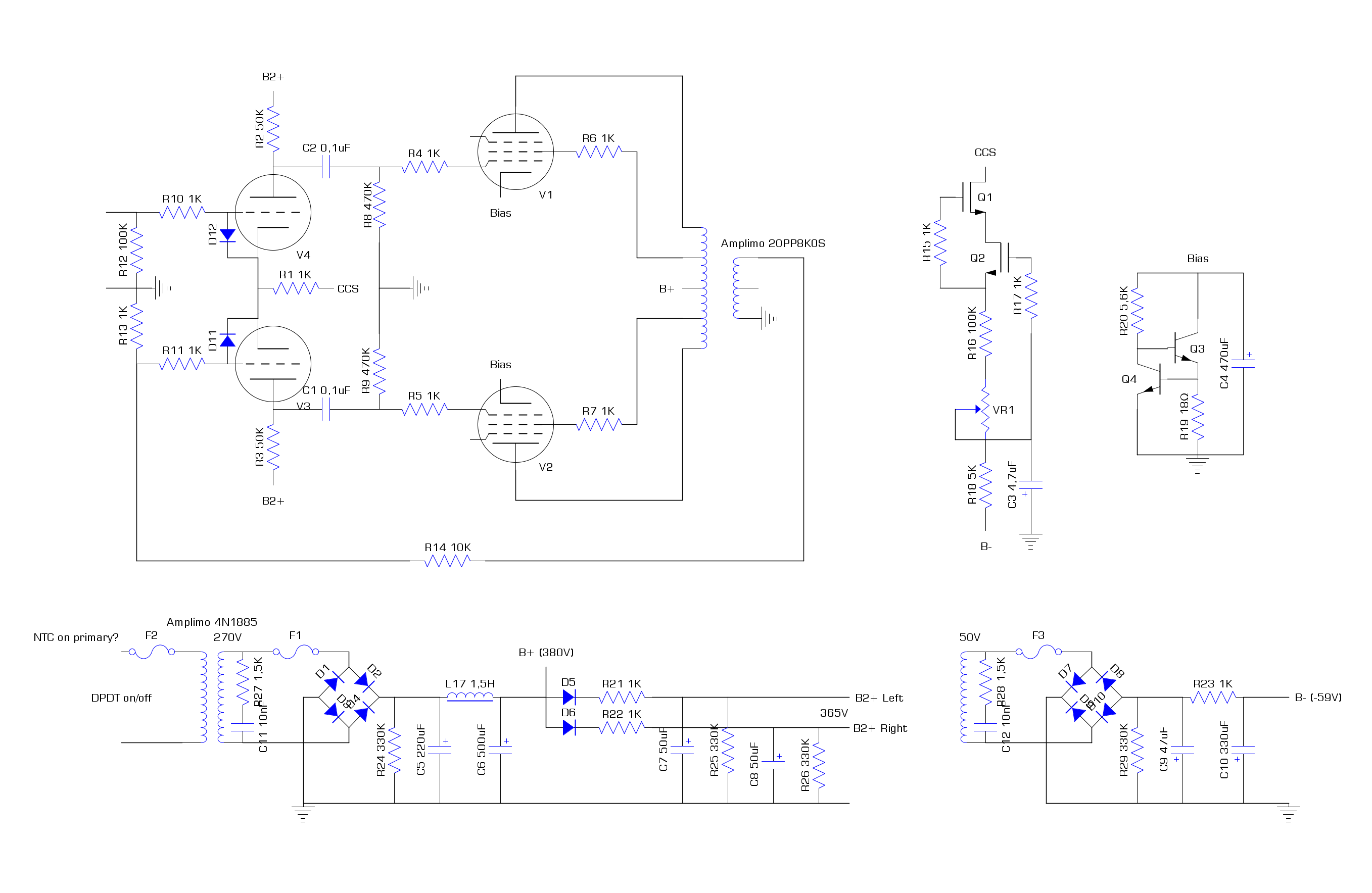

Update: schematic with some changes.
- I think I've got some volts to give away, so I increased the 100R dropping resistors to 1k.
- Changed some power supply caps. Some smaller because of availability, others larger because the rectifier tube is replaced by SS diodes.
- Protective diodes on the 12AT7's
- (Option of) bias a la Baby Huey, as a result of 6A3sUMMER's remarks (if I interpreted those correctly).
- Input to be decided (be patient 6A3sUMMER ;-) )
- Bridge rectifier as the secondary voltages are different
- Lowered the LTP tail resistor because of the lower voltage.
- CL120's to be added.

Tom,
I like your idea to use the diodes on the input tube grids.
During Hot-Start conditions (power is on, goes out, comes back on; the current sink can dump all that current from the cathode to the grid (if the plate B+ voltage is collapsed).
Think about this:
Switch the positions of the 500uF and 220uF B+ caps.
It will do 4 good things:
1. Make the 270V winding run cooler.
2. Reduce the inrush current during Power-Up.
3. Make the B+ that runs the output stages a much lower impedance.
4. May allow a smaller fuse in the transformer primary power mains circuit
(because of the lower power-up inrush current).
You are going to fuse the primary, Yes?
I hope so.
And, I do not see any bleeder resistors on the power supplies.
Prevent the "Surviving Spouse Syndrome" Use bleeder resistors.
Safety First!

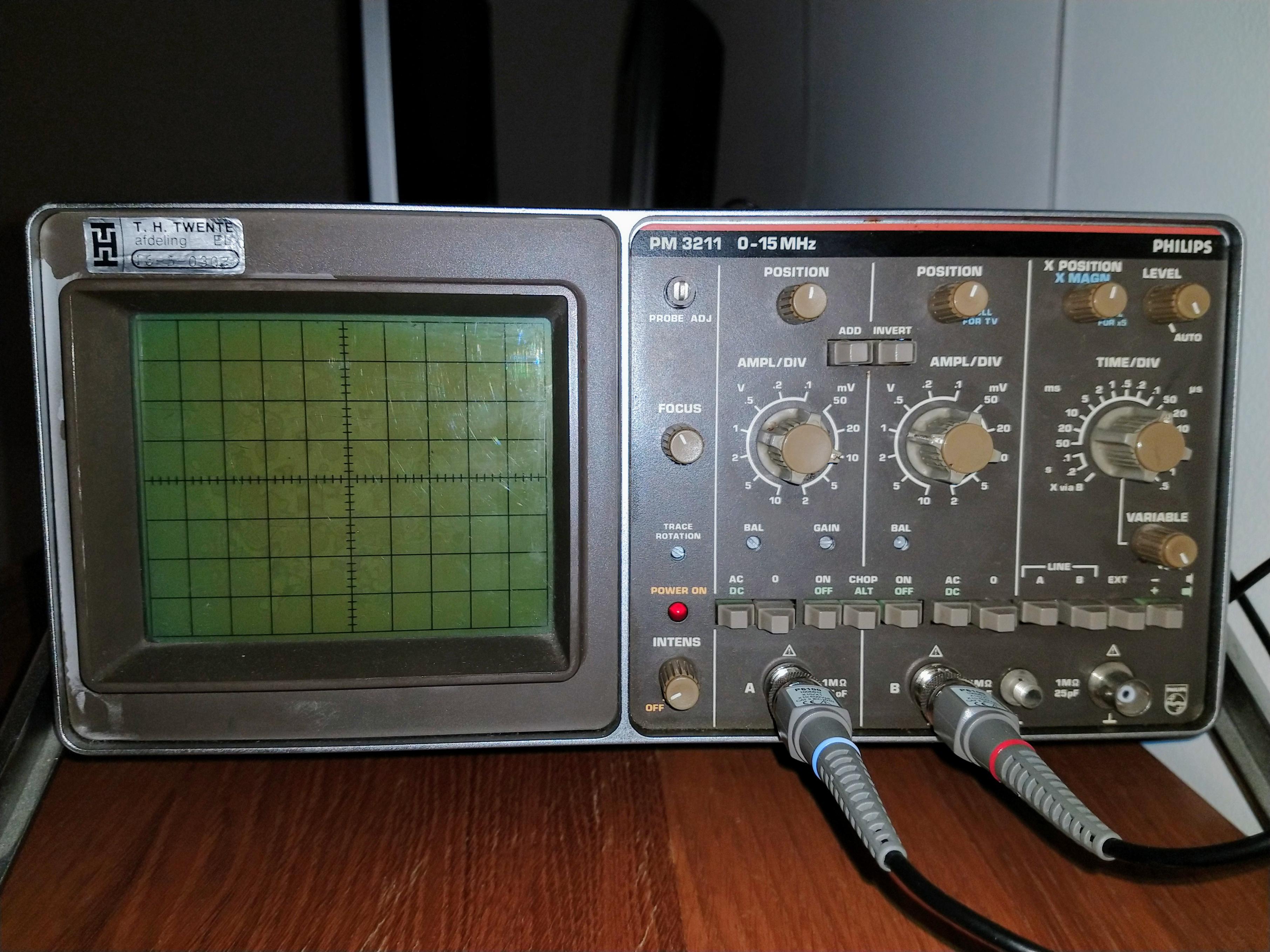

@Tom Kamphuys
How good is your test bench? Do you own an o'scope and signal generator? After you get the amp working (sort of), you can experiment with phase compensation. Feed a 2 KHz. square wave to the I/P and try various small capacitances in parallel with R14. Examine the waveform across your "dummy" resistive load. Settle on a value that yields the best "look". Some compromise among overshoot, ringing, and tilt is inevitable.
If the available test equipment is limited, we'll fall back on a brute force method of phase compensation.

Ok, I took the advice (see attachement).
I do have an oscilloscope, an old Philips. Bought it second hand for 25,- euro or so. Turned out it used to be of the university I went to; we might have met before. And a somewhat decent multimeter and an el cheapo one.
I've been looking at a pico scope, but recently my interest has moved to an analog discovery 2 (+ audio analyzer suite). Is that the full audio test set it seems to be? Is it any good?

The B+ 1k resistors and 50uF caps that powers the input phase splitter tubes . . .
That is -3dB @ 3.2Hz, plenty good!
But that makes me think that D5 and D6 are not needed.
The 1.5k and 10nF have a pole frequency of 10kHz.
Unless you live near US Navy's Megawatt 15kHz transmitter, or a Loran 60kHz transmitter, or similar Very Low Frequency transmitters, those RC snubbers are probably not needed.

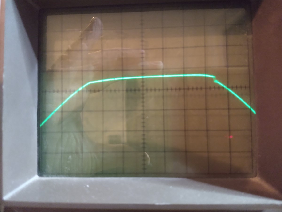

I placed the snubber to limit the 'switching noise'. See attachement of a scope image just after the power transformer (using UF5408 rectifier).

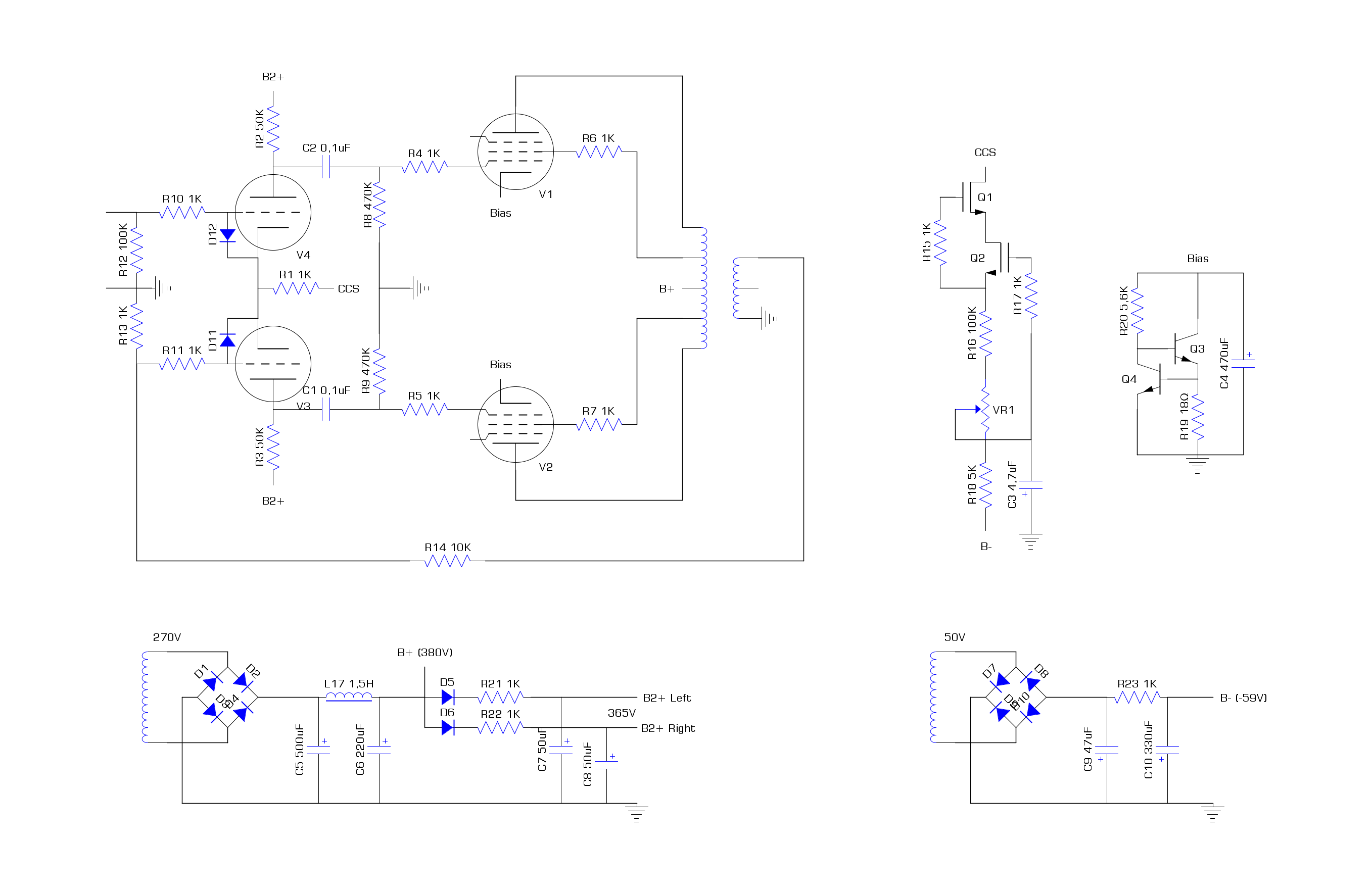

And what are your comments about the two layout examples?

Not much difference, just rout the PT wires away from both OT and sensitive circuitry as that part of the toroid has the most leakage. Solder the UF5408 close to / straight on the PT and keep the reservoir elco very close, as much out of the way of mentioned circuitry.what are your comments about the two layout examples?
EL84 does not give much heat, otherwise I would opt for the first possibility.
6A3sUMMER said D5 and D6 might not be needed with the 1k dropping resistors. I've thinking about and simulating their function. I think I read somewhere they are there to decouple the two source voltages of the two 12AT7's. But as the current draw is controlled by the current source to a steady 6-7mA I don't see how they would steal voltage from the other channel. Still, the power tubes could steal some voltage from the 12AX7's. I haven't figured out how to simulate that, but I would only need one diode (and one bleeder resistor) to stop that from happening.
Is my reasoning correct, or am I missing something?
