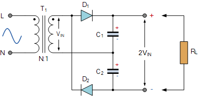

€400-500 is quite sufficient to complete an approx. 15 WPC push/pull amp based on "12" W. tubes, like the EL84 and 6V6. Mate the amp to low 90s sensitive speakers and the music will flow.
BTW, a well executed "full wave" voltage doubler is the economical way to obtain a high performance B+ PSU. Good sized caps. in the stack followed by a LC section reservoir get the job done, well. Hint: Hegeman, Marantz, and McIntosh used the method. 😀

You will be very hard pressed to find a more economical high performance setup for the B+ PSU than "full wave" doubling a boosted Triad N-77U with UF5408 diodes.

That is a good way to get the B+.
But just be sure to keep all of the doubler circuit in a local loop. Extending it out to
other areas of the amplifier, it will cause terrible hum/hum upper harmonics noise.
But it requires one more tran$former, the filament tran$former.
Choke input full wave with center tap, or with bridge, has the quietest hum/hum upper harmonics ground loop noise. Again, be sure to keep the circuit to just a local loop (at least the secondary, rectifiers, choke, and the first cap (and resistor and second cap).
But the power transformer is more expen$ive, and heavy; and so is the added choke more expen$ive and heavy. And, the choke needs to be far away from the output transformers, and oriented properly.
