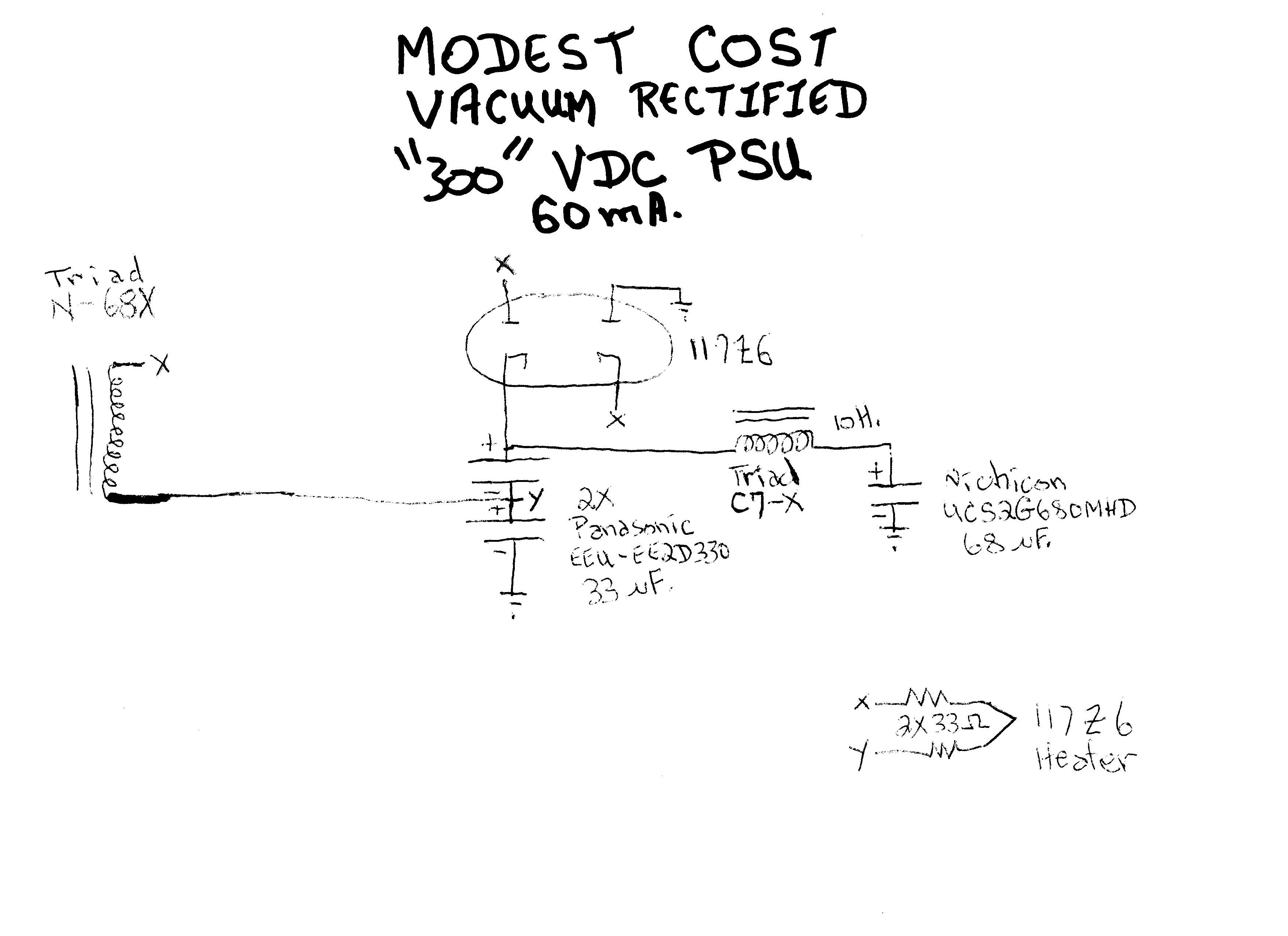

The method employed by Hegeman and others was used in "El Cheapo" (schematic provided). The LC reservoir section is critical to high performance. A refinement is inserting a LC "hash" filter made from a high current RF choke and a 1000 pF. mica or high quality ceramic (NP0/C0G) cap. between the doubler stack and the reservoir section.
Large valued caps. at the I/P of a PSU filter "crush" the ripple fundamental, but they generate ripple overtones up into the RF range in doing so. (TANSTAAFL strikes again) I've discussed the mechanism many times both here and AA. A "hash" filter keeps the trash out of the ultimate PSU product.

Eli,
Of course that schematic of El Cheapo is a good power supply . . .
Using 3 separate power transformers is sometimes considered a luxury.
More real estate, weight . . . and expensive.
1 B+, and 2 separate filament transformers.
That helps to isolate the noise from one power supply getting into another supply
(has to cross from the 1st secondary, to the 1st primary;
and then onto a 2nd primary, back to a 2nd secondary.

Believe it or not, 3 transformers were (sic) the inexpensive route.
Triad's N-77U and N-68X are bargains for getting 300+ V. of B+.
Things change over time. Anybody in North America considering an "El Cheapo" build can get a complete set of power "iron" from Allied Electronics.
Stock # 70218190 = main B+ $32.59
Stock # 70218344 = 2 "12" VAC windings for B+ boost and heater power. $16.73
Stock # 70009000 = B- feed and 12AT7 heater power. $16.83
Stock # 70218145 = B+ filter choke $8.62
Approx. $75 for a reasonably sophisticated set of power "iron" is (IMO) a pretty good deal. FWIW, Triode Electronics charges approx. $100 for a ST-35 power trafo and that chunk of "iron" will not completely satisfy the needs of an "El Cheapo".

So the only expen$ive thing about the EL Cheapo having 3 transformers . . .
is the extra large chassis to be able to fit those on.
1 transformer = more hum and noise cross coupling; but a smaller chassis.
3 transformers, and 2 output transformers that need to be spaced away from them = a larger chassis.
Tradeoffs.

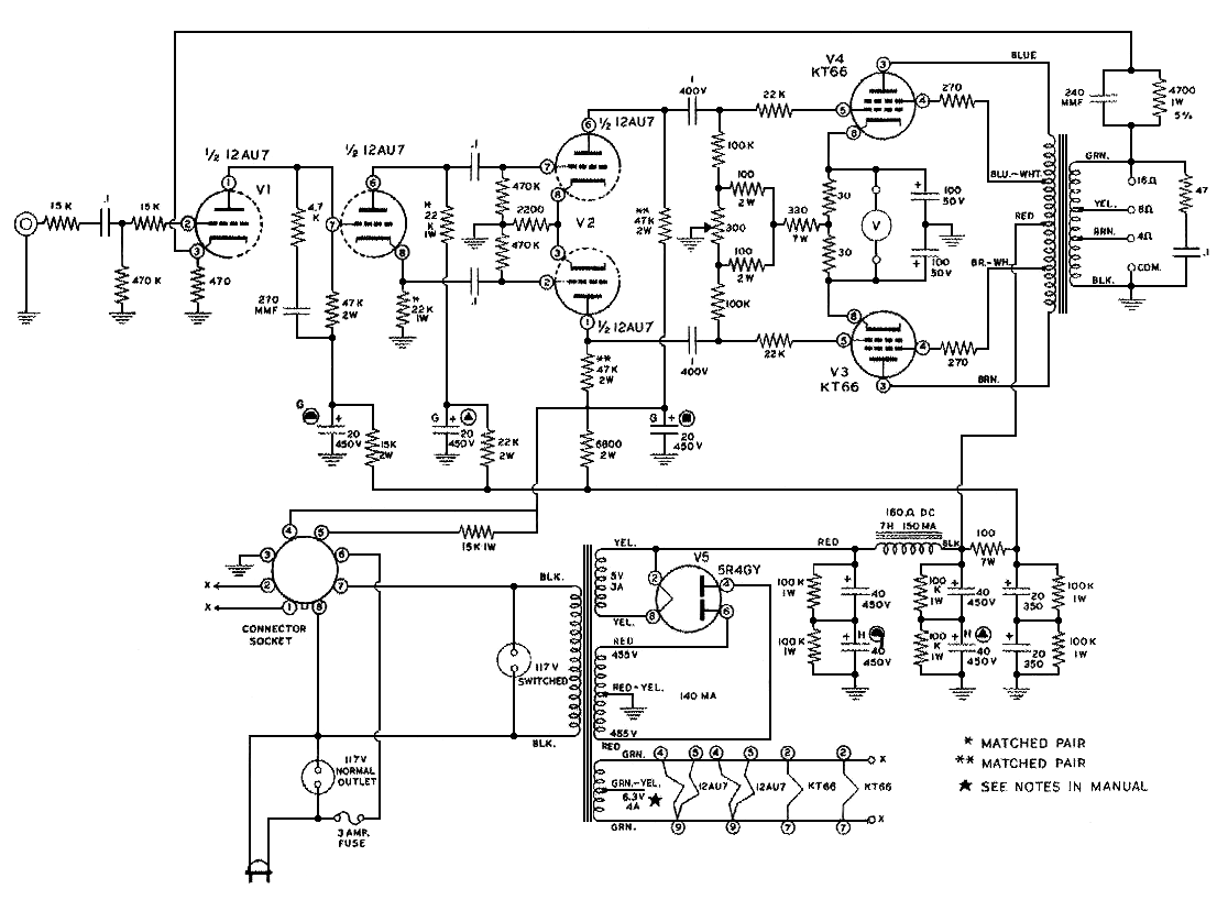

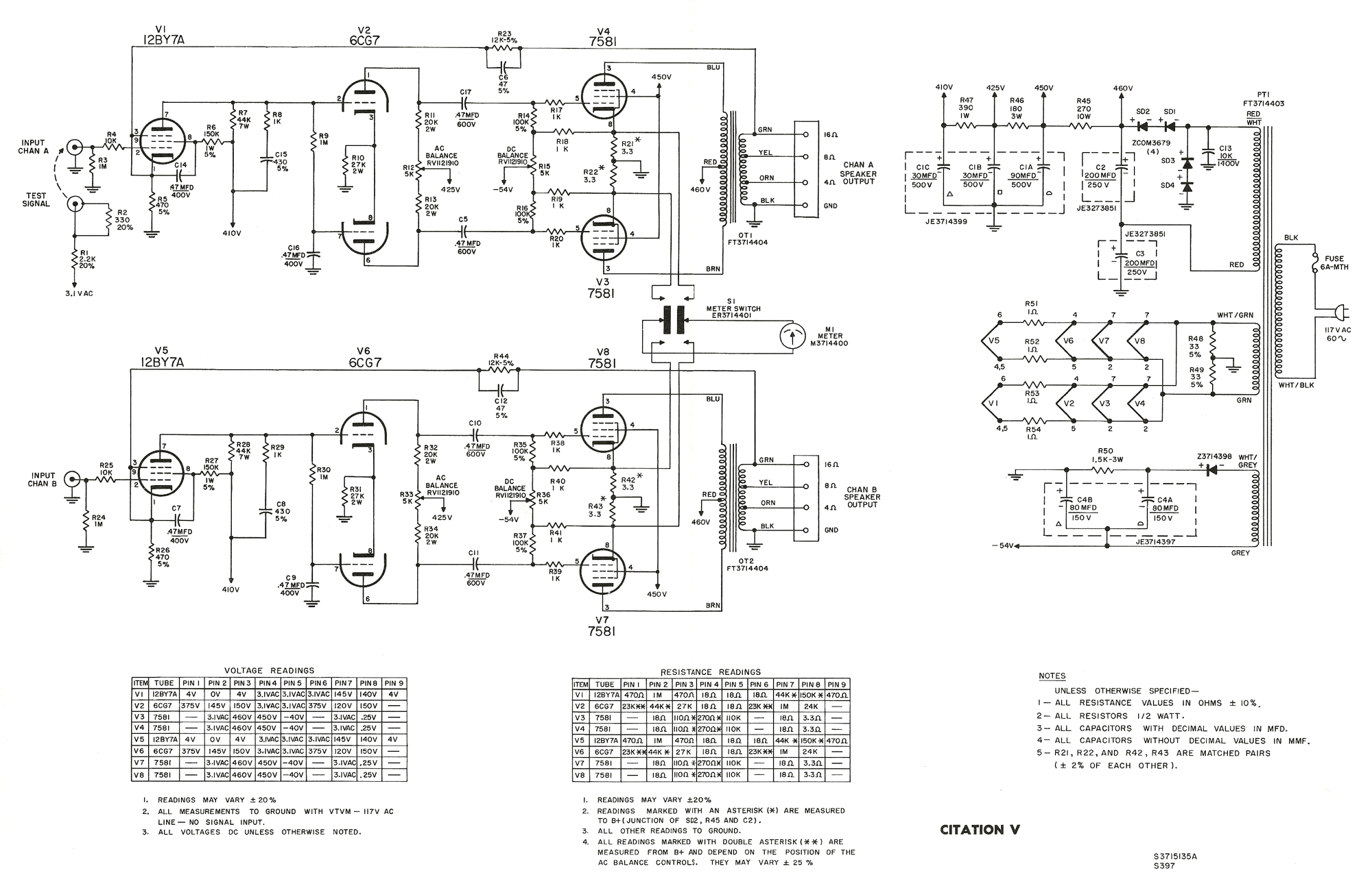

Start with a proven circuit. I'd recommend a variation of
the Williamson circuit, or the Loftin-White SE 2A3 circuit. You can find schematics for the Williamson with 12AU7 or 6SN7 driver/phase inverter tubes, and/or 6L6, 807, or KT66 power tubes. One of my first amps was the Healthkit W5-M mono blocks. Some good info here:
The Williamson Amplifier
The Loftin-White SE 2A3 is a simple, straight forward design. If 4 watts will driver your speakers, this would be a great way to start. I've ran this circuit for 20 years and haven't found a reason to move away from it.
loftin-white - American Radio Historyworldradiohistory.com › Radio-News-1930-03

Building a Williamson amp can also be inexpensive, depending on which version of the circuit you build. My preference has been one that uses 6SN7 up front and 807 in the back. Good 807s can be hard to find. The military version of the 807 is 5933. Very solid tube. The heathkit version is nice because it uses 12AU7s up front and you can uses 6L6 instead of KT66.
I believe you can also use the same PP transformer for 6L6, KT66, 6550, and 2A3. You can build different circuits and use the same transformer.
You can keep your costs down on your build if you opt for a stereo rather than mono blocks. Keep parts costs down by using ok components for everything except signal path. Get the best parts you can for signal path within your budget. The most important part is going to be the iron, the output trans. Starting in-expensively will get your foot in the door - so to say - and you can upgrade parts as you go.
The "Achilles Heel" of Williamson style topology is low frequency instability. Costly O/P "iron" relatively free of phase shifts is part of the Williamson "package".
Mullard style topology is more tolerant of O/P "iron" aberrations and (IMO) is a much better choice, for a 1st time builder. Mullard style is "idiot resistant".
The OP's budgetary limits (unfortunately) tend to exclude tubes more capable than the "12" W. multi-grid types. In the interests of completeness, I'm uploading examples of the Williamson and Mullard styles.

During the development of "El Cheapo" DIY Audio "guru" SY pointed out that the NFB was working into a high impedance non-inverting control grid. An inductive NFB resistor could cause trouble. Both MF and CF resistors are spiral trimmed and that introduces inductance. The low cost answer was employing meter matched (between channels) CC resistors. Use Caddock parts, if your bank balance can tolerate the "hit".
The 10 Kohm CF resistor between the LTP's tail and the CCS drops some volts and also blocks the conduction of heat from the tube (via the wiring) to the CCS. Unwanted heat is the mortal enemy of all things electronic, especially SS. I took no prisoners. 😉 BTW, that resistor also slightly increases the net load the LTP tail works into.
IMO/IME, amps (including "El Cheapo") which employ GNFB loops that the encompass the O/P "iron" should filter infrasonic noise out, at the unit's I/P. Suppressing said noise is prophylaxis against core saturation. When the "iron" is of decent quality, a 1 pole RC filter whose F3 is in the 16-18 Hz. range is adequate. The "El Cheapo" schematic shows a no longer recommended guitar amp O/P trafo that can't provide full bass extension at full power. F3 for the 0.056 μF./100 Kohm combination shown is 28.4 Hz. For any rational signal topology, better O/P "iron" = better amp.
Please notice the the "El Cheapo" schematic shows triode wired O/P tubes. Approx. 6 WPC are available with low cost guitar O/P "iron". The "Gold Standard" O/P trafo for "El Cheapo" builders is the "Dynaclone" Z565, which allows for both UL power and full bass extension. The Z565 is the price/performance champion "iron" for building PP amps that employ "12" W. multi-grid O/P tube types. TANSTAAFL!
Many DIY builders find a metal plate (usually aluminum) and a wood frame convenient. A commercial kitchen baking pan can be convenient too. Adhesive metal shielding foil is available, should wooden construction prove troublesome.
Decent B+ rail filtering and stage to stage decoupling has proven quite sufficient.
Good sized interstage coupling caps. avoid deleterious phase shifts, which can be particularly troublesome in units containing feedback loops. Heaven forfend that most definitely unwanted fulfillment of the Barkhausen Criterion for oscillation occur. I adhere to the 2 octaves away from the passband notion. Some folks follow a slightly more rigorous rule of a decade away.
Filament voltage definitely is an issue, when AC heating is employed with directly heated types. An AC heated SE 2A3 will usually be fine. OTOH, time and again, AC heating of SE 300Bs has been problematic.
Vishay/Dale 1% tolerance RNnn milspec metal film resistors are quiet and non-magnetic. They are excellent where low noise is important and the tight tolerance is (obviously) good.
