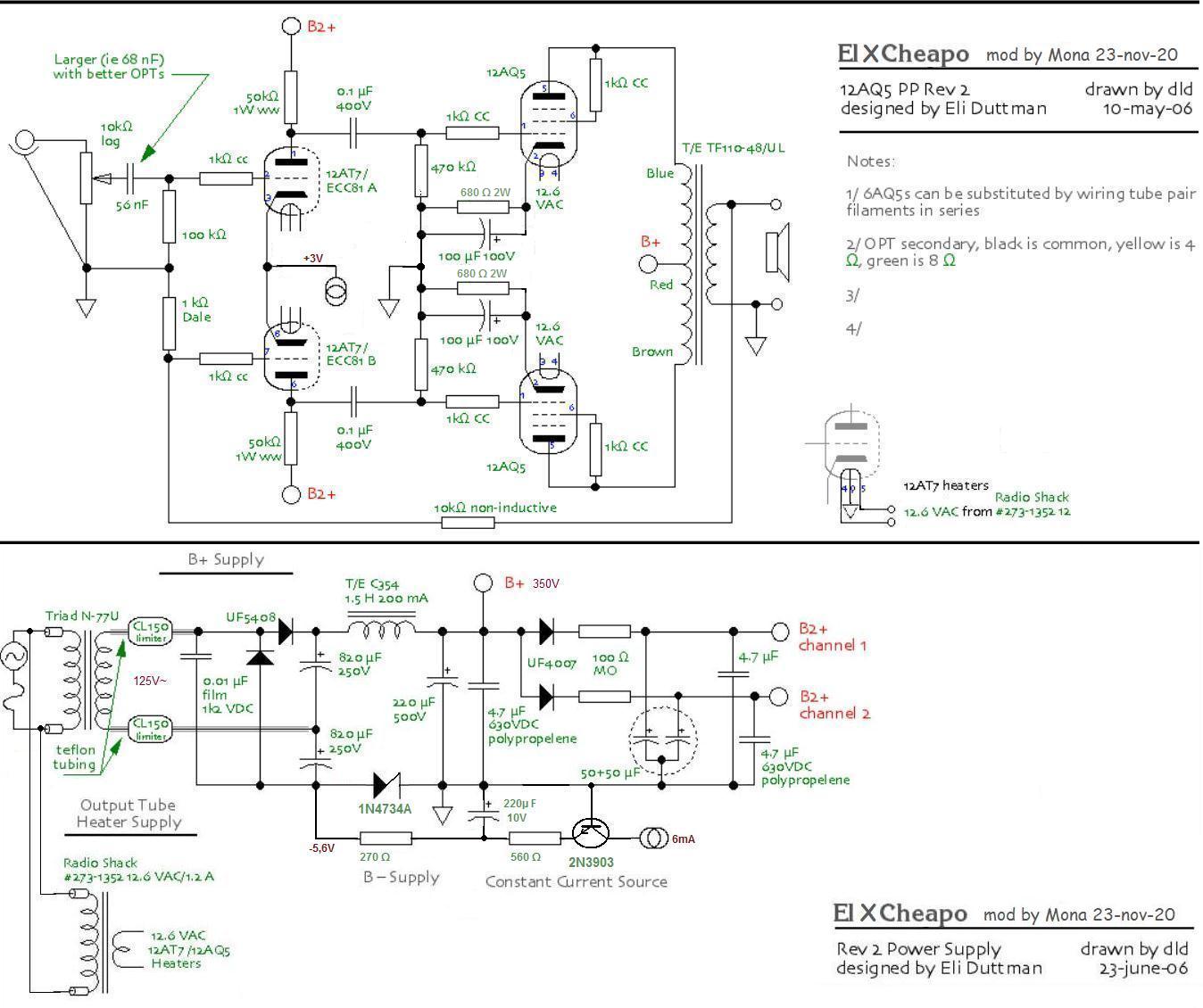

After switching back and forth between the El Cheapo and Baby Huey and thinking I might pick the best of both, I've come to the conclusion that the El Cheapo was designed by smart people and discussed extensively (very unfortunately the original thread is nowhere to be found). Who am I to improve on it?!
So, El Cheapo it is. I'm gathering as much info as I can find and have started to put it into one document; currently mostly quotes of Eli Duttman. It is a way for me to bundle the scattered info. Thinking big: We might even construct a dedicated El Cheapo site. Who knows...
In that process I looked at the 12AL5. It is hard to find and of my go to shops, only one has 'm and is charging 20,00 euro. Quite a lot w.r.t. the 12AQ5 ($4 or 8,- euro). Is the slow start needed? Are there other ways to provide the slow start?
And I wonder: How is the LTP biased?
In any event, you have to rework the negative supply. The Allied 6K27VF transformer works only in North America.
Can a you economically source a 6AL5/EAA91? If you reduce the value of the CF resistor between the LTP cathodes and CCS, the voltage of the B- rail can be smaller. Remember, severe budgetary constraints drove the project's development. A low cost low voltage toroid transformer could be 1/2 wave parallel multiplied to obtain the rail and the twin diode (with its sections in parallel) used only as a delaying device.
As for the 12AQ5, it was chosen as a low cost member of the 6V6 "clan". Any 6V6 family type will work. Possibilities include: (of course) 6V6, 6CM6, 6AQ5/EL90, 7C5, and 12AB5.
The 6AL5 is €13,-. Actually, the cost is not a problem; I hate heater wiring . I am searching for more expensive transformers with end bells, just because I don't like the naked transformers. Quite a journey to find the iron.

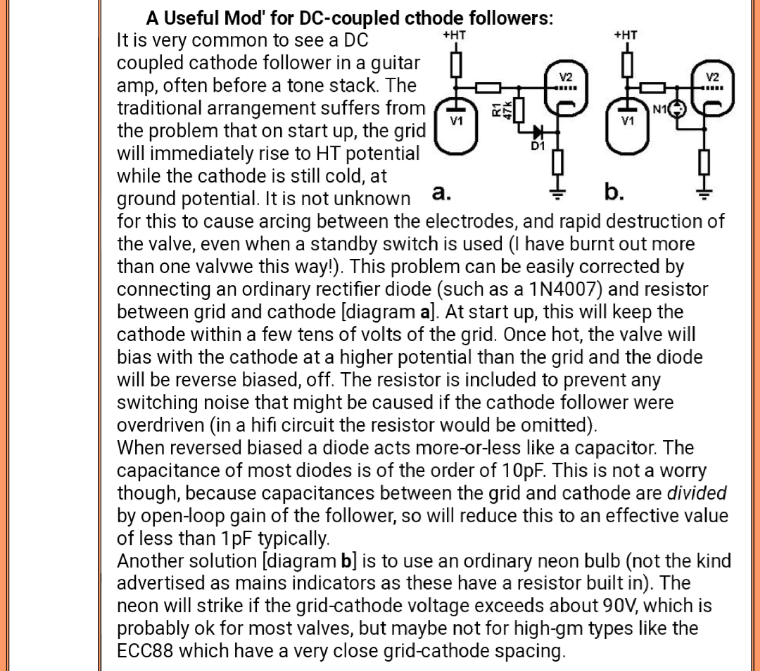

Would it be a possibility to use the protection diode per valve wizard?
I think the diode is present to prevent the grid from becoming too positive wrt the cathode resulting in arcing and tube death.
This situation arises during start-up (using ss rectifiers) for dc coupled cathode followers as you and valve wizard say.
However, I think, with my limited knowledge, that the same situation (grid too positive wrt cathode) arises during start-up in the El Cheapo. The slow start B- diode enables the 12at7 to heat up and start conducting thereby 'solving' the problem. I think it is a relative problem. Whether the grid goes up too fast or the cathode down too fast, arcing might occur. Same problem, same solution?
I'm a bit too stubborn to just believe statements without an explanation. Sorry.

With DC-coupled designs you have full B+ at the second tube's grid and ground potential at its cathode during the startup, when tubes are cold and don't conduct yet.
All grids in El-Cheapo are always at the ground potential in terms of DC, being tied to the ground by grid leak resistors and having all possible DC voltages blocked by the coupling cap - amp being off or on, powering up or shutting down, doesn't matter.
Yes, the 'T7 grids are at ground potential. However, an "instantaneous" on/SS rectified B- rail will result in the grids being positive WRT the cold cathodes. Once emission and conduction start, the CCS forces the grids negative WRT to the cathodes. I took no prisoners and "soft" started the B- rail. RES charges $4 for a 12AL5/UAA91 and $3 for a 6AL5/EAA91.

I think Eli in principle agrees with my reasoning. Are there any drawbacks to the diode?
I think I recall from the posts I've read, the tube is also free of 'hash' caused by ss diodes? Did I remember that correctly?
A vacuum rectifier can block SS diode switching noise. A signal tube or transistor is most definitely vulnerable to said noise riding on a power rail.

I'm familiar with all of that. I miss the bias resistor (and the grid leaks) in El Cheapo though.
You don't need that 12AL5 nor the transformer that go with it.Makes it still cheaper (El extra Cheap 😉 )
Just steel 5V from the HT (not much difference 350V or 345V).
No high negative voltage, no risk for the 12AT7 grid.
Bonus, no current adjust.
I decoupled the cathode resistors of the finals, I don't like the common resistor solution.
