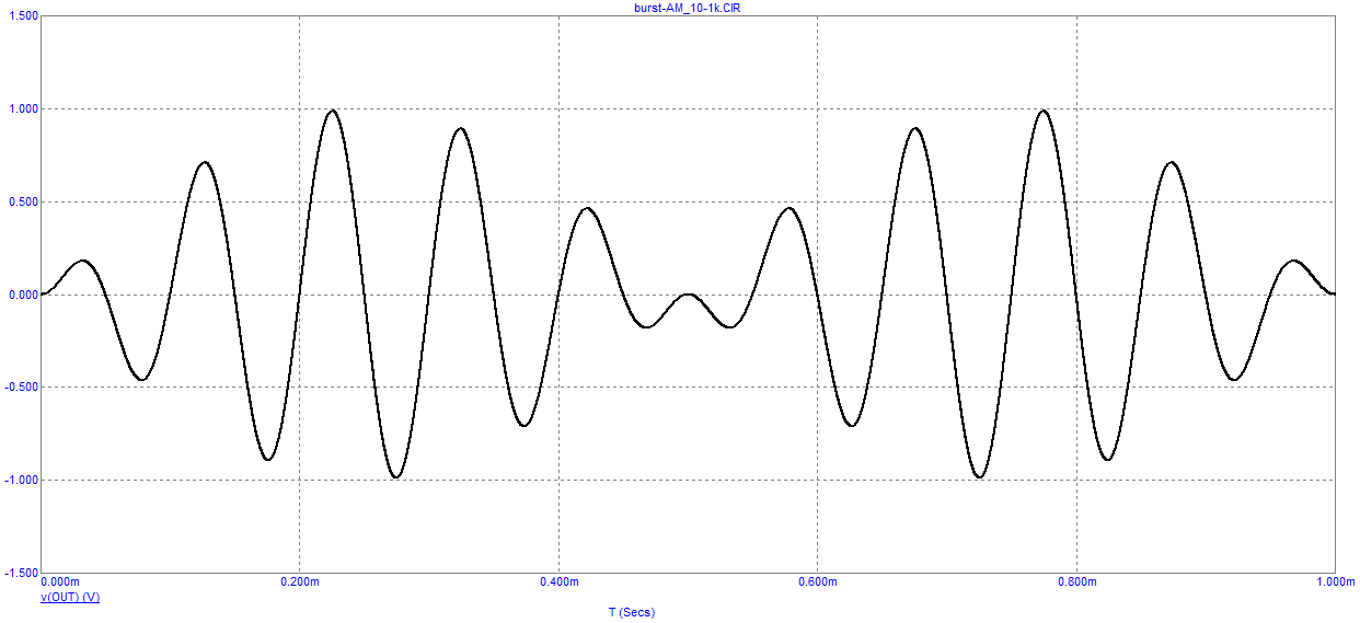

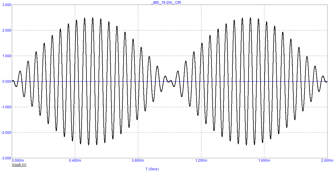

OK, why are these signals not suitable for tests?

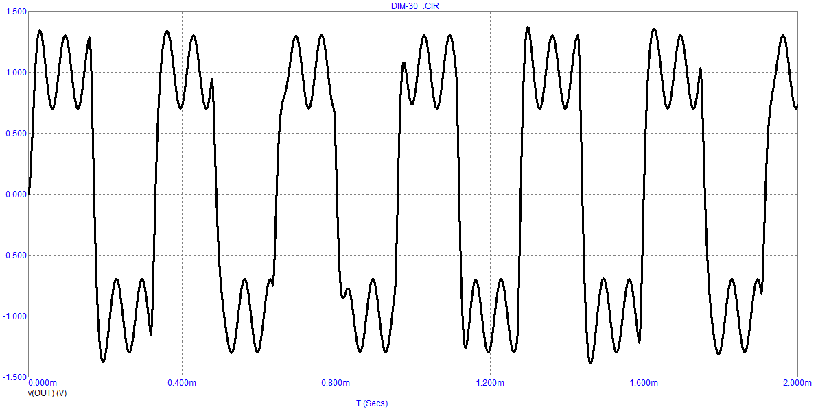

Let me give you a head start: look up 'DIM30 test signal' and the measurements done on the amp response to it. It is a technique used to measure the non-linearity of a device, and it’s designed to be particularly sensitive to distortions produced during transient conditions typical of audio program material.
Jan
The disadvantages of the method are as follows:
1. must be in stock an analog domain Audio Precision 2700 series analyzer. Not everyone can afford it.
2. The DIM measurement provided by the system’s Analog Analyzer is just an approximation of the DIM level specified by IEC 60268-3, because it only considers two of the nine intermodulation components specified in the standard.
DIM30 is a very realistic audio-like signal. Which is what we wanted, no?
Let's look at your signals for the simulation case, because that's where you see the results.
The first one is visually appropriate, since it is a common mixture of two sinuses. But the second one is not good, because you put it together with a break in the function and in the middle, where the amplitudes decrease to zero and increase again, you will have a step surge. Show the response of the same amplifier to both of these signals for comparison.
