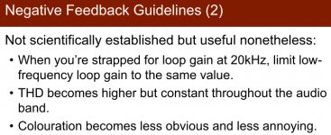

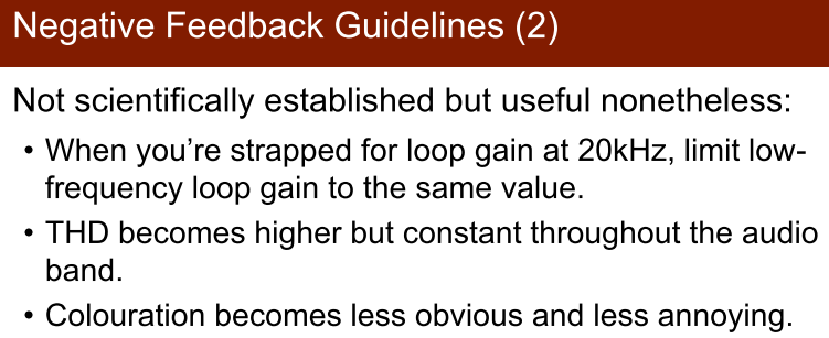

Graham and I are criticized here: they say you can't suddenly feed the amplifier with a sinusoidal signal from zero and watch how the amplifier reacts to it. Here's an example from Bruno of reversing a signal at the top of a sine wave. The test shows that in order to amplify the signal without distortion, the output current margin is not less than tenfold.
Here are the statements of popular authors about the first pole.
From myself I can add:
the first pole above the audio range ensures the constancy of the loop gain in the audio band and, as a consequence, the constancy of the output impedance, which has a beneficial effect on the sound.

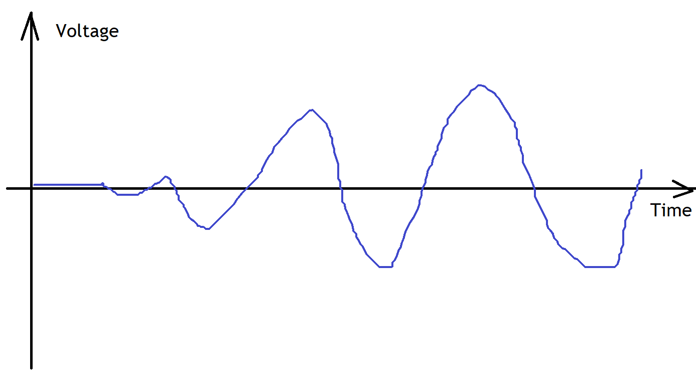

What if we increase it as fast as it can be? What about a test signal like I attached.
And please allow some speed (slew rate) margin also somewhat above the normal audio band.
As it's also very common to use a square wave for testing amplifier, why not to use a special
waveform for this test as well? Square wave is also not within the normal audio band.
And again: the reason to that is just to MAGNIFY the effect as it also COULD affect
But the main point again in this approach is not the extreme / unreal fast test signal but
the fact that the amplifier is tested in "real time" within a short time period and we check
for the amplifiers adaption capability (speed and cleanness) to this changing state vs test it
with a regular and continuous waveform in average after a lot of time let the system settle.
The exact opposite is on target: let's test this settlement process from the very begining.
