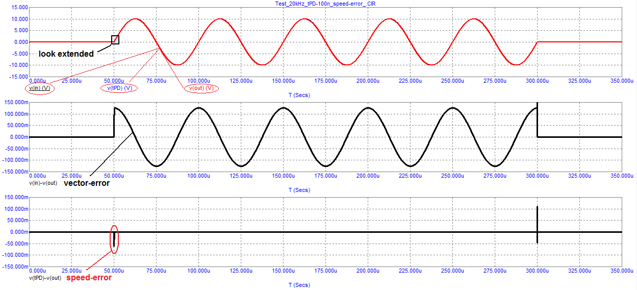

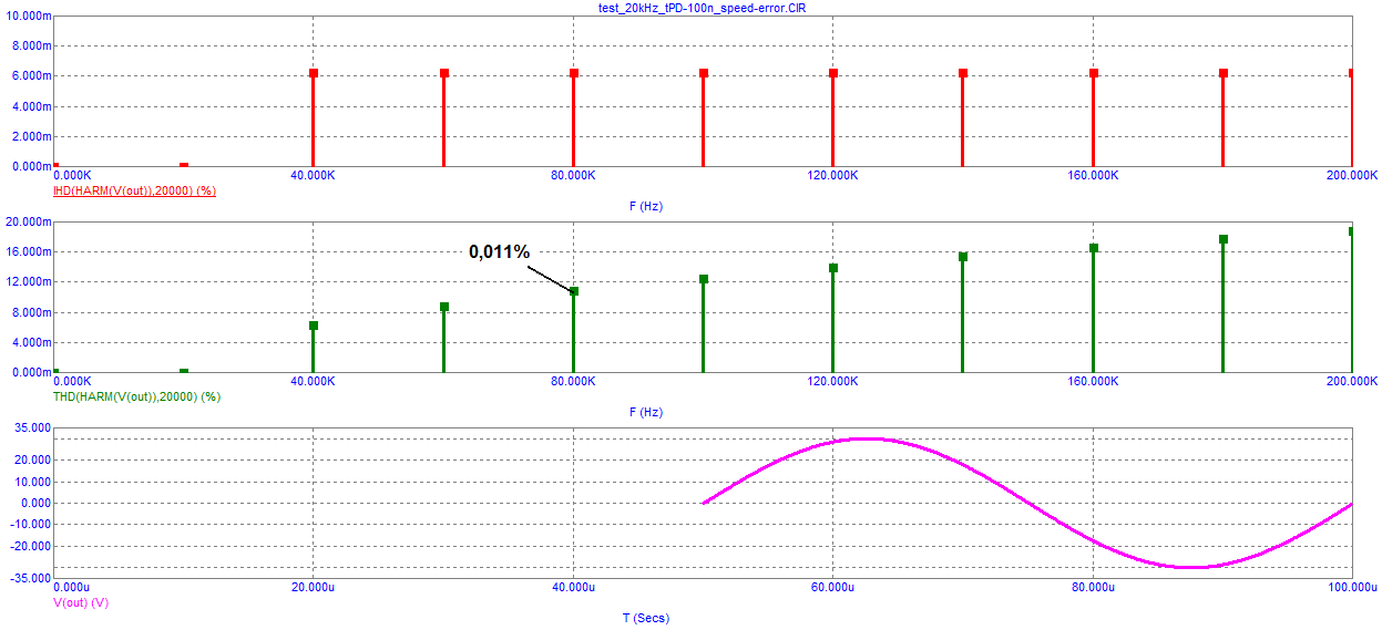

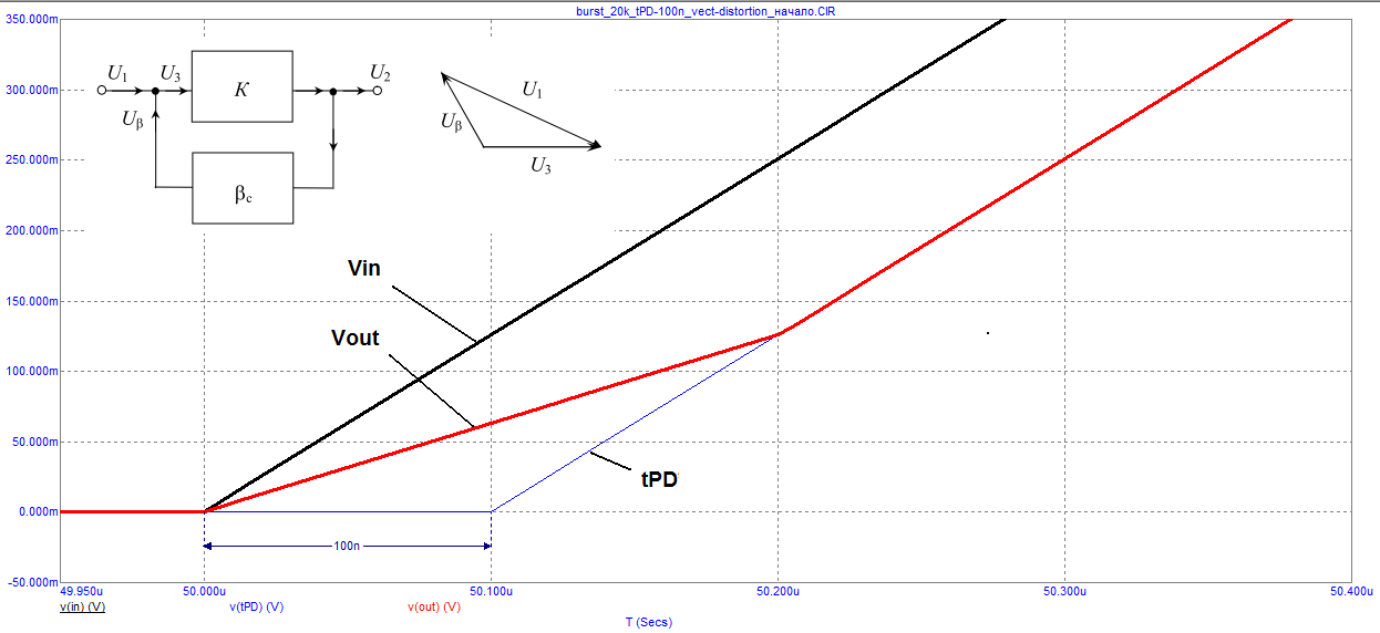

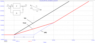

I have already shown that on a sinusoidal signal this kind of distortion appears at the beginning of the first period. Tests show a direct relationship between speed distortion and signal propagation delay time. To determine what level of delay is necessary to ensure speed distortion of less than 0.01%, I synthesized the signal using the sum of two ideal sinusoidal signals, one of which is delayed by 200 ns. The total signal is delayed by 100 ns, and at the beginning of the first period, signal distortion is formed, similar to the distortion that occurs in the signal comparison unit of a real amplifier. As shown by the result of measuring harmonic distortion, it is with a delay of 100 ns at a frequency of 20 kHz that the level of distortion is 0.01%. Considering that in real amplifiers, in addition to high-speed distortions, there are also nonlinear distortions, it makes sense to reduce the level of permissible high-speed distortions by 1.5 ... 2 times (up to 50 ... 70 ns).
unfortunately there is no one here to explain anything, the attitude to my posts is the same as to Graham's posts
