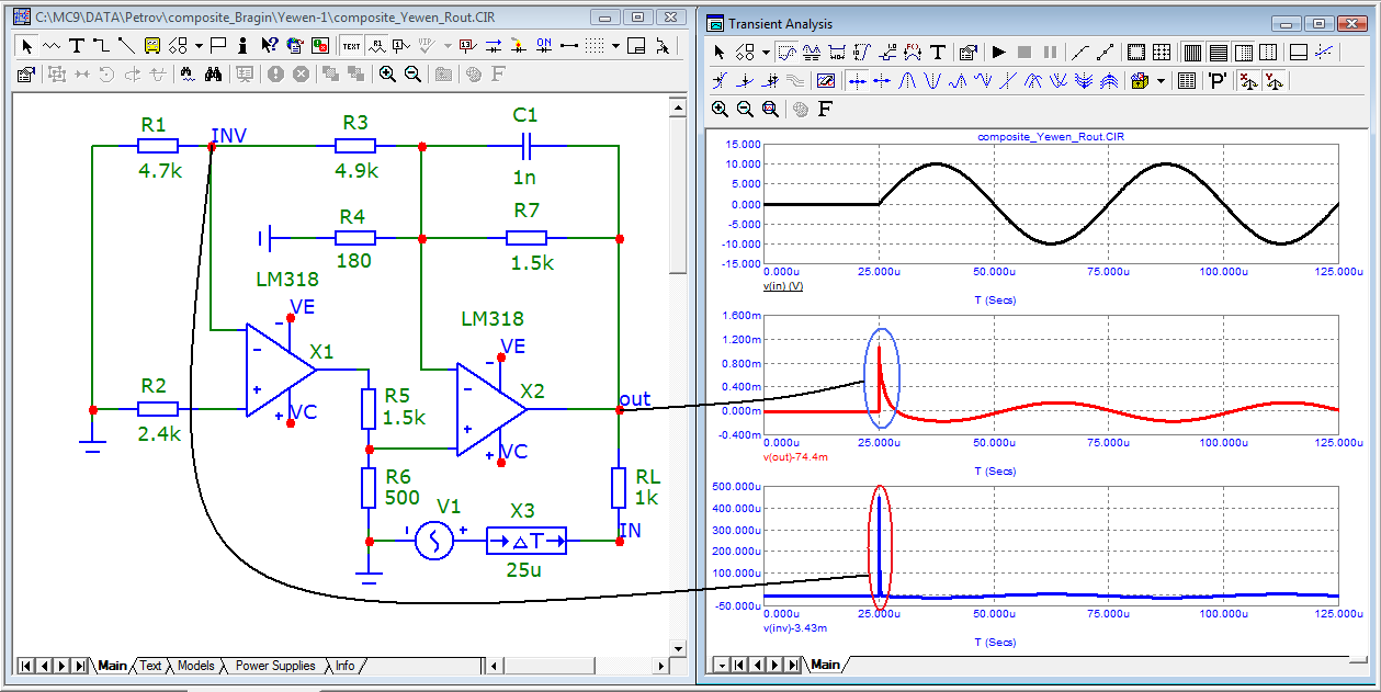

Graham recommended driving the signal to the amplifier's output through a load. This method is often used to measure the output impedance. His opponents did not seem to know how to do this, otherwise they would have learned more about the work of the NFB and would not laugh at him.

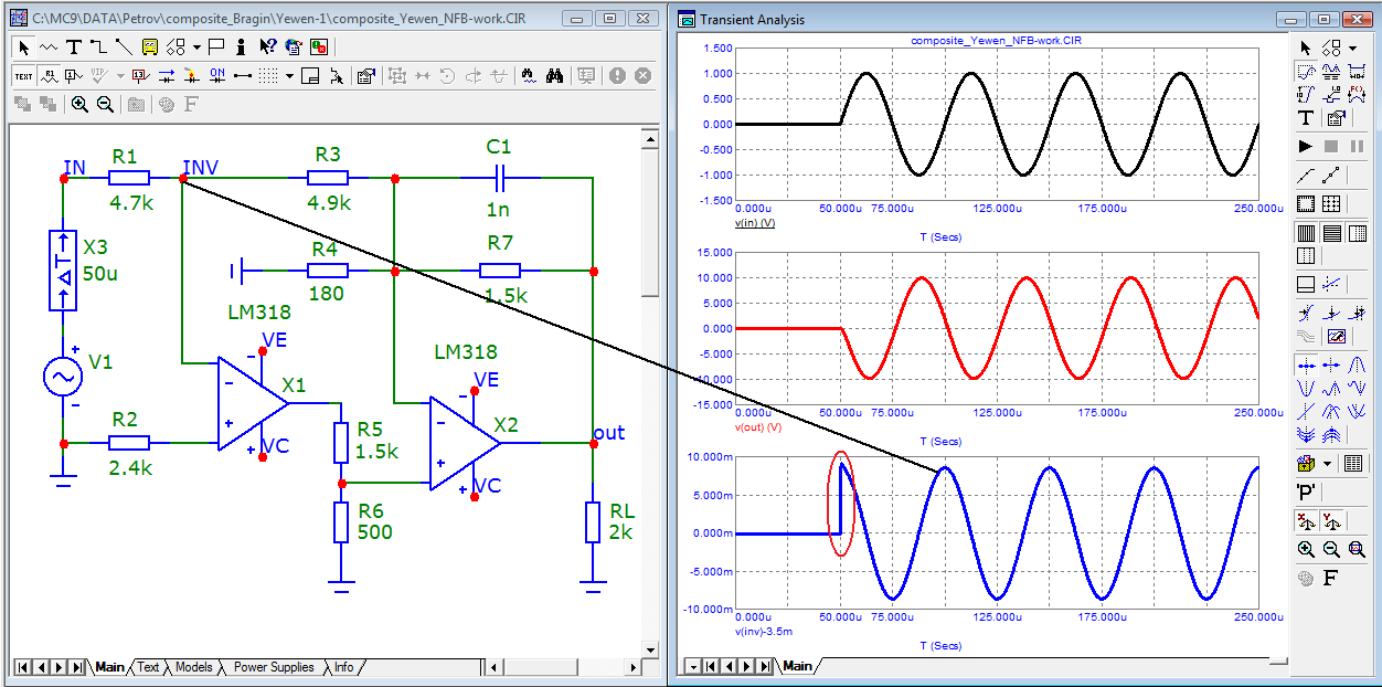

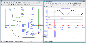

Here are a couple of tests that show that speed distortions are inherent in the very mechanism of NFB. In the steady state, they do not occur, speed distortions occur at the beginning of the period and at any voltage deviation from the sinusoidal one. Feedback works after the fact, with delay, with delay. And in order for the NFB operation to be invisible, the signal propagation delay time must be less than 100 ns.

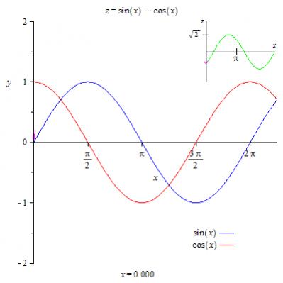

This parameter has now begun to be indicated in expensive prestigious reference amplifiers. The animation shows the result of the addition of sine and cosine voltages.

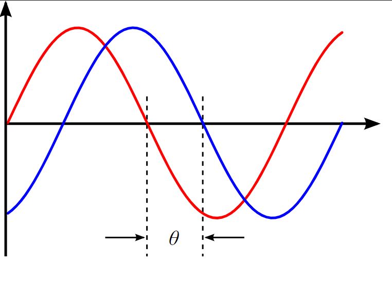

What if there was a positive phase shift, would you call it negative delay?View attachment 900092

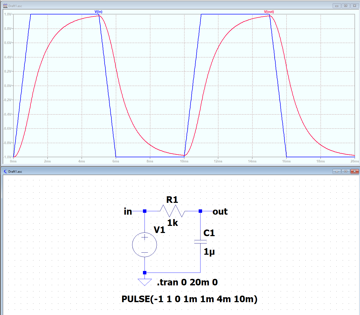

See attached. Lots of phase shift for the various spectral lines that make up the signal, but at the same point where the input wave switches direction, the output wave also switches direction. So there is no signal delay, only phase shifts, that vary depending on the frequency component in the signal.
I believe that it would be very hard to really understand the operation of nfb and stability unless you have a grasp of this.

It only looks like delay because you keep thinking that the top of each curve should somehow be at the same time point. That is the fallacy.
You are not seeing two sines, you see one sine and one that is phase shifted. Unfortunately, the phase shifted one looks just like the original, which happens to be the case only for sine waves!
One curve is phase shifted so the level peaks and zero crossings occur at different points in time.
But that is not the same as a delayed signal.

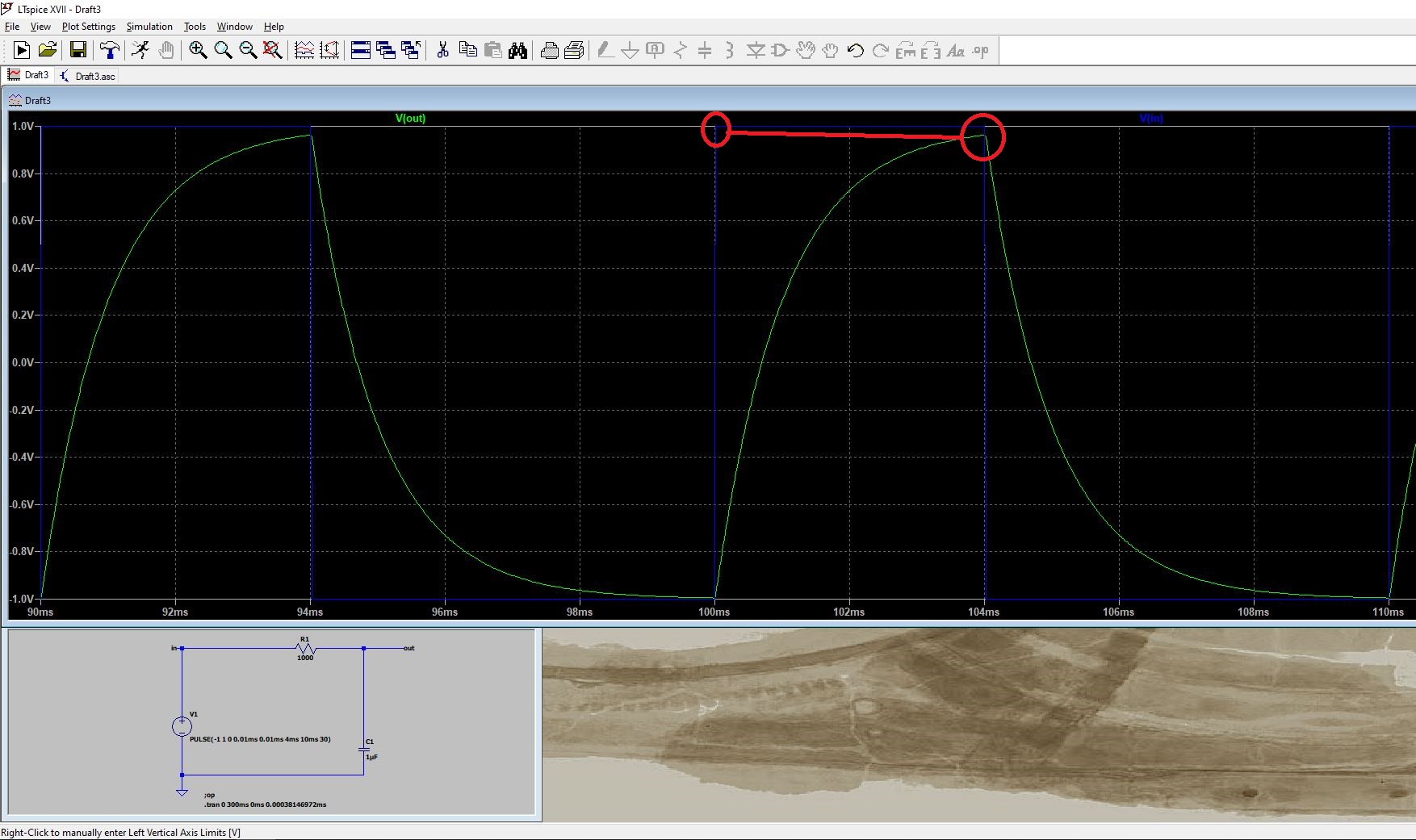

In this picture above the energy needed in (for an example) a feedback loop is still delayed 4 ms. Sure, you can see that the wave starts and stops at the same time but we need both volt and current at the same time to be able to do work (control an amplifier output stage driving a highly reactive load). Here the first initial peak does not give the feedback loop any potential to control the output due to the delay in total energy content - which peaks at the trailing end of the signal wave while it is needed at the leading edge. This is 4 ms delay of available energy - not voltage - needed to do its thing (in my view).
Are you aware what you are doing? You are inventing new stuff like 'feedback energy' to try to save your opinion which is wrong. Happens a lot - only very few people can make the jump and say - aha! I get it now!
Just keep thinking - you'll get it eventually ;-)
I am not inventing anything. I am pretty certain that "Volt X Current = power" is something someone has come up with before me... I am just stating that if phase is a difference between voltage and current being separated in time by a reactive element like a capacitor or a inductor, then in the example above there will be a 4 ms delay between when the feedback loop would need to control the output stage and when the feedback loop actually manages to control the output stage.
If there is no delay in energy in the LTSpice example above, what does the 4 ms in the simulated graph show? Why is the green curve still at -1 volt when the blue curve is at a full +1 volt? Is this not a lag of energy?
