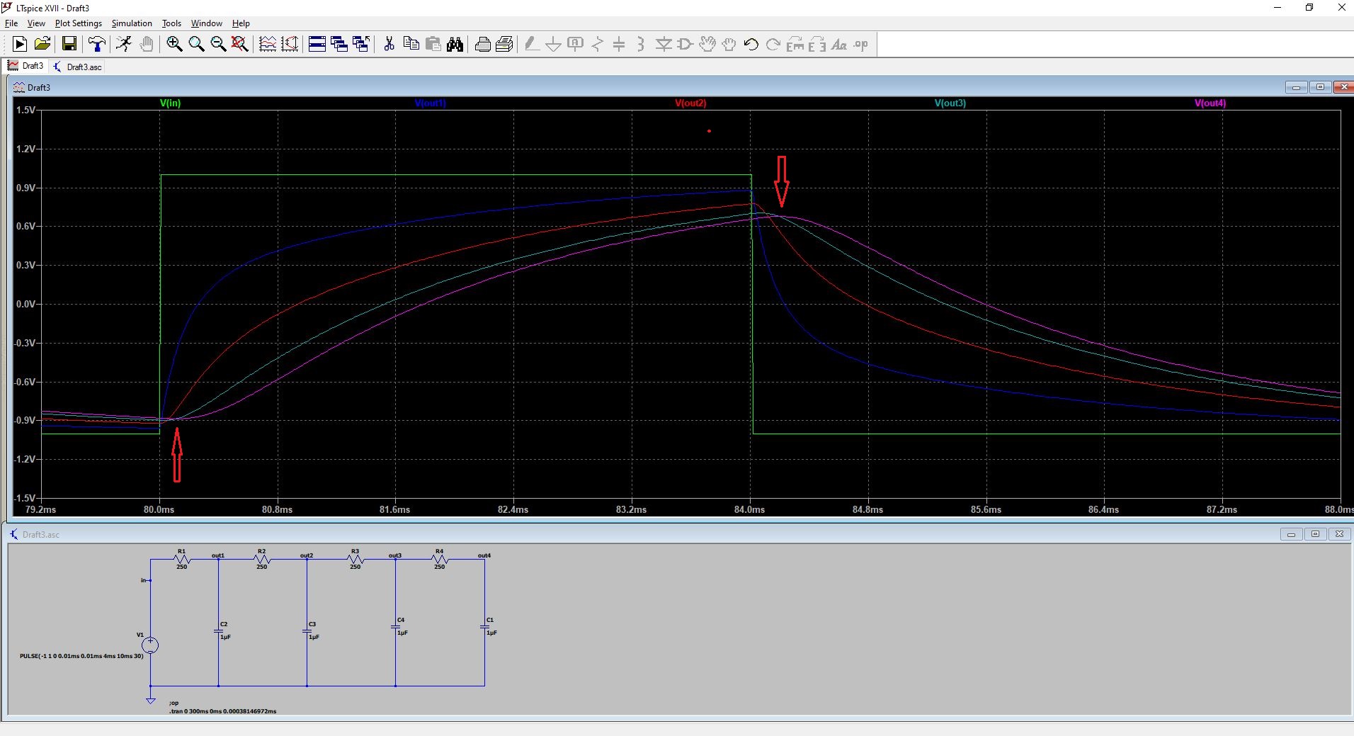

Your model does show something quite different once we start increasing the phase shift by increasing the order of the filter.
It seems like the whole filtered wave does not only lean heavily but starts and stops (or crosses the zero line if you prefer) with a distinct delay with the green square wave (input) as a reference.
The pink line is "out4" and the blue line is "out1".

Have you been talking to Joe Rasmussen?I am not inventing anything. I am pretty certain that "Volt X Current = power" is something someone has come up with before me... I am just stating that if phase is a difference between voltage and current being separated in time by a reactive element like a capacitor or a inductor, then in the example above there will be a 4 ms delay between when the feedback loop would need to control the output stage and when the feedback loop actually manages to control the output stage.
If there is no delay in energy in the LTSpice example above, what does the 4 ms in the simulated graph show? Why is the green curve still at -1 volt when the blue curve is at a full +1 volt? Is this not a lag of energy?
You should show the difference between each input and output. The input for out4 is out3.
And I have already mentioned a transit delay, which is minuscule compared to the apparent 'delay' of the phase shift.
But I am not interested further in this. I gave the pointers, up to you what you do with it. Best of luck.

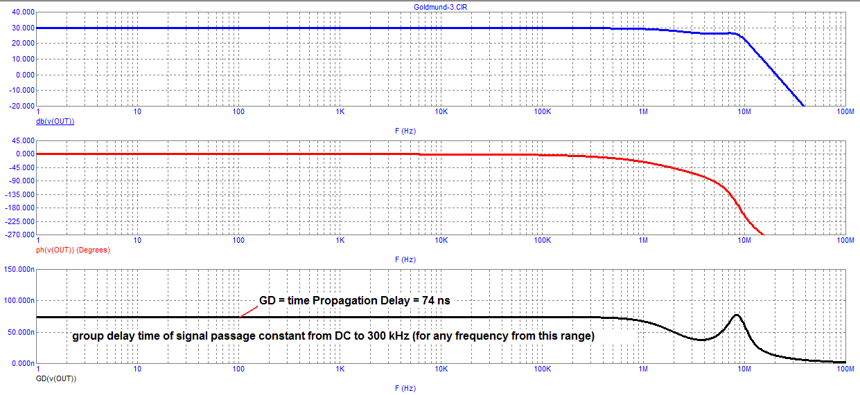

Here is the Bode plot of the younger Goldmund-3 model.
tPD = 74 ns from DC to 300 kHz

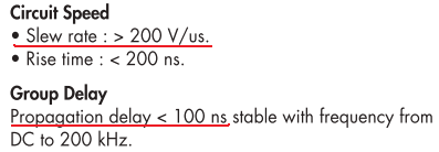

Dear opponents, finally understand the difference between phase shift (second graph) and time Propagation Delay (3 graph). In DC amplifiers, the signal propagation delay time is physically equal to GD. The older model is more powerful, but the parameters are similar, see figure
We already understand the difference. For a linear, time invariant system (like all audio amplifiers) the group delay is minus the derivative of the phase shift. The group delay can be made asymptotically equal to the propagation delay, but only for an all pass filter. There is no DC propagation delay or group delay, these concepts make no sense at DC.
Please stop trolling.
