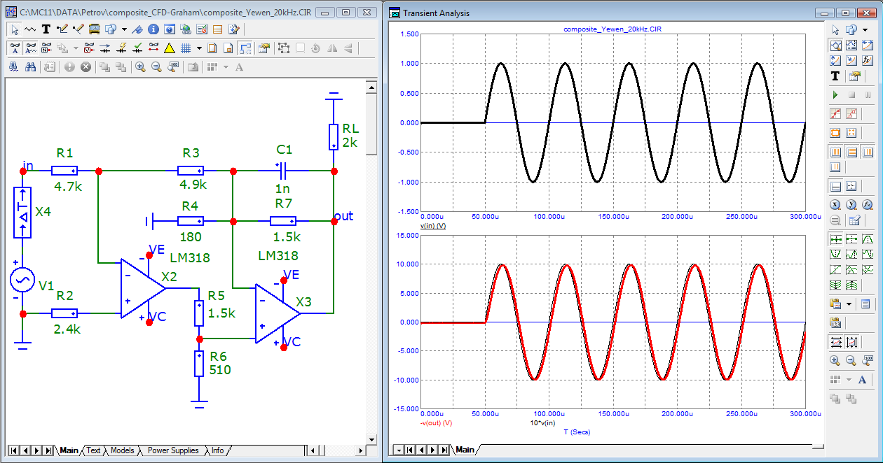

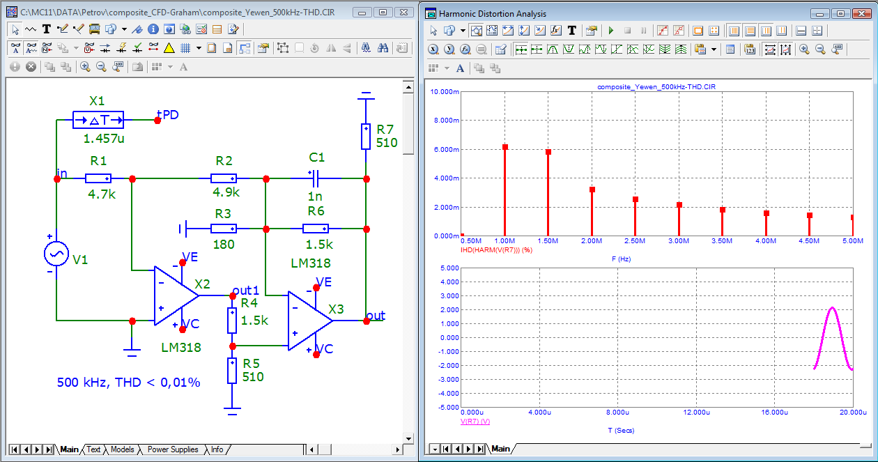

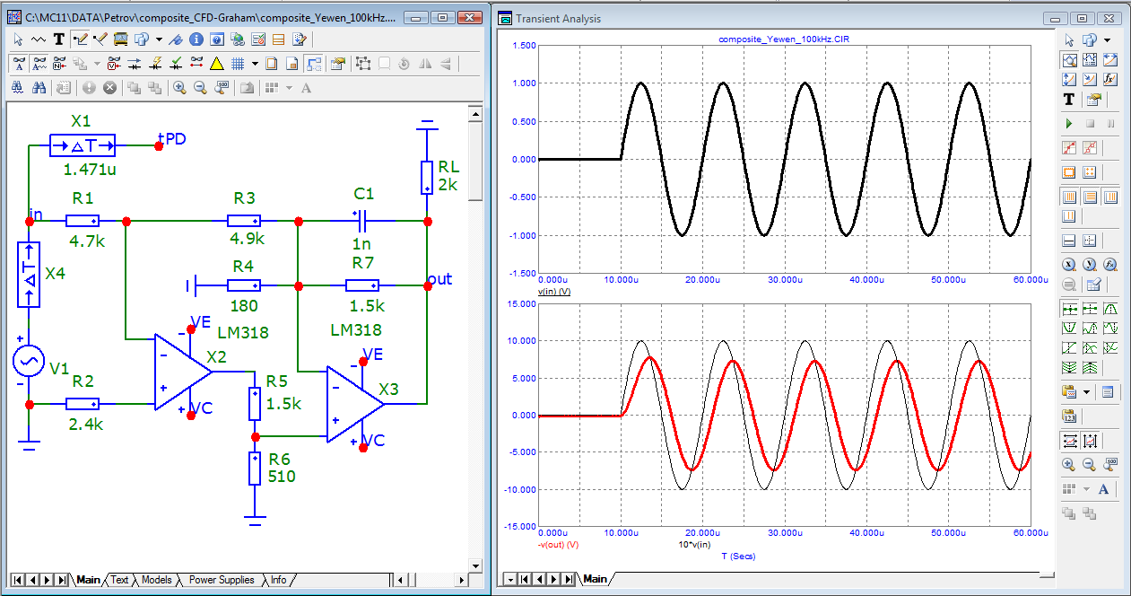

Here is an example of an amplifier that introduces predominantly linear distortion in steady state (amplitude reduction and phase shift). At 20 kHz, there is a barely noticeable decrease in amplitude and a barely noticeable phase shift. Let's increase the frequency to 100 kHz. Here we can already see clearly pronounced linear distortions. Let's go further and increase the frequency to 500 kHz (the period of 2 μs is comparable to the signal transit time of 1.5 μs). Here, in addition to the phase shift, we see a decrease in the signal in amplitude by more than 3 times. To make sure that there is no harmonic distortion in the linear mode, measure the THD level at a frequency of 500 kHz, it turns out THD <0.01%!

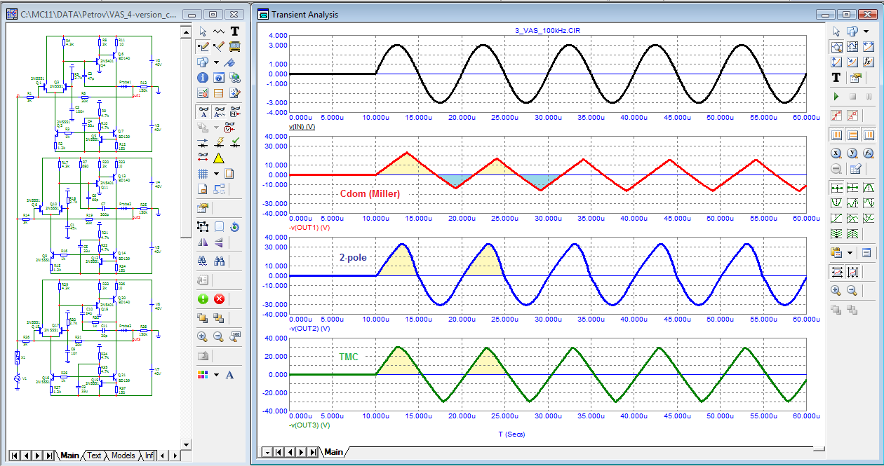

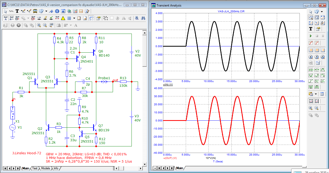

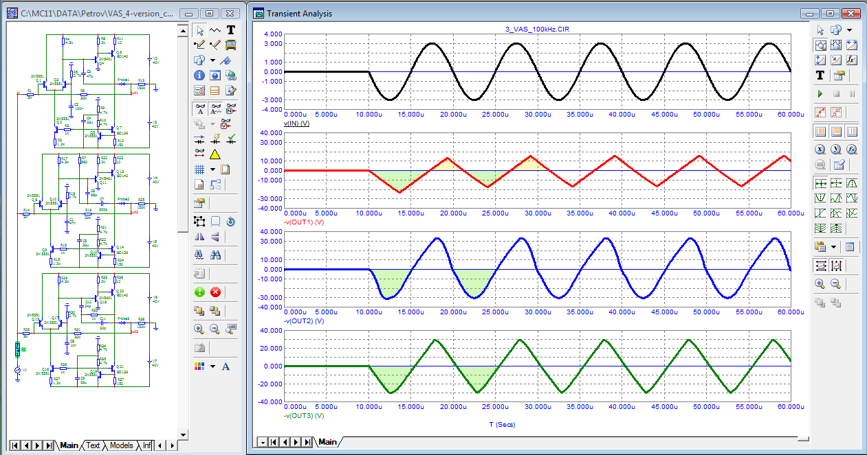

Some authors argue that TIM distortion does not exist, they say these are ordinary nonlinear distortions. In my opinion, TIM distortion is a dynamic distortion associated with a specific limitation of the slew rate of the output voltage, which leads to the fact that the output signal turns into a triangle. However, not all SR limited amplifiers are prone to this kind of distortion, as I showed with the composite amplifier.
Dynamic distortions significantly depend on the used correction to obtain stability margins. Only one of the 4 types of correction gave a positive result, and only one of the 4 options is capable of operating at a frequency of 200 kHz.
