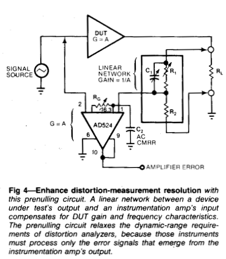

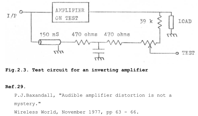

The classification of the types of distortions was put in order by Jiri Dostal.

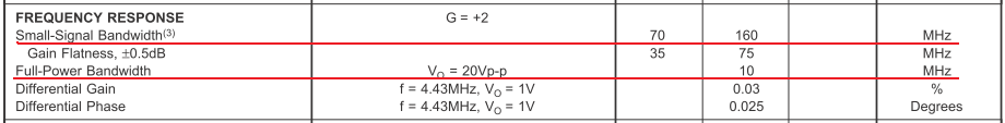

I agree with the statement in the first part. But the second part is wrong. GBW is measured in small-signal mode and it can be 7 ... 30 times more than the full power bandwidth. It is FPBW that is responsible for performance and is related to SR by the well-known formula:
SR = 2π fVp

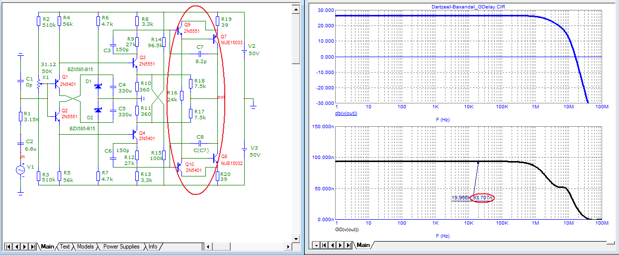

SR and its relationship with the type of amplifier correction
Bonsai, you can make sure that even with BW = 13 MHz the amplifier is slow
Your simulations look ridiculous. For some reason, you are trying to contrast the value of SR with Bruno's theses. It is assumed that the value must be appropriate. You are not trying to work with transistors in the TO-92 case on a load of 2 Ohms with an amplitude of 80V peak-to-peak, right? So why do you lower the SR to small values and try to prove something? All your examples are deliberately made by lame horses. Rather, you show ignorance of the issue under discussion.

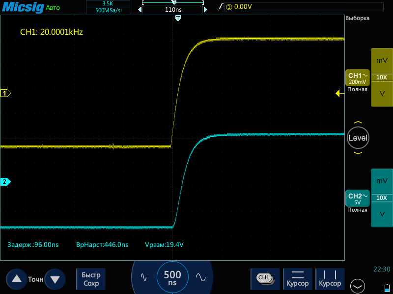

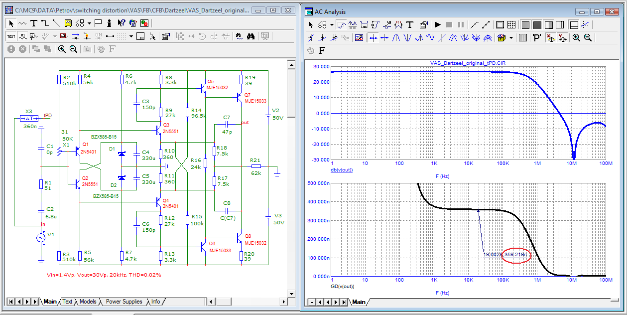

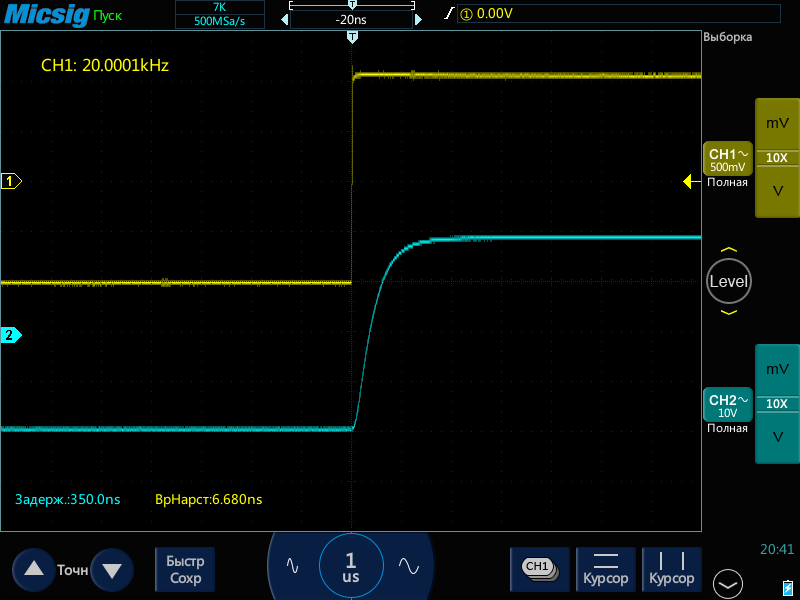

here is an example of measuring the propagation delay time in a real amplifier and in a virtual one
And what do we see on the waveform? The instrument automatically measured the latency on the level of the middle pulse. Can this be considered a delay time at all? The output signal must enter some kind of tolerance tube. Only then can we assume that we received a signal at the output. Open the video amplifier Datasheet for an example and you will see an entry like " setup time to 0.01%" - this will be correct. Multiply your numbers by 5-6 times. And this is still optimistic.
