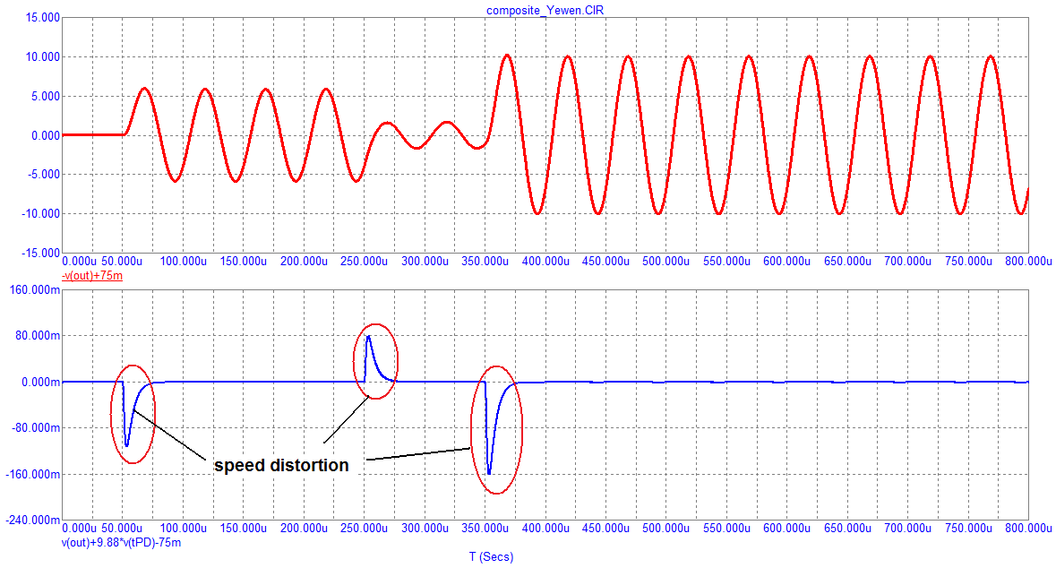

The problem with the signal that you describe in the .pdf is that again it is a start of a sinewave that starts infinitely fast. The reason that you only see it in the 1st cycle is because that 1st cycle is completely artificial and not a real life signal*. The answer is staring you in the face there: after that 1st artificial start, there is no speed distortion anywhere else, only a pure delay.
If you want to do it correctly, send the sine wave input signal through a low pass of say 30kHz (to stay with the DIM30). Then run your sim and use the output of the low pass as the input signal and check the distortion against that. You will not find 'speed distortion', because now you work with real life signals and the amp can handle that fine*.
The only thing you will see is a delay as you show in your .pdf after the 1st cycle.

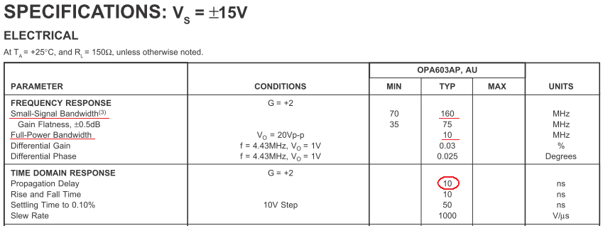

Any standard audio amplifier has a loop transit time of 10’s of ns. This is not the same thing as phase shift (a property of all reactive circuits)
You mean that any standard amplifier has the same parameters as this high-speed op-amp (FPBW, SR). The time Propagation Delay (tPD) is indicated for a gain of + -1. With increasing gain, the tPD also increases.Any standard audio amplifier has a loop transit time of 10’s of ns. This is not the same thing as phase shift (a property of all reactive circuits)

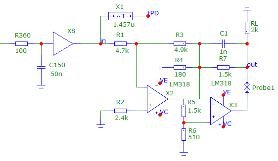

The scheme and test results are shown in the figures. I have already explained, I repeat again: no filtering does not save an amplifier with a long signal propagation delay. Note the amplitude and duration of velocity distortions. Their duration is commensurate with half the useful signal period. At the same time, there is no distortion in the steady state! Straight line, zero distortion.If you want to do it correctly, send the sine wave input signal through a low pass of say 30kHz (to stay with the DIM30). Then run your sim and use the output of the low pass as the input signal and check the distortion against that. You will not find 'speed distortion', because now you work with real life signals and the amp can handle that fine*.

This is the transient response of a low pass RC. Should it be considered as FCD?
In opamp and miller compensated amplifiers, the open loop F response is only few hertz may be a khz. When the transient reaches the output it arrives as -90° phase shift. The feedback will bring to the final phase shift, but in how long time? The input to adjust the phase needs an error voltage to charge the miller capacitor, mean while the output gets the same kind distortion as the crossover but only at the beginning the burst as piano note. I call this the blindness of an amplifier and it is the difference of the low pass transient and that of the amplifier. If the music is just few instruments playing each individual notes, no problem, if it is a choral or large orchestra , you can hear clearly the distortion. The music that I use since more that half century is the "Happy together" of the Turtles, most difficult ones are requiems of Verdi and Mozart.

So what you are saying is there is a delay between the input signal and the feedback signal and this causes ‘speed’ distortion because the amplifier feedback loop overshoots during this time?
You are heading into dangerous territory. This stuff (see below) and similar has been debunked by some seriously good engineers/academics:-
A Future Without Feedback? | Stereophile.com
The ‘speed’ distortion is perfectly explainable and is not some new mechanism. You minimize this type of loop overshoot by compensating the amplifier correctly and ensuring the loop BW is adequate. If these things aren’t right then that’s because of bad design.
An easier way to test for this is to feed a very fast rise time square wave into the amp and then look at the LTP output current. There will be an overshoot time and magnitude which you can measure and minimize through compensation and input stage degeneration.

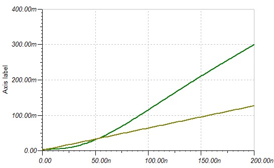

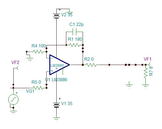

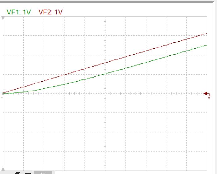

I was also convinced as you that the quality of amp depends upon the delay. I will found my posts advising composite amp designer in that direction. This is the LM3886 with gain of 2.8, delay 25nsWell, judge for yourself. You have brought a low-pass filter with a cutoff frequency of 160 kHz and having a group delay of 1 μs. I have already sharpened my attention several times: the most important parameter in the amplifier is the time Propagation Delay, which should be no more than 50 ... 70 ns. If you put such a filter at the input of the amplifier, can you get the total group delay as needed? Of course not. It is no coincidence that I gave the parameters of the Goldmund Telos 5000 amplifier, which has a tPD less than 100 ns. Nevertheless, despite the astronomical cost, this is far from the best amplifier in terms of sound quality.
I have another amplifier posted that has 10ns and is my best sounding amp superior to SET 300b. But , I did notice if tube amps don't have this defect in sound, because their open loop response covers all the spectrum, by this the feedback doesn't need to adjust the phase. In other words if you have an opamp or power amp with open loop response over 20khz , JLH 30khz, you don't need to get concerned about this type of distortion.
