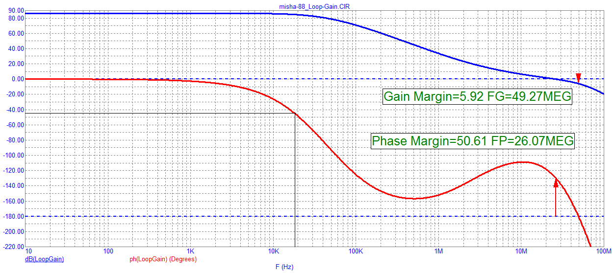

You are arguing that only the full power bandwidth and slew rate produced good sound, forgetting that it also increased the depth of feedback. The rate of increase should be appropriate to the task, but it will not be enough for lunch)) Enough to isolate the parameters and attribute all the merits to one or the other.... I had to stop at a Russian-made microcircuit with external correction circuits. According to the typical connection scheme, the FPBW was also 50 kHz. After experiments with correction circuits, it was possible to expand the full power band to 450 kHz. To ensure the technological headroom, the FPBW was reduced to 350 kHz. Only with this version of the amplifier, the tape recorder sounded as desired and began to differ favorably in sound from tape recorders of a similar class.

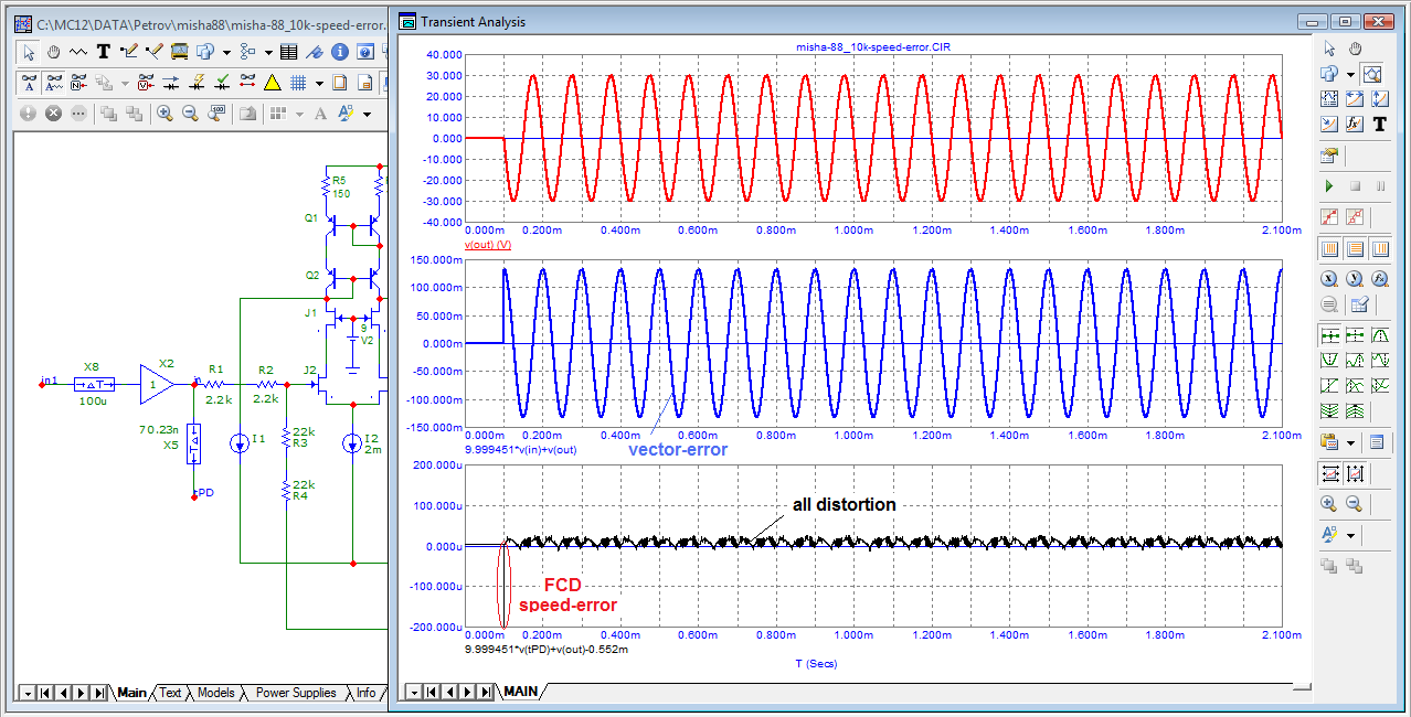

Anyone who understands sound and circuitry (understands the nuances in the work of amplifiers) today develops these amplifiers:

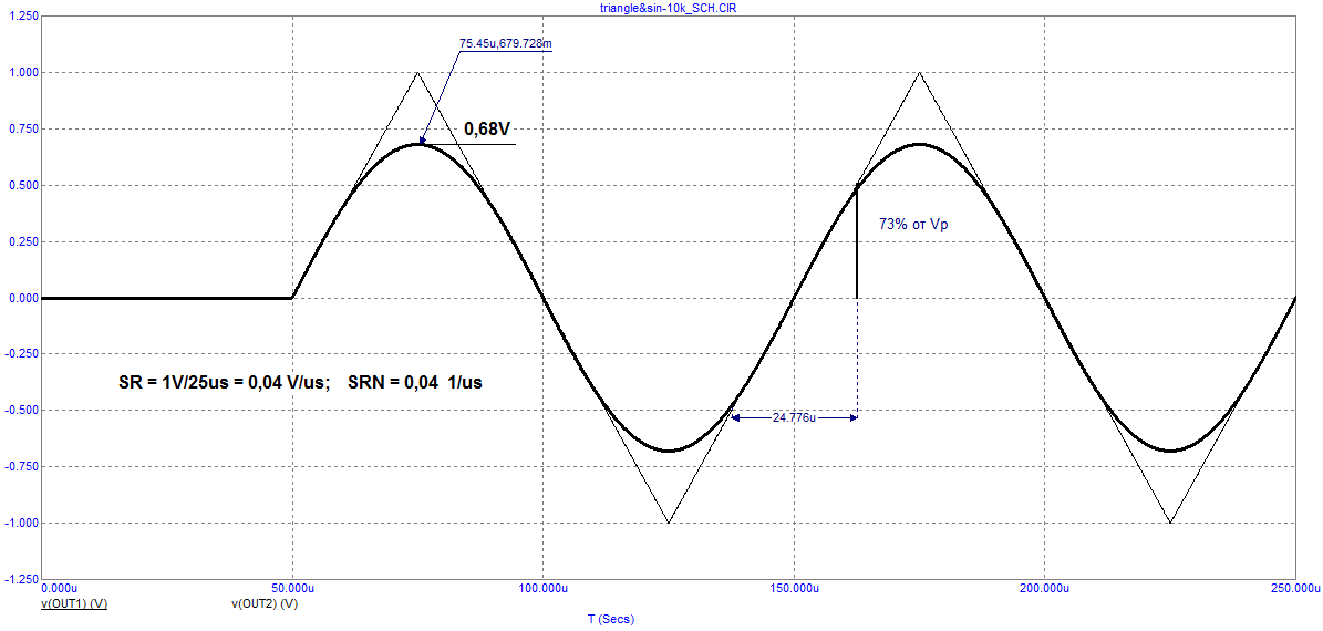

As can be seen from the oscillograms on the stationary signal in the steady state, there are no speed distortions, there are only nonlinear and crossover distortions and speed distortions only at the beginning of the first period (FCD).

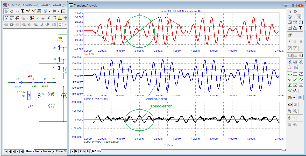

It is enough to modulate the signal and distortions immediately appear. The highest rate distortion is in the middle of the 1 kHz baseband signal, where the modulation rate is highest. And although at this point the amplitude of the 10 kHz signal is minimal, the rate distortion is maximal. And this is on the simplest signal. Here is an explanation of why microdynamics is disturbed in amplifiers with a long signal propagation delay time, high-frequency signals of small amplitude are clogged with speed distortions.
the real sound signal is much more complicated, if of course you understand anything about it ...So you are simulating an impossible signal. so what?
If you understand so well, then explain how the carrier frequency abruptly changed the phase in the opposite direction. What linear circuit can pass such a signal through itself without distorting it?the real sound signal is much more complicated, if of course you understand anything about it ...
In addition, our ear also has its own inertia described by bandpass filters when constructing equivalent equivalent circuits. Do you think such a crazy signal is able to reach the neurons in their original form?
You are using the term "velocity distortion" from the book by Jiri Dostal, but you did not bother to read it carefully. For example, the author conducts an analysis with consideration of the input-output voltage delta (velocity, vector and phase errors). But it is not clear why you grabbed them, because we only listen to the output signal without reference to the input signal. We can only be interested in the derivative of these parameters. However, in the linear mode of the circuit, it is negligible and appears only when excited with a step signal, which you so skillfully disguise under the guise of various ingenious test signals. But the essence is the same - a latent step effect with piecewise signal approximation.
Speed error? This occurs where the signal is smallest. I.e. less probability of slew limiting. This analysis would mean that RIAA equalization and its subsequent inverse wouldn't stand a cat's chance in hell of working.

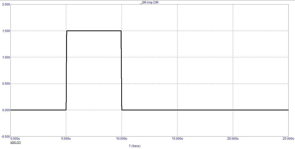

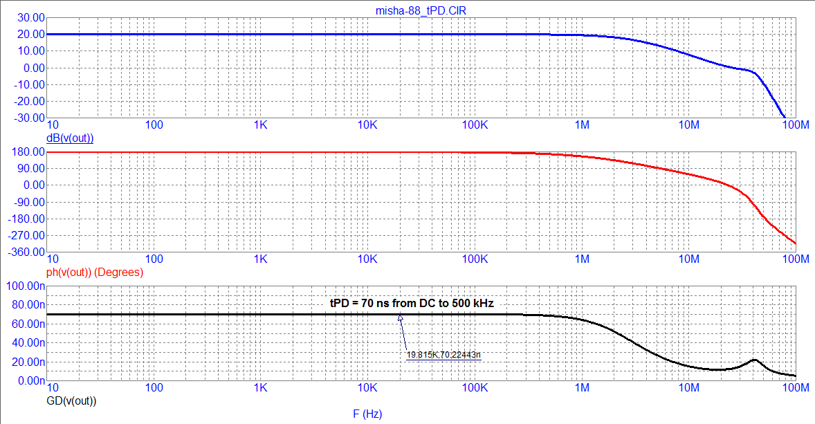

If I understood correctly, Graham was surprised: why a suddenly starting pulse can be used to measure RT and SR, but to check the quality of the gain of the first period, it is impossible to apply a suddenly starting sinusoidal signal with a frequency of 10 kHz.
After all, if you take a typical amplifier for home use, then its peak output voltage usually does not exceed 30 Volts, and the slew rate is about 0.8 V / μs, which is "tough" even for the "slowest" amplifier (the slew rate of the triangular signal and that less - only 0.6 V / μs). Graham suggested only to measure the parameters of the first period and check how these parameters correlate with the sound quality of amplifiers. Instead, they began to ascribe to Graham that he does not understand anything in theory, they say there is nothing to watch linear distortions. In response, Graham revised the 600 pages from 1980 in New York and did not find such a term as linear distortion, he found only the term linearity, which is not the same thing.

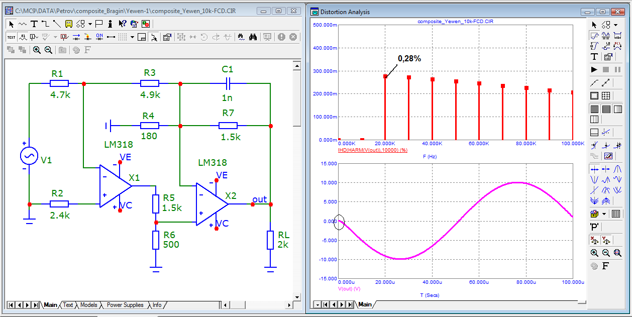

For those who don't deny its existence, this is where First Cycle Distortion observation will show on the simulator which amplifiers are capable of clean dynamic reproduction
If FCD "is just the normal" then why not study it?
I suggest that denying the use of first cycle observation is to deny insight into amplifier circuit operation.
Many solid-state amplifier designers would get a surprise if they set thd performance aside for just a moment and studied the first cycle (dynamic linearity) behaviour and output characteristics of their own creations.”

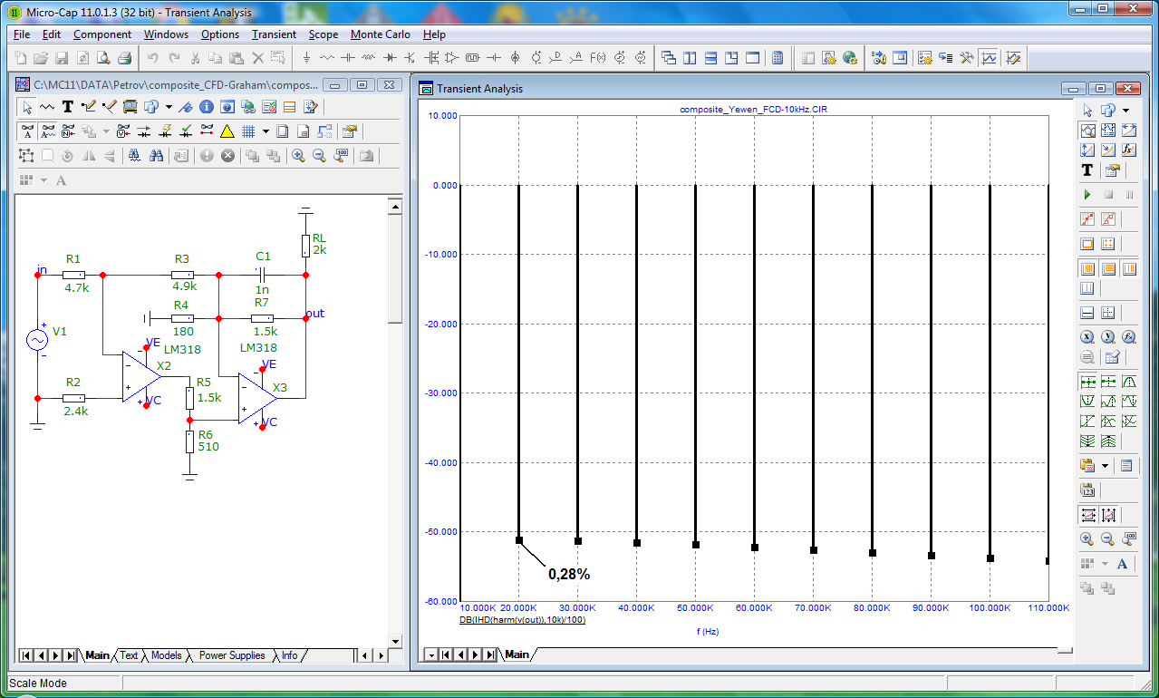

microcap software version 9 allows you to measure THD at any period. This feature is not available in older versions of the program.
However, in older versions of the program it is also possible to measure the spectrum of distortions in the first period. Let us check the distortions of the previously considered composite amplifier in the first period using MC9 and MC11.
