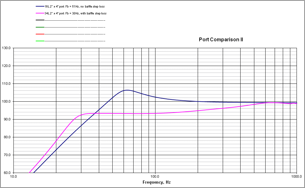

Great, that's helpful. So that's approximately 16L, tuned to 51Hz which will give you the blue curve in the graph below and that was giving you about a 6dB boost between 60 and 70Hz (baffle step loss is not included since I figured you probably had it on your test bench or something so the bass was getting boundary reinforcement which negates at least some of that loss).
Violet curve is from your plywood cab with the 2" x 5.75" port again and with the 6dB baffle step loss. So you should have heard a pretty big difference between those 2.

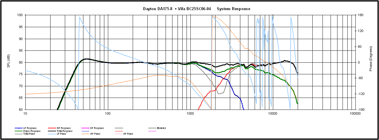

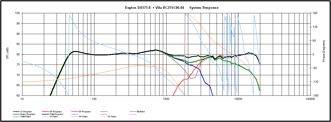

Given how it's becoming apparent that the bass is important to you, I just went over the xo a bit, simplified it and changed the baffle step compensation from 4dB to 6dB by increasing the woofer inductor just a touch and dropping the tweeter level a little more. The response ends up a little flatter although the driver phase in the xo region isn't quite as well aligned as before but I think it's a good compromise. So I'll re-post all the info to be clear.
First is the parts. All the caps could be non polarized although the tweeter cap of 6.8uF benefits from being higher quality. The bigger inductor can be iron cored while the other 2 can be 20 gauge air core. It's good advice to get extra resistors because these are values that can be changed to suit your tastes. So maybe get 1 x 5ohm value and then a bunch of 1 0hm values that can be added and subtracted in series and parallel to get to the values you want.
The LCR notch filter circuit on the woofer after the xo is the optional one. You may or may not notice the difference. I can't say for sure. Here the resistors and the cap could be modified to see what works best, so same as above for the resistor (5ohm +++ 1 ohm) and you could get a 50uF plus 2 x 10uF to try 50, 60 and 70uF if you want, although I think it'll work nicely as is (ie at 60uF). I had an optional LR circuit on the tweeter last time around but by changing R1 from 4ohm to 6ohm the rising response on it seems to be sufficiently taken care of that you don't need it any more.
For this sim, I used the bass response from 28L tuned to 45Hz with the walls covered with insulation so you can see how that looks. Doesn't affect the xo. There are many types of insulation that you can use. Heavy felt if you can find it. Some kind of open cell foam if that's easier. Thin 1" or 1.5" memory foam mattress toppers work well and they're easily found at Wallmart in my neck of the woods. About $40 for a twin, I think.
Did I cover everything or miss something again? Oh yes, the cross over frequency is where the blue and red curves intersect - about 2600Hz. The way that the response of the DA175 falls off above 1000Hz won't let it be crossed as high as 3500Hz.

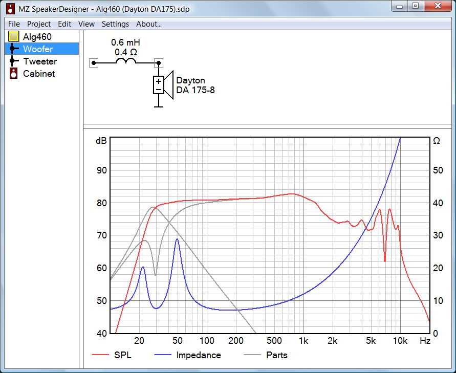

The upper impedance peak of the woofer should be at 50 Hz in your current setup, but you measured 70 Hz, that's an indication something is wrong indeed.
Attached a simulation of the Dayton in your cabinet (volume 1.3 cu ft, port 2" x 5.75").
Thanks for that simulation. You are probably right. If you read my last post I'm finding something is very wrong with the port. The cabinet is sealed everywhere but the baffle is in fact just screwed on.
