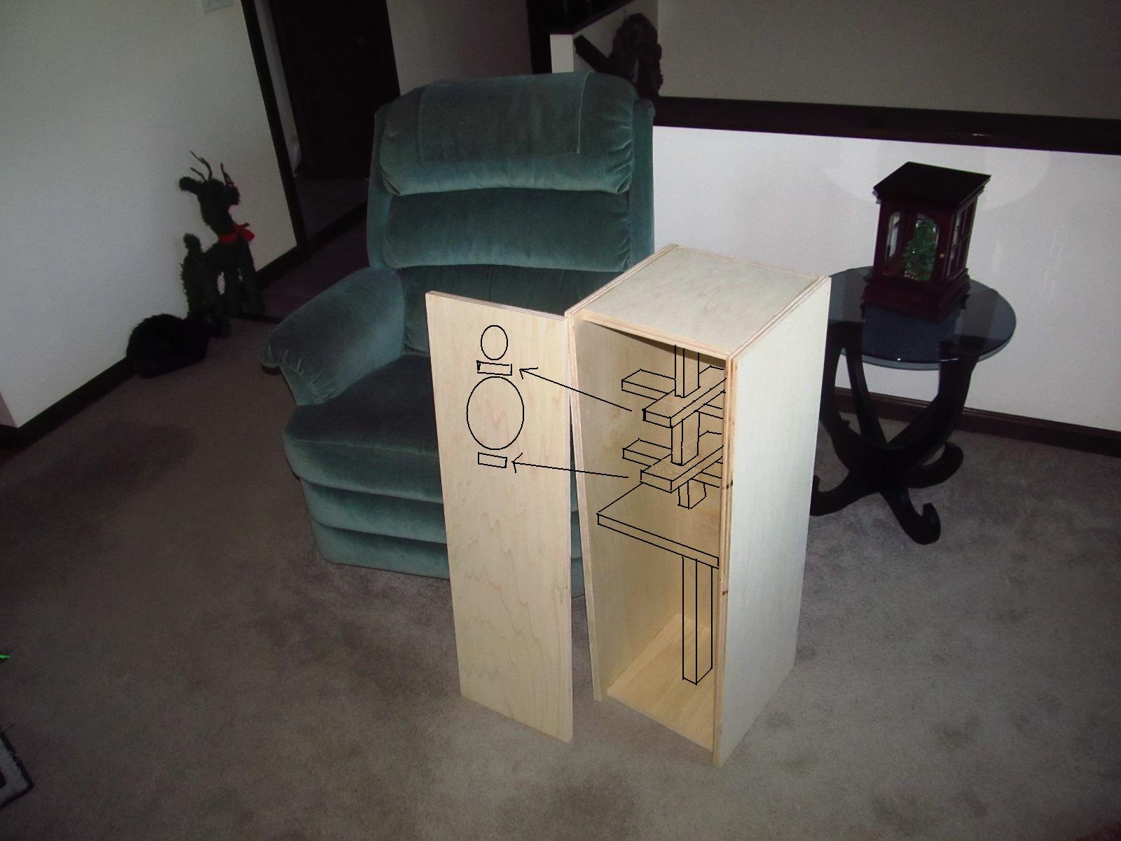

Could use some bracing in there 2 or 3 of these.
3 of those? What am I building here - a battleship? 😉 Thanks for the info.
Yes three - I'm doing the same thing today - btw

ODougbo, don't forget that Tony only wants to use about half the cabinet to start with. I'm unsure if the bottom half would need bracing as well.

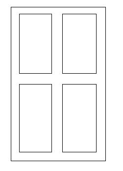

Tony, bracing does make a difference - cabinet panels can act like drum skins at the right frequencies and resonate loud enough to add to the overall sound. The 'window' style braces that ODougbo posted are a good method. Another way that might work for you are cross braces that are glued together in all 3 axes. I added a very quick little sketch to your picture below. That's the minimum I would use. Left over strips of plywood about 1 1/2" wide would work fine.

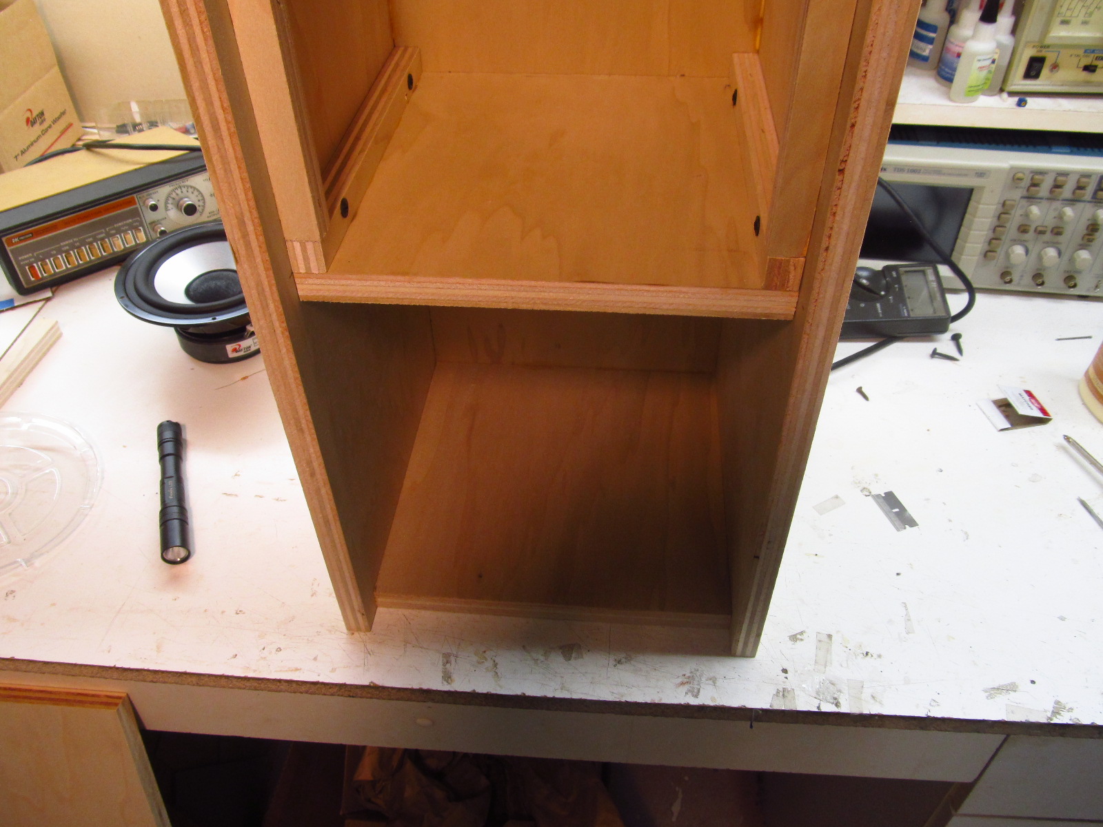

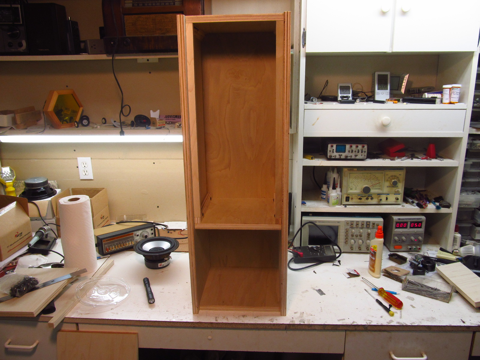

Well this is where I'm at. (see pics). I got a partition in there to bring the volume down to about 1.3 cu ft and added battens to allow the baffle to be screwed to and removed if needed. Just got to add some "ODougbo Braces" or "jReave" Braces. If I go with the "ODougbo Braces" I'm just going with two of them. Before I decide which method, what is the purpose of the one big hole and three smaller size holes?
Looking at this now, I'm thinking that if I ran the boxes through the table saw and removed the 3/4" "inset" I have on the sides, I could use some 3/4" quarter round molding on the edges to get the rounded edge. Might look nice too.

Again, I'm not 100% sure that you are going to notice the difference with or without the roundover. However, yes the quarter round will work quite nicely - it's been done before. 3/4" will smooth things out a tiny bit more than the 1/2". Another thought that occurred to me was to run the edges through the saw on a 45 degree angle if you could make your finish work with that but maybe the quarter round is easier and will look better?

Re braces - I kind of like the 2nd type of window braces ODougbo posted better but with vertical pieces of wood in between them right in the center so that the window braces' cross sections (+) can't flex and then the top panel is braced too. The picture I drew first I thought might just be simpler for you.
Keep in mind with the quarter round and the separating panel, the enclosure needs to be air tight except for the port.

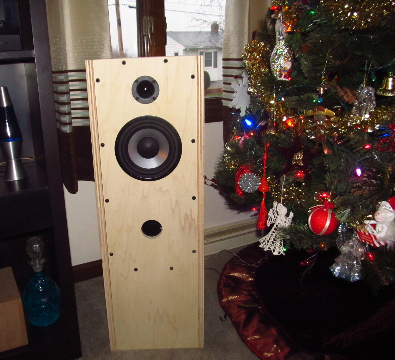

Help. I cut my holes in the baffles and just for fun put one all together - still no braces though. I hooked one of these up - no tweeter connected, no crossover and just a .6mh inductor in series to the DA175. Somethings wrong. This thing has no bass - zero - nada. It sounds like an old pocket transistor portable radio with the exception that it can play quite loud an clear - just no bass. I also tried a placing 5.6 uF cap across the DA175. No change just a shift in overall tone.
As far as the port, I mis- measured the diameter of the PVC pipe and made my hole 2 1/4" instead of 2 3/8". So for now what I did is hot glued a 5" length of 2" ID PVC to the back side of the baffle behind the hole.I guess that would mean I have a total length of 5 3/4" which I'm sure is slightly too long.
Keep in mind that back several posts ago I mentioned , when I got the DA175s in, I made a makeshift ported enclosure of about .6 cu ft. That ones got some really good bass. On that one the woofer is close to the floor. Does that make a huge difference. I hope not.
Any ideas? I'm stumped. Heres a pic if it helps
