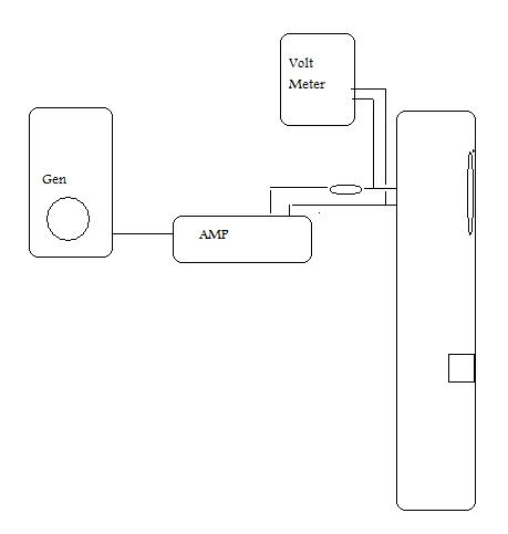

Tony,
This is what I do with every BR speaker
You'll need a load resistor (can just make one).
The resistor will exaggerate the box tuning (should be near the 39hz). Just sweep the generator and jot down the two peaks and the valley frequencies; jot down the peak voltages also.
Also a good time to check out the bass response, check for knocks, air leaks, etc.

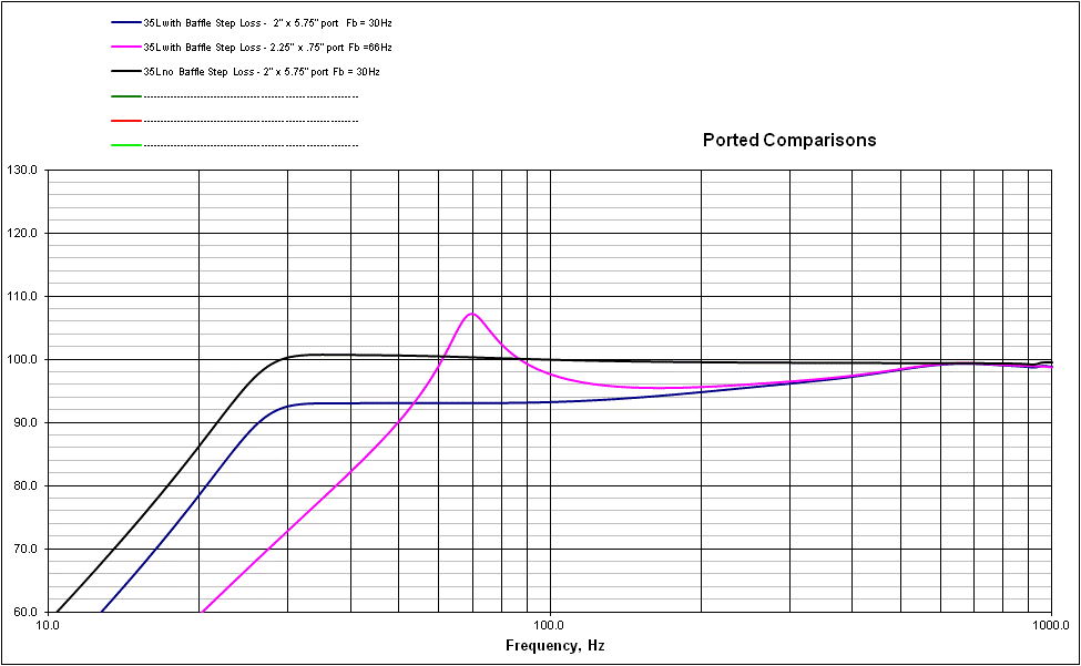

You have about 35L with a 5.75" x 2" port and no xo to compensate for baffle step loss. The bass stinks.
Layed on the floor, baffle step loss in nullified and the bass is back. Is it enough or is it just ok?
Take the port out and now you essentially have a .75" x 2.25" tiny port and you hear more bass but it's not very satisfying.
Seems to me that you just discovered that you can very much hear the effects of the baffle step loss and different box tunings.
The 1st graph below compares each of these responses. Blue shows no baffle step compensation so the bass is going to be 6dB lower than the mids and thus unsatisfying. Black is similar to the boost from the floor working in conjunction with a much different baffle step loss point because the baffle width has also just changed from 11.5" to 34" by laying the speaker on its side. Better. And the violet shows a large 70 Hz peak from the wea little port the plywood provides that gives the impression of more bass but isn't really doing a very good job of it either.
So the take away is that once you add in a baffle step compensation circuit the sound is going to be more like the ported version on its side on the floor. And again, if your hearing is actually a little weak in the bass frequencies, then choosing an alignment that gives you about another 3dB boost may be the way to go.

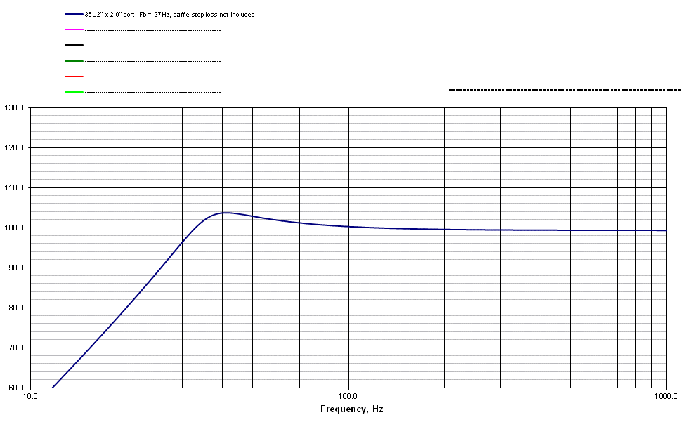

I've been suggesting 28L tuned to 40Hz for a single woofer. The second graph shows just about the same response - 35L tuned to 37Hz and this is with the walls covered with foam. Port is 2" x 2.9". Try your currently ported version on its side on the floor and then maybe compare it with this shorter port. See which one you like better. These will be similar to what you'll hear with the speaker standing up and with the xo circuit attached.
