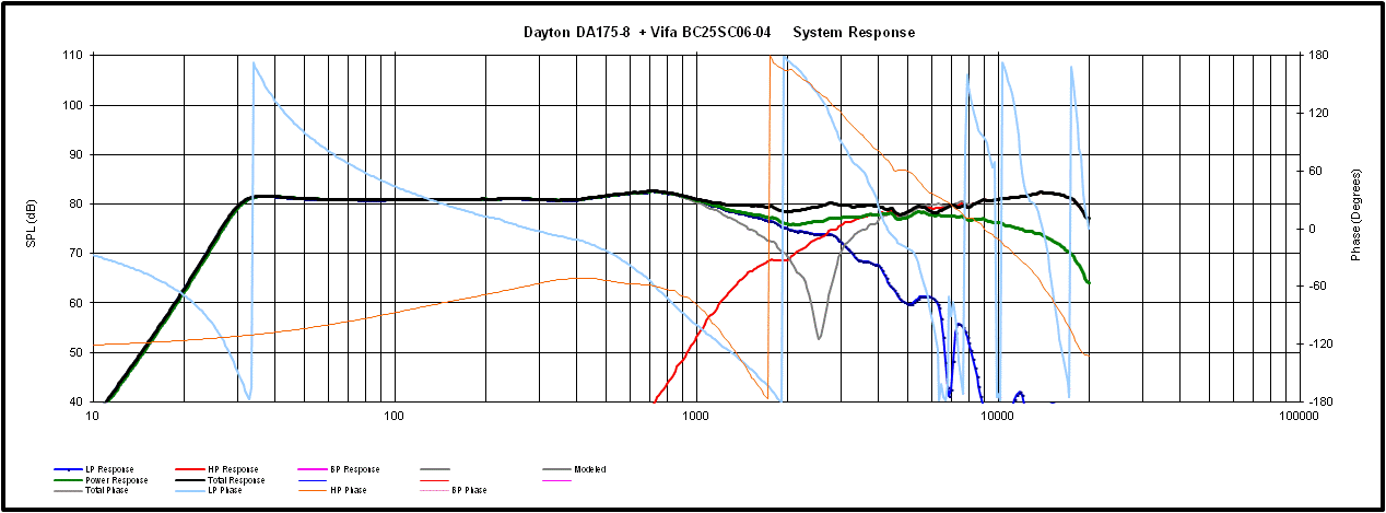

Those Daytons will have a much lower F3 than the OS's. Plus, compare the cone area multiplied by the xmax for one 175 (that'll be the volume of air being displaced) vs the same x 2 for the HiVi's and the Dayton still comes out on top.
In simple terms, high frequencies are more directional than low frequencies. So when you are off angle to the drivers the bass will always be louder. Maybe try dropping the bass knob when you're listening like that and/or adding a little treble.
Reduce the box volume? That's actually tough for me to answer. I would probably be more interested in getting the tuning exactly the way I liked it and then decide whether or not that tuning will play loud enough for me. I don't think WinISD shows you the cone excursion. Unibox shows that, port air speed (re port 'chuffing') and the effects of different densities of stuffing. You should try that and see for yourself what happens with different alignments.
To reduce cone travel, a smaller box, a higher tuning and more stuffing all have an effect, but with this driver, I'm not really seeing a really significant difference even if you half your present box volume, and you don't really want to tune it too high because it starts peaking the response excessively. There's definitely some difference but it's not as significant as adding a 2nd woofer. I say live with them for a while. See exactly how loud you really need them and whether they're up to the task. If you want to play with the port tuning I can suggest a methodology for trying different things out. But I'm pretty impressed with the LF these things sound like they're putting out - with the walls shaking, it doesn't sound like you have any need for a subwoofer. Poor Phoenix.......
I have winisd pro on my computer. It crashes on exit on my vista system (the worst ever OS) and I have to kill it with task manger so I never played with it. I just played with it now and yes I think I could learn a lot more from it. Thanks. I didn't know it did all that other stuff.
I will and can live with these speakers for a while, possibly forever. Other than maybe tweaking the resistors a little and maybe tweak things based on what I might learn from winisd pro, I'll just leave well enough alone and maybe someday add a second DA175 just for fun. They are plenty loud and quite fine as is.
However. I think I have an itch. I want to do it a again. Build another system with better stuff just for fun. I'm thinking bass drivers in the $50 to $100 range and tweeters in the $25 to $50 range. Even though I've learned a lot I still would not know how to pick them out. And then I cant have jReaves designing crossovers for me for rest of my life. What do you use to design and model crossovers? I'm open for suggestions on drivers for a second project.

Anyway I'm having trouble understanding crossovers but specifically mine. Jreaves said its a 2.5K crossover point. For the LP with 1.5mH and 6.8 uF I calculate 1.575K. For the HP with 0.3 mH and 6.8uF I calculate 3.523K. What am I missing or doing wrong? Or is the XO point the midpoint of those two numbers?????
