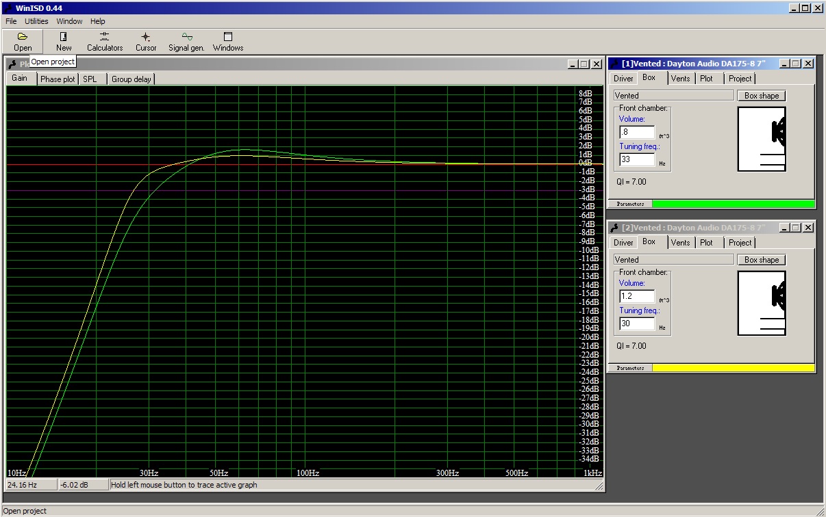

I would shy away from any more than 1cuft.
Zaph Audio showed that 1cuft @ 31hz was about the lowest you want to go and a pretty sweet spot to be for response v.s. power handling.
Here is a quick comparison with 1.2cuft @ 30hz VS .8cuft @ 33hz.
The extra 50% volume only gains you 3hz extension @ -6db down, at the expense of control an power handling.

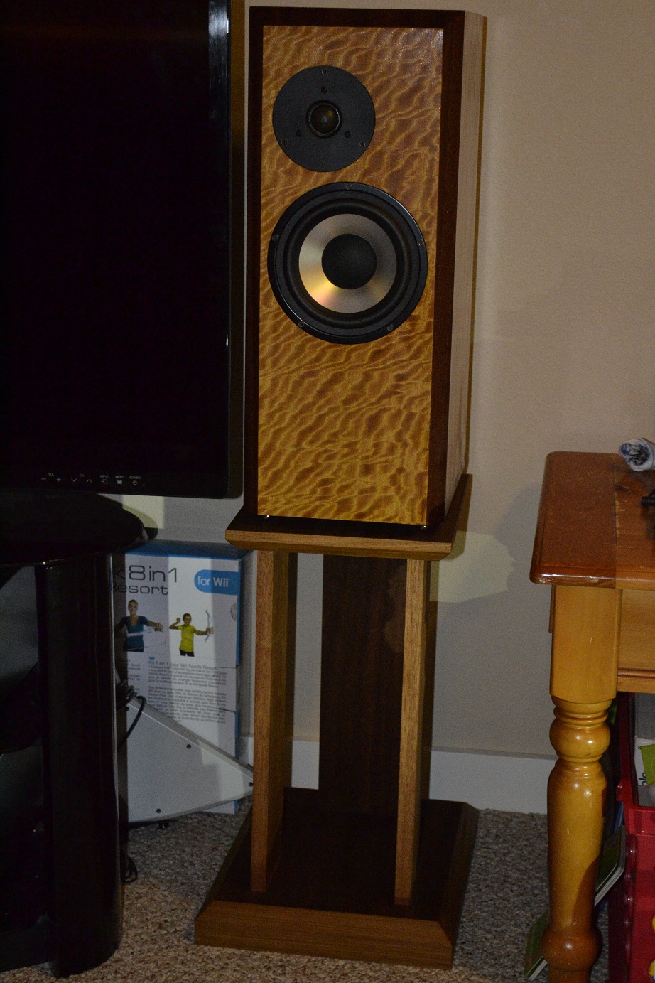

Here is the aesthetic I went for, my wife thinks they are "Wood Art".
In retrospect though I would have gone with a floorstander with a partition or maybe integrated side firing subs with plate amps.
Those are nice looking. My wife would love them. She would have a place on the bottom to put a vase or figurine or something there.

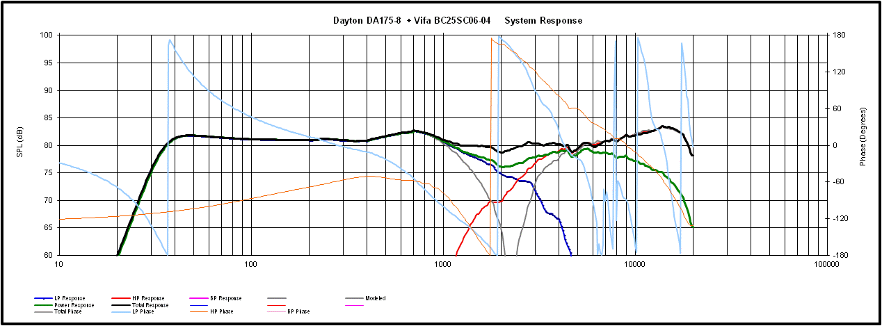

Well..... my Great Christmas Adventure of 2013 only lasted 27 hours. I was a bit disappointed. An ice storm moved through the area on the weekend and power went out for hundreds of thousands but I got it back yesterday. Others are still without and I feel for them ........ but I had fun anyways.

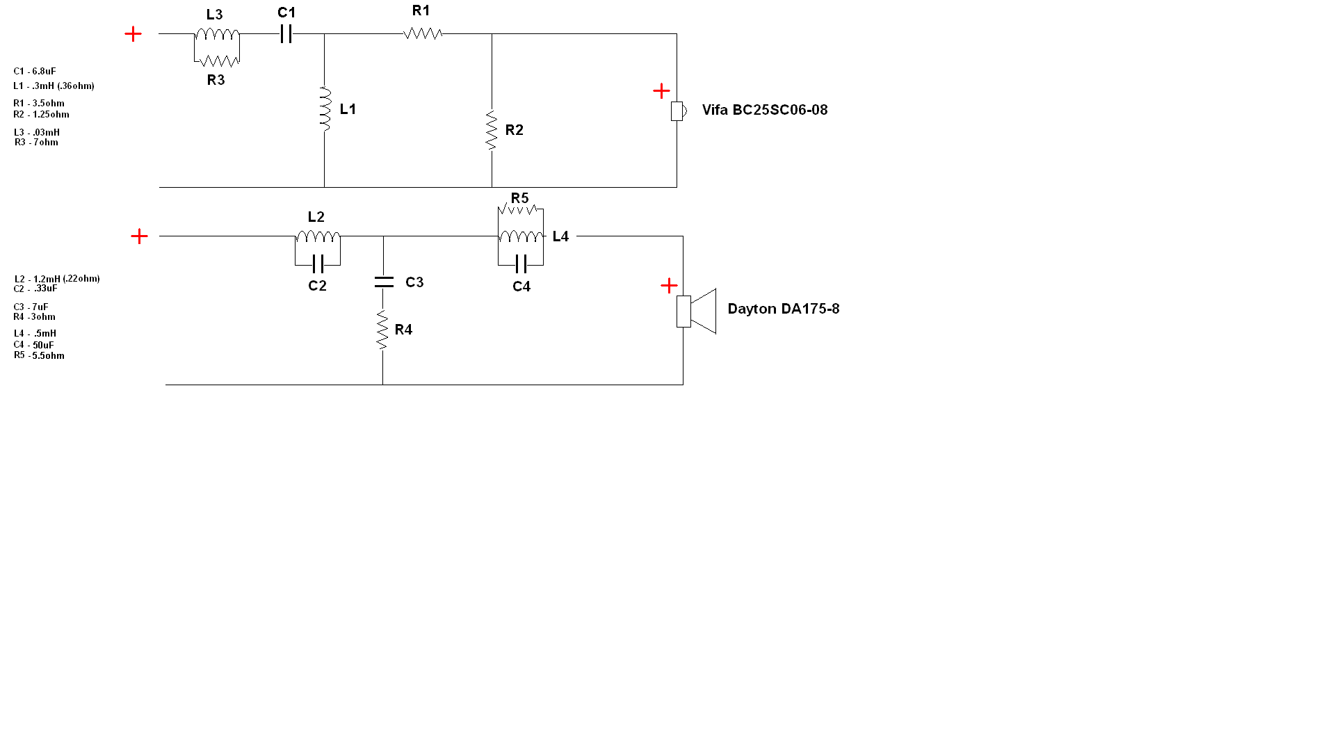

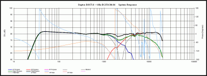

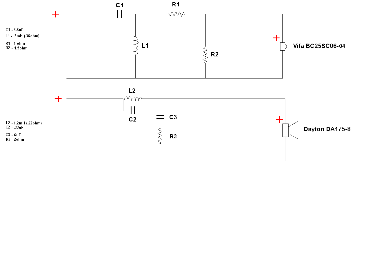

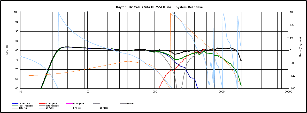

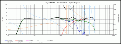

Well, back to the subject at hand. Here's what I've worked up for you Tony.
I changed the baffle in these sims to 11.5" wide and 34" tall. The center of the tweeter should be 3" from the top; the center of the woofer, 9". Sides and top edges have a 1/2" roundover.
There have been some good suggestions re box size and xmax limitations. Since you were kind of set on the 60L or so cabinet size, I thought half that (about 28L) might be a good volume to go with for 1 woofer because you'll be getting the same response if you end up going with 2 of them in the same cabinet. Just a thought though. For these sims, I used the 34L (about 1.2cft) that you seem interested in but tuned it to 37Hz, a little higher than other suggestions because I wanted to boost the LF a little more in SPL to match your small deficit in hearing (mentioned in your 1st thread). But tuning I leave up to you. These xo's should work with whatever you decide to go with. Also, with a removable baffle, another way to shrink your internal volume other than a divider of some sort (which must be air-tight btw) is to fill the cabinet with something. In your case something large like a bag or 2 of sand for example.

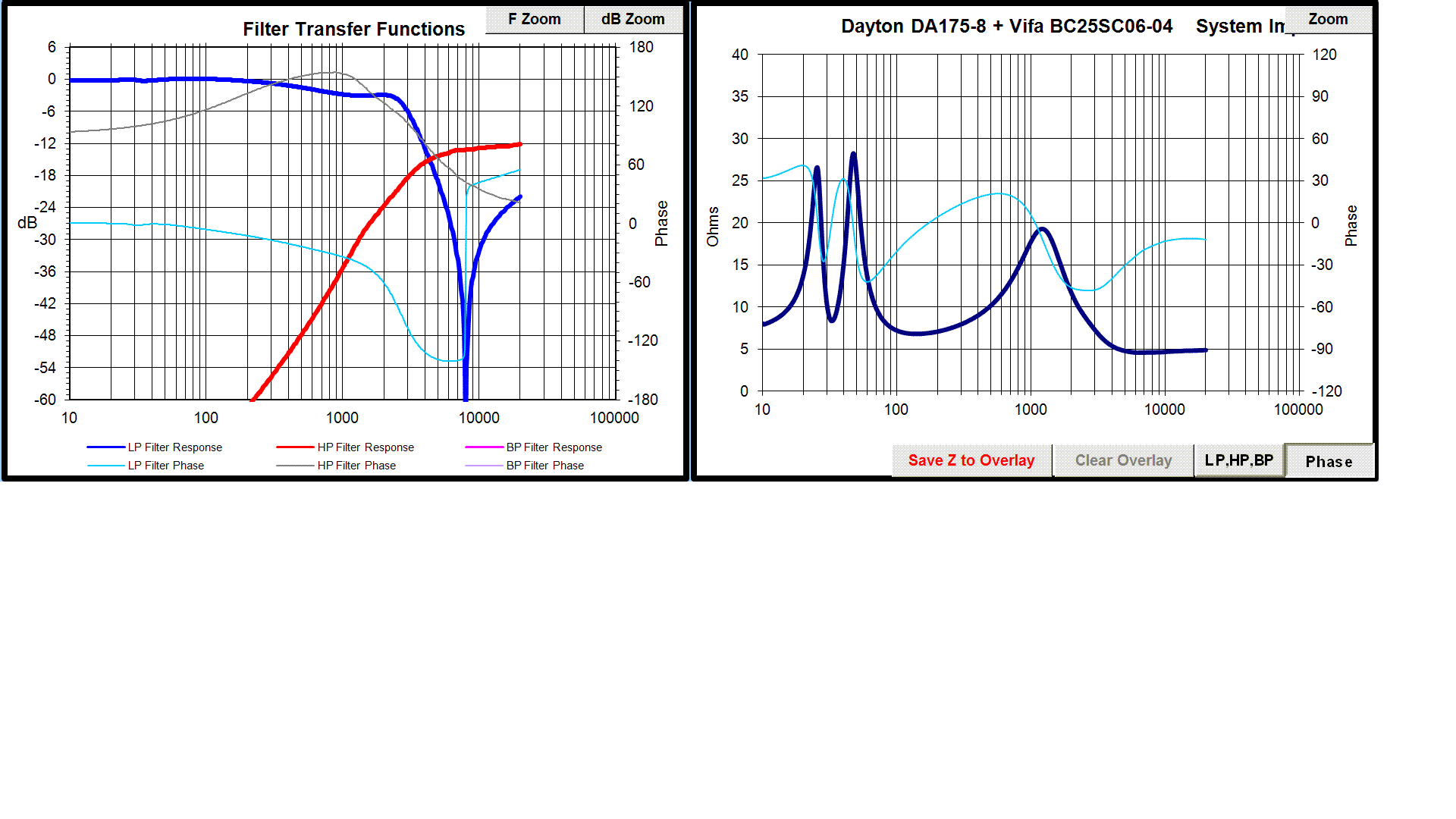

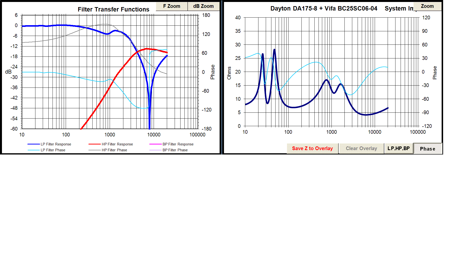

Below is the simpler xo for you with the transfer functions again and the xo schematic. The 1st graph zooms in a little more on the FR this time so that you can see the deviations from flat a little better. Second order for the xo's at about 2500Hz with a couple of extra parts to knock it into shape. Tony, for you, mostly just look at the summed response which is the black line but I've included individual driver responses (blue and red), phase (light blue and sort of brown), the reverse null (grey) and the power response (green) for anyone else that might want to see them.
Here are a couple of pieces of info that might help you make evaluations:
Three dB is usually the minimum change in SPL that's required to be able to notice a difference perceptually. So if the deviation in the FR is less than 3dB, it's more or less considered close enough to flat. Personally, I think 3dB is overstating it. I'd call it at 1.5 to 2dB, for me at least anyways. (My receiver changes volume in 1/2dB increments - and yes, that's a lot of clicking sometimes)
A peak in the response is generally considered more noticeable or more offensive than a dip.
We tend to lose high frequency hearing as we age so you may or may not be able to hear what happens above 13,000 to 15,000Hz or so.
Although a flat FR is generally considered as the ideal, there are reasons why in certain cases you might want to deviate from that - the most important being because you prefer it that way. 😛 Probably the most common thing you'll see is increases in the LF and HF so that the FR looks like the start of a smile. YMMV
Not to worry about taxing my patience - if I didn't want to help people here, I wouldn't be posting. Now that I have the sims done, it's a real simple matter of making changes to them. So if you want to see what happens with other values, just let me know and I'll post the response.

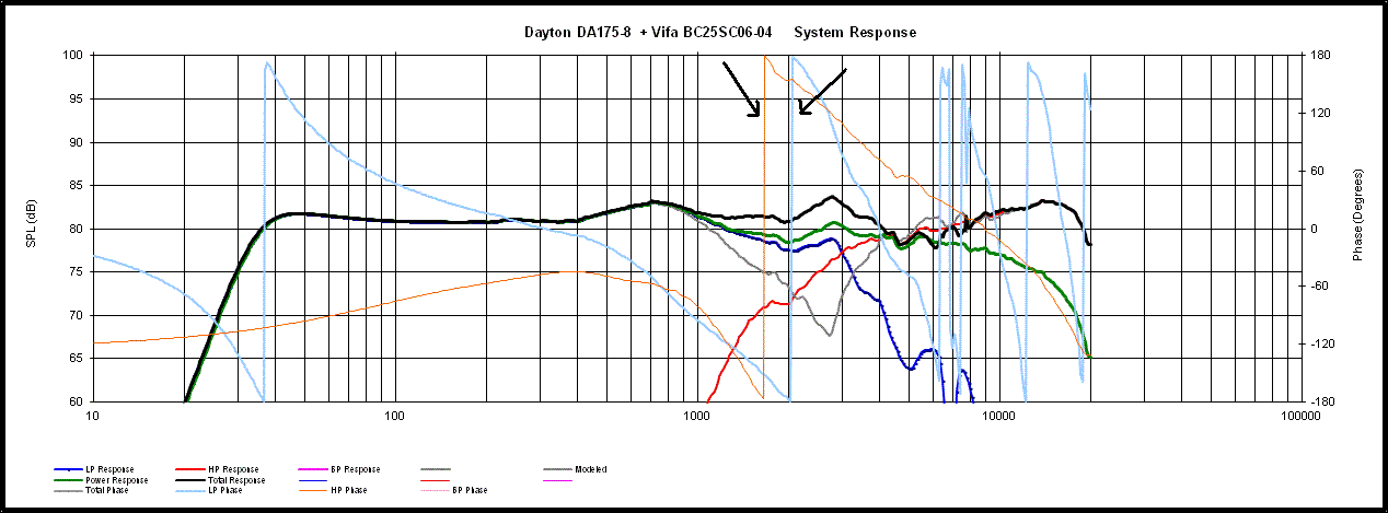

So looking at the FR above with the simple xo, 2 things stand out - the peaking between 400 and 1000Hz and the rising HF response at about 7000Hz. If you want to see what it will sound like without these, I've added 2 extra filters to tame them (and I think 2 other tiny little changes too - and yes, guilty as charged in seeking perfection here, I just can't help myself 😀), but I'd say start with the 1st one and go from there.

Wow. I'll have to study those curves for an hour. I'm going to build the simpler xo first and after a week or so make the second just to see if I can hear the difference. I mentioned 1.2cu ft because thats what the parts express website stated was optimum. Whats weird is winisd gives me 55L for the DA175 ?????. I'll put a partition in my box for the 1.2 cu ft because eventually I'l probably want to experiment with adding a second da175. What does that do to the xo?

I hope you have some resistors on the tweeter too. I input your values into my sims with my tweeter padding and you can see what the result looks like below. Not bad. It's very similar except the driver phases aren't as well aligned in the xo region (arrowed) (so in other words, the 2 drivers are playing the same thing in the xo region but not exactly at the same time) and you now have a bit of a peak at about 1800 Hz too.

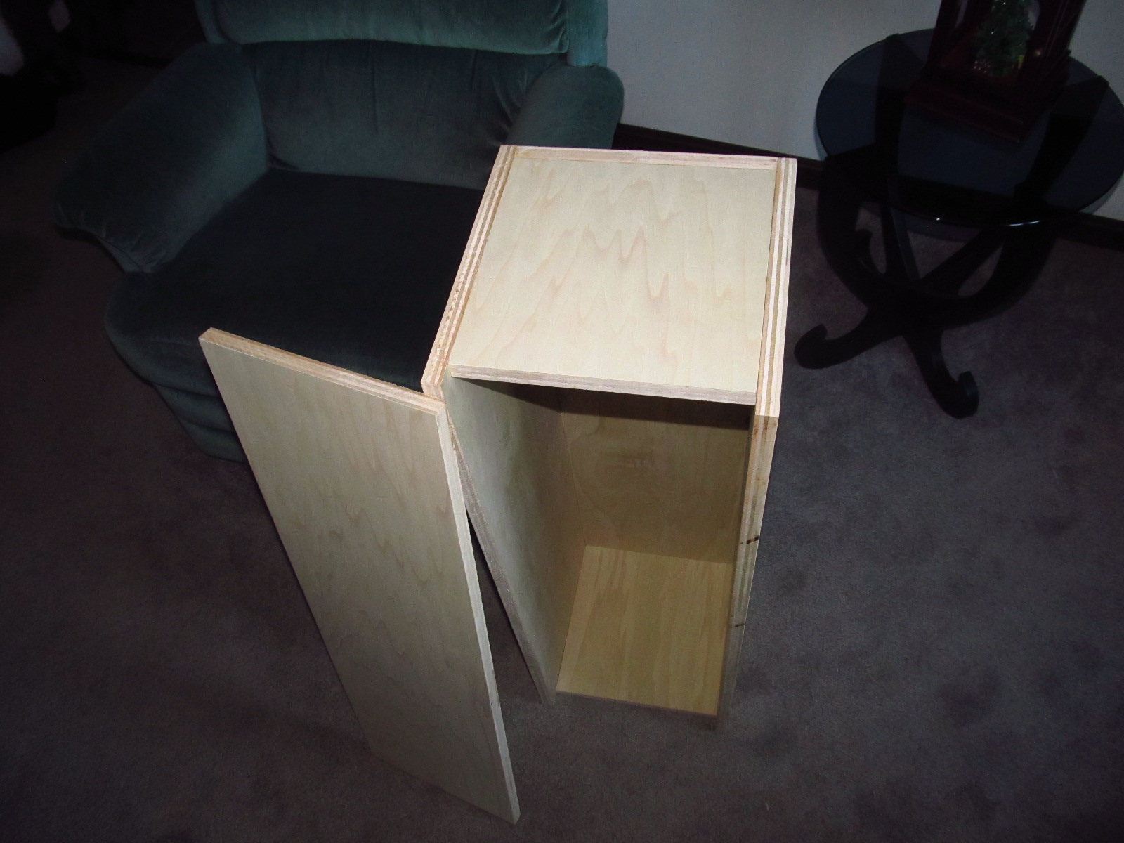

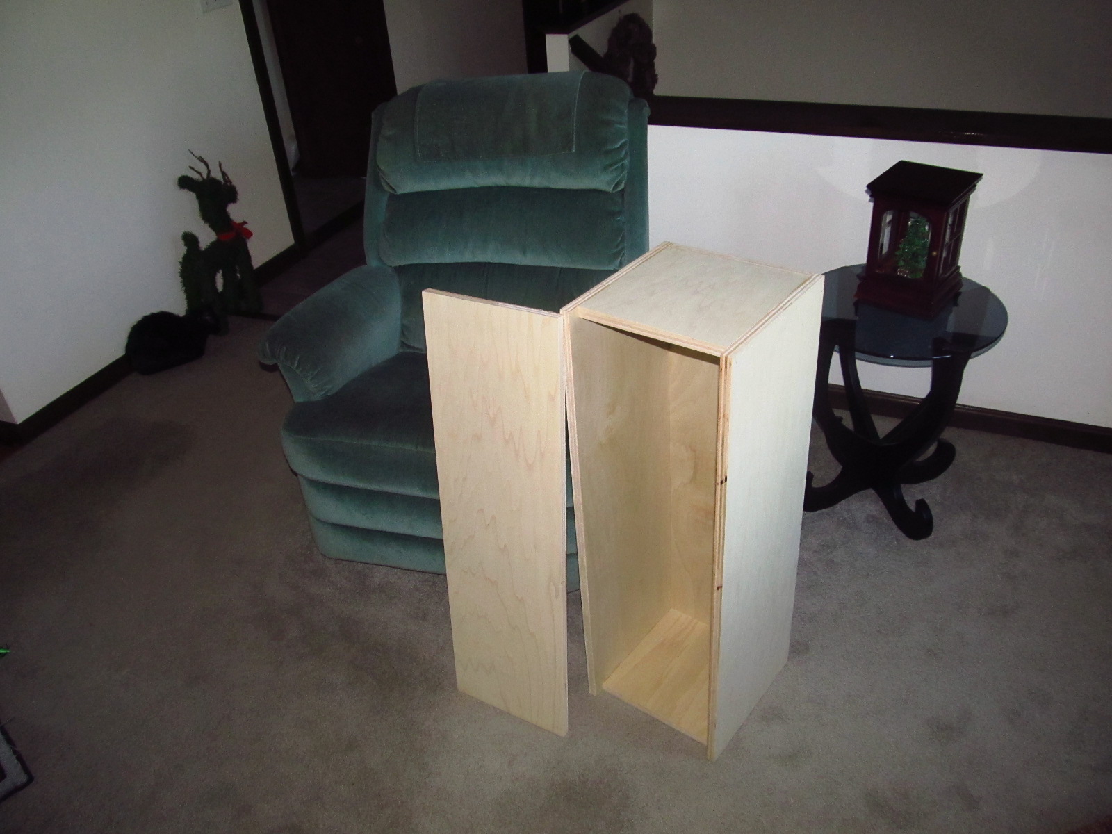

Well I got all my wood cut up and I'm building boxes. My intent with these was to cover the boxes with a black, satin finish laminate and stain the baffles a gunstock like color. I'm confused about this rounding the corners of the baffle. I looked at various speaker projects on the web and noticed many don't have rounded edges but many do. I can't make laminate go around a radius. So whats the deal about rounding the edges?
Here's some pics. I'm going to add two 3/4 X 3/4 strips along each side to screw the baffle to so it can be removed. The back will not be removable.
What else I need? Corner braces maybe?
