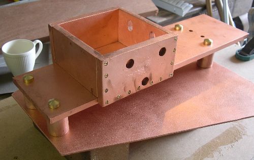

erik how did you aquire such industrial size pieces of copper, they seem so rare these days, the plate and tubing is of measurements beyond the normal end user market. your design seems to stear quite far away from your organelle mock up, where are you taking this design?

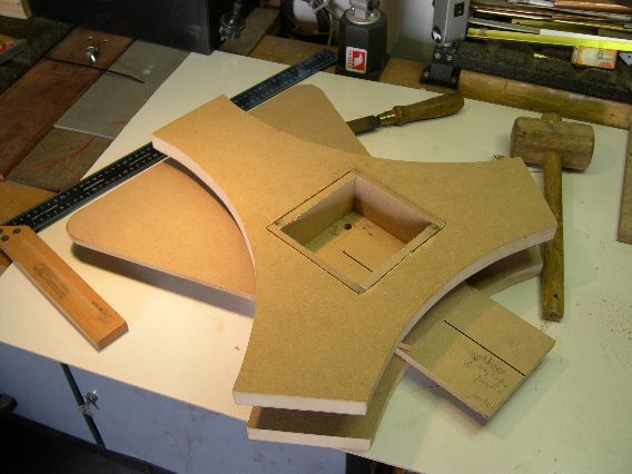

kanifee said:erik how did you aquire such industrial size pieces of copper, they seem so rare these days, the plate and tubing is of measurements beyond the normal end user market. your design seems to stear quite far away from your organelle mock up, where are you taking this design?
I was able to buy it (for the copper-price) from an industrial client .
I am still building according to my MDF scale...only the
bottomplate becomes a shallow compartment in real life...(such as in the Kalista...)
Since I never make drawings I build most of it "while I am at it"
I always give myself room for changes without loosing to much of my original idea.
