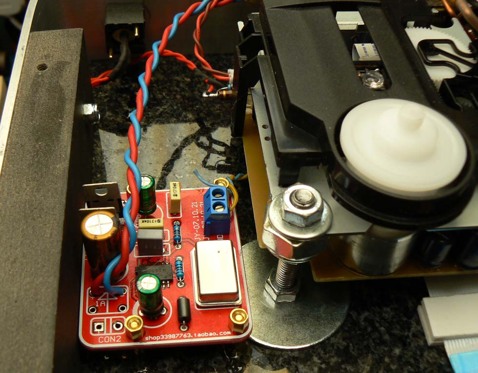

Citizen 300-8441 crystal frequency is 16.9344Mhz, I can find locally only quartz 16.0000Mhz.
Can it work ?
Zigis.
Can it work ?
Zigis.
Zigis said:Citizen 300-8441 crystal frequency is 16.9344Mhz, I can find locally only quartz 16.0000Mhz.
Can it work ?
Zigis.
nope .

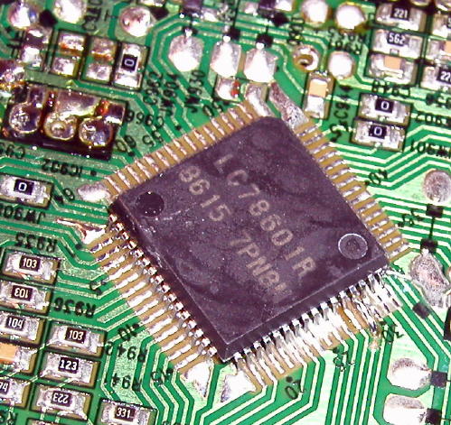

Annyone able to provide a datasheet of the LC78601R?
Been looking for a while but somehow i can't seem to open the sheet.
(No MS office)
So a PDF will do.
Thanx, René

LC78601R or LC78601E ?
I have E 😉
send me a mail and I'll send you pdf

Here's the 'E' online
LC78601E
Dan

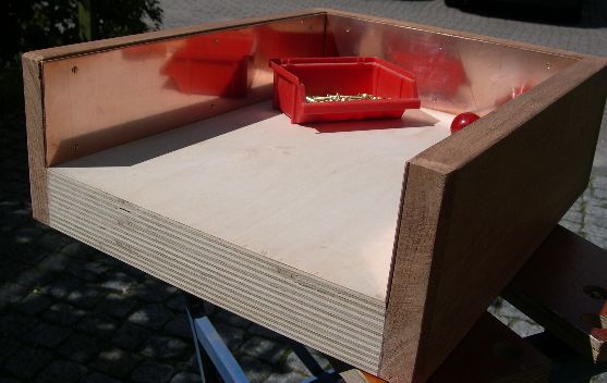

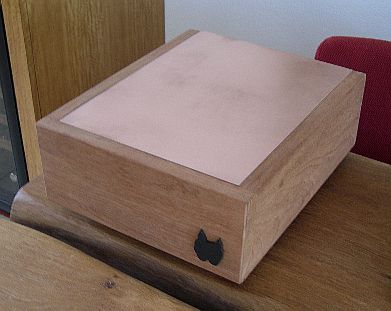

Today I finished the sides and the top of the piTbull psu-box..
I used 2 mm copper.....
And hey my regulators arrived today....heating up...😎
