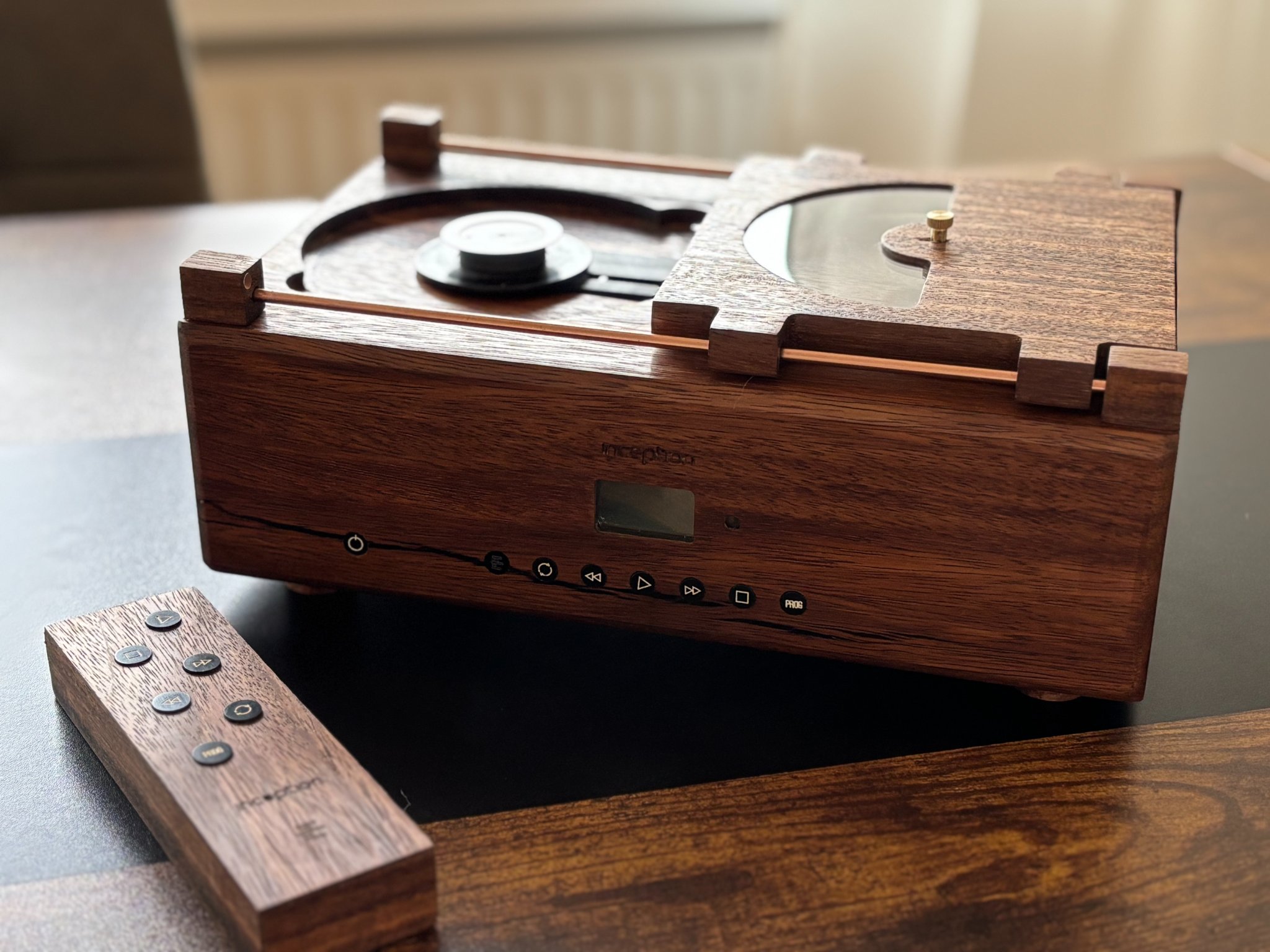

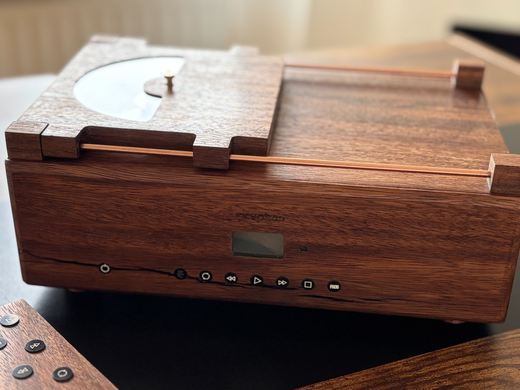

Finally, an affordable CD Transport: the Shigaclone story
I already wrote to Peter thanking him for this project, I would like to show it to you too, if anyone else makes or wants to make this CD transport. Unfortunately, I can't upload the video.

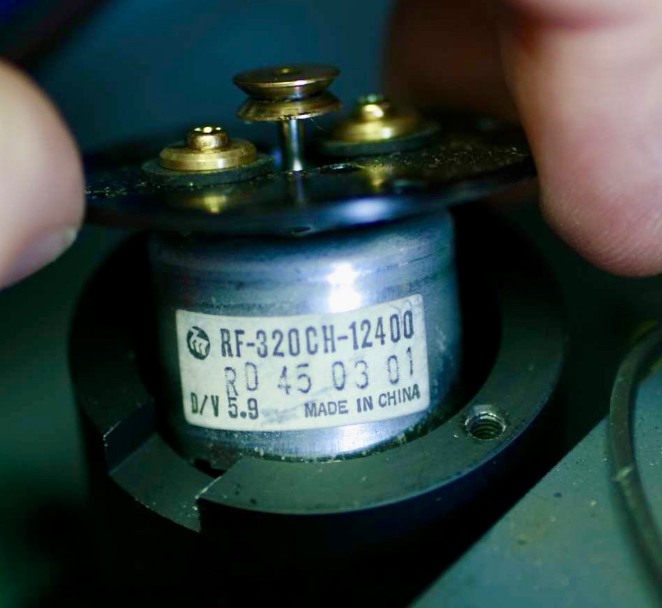

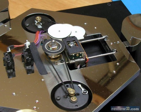

The Mabuchi (or clone) RF-310T-11400 long shaft 5.9V spindle motor. Their bearings are made of cheese and the brushes/commutators get chopped up by aggressive drive conditions. (over driving for fast startup and stop)
The best drive mechanisms used were BSL (brushless/slotless) motors with a lower sapphire thrust bearing and an upper high quality sleeve. Run-out is non-existent on such motors.
Most CD player issues can be placed firmly at the feet of cheap Mabuchi brushed spindle motors.
But you are perfectly correct about Accuphase using these cheap Sanyos. It's kinda sad, but they are between a rock and a hard place. Make their own at huge cost and still need to out-source the optical block itself, or use an ultra cheap commodity mechanism and stock enough spare parts to last forever for their customers. They ran out of Sony BU-xxx mechs back in the day for their TOTL players and upset some customers.
I just wish they'd be honest and not talk up the mechanism as something special. It'd be better to say, it's a decent, low cost mechanism that's easily replaceable. In fact they could potentially offer a lifetime guarantee on the laser as they could stock enough mechs to send them out for free.

The SF-91 was a nicer mech, but it all comes down to how to how the drive circuitry drives the spindle and tracking motors. Hard startup and stop with gross over volting is common which burns up commutators. Onkyo were one of the worst for that. Basically nuking spindle motors in a few years to get sub 1 second TOC/Access.

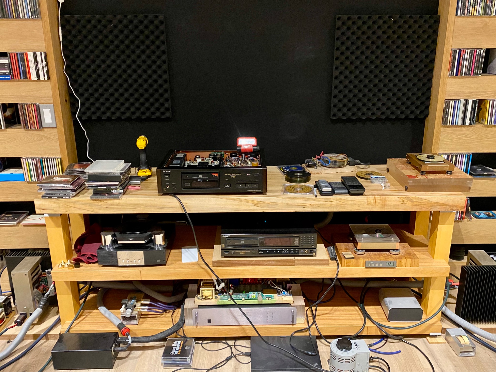

I have two transport on my rack that are in use for the last 20 years: CEC TL0 and Shigaclone. You know what they have in common: Mabuchi motors.
Those may not look like much, but I don’t recall anybody complaining that motor failed, either in this thread or from people who got transports from me. And some are being used with heavy pucks. One tech was saying that as long as you don’t use shuffle or random play mode, Mabuchi motor should be fine.

I agree. This Mabuchi motors are very reliable from my experience. In contrast to other spindle motor brands such as Matsushita - I had to replace these frequently, although I always chose Mabuchi as a replacement despite the higher effort regarding the different arrangement of the fastening threads (e.g. for the Linn Karik, PROTON AC-420, TANDBERG TCP 4025, TEAC PD-H500 and UHER UCD-410R - all equipped with the Hitachi HOP-M3 mechanism).

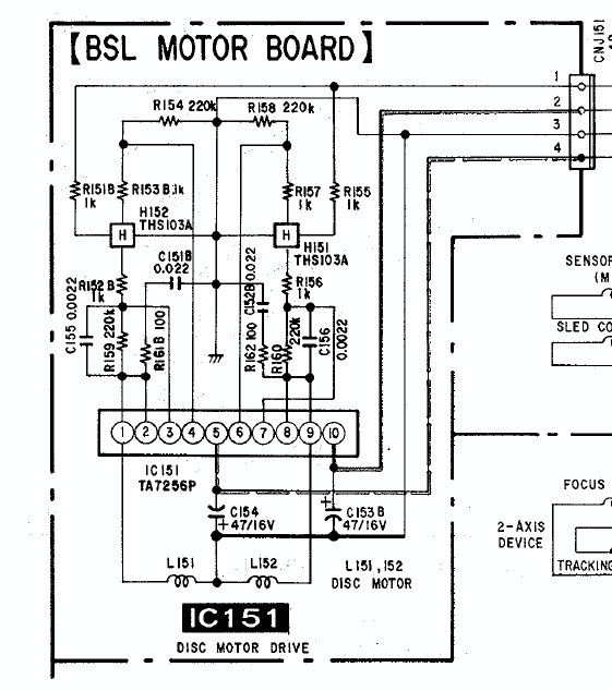

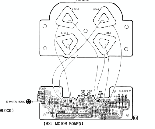

The Sony CDP-X77esD has a BSL sapphire bearing motor. That's why, 35 years later it is still working perfectly...
And that's why the world's first commercially released model, the CDP-101 had a brushless, slotless, direct drive spindle motor as well. No rocket science. All the first gen and TOTL players had quality spindle motors. No cheap-a#s Mabuchis in top models.

the most deficiency on this board are the very bad caps C154 and C153 B (47uF, 16V). Unfortunately the traces are also oxydated - check out the images in post #10 under
Accuphase DP-65V dead transport section
