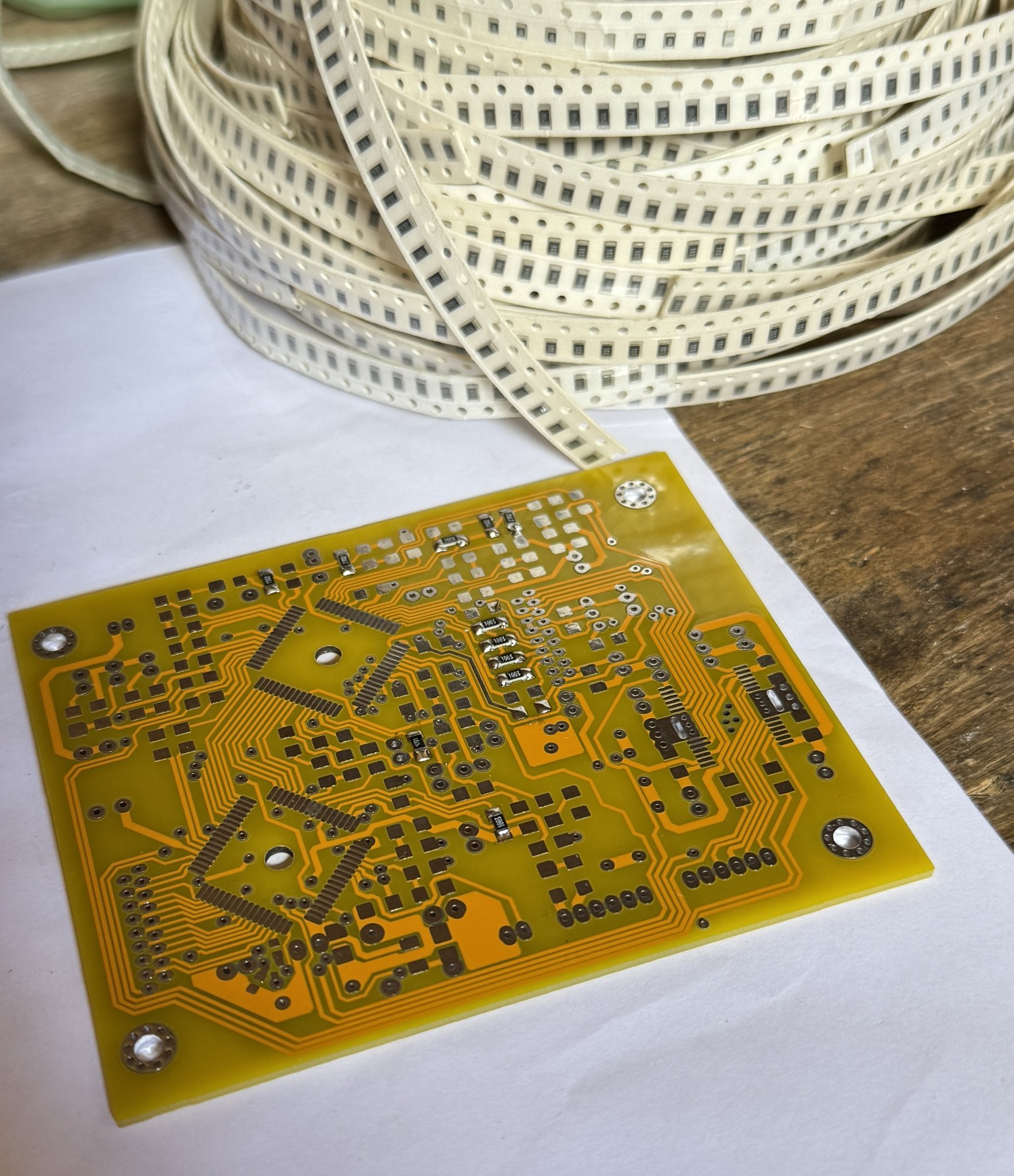

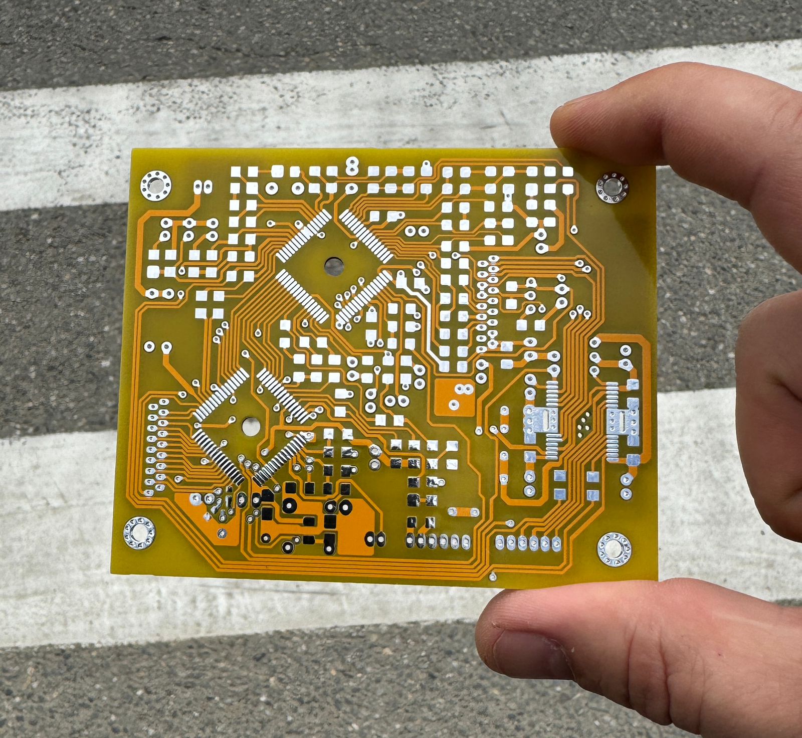

Good job with the boards Oleg! Will you be sharing the gerbers or selling the boards? I have several broken Shigas, I might be able to salvage the chips from them or from the EZ31 I just bought if I had a new pcb. I think it would be great for the community if there was a way to build more of them. Do you happen to know a reliable source for the chips? I've bought some from Aliexpress, from vendors who have sold me genuine obsolete transistors in the past. As far as I know there is no easy way to test if they are counterfeits.

About boards
I think the best way a find the complete boards from iTiberius
Because cost if you build that with many parts at himself is very highly
Buy boards

What channel did you obtain this type of PCB from? I know what this is.PCB boards a first version with two mods
Good day
I reading posts about mods in this forum and Poland forum
After that I draw first version of ShigaClone and added two mods on board
You don’t have this design because I draw this at himself

The label on the PCB shows that this is a free PCB manufacturing service provided by this factory, including free shipping fees within China. I'm curious about how you, a Russian, got this kind of service? It seems that you are very good at finding parts and services in China.PCB boards a first version with two mods

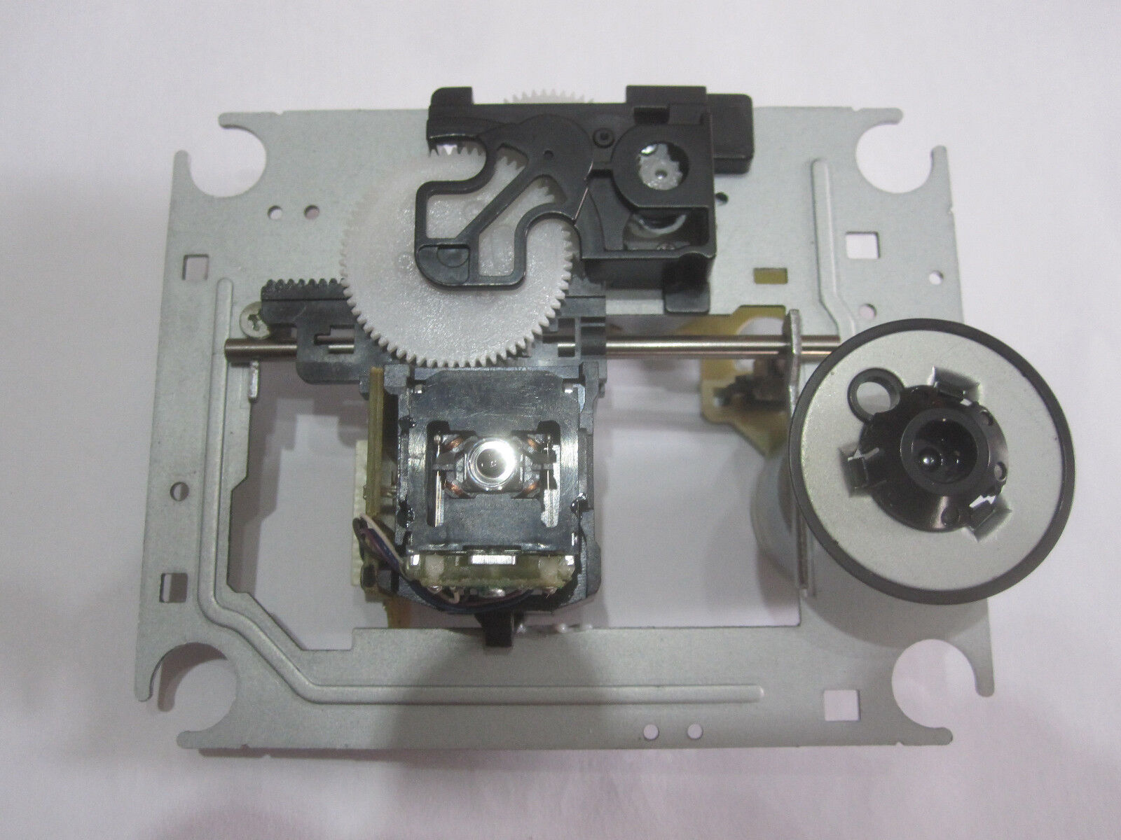

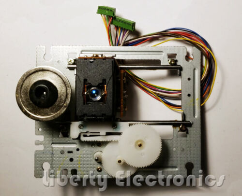

Same heads
2) SF-P1 (без информации) - plastic case
3) SF-90 (без информации) - metal case
4) SF-91 (без информации) - metal case with connector
This is old versions of SF-P101
His used in CEC2100/3100/5100 and more old CDs

That wayThe label on the PCB shows that this is a free PCB manufacturing service provided by this factory, including free shipping fees within China. I'm curious about how you, a Russian, got this kind of service? It seems that you are very good at finding parts and services in China.

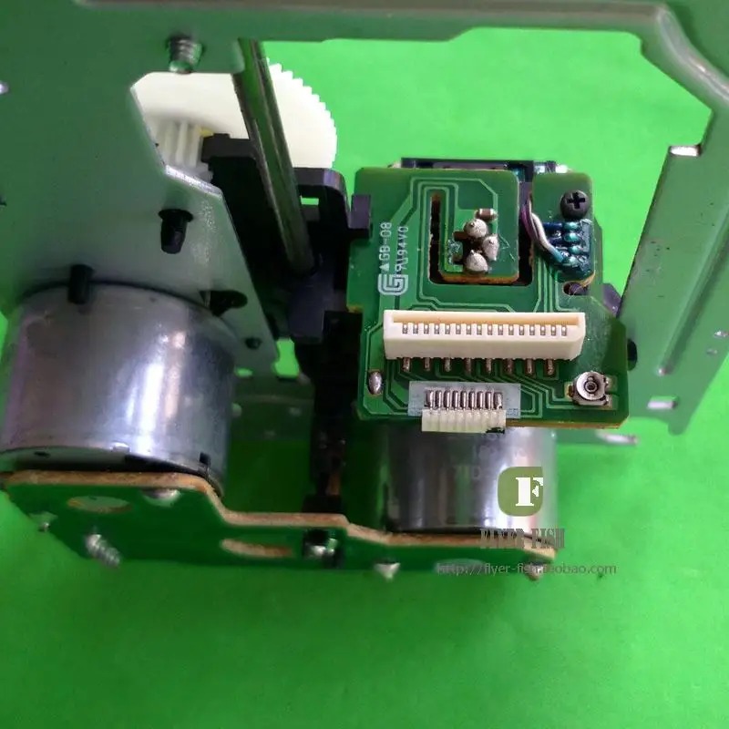

Please attach photo of your head and mechanism
I haven't laser heads and mechanism, but nevertheless I want to have the datasheets of often used mechanism. In the attachment some images of SANYO's mechanism for SF-P101N, SF-P1, SF-90 and SF-91.

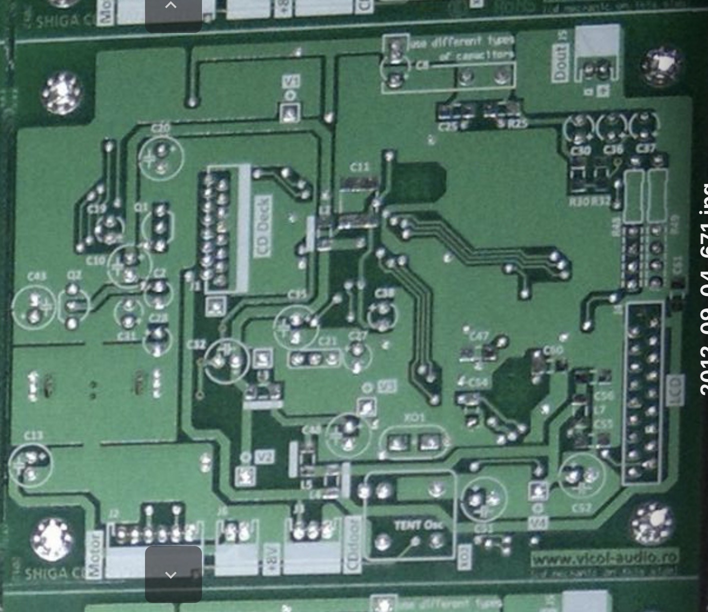

I think my version of design is not original ShigaClone 2012
Wow wow wow…
I get this one main design from Europe forum
Maybe this is middle version between Shiga2012 and ShigaMKII ?
Wow wow wow…

Maybe you have the schematic for this board project ?
Because is labels R/C/L and smd stabs is not same with Shiga2012
