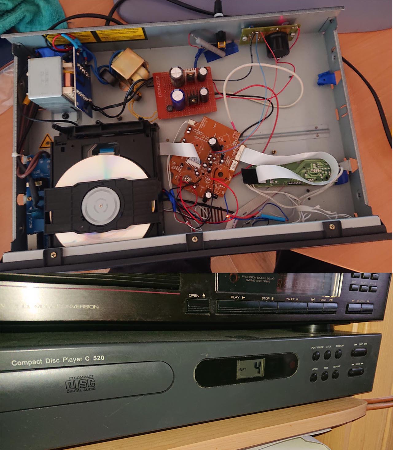

I did the same thing. I bought a Sanyo MCD-ZX201F for $15. Installed in the case of the NAD C520.
Additional clock and pickup control relay (open-close).
It looks rough inside, but the sound is great!

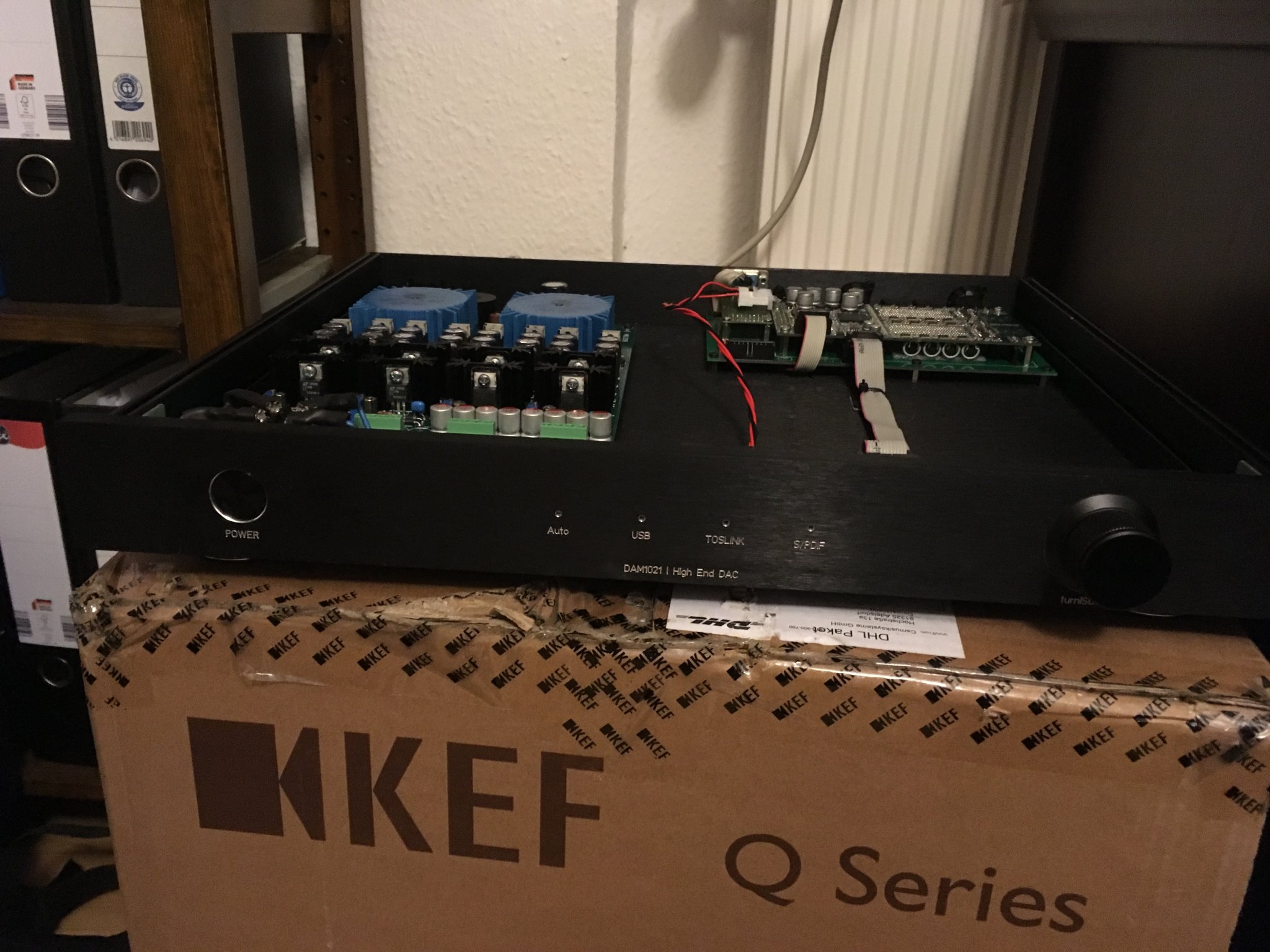

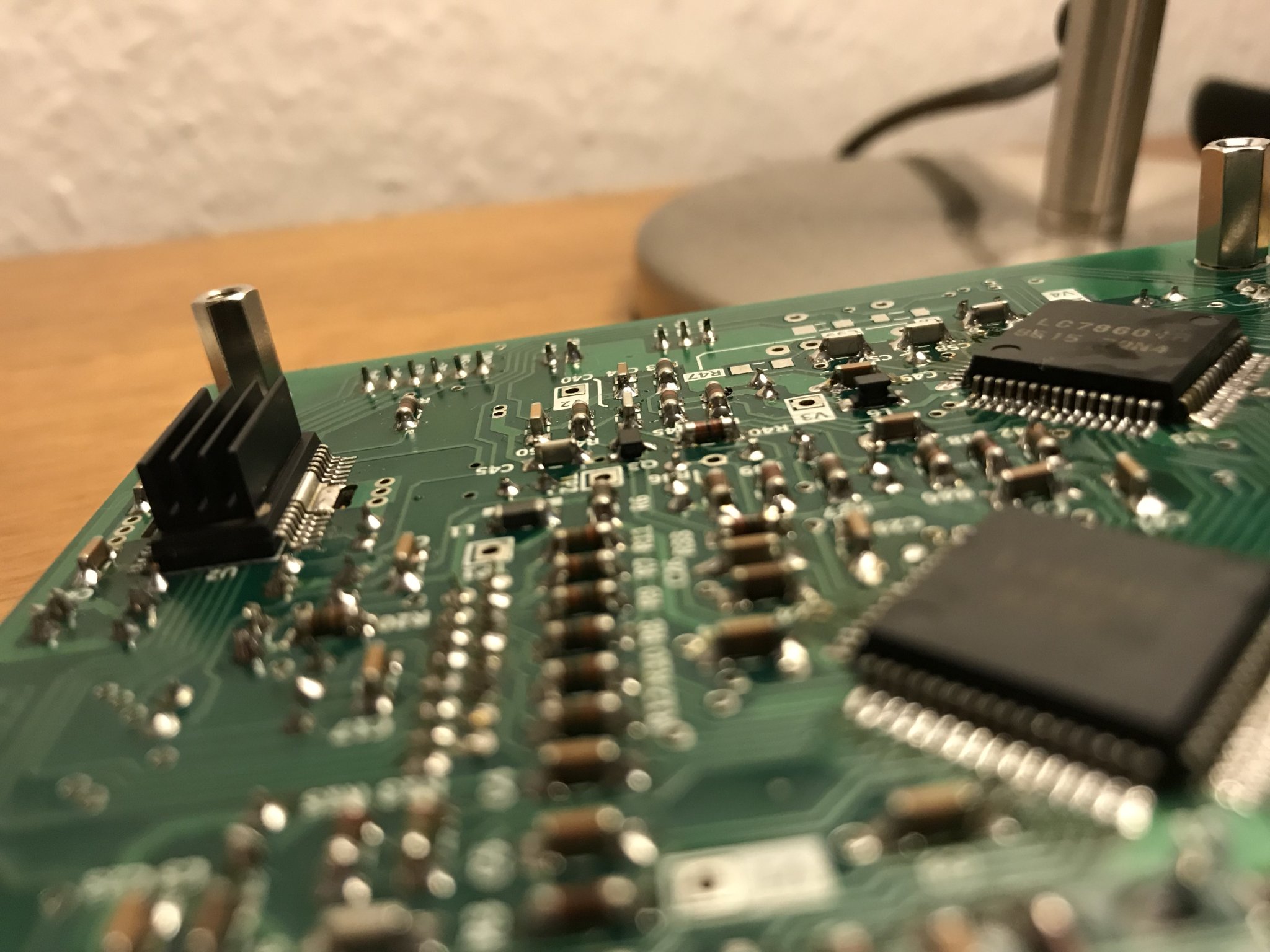

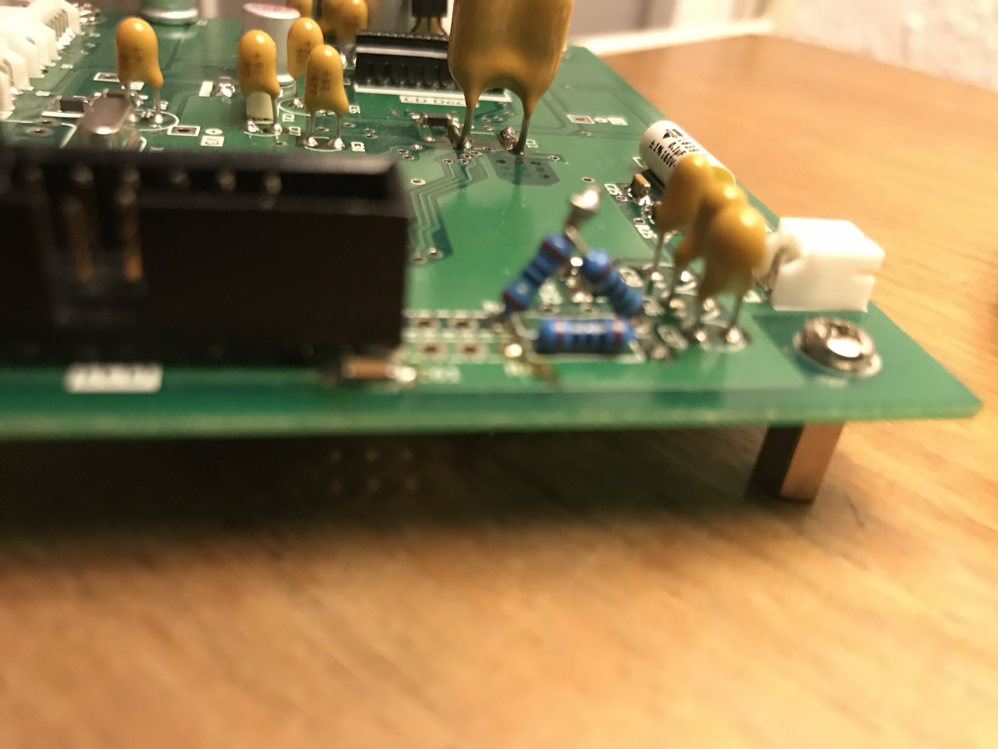

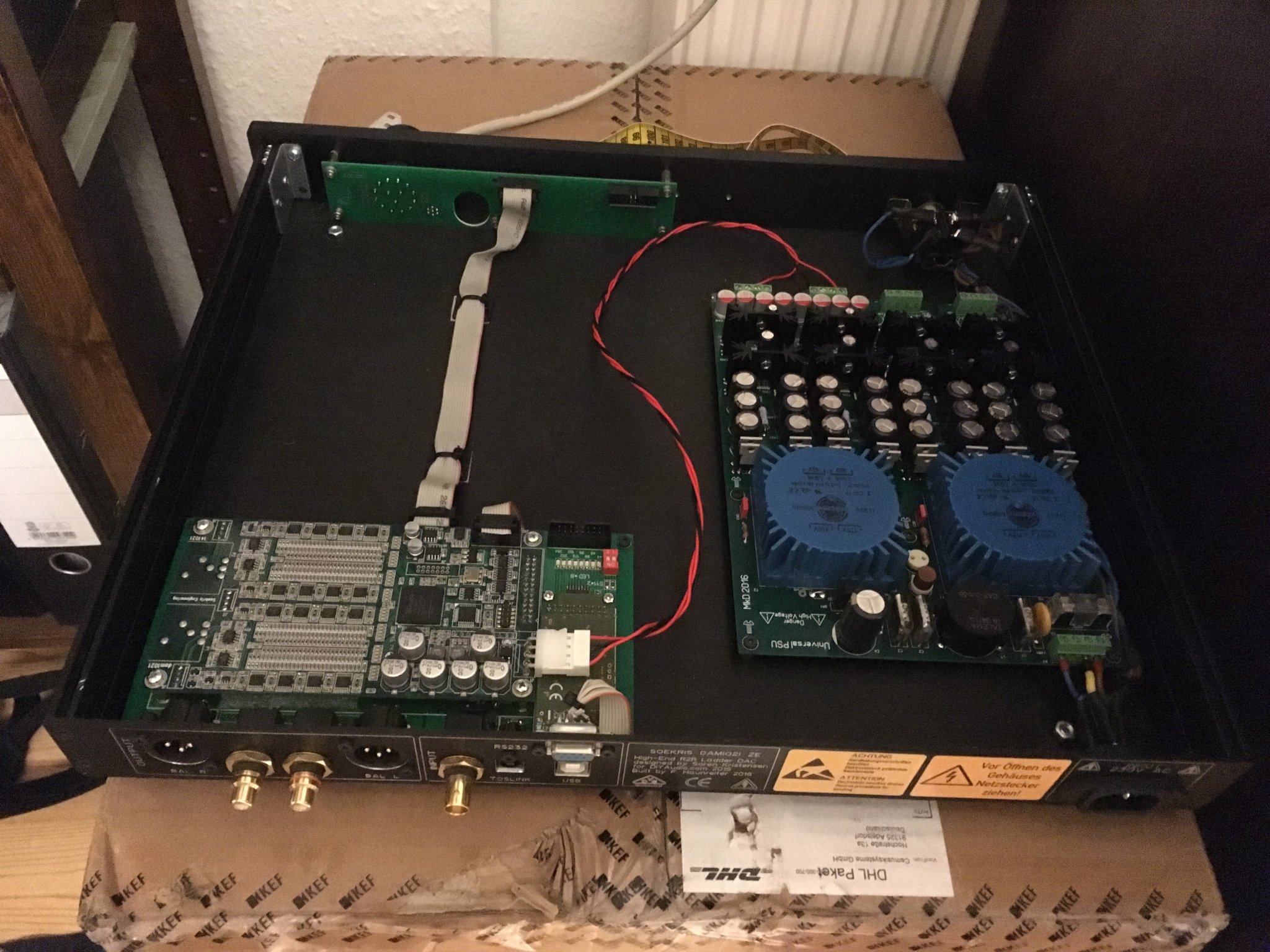

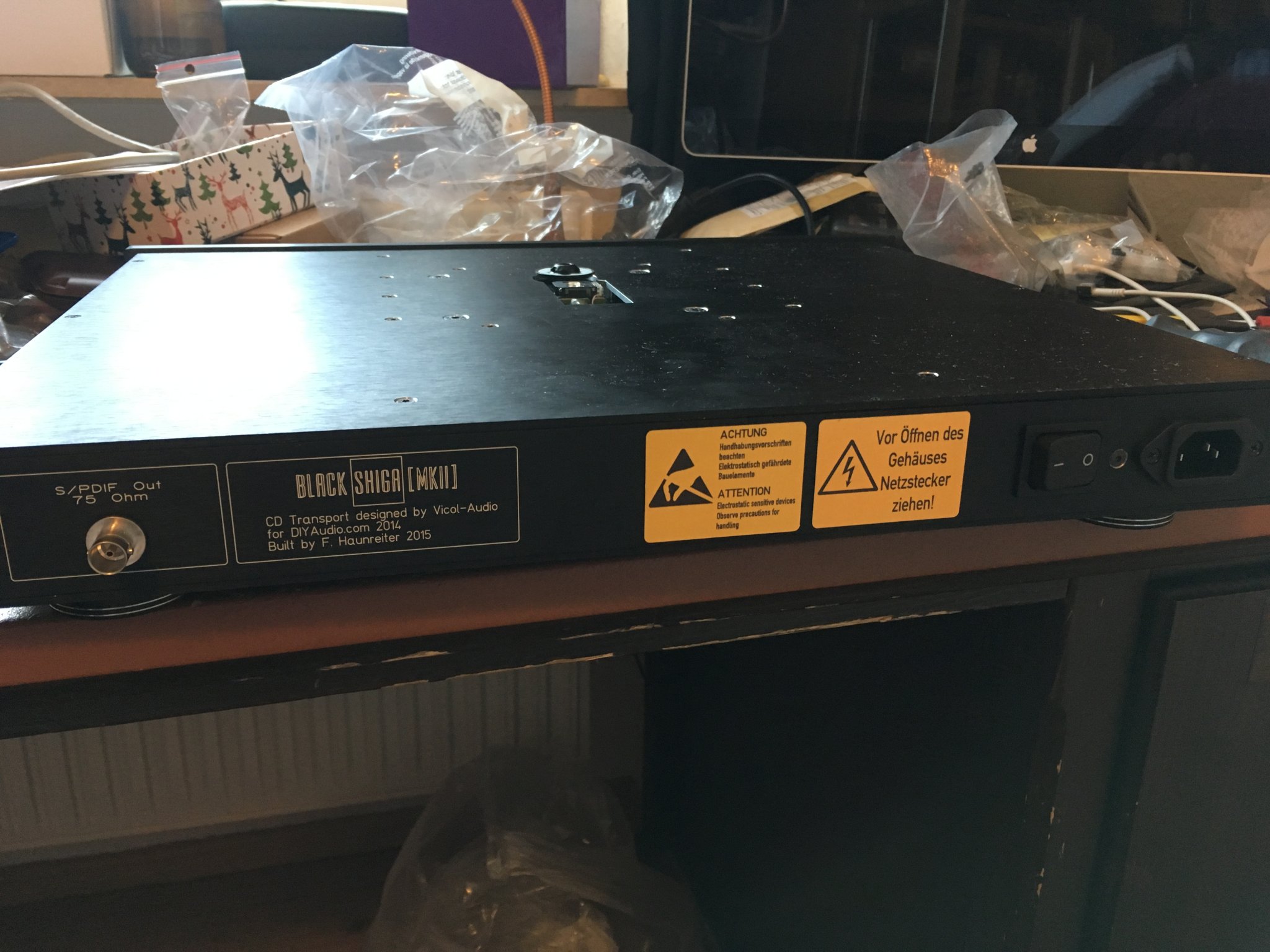

Shigaclone… ih what a journey… started from boombox version to Tibis MK1 and finally MK2 which hangs on my original (but strongly modified Soekris DAM1021 DAC). Although in times of streaming I always get back to poorly mastered CDs… like Oasis / Blur from the mid to late 90s. Britpop war of loudness.

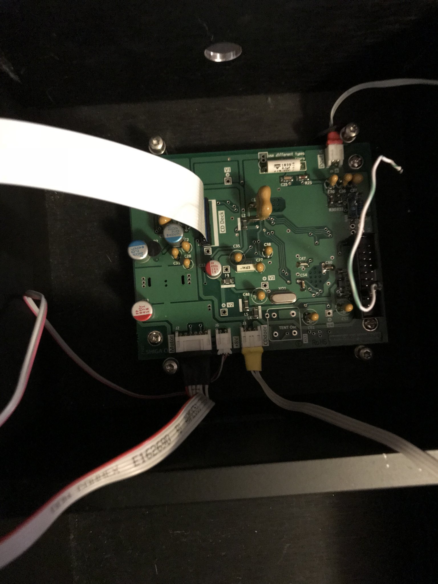

I took my combo to many places and nearly every time it beat transports far more expensive… Though the final iteration wasnt cheap to build too.

Can you share your pickup control solutaion to make use of normal front loading transports?I did the same thing. I bought a Sanyo MCD-ZX201F for $15. Installed in the case of the NAD C520.

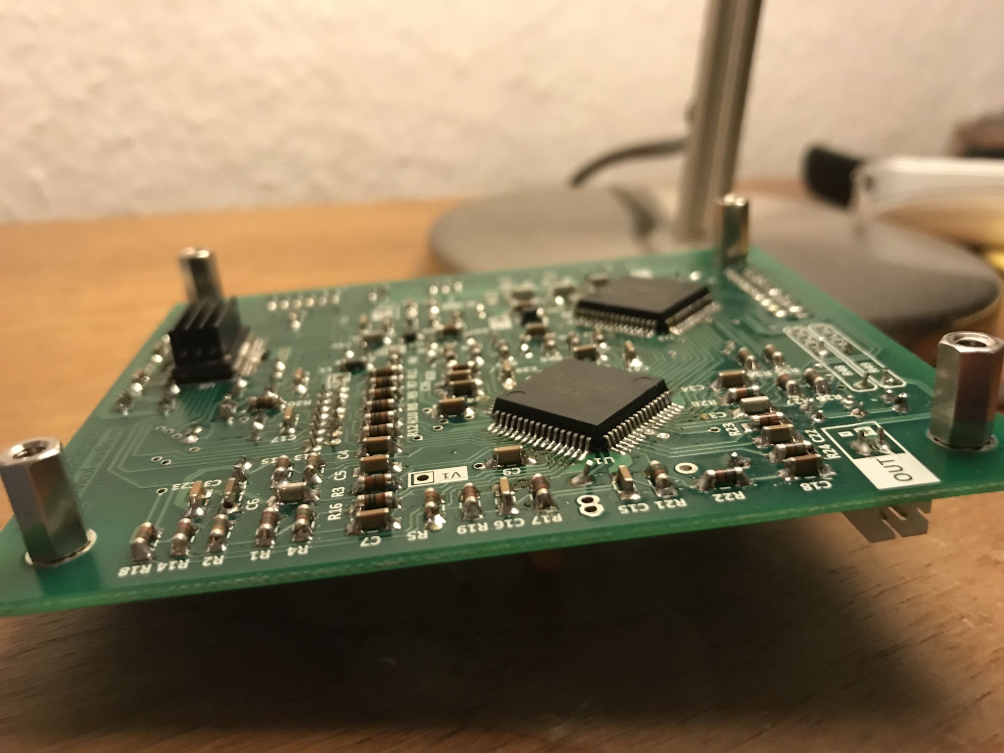

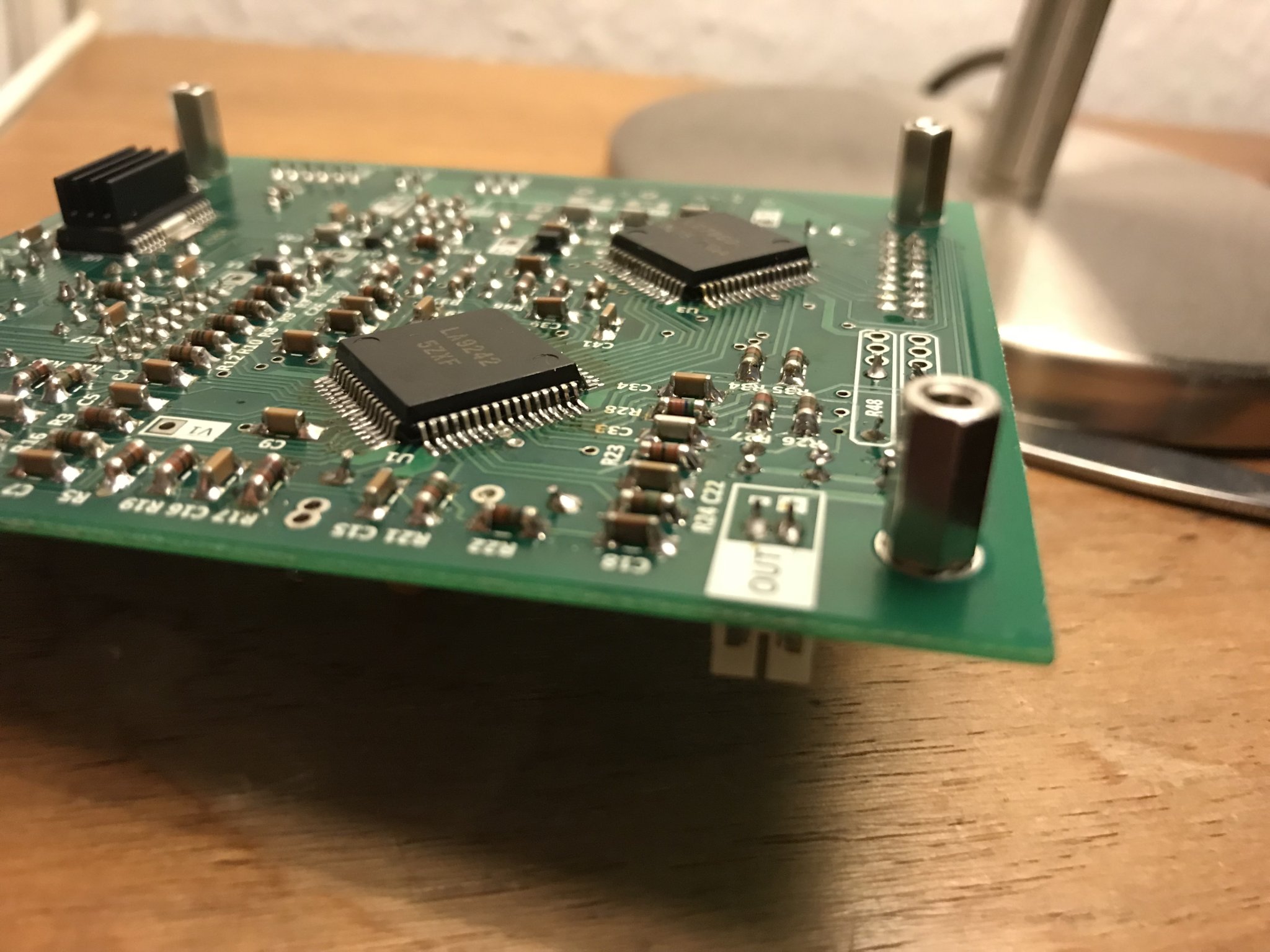

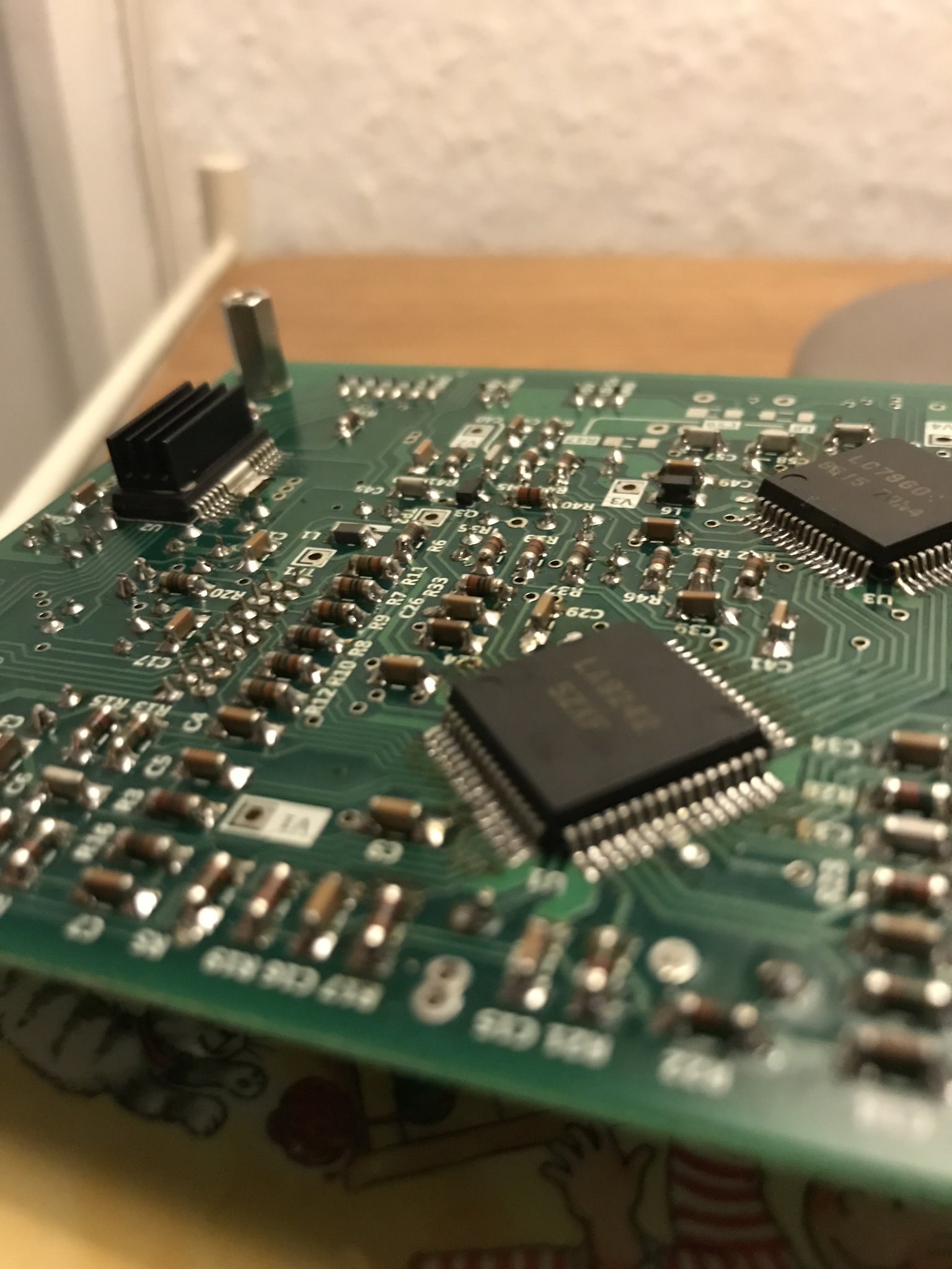

If somebody is in search for a Shigaclone I am offering my completely assembled and tested MK1 as a PCB set. Just add toroid, cabeling and enclosure. All fine premium parts, built with Vishay MELF and so on. Also for sale is a suitable Masterclock from Andrea_mori. Both sale threads can bei found
Here for Shigaclone and here for Masterclock
If someone is interested we can sure make a package. If you are unsure about SMD soldering, I can for sure offer a service help ;-)

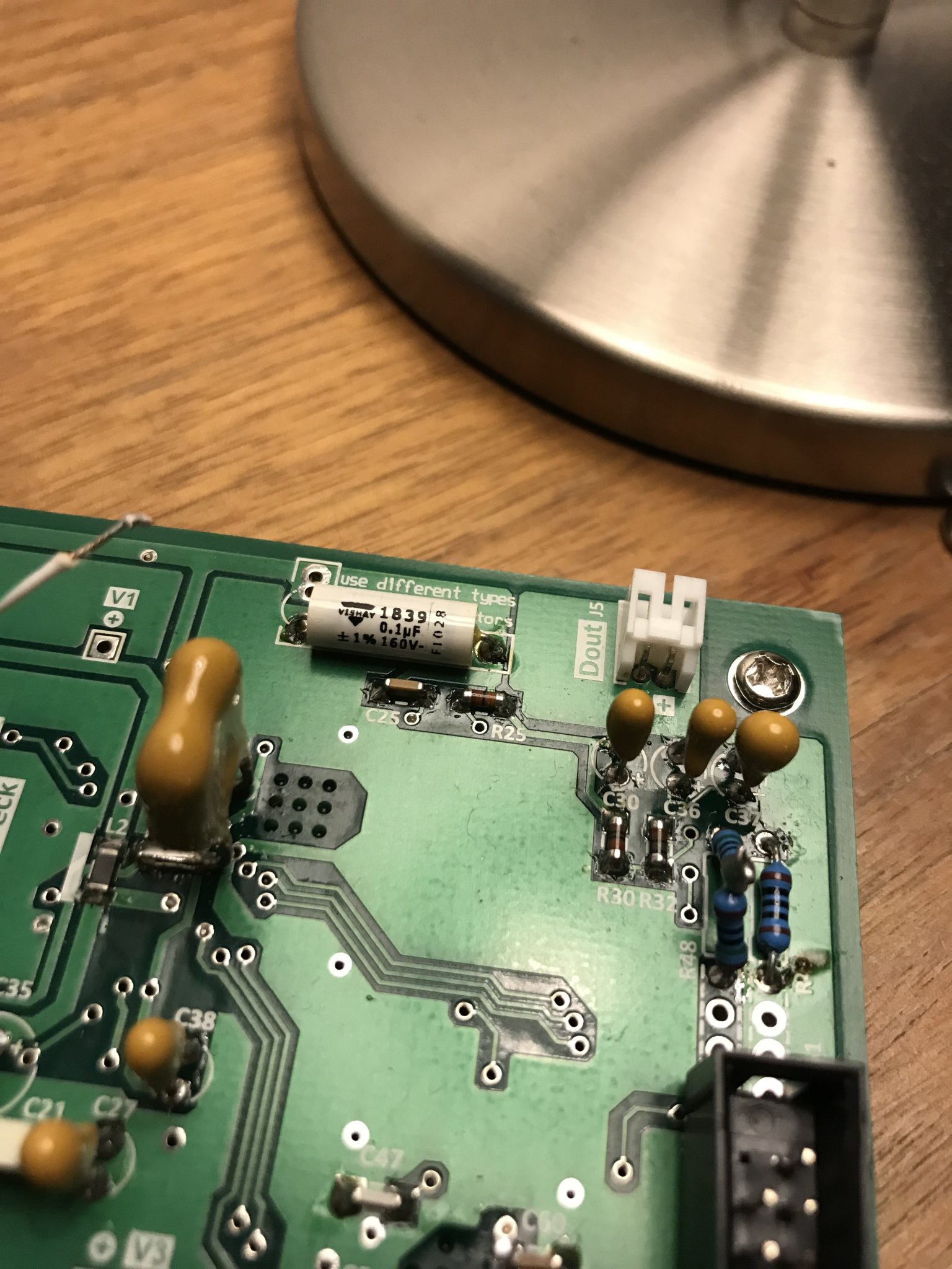

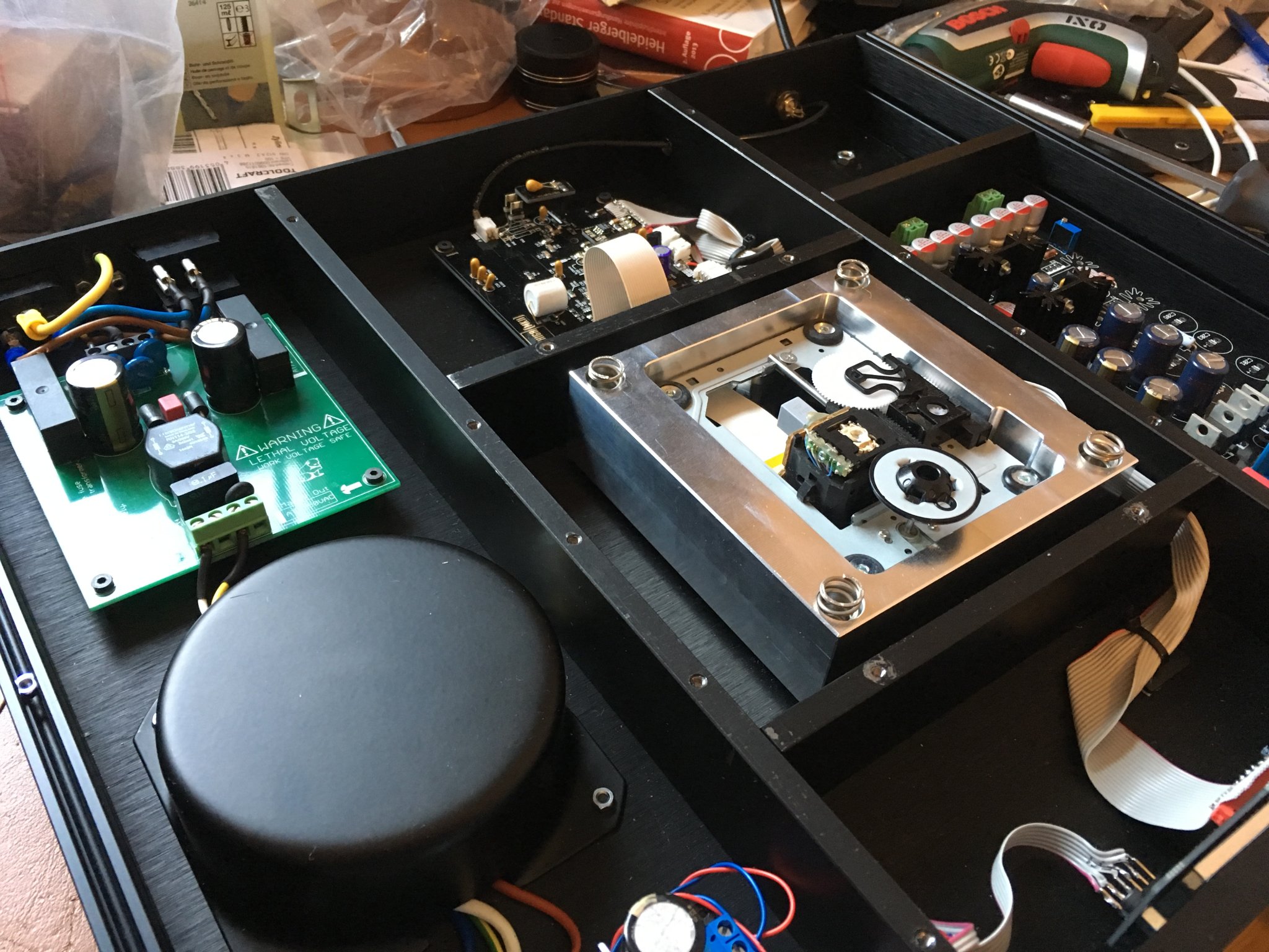

Technically not. MK2 PSU can host some extra parts or bigger parts. On mainboard of MK2 the spaces for optional external V-Regs (V1-V4) has increased so its more comfortable to install them on board directly. Minor adjustments to components placement (some capacitors went closer to Main chips... mainly fine tuning. Sound wise I heard both with the same DAC Setup. The MK2 did not sound much better. Maybe a tight bit, but thats because on my MK2 external VRegs and Tentlabs clock were installed and on MK1 it was not.
Biggest focus should be made on proper installing the CD transport itself. Thats, in my opinion the most crucial part. As some did (so did I), make a block of heavy steel / aluminium and put it onto springs from up and down, like in a sandwich, that way its completely decoupled from any vibrations. Also use a high quality CD puck so there is perfect pressure from on top. I bought my first from Tibi, but it was a tight bit too easy on weight, thats why a friend of mine made a modified version.
