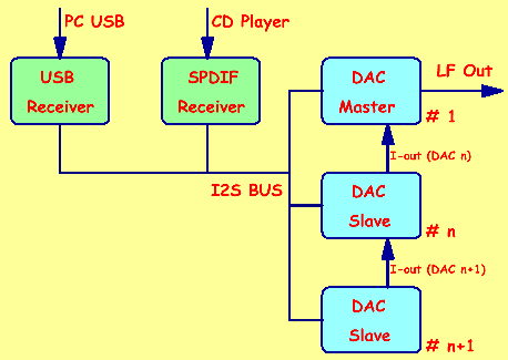

I2S Please...
@ All, been reading the threat with lot's of interest and on the Dutch forum with Erik, very nice job.
Getting ready for the upgrades and am looking for a nice NOS DAC for use with this clone.
Now I'm getting pretty serious for trying the dddac without the Spdif unit. Directly to the I2S on the chip. Is this a possibility?
It would reduce jitter, save me some pesos for a better upgrade and better sound quality.
Please help me, and keep it up!!
