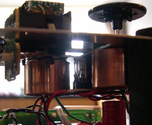

Erik van Voorst said:Mounted by a tight fitting (making a cut and pressing it together...)
For the photo and my experimenting I used my "dummy" motors

Did you use a vise or bench press for fitting?
Is the copper tube of a stock diameter?

The copper gas tube is not stock but approx. 1.5 mm wider so if you make a cut with approx 2-3 mm blade thickness then press a little bit until the cut closes again you have always a (clamping) tight fit..
The motor is 24.2 mm dia.
