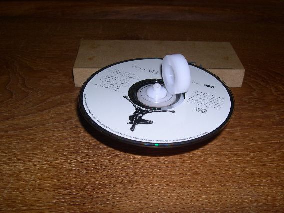

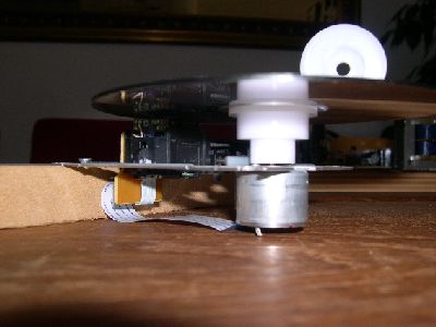

Yes I have tried it out with a "failure" Clearaudio Delrin puck (exentric)
I removed the original plastic platform with a dremel (small drill with a cutting wheel) because with bare hands I think it will be
risky to do damage in my opinion.
I made from a small piece of wood an exact measure between mounting platform and cd. (approx. a tenth of a small pencil)
I used my drill chuck to slowly press it home...till the cd hits the wood....
The part with the drill chuck still bothers me because there is a load of preasure......
When Roy sends me a proper puck I will use a diffrent method 🙂
Beware there is a snag...it is after mounting impossible to reach the 2 small screws...so mount it on your final rig

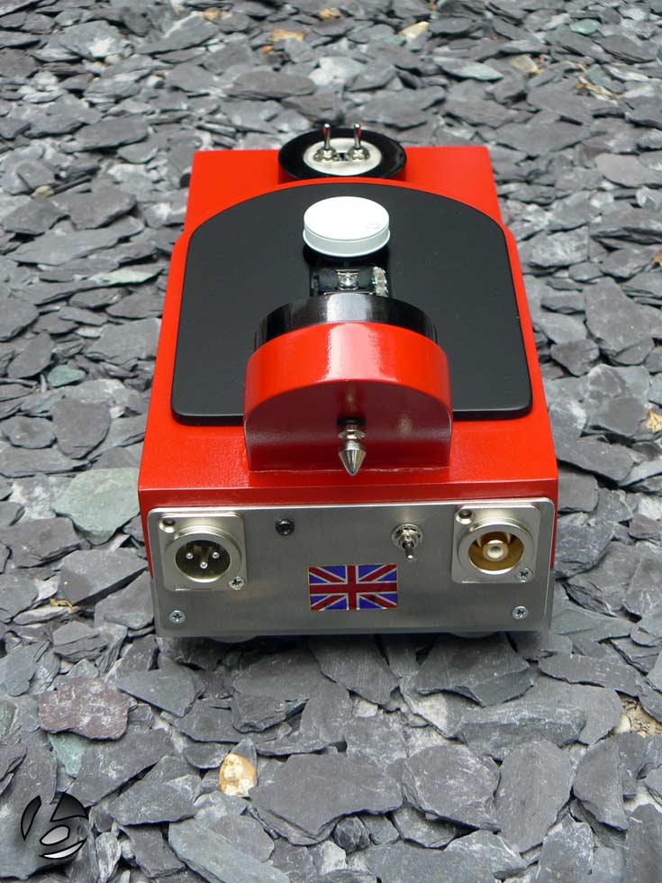

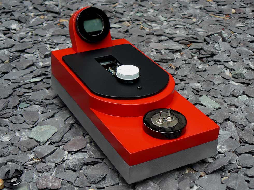

Nice and organic...what is the tiptoe-like point at the back of the display for....
BTW I like the flag......it resembles also a kind of racing machine 😎

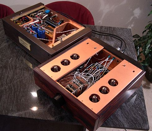

I just like to know that I have tried everything to get the most out of this design...It is definetely worth it.
I think there is still room for improvement...the major asset being that we can LISTEN to it step by step in our own configuration...also you do not have to do it all at once....
If you are in the mood and have some money for the hobby you can try the next step....
I had all the copper as a left-over from building my pre-amp.....I got at the right moment loads of it against a reasonable price via a client/friend..
