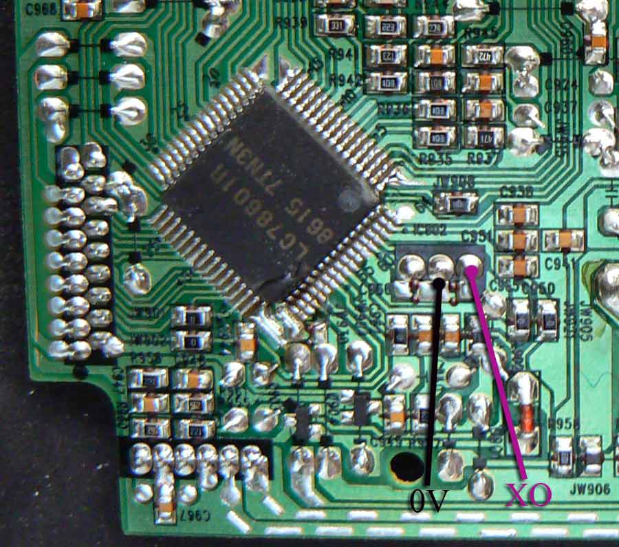

I have built a flea supply for the 16.93 crystal that I obtained from Peter Daniel. I have tried to connect it up as in the schematic attached. However the transport is reading the disc and making music even if the flea is turned off. I am also getting a loud buzzing noise.
I assume that I have either got the orientation of the crystal wrong, or that I have to cut the power supply to the point where the crystal was originally attached?
I have attached the crystal as to one leg to the +5v and the other leg to one point on the board. The ground wire from the flea is attached to the other point for the original connection.
http://www.acoustica.org.uk/t/naim/35clockreg.html

Are you using the crystal in an external clock circuit - such as this one: http://home.quicknet.nl/qn/prive/ra.vdsteen/pdfs/CD_clock.pdf ? If so, then it will work as Audio1st has just shown. But it won't work with an external supply if you have just got the crystal connected directly to the board.
jonners& Audio1st. Thanks for your replies. I am finding my way here so forgive me if I may not understand. The flea is a regulator to which I have attached the crystal oscillator. The flea is shown in the document I attached previously with a Tent Clock (16.93) attached. It can be used for other applications. I don't know if what I have made would be classed as an external clock circuit or just an external power supply with crystal attached.
I'll post some pics later if it will help.
Hope this helps
jonners said:Puffin
You have me puzzled here. I'm building a separate clock (KC7) with it's own independent PS.
