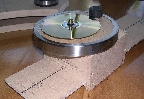

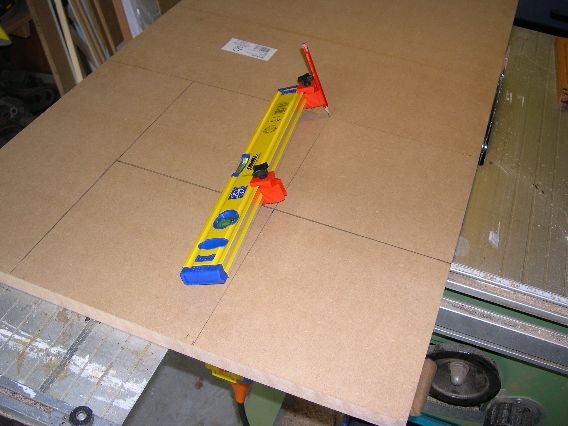

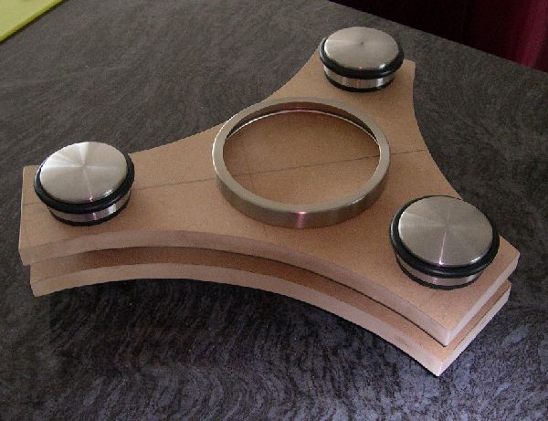

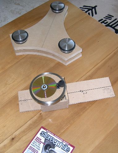

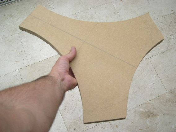

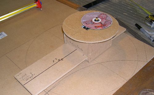

Today I took some time to get an idea how the transport will be build....
I used MDF to get a feel of proportion.....and low costs before I start hacking away with acryl and the likes.....
It wil look like the Metronome Kalista...well that is the idea..😀

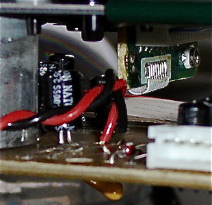

I just realised that an earth connection via the Trichord clock board is both unnecessary and undesirable: My clock power supply is derived from the main PS after the rectifiers, so the earth connection is already made. Hence I've snipped the earth wire near the transport board but left it twisted around the clock output wire:
For me, the external clock is definitely the way to go. 😎
